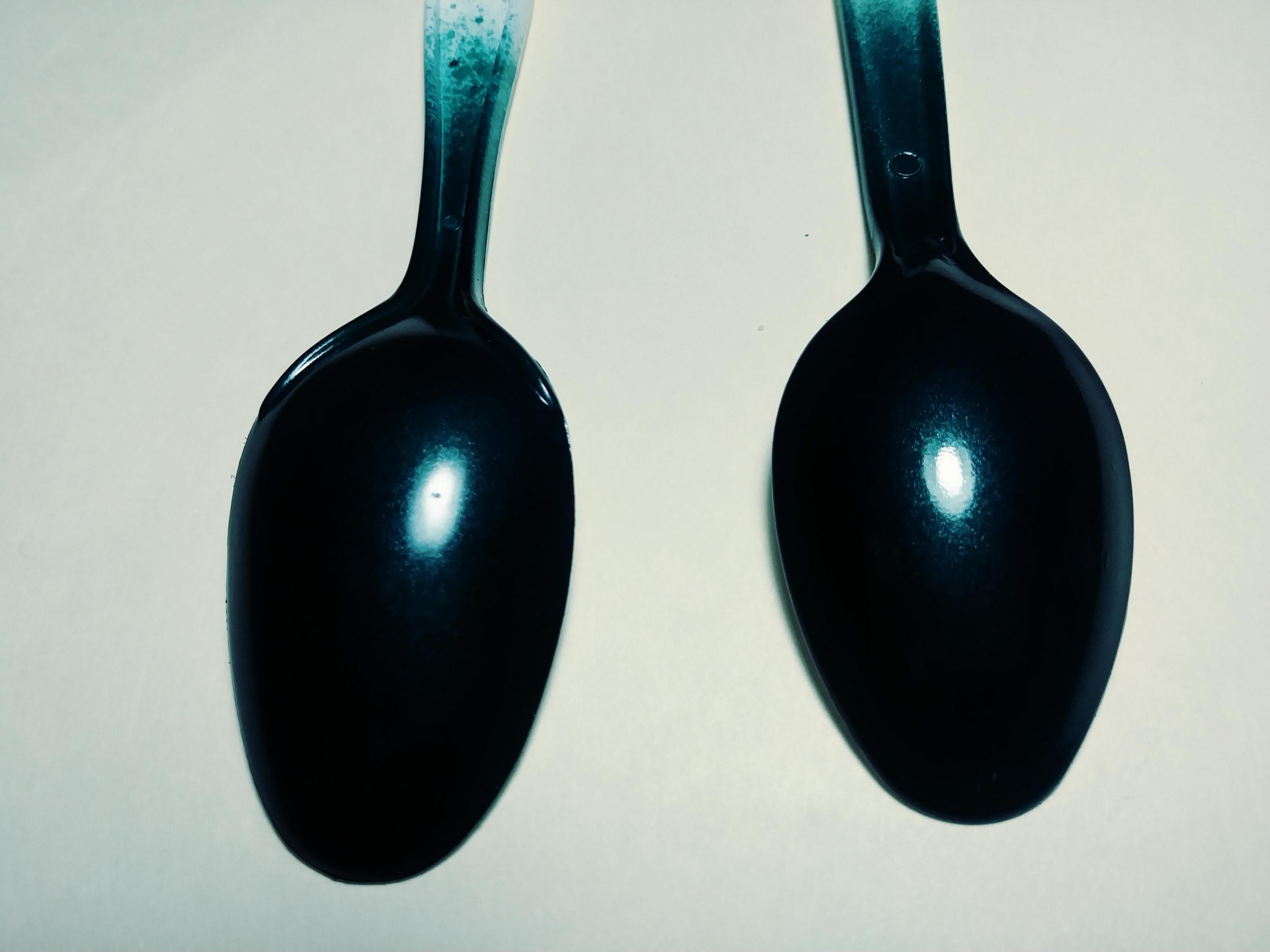

  1. OK I just did a spoon test. Both where done with white primer. The one on the left is Tamiya and the right one is Rustoleum 2X. The paint used is Dupli color Forest Green Pearl BCC0423 (PG8) I let the primers cure for 24 hours. Under a 60 watt LED table lamp is how I took the picture. Neither crazed on me and I put the paint on wet, one coat. The Rustoleum has more gloss as seen by the light.

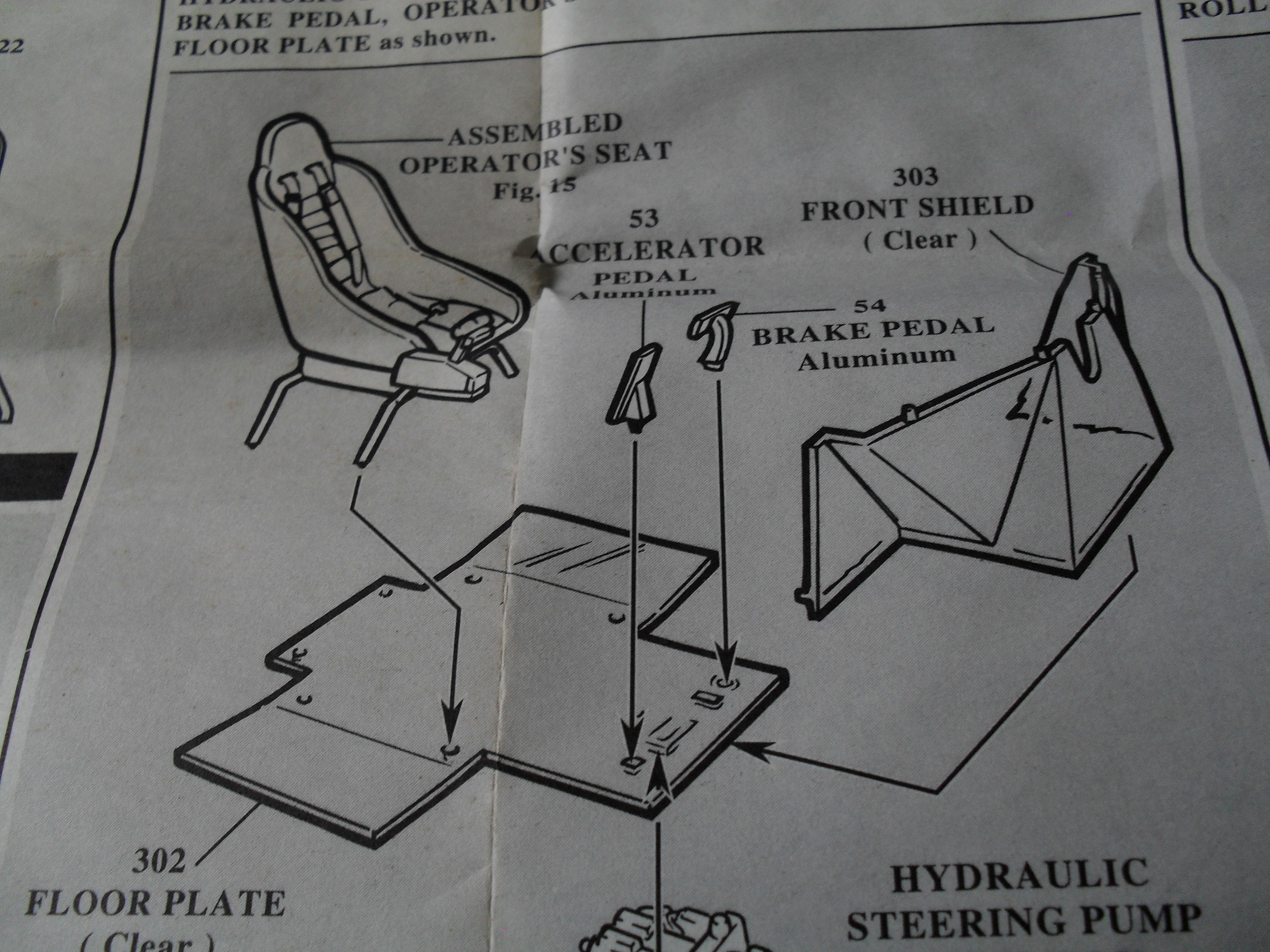

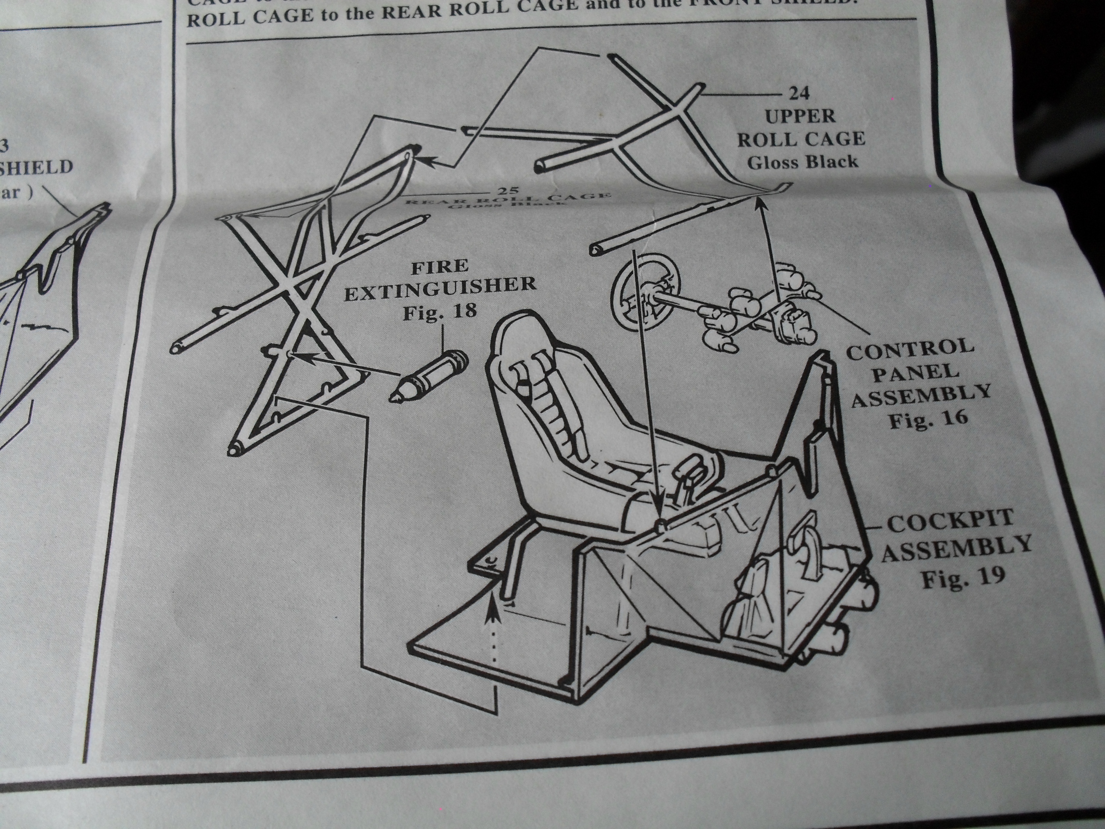

  22. Hi Putting together a model I have had for years, Big Foot monster truck. The cockpit is clear and I am using Testors clear parts cement. I understand this is a type of wood glue but I need something with more strength because I have to clamp the roll cage to it when I glue the cage in place. I'm using rubber bands to do this I guess I'm going to answer my own question and say to use clear epoxy. Here are some pictures of the construction. Thanks
