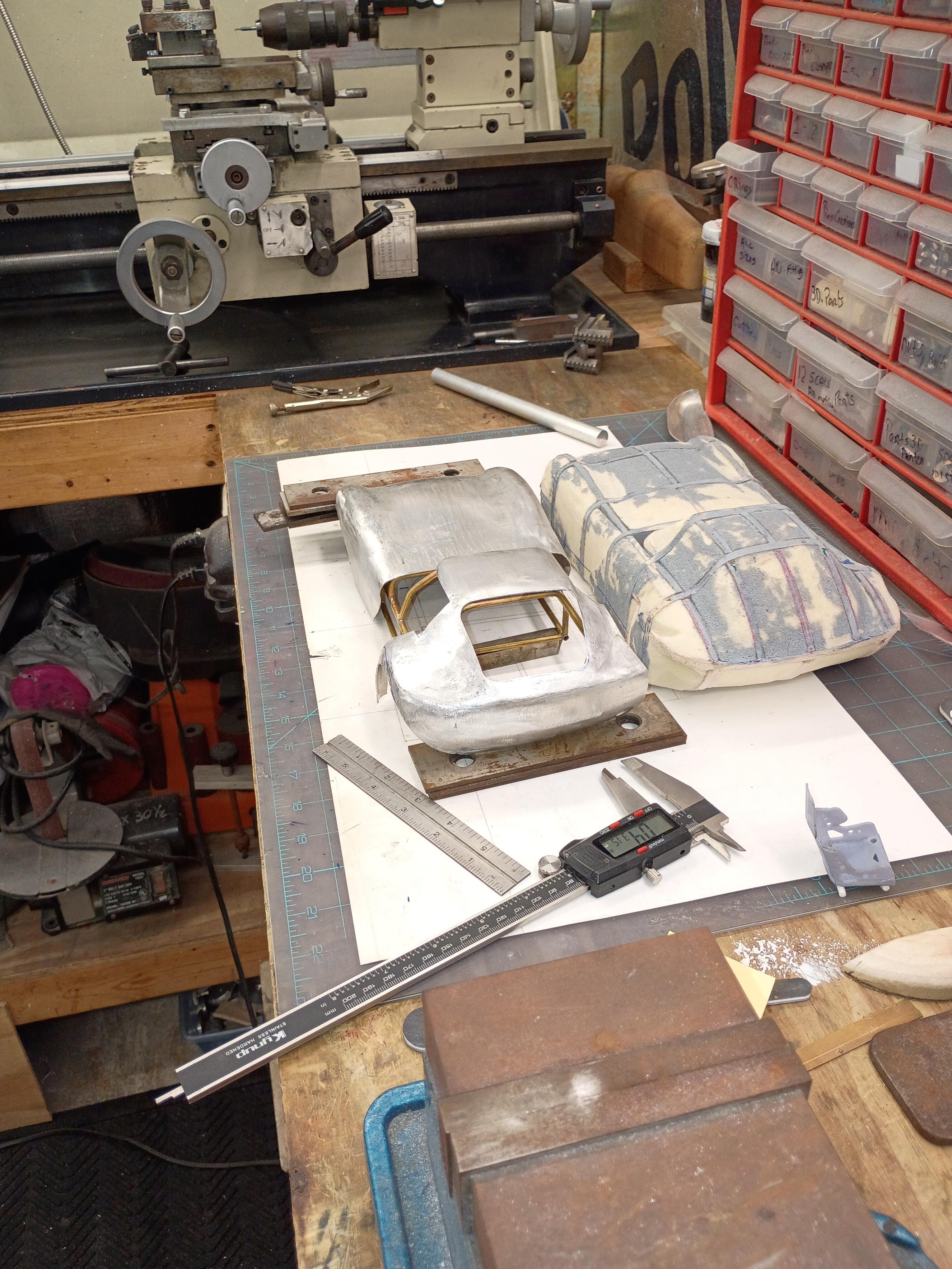

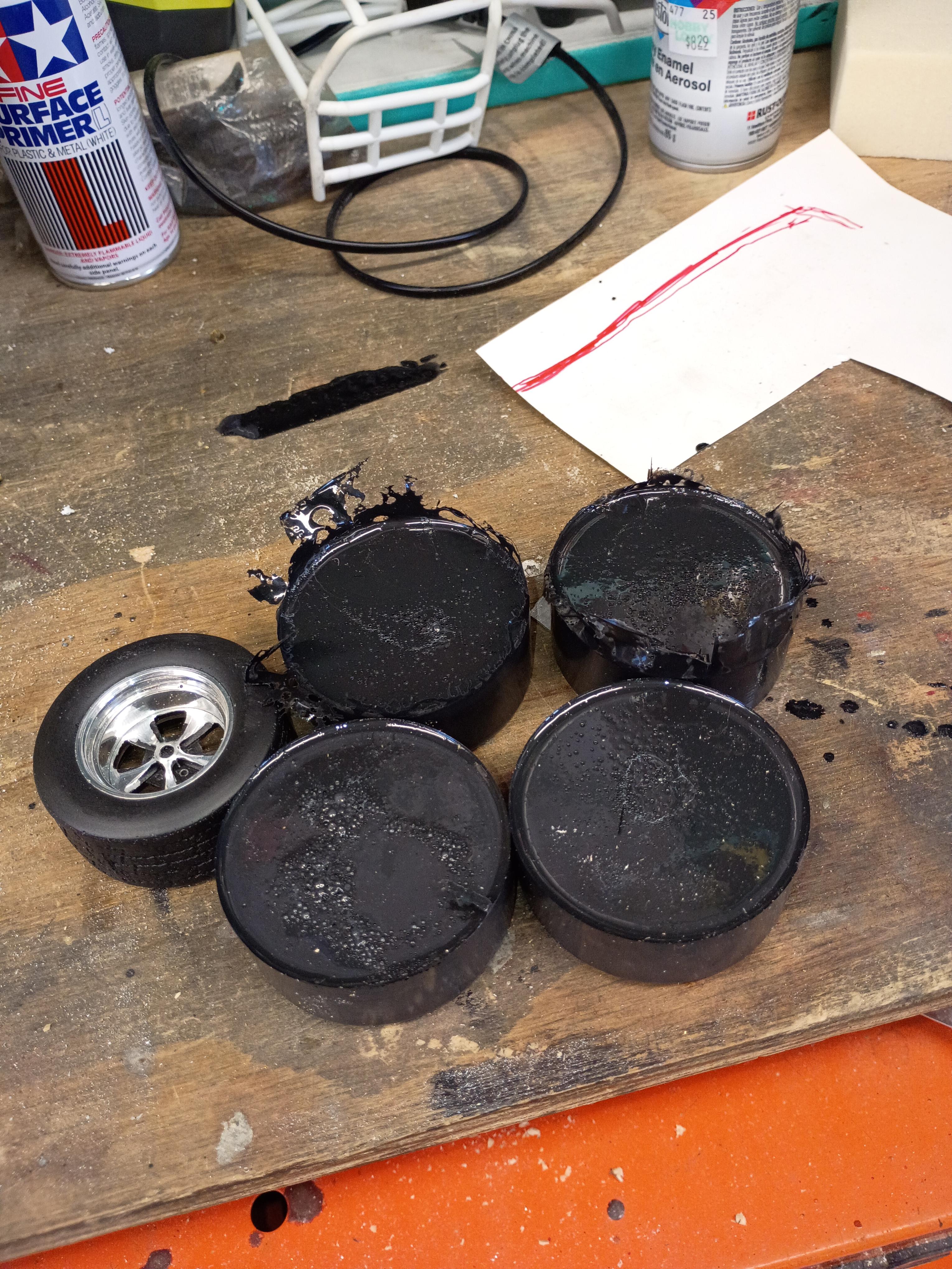

  3. thanks for following brian. david i will start looking for those 3 magazines after this. hi Andrew, when are you coming this way? no stretching David got to fit right. I am going to have to build mostly off the buck after the windshield frame is made and attached. i cast 4 blanks to machine the tires . i can do them on the lathe because they will be slicks . going to take a while . i am looking forward to finishing the 55. thank you all

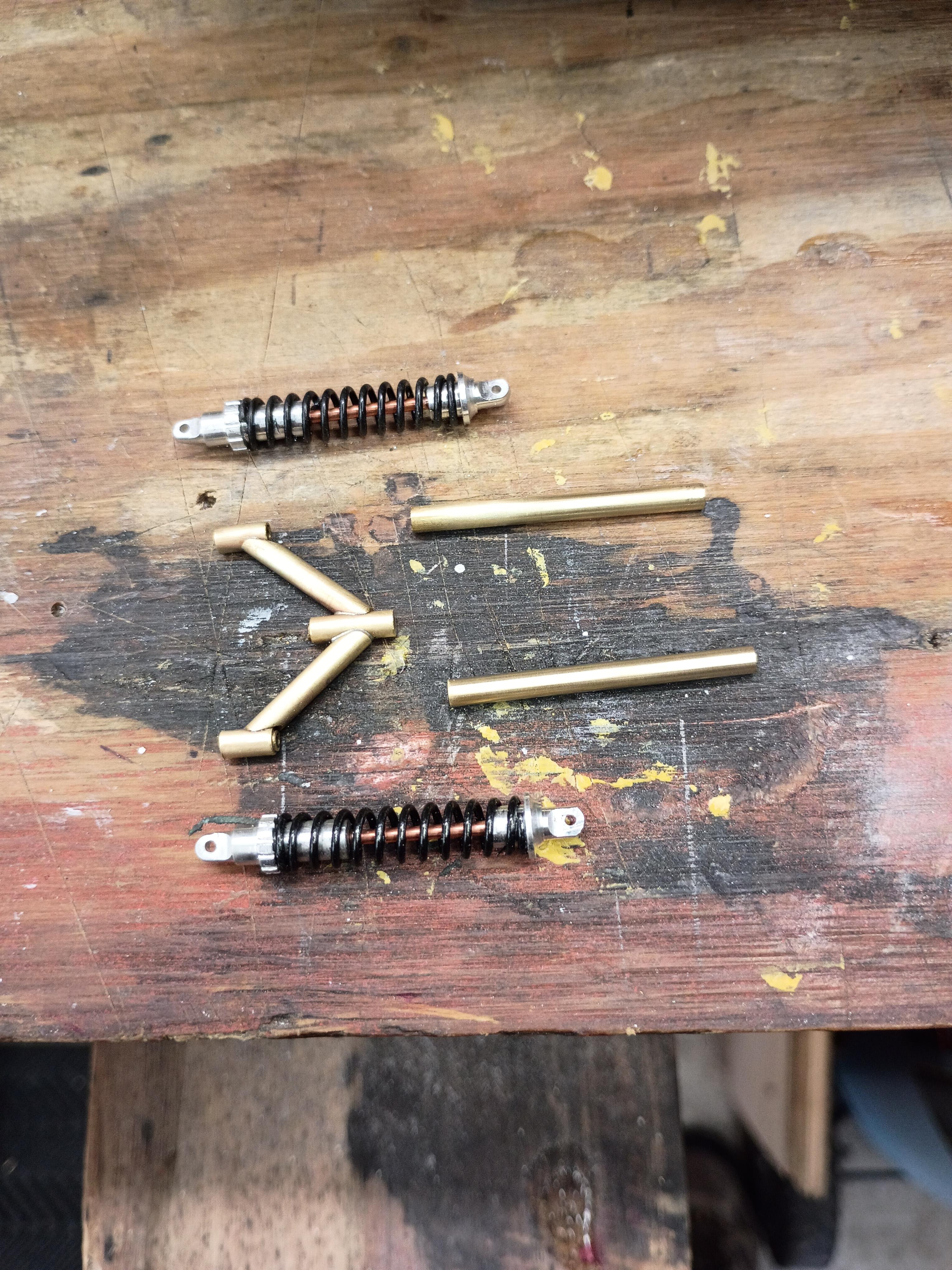

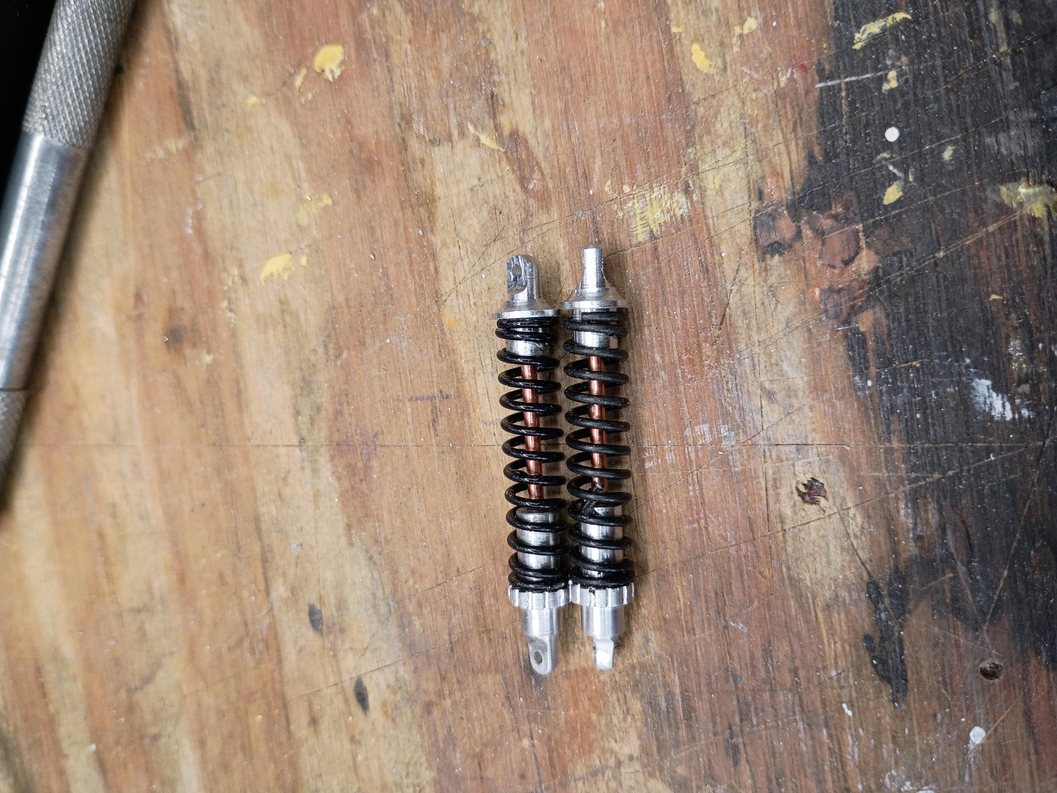

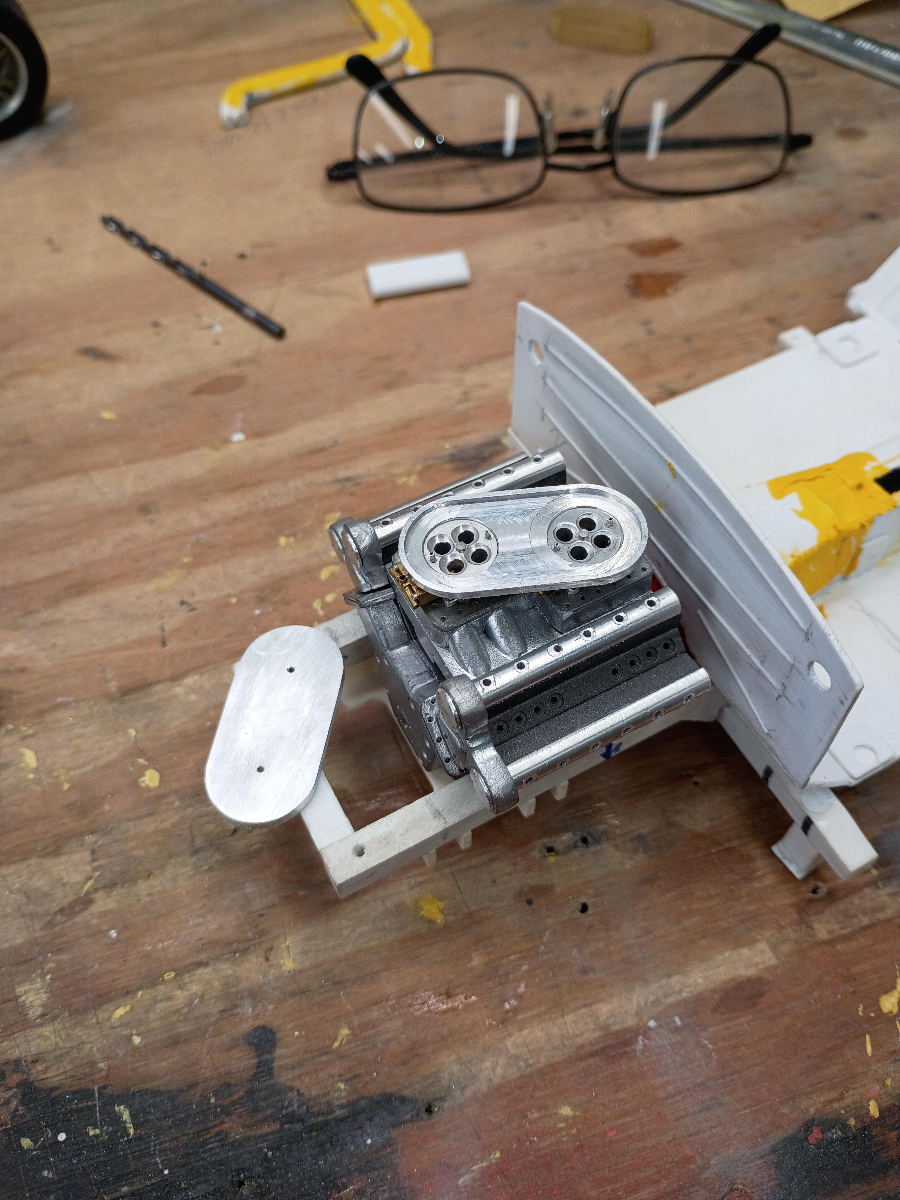

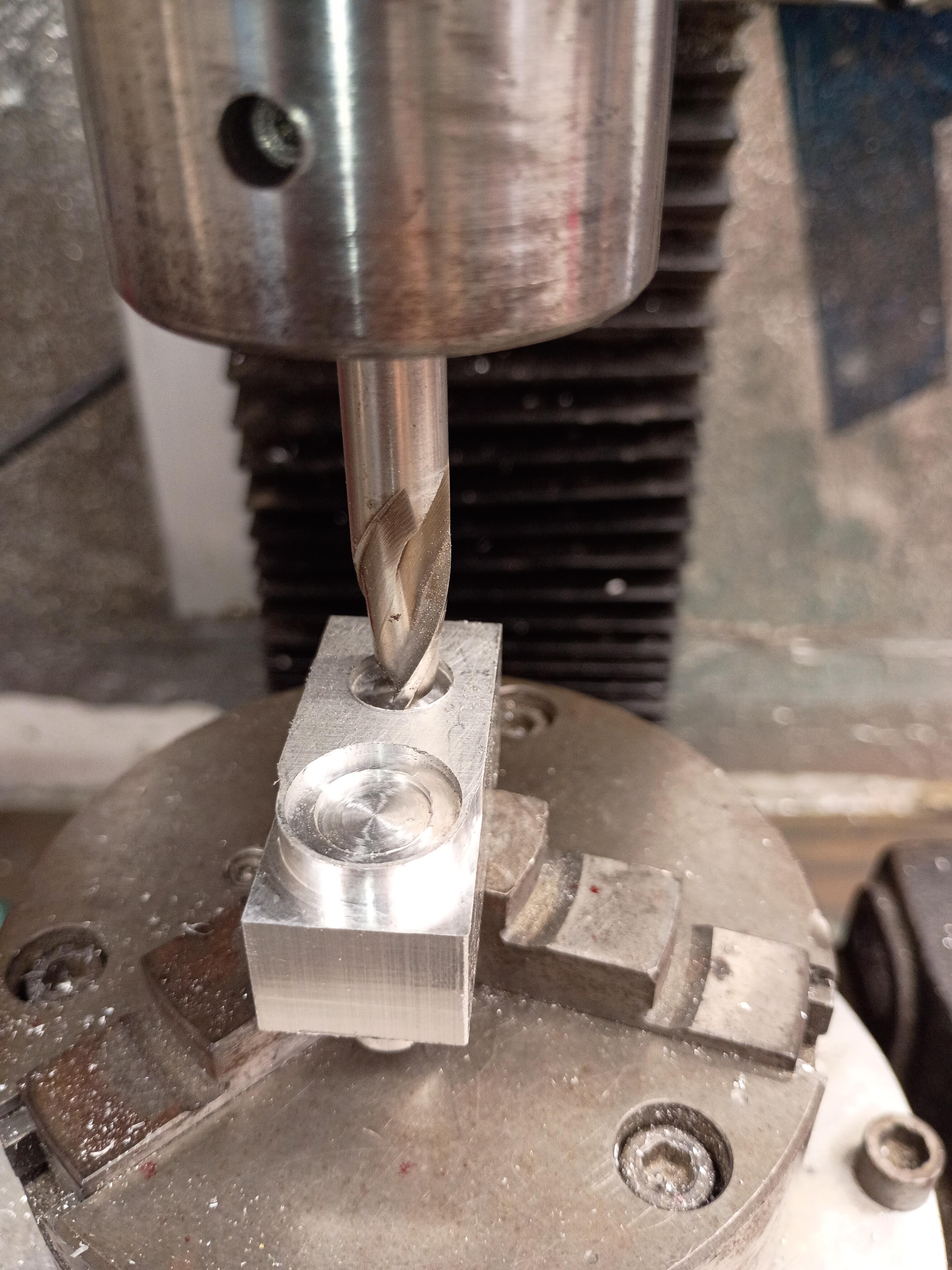

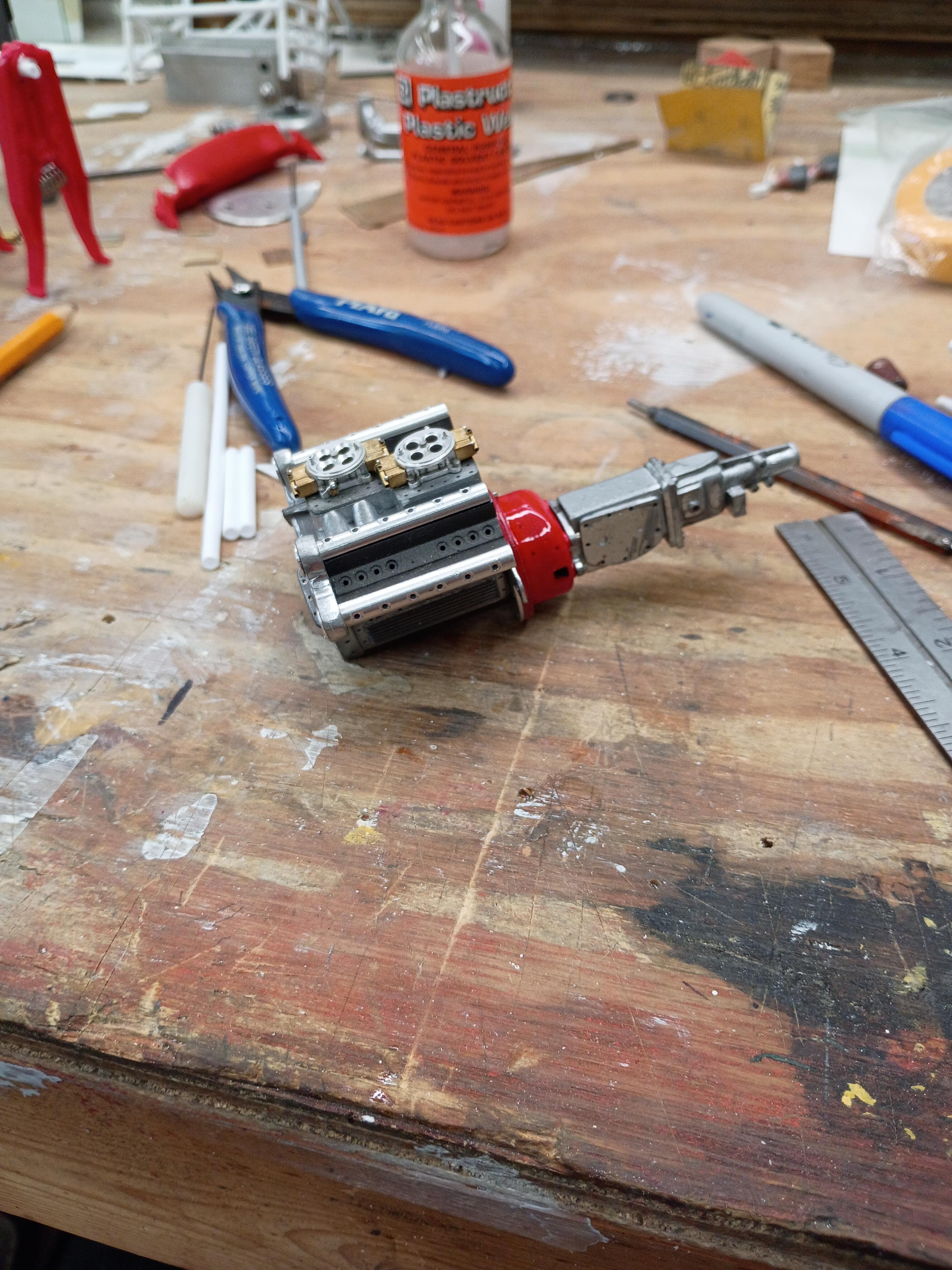

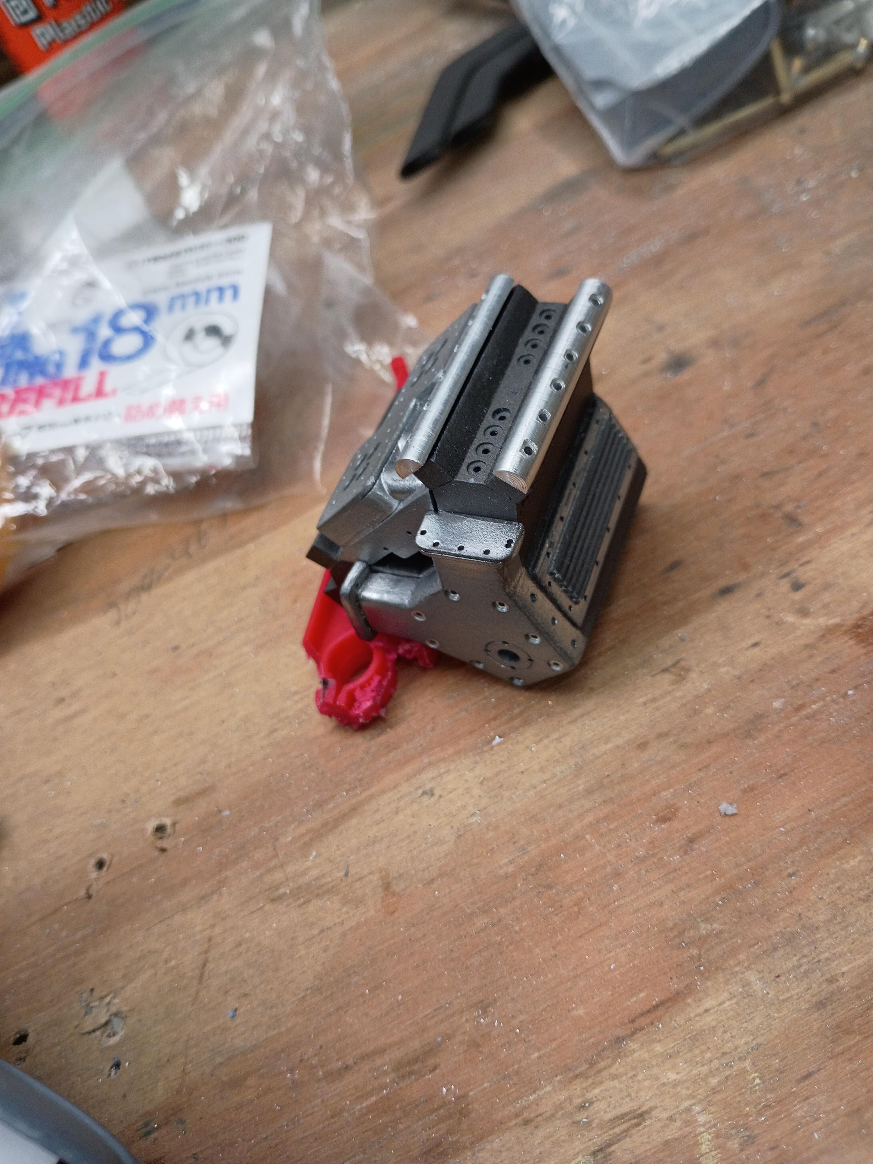

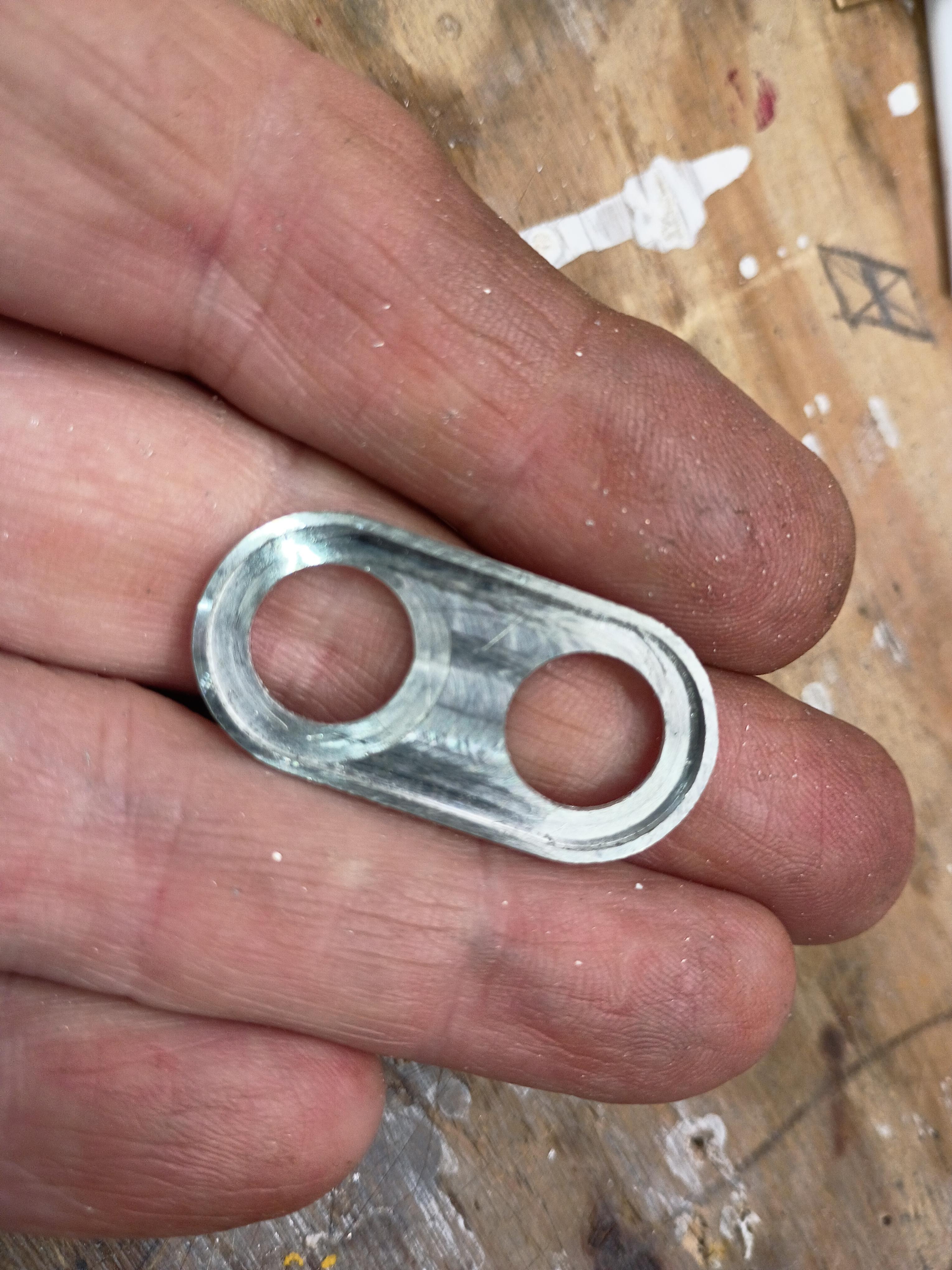

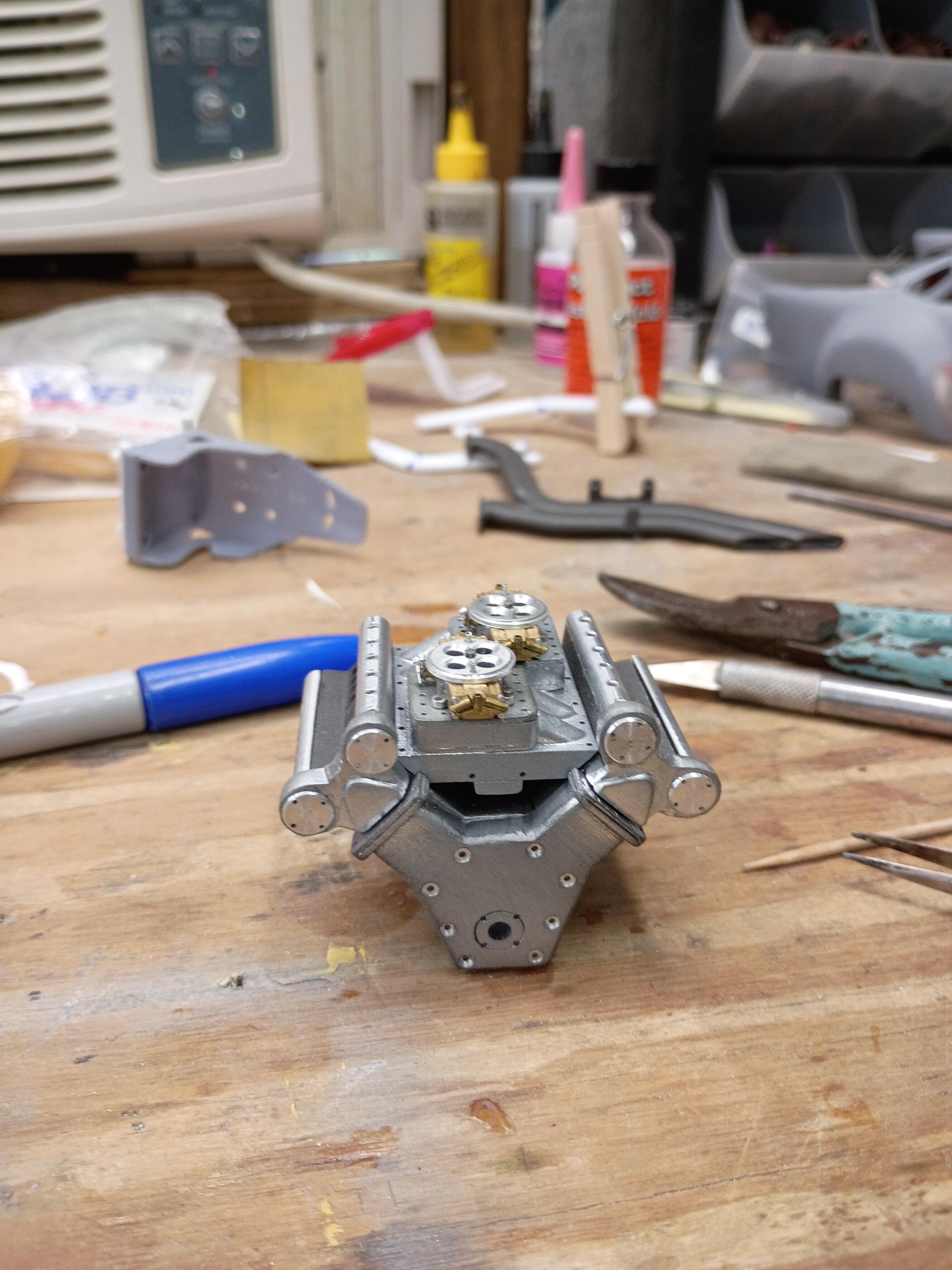

  4. thank you micheal, its coming along. does anyone know when rb will be back or another place to purchase 1/12 and 2/16 rodends ? working on the rearend suspension, nee rodends to finish . i have an idea to try to machine them myself. the engine and transmission are coming together. shifter is made just have to make thr rods. going to work on the water pump tomorrow. got the top and bottom of the air cleaner machined. got material today to make the upper a-arms and then the shocks. the parts for the shock are made, just need to measure for length. tanks for all your comments.

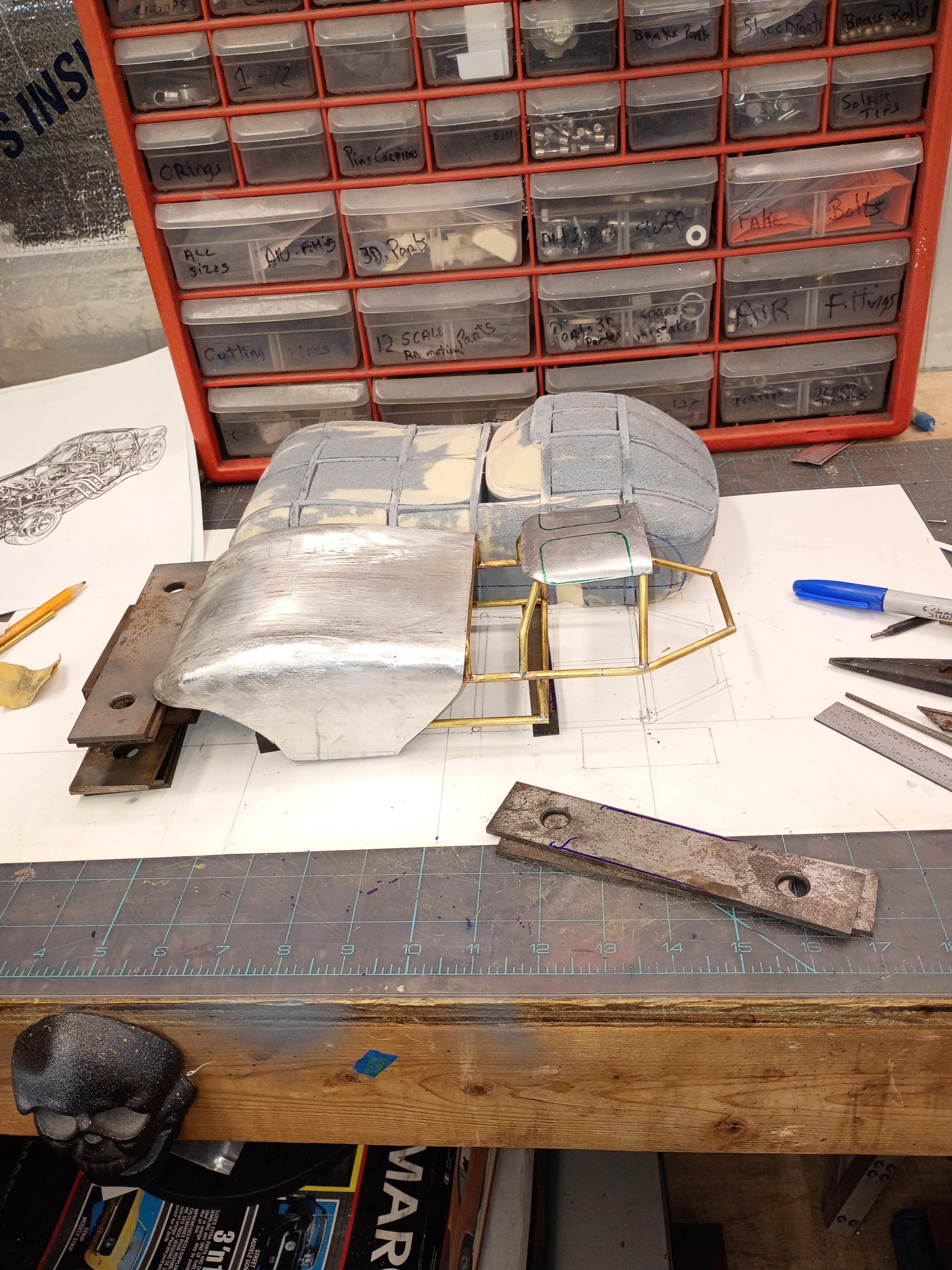

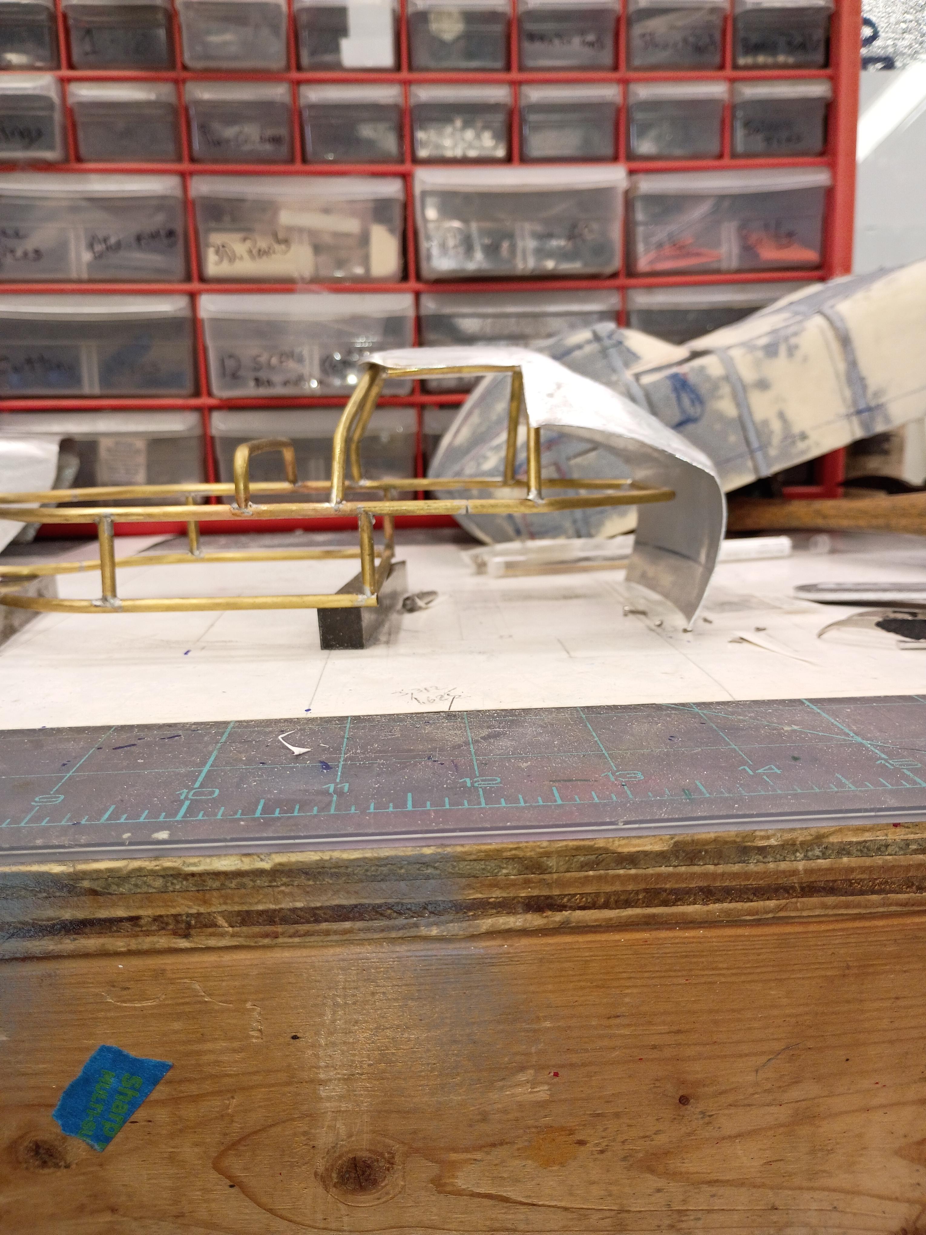

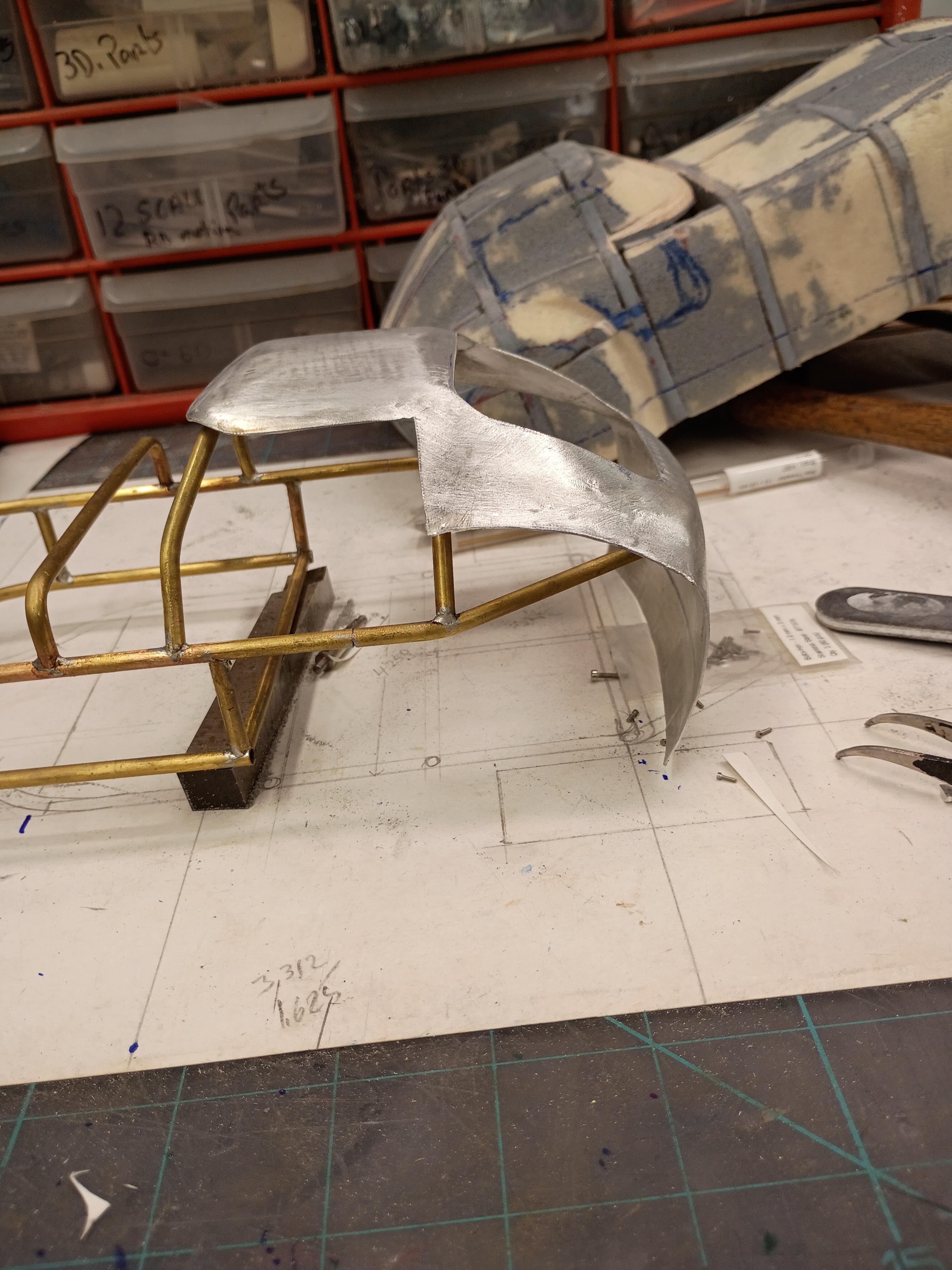

  6. cant keep up with you or Francis . hope you are doing well. nice to hear from you all. this is a big project. much thanks to David Bantoft for the chassis drawing. i got a good start on it. still building the 55 also. got to keep an old mind and hands busy. here is a few pictures. to make all the uprights the same and make sure the fish mouths were in line on both ends. i fished mouth one end and soldered them on a piece of tubing so i could clamp them in the vise to fish mouth the other end with a .150 ball endmill. this way all would be the same. i started on the front fascia with the grill opening. i am doing alot of research. found a lot of picture but no technical drawings. measurements are hard to come by as i am sure David knows. sorry noel,cheetah was always a favorite of mine . stay with me, it might grow on you.

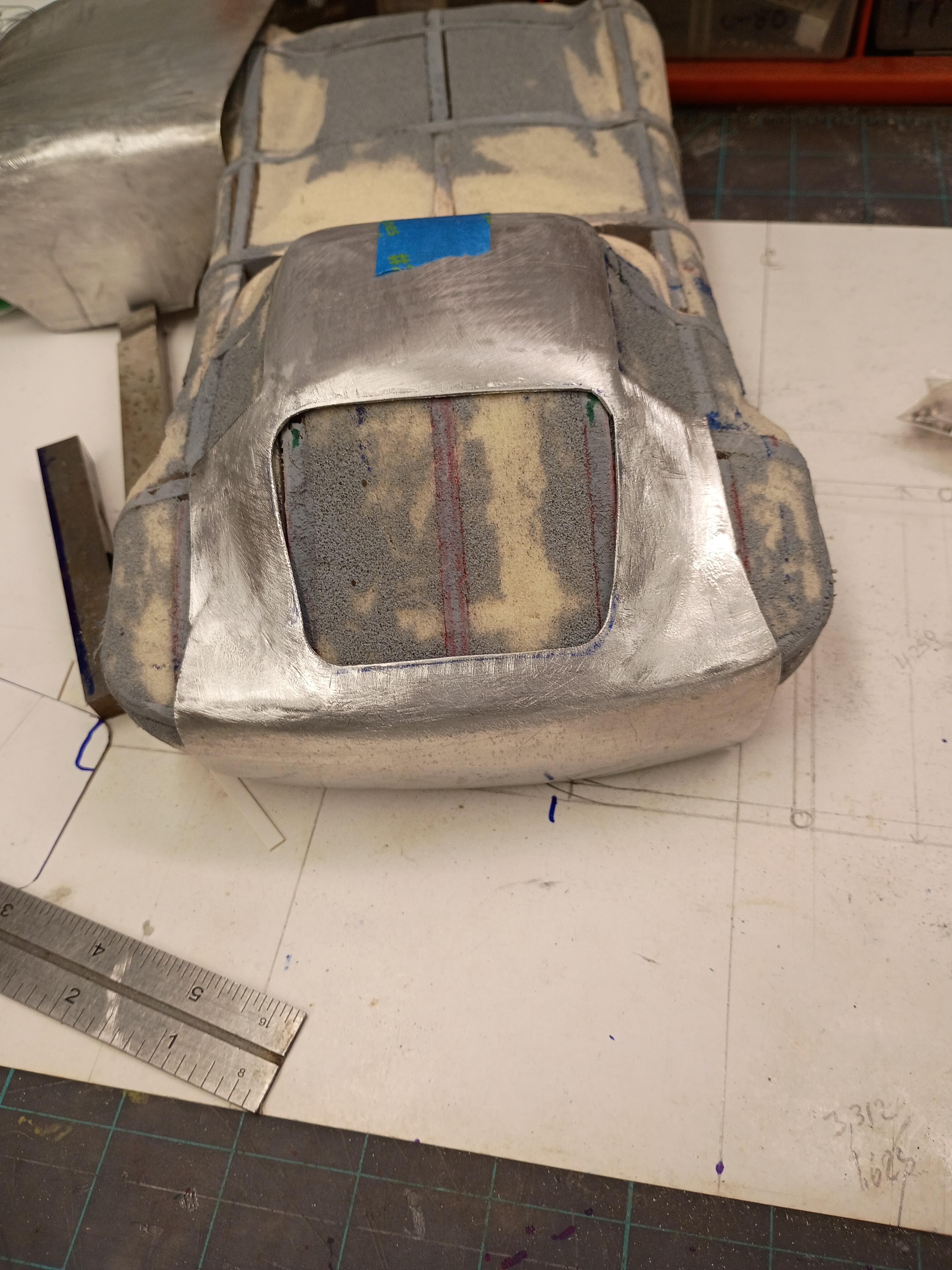

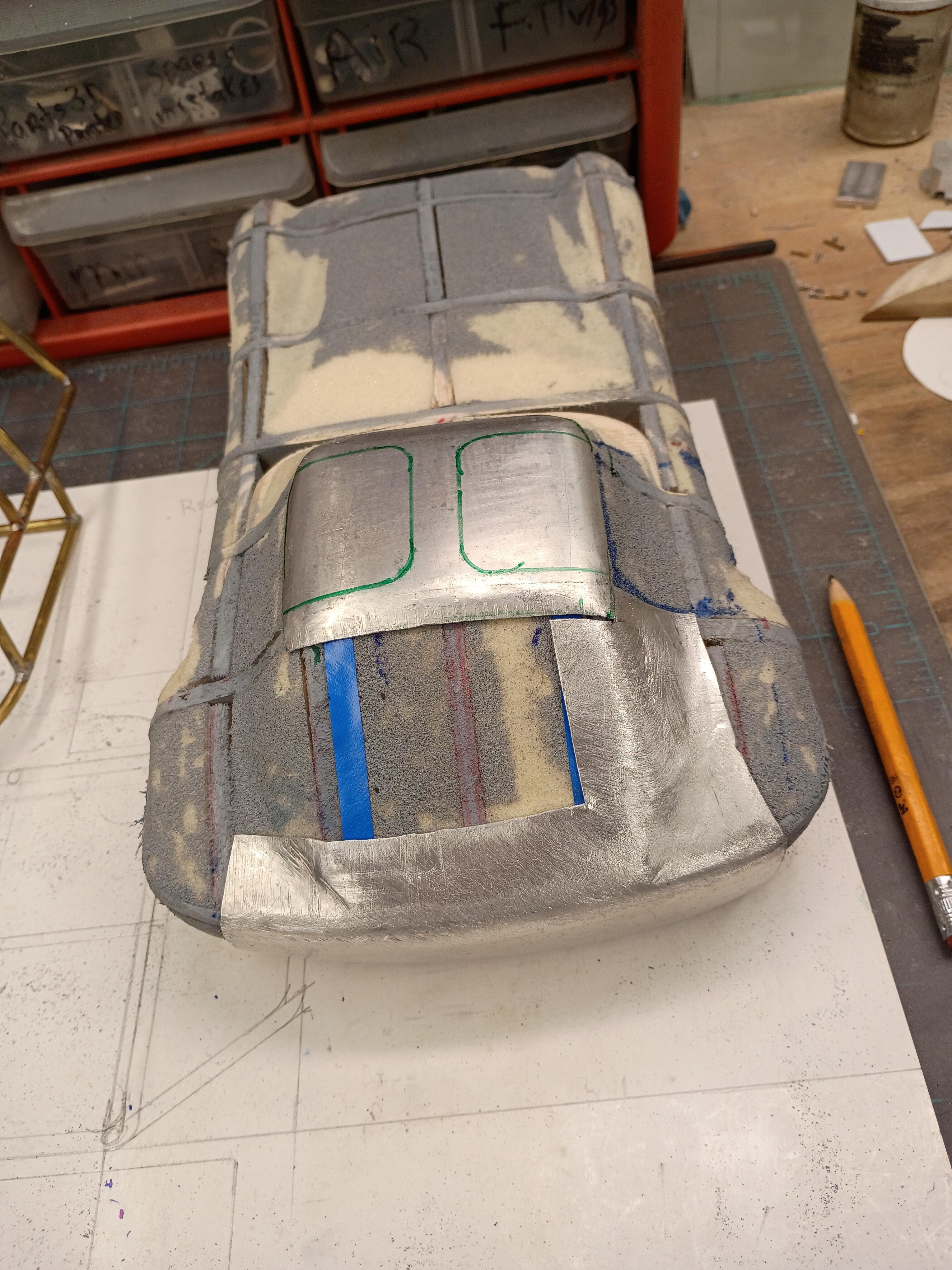

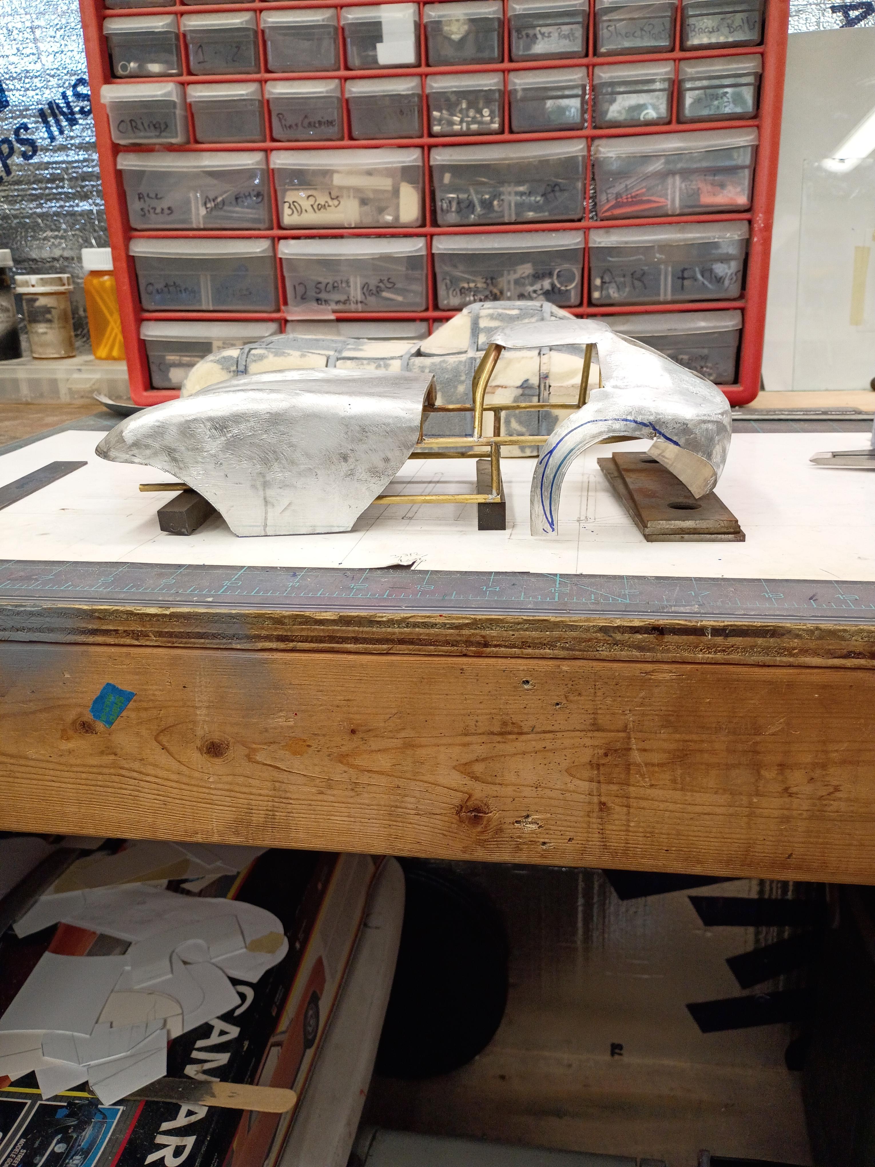

  9. back so soon.glad to hear fromm you .this will be another big project. got a little start on the body today ,this is 1/12 scale. in between working on the 55. outside half of the front fenders are next them soldering . i am going to practice a little first.
  10. just get started . going to be a long project.i promised after the Bugatti no more long projects an here i go again.i am going to attempt an aluminum body this time . we will see how this goes.i will post pictures tomorrow. i forgot to send them to one drive
