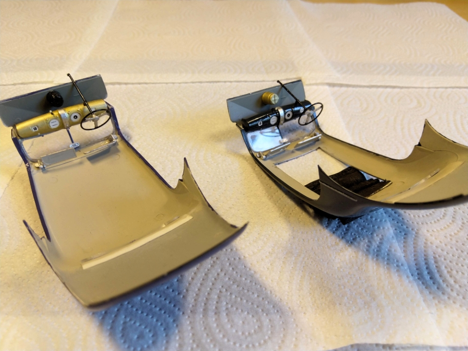

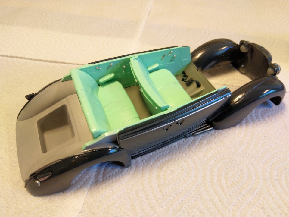

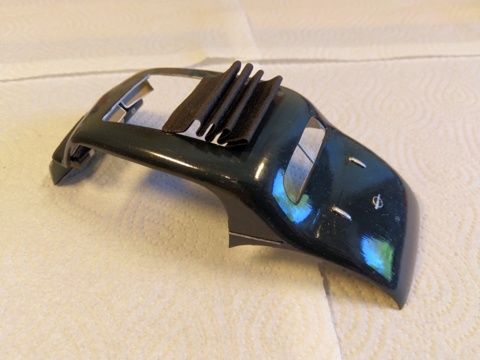

  14. Seats, door panels and handles mounted into Cabriolets. Dashboards glued into Limousines. Last photo shows the Webasto sunroof made of 0.24 mm brass sheet covered with fabric.

  17. A small update. Seats, door panels and handles mounted into both Limousines.

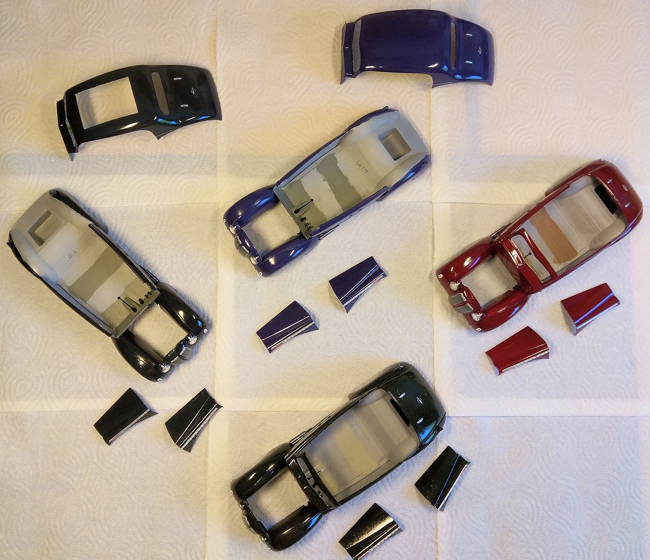

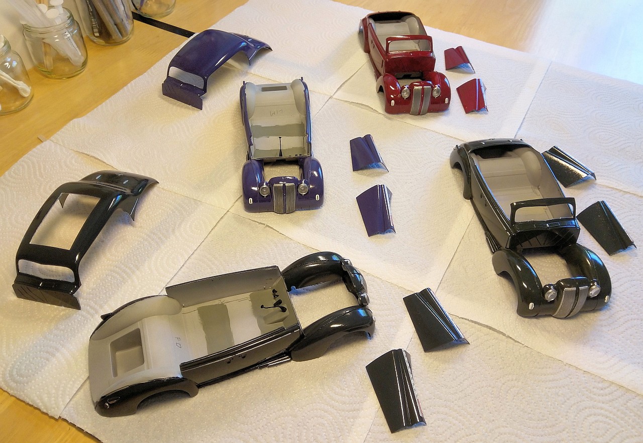

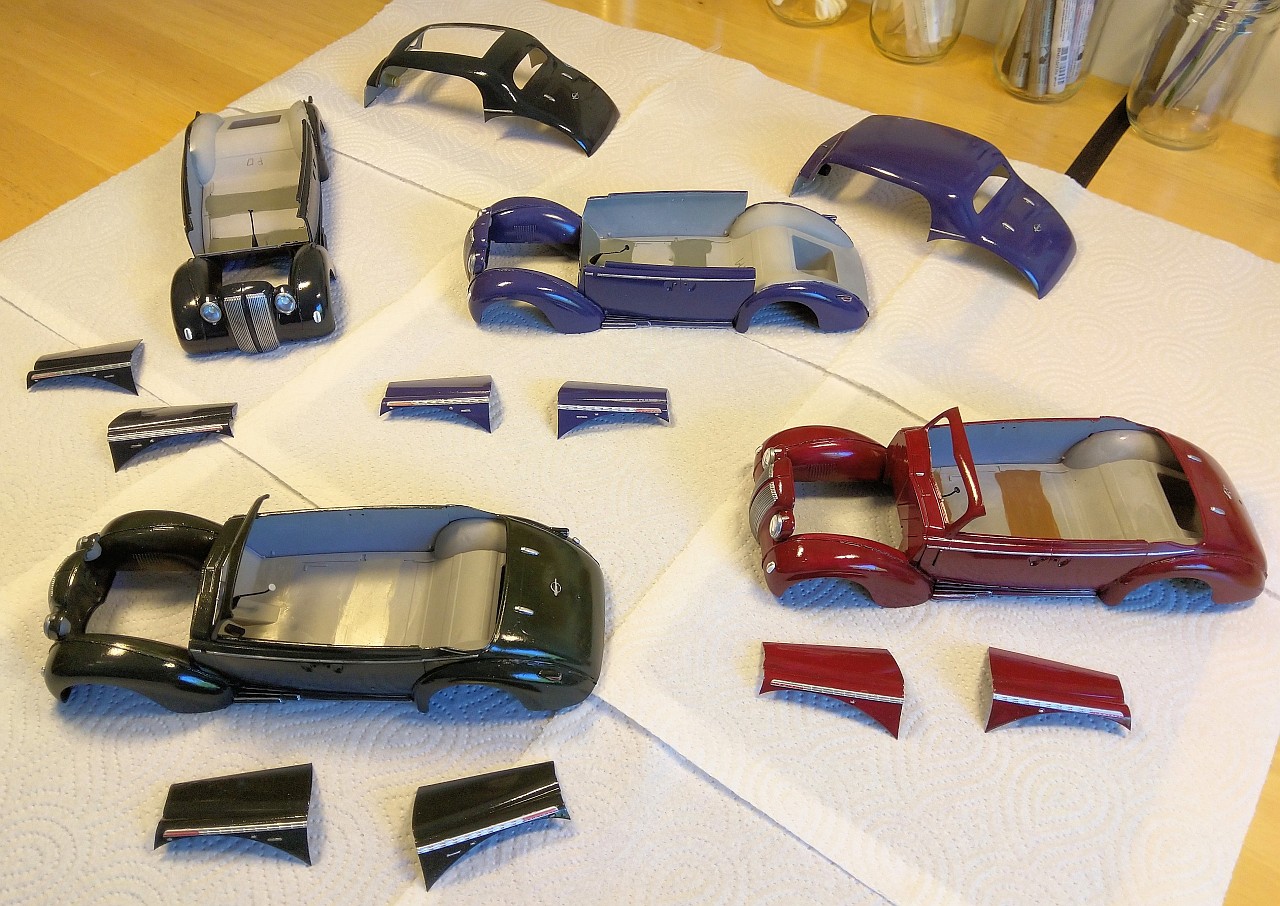

  21. The factory was closed for two weeks due to the reorganization of facilities and equipment. Fortunately, no one was left unemployed. ? Now that everything is in place, production can continue again. All bodies are now painted and e.g. lights and grilles installed in place.
  22. Thats nice! ?

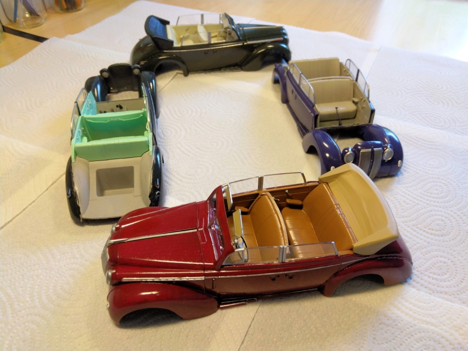

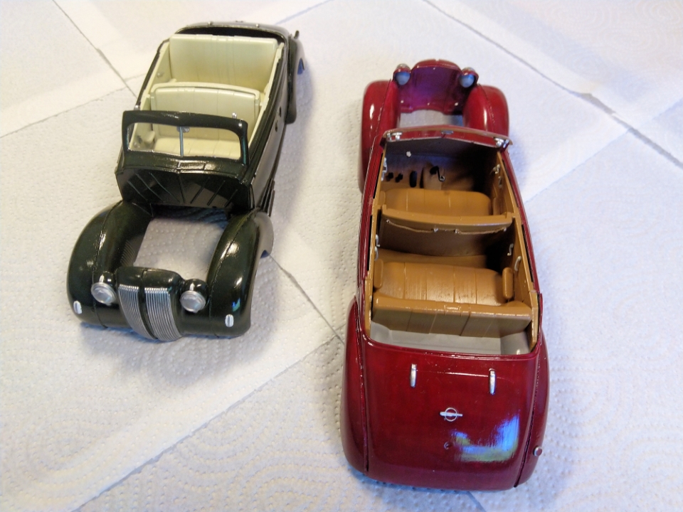

  23. Hello David. Thank you for asking. The answer is quite simple. It is not possible to mix car parts because the different parts of all cars are painted in the same color. For example, all chassis, engines, etc. are exactly the same in all four. The only differences are the colors of the car’s bodies, rims, dashboards, and interiors. If I try to put red wheels or a blue dashboard in a green car, I notice it right away. There are three black steering wheels and one off-white. I know right away which car that one will come in and the others then the blacks. I hope this answer was helpful.
