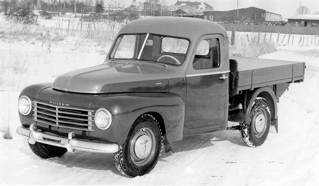

  18. Is it like this when it's ready?
  19. That looks very good to me. ?
