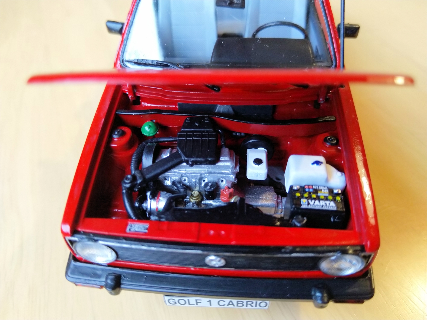

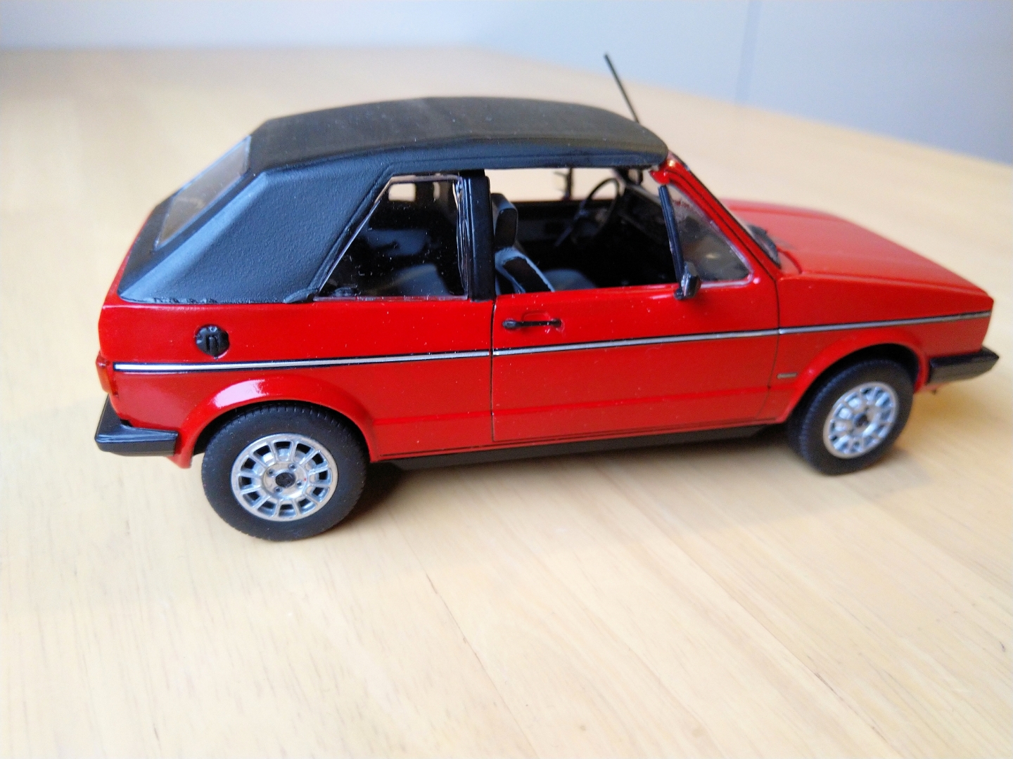

  6. Golf Cabrio that was build in 2020.
