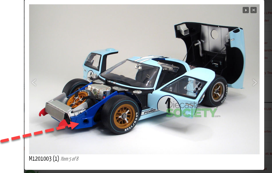

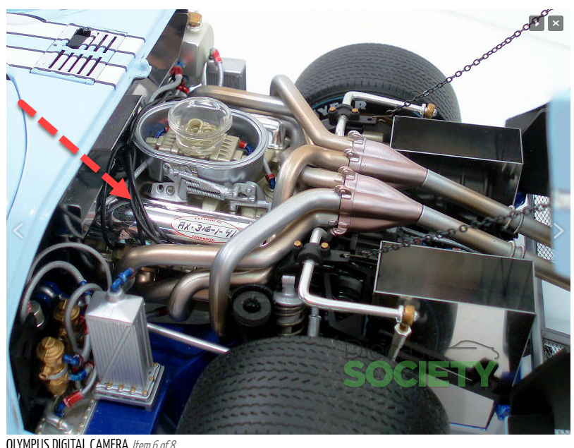

here are images of the cabling and note the color of the main frame which was a kind of royal blue which i am now looking into . these 2 images are from a high quality die cast model . I agree that PE extra is way too expensive and also very complicated from what i have seen on 2 videos on youtube promoting it . -

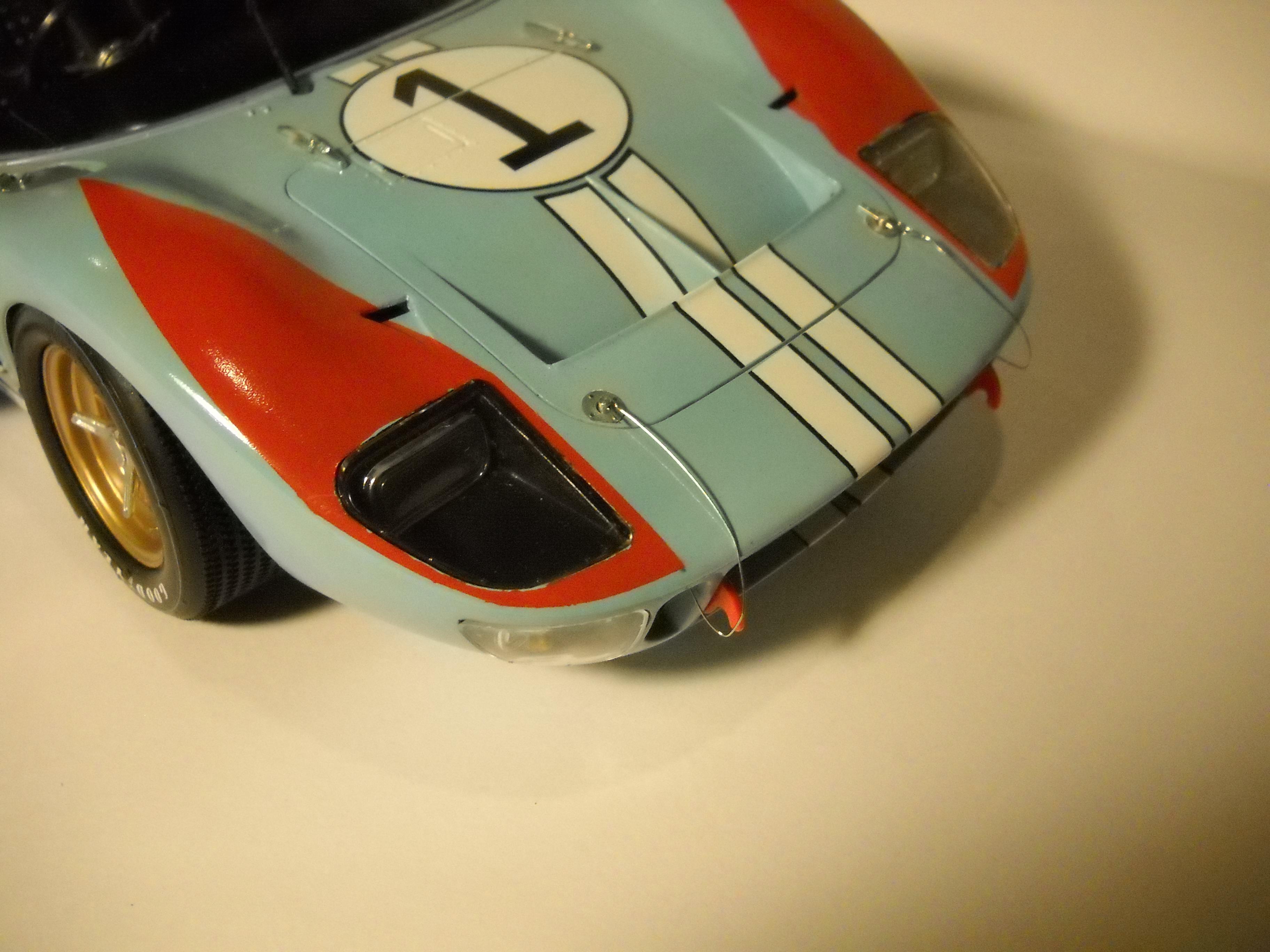

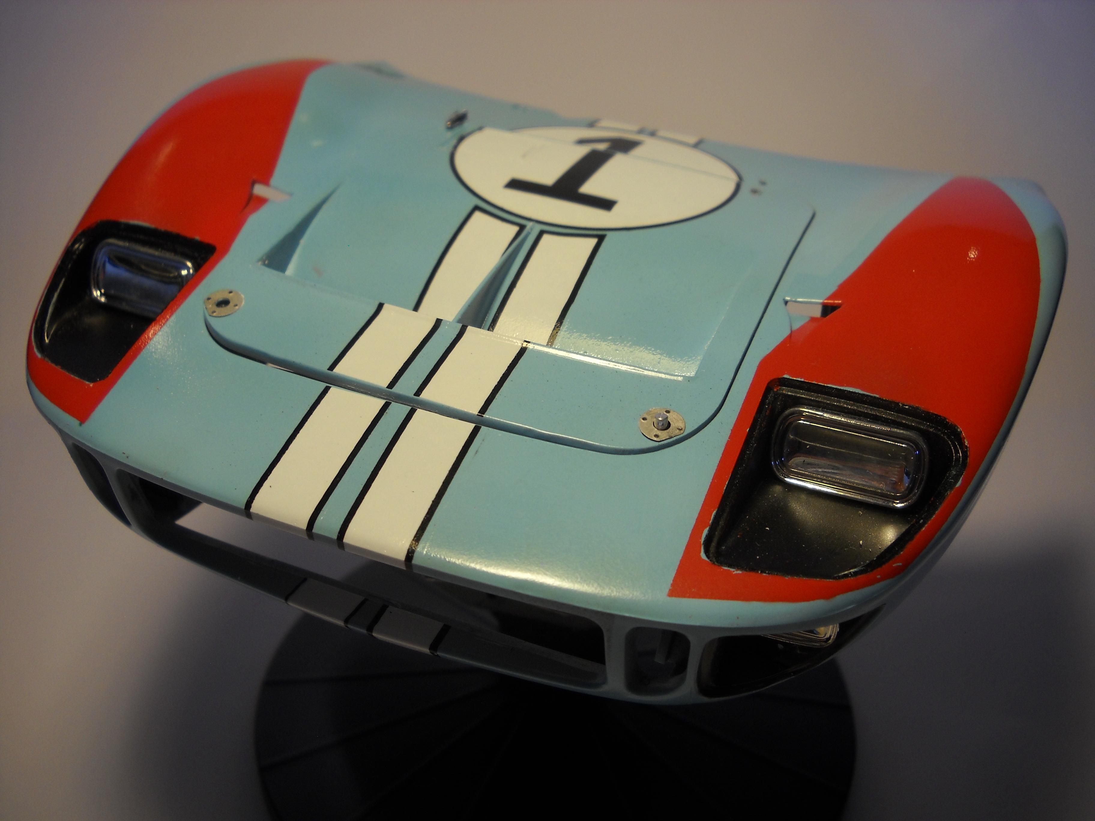

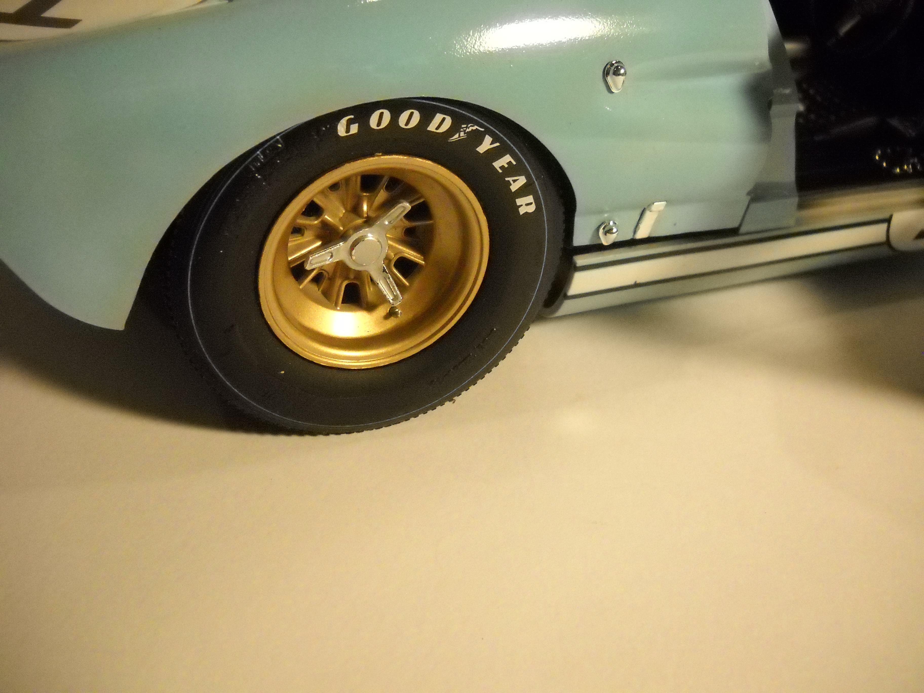

Tyres I just received the new tyre decals and i promptly changed them , as you can see these have the blue ring around and the Goodyear is in the right scale and flat color tone , this is how they really were at Lemans , i have a video with the goodyear truck fitting these tyres on rims at the race . Fit i too have a second one which i will start soon as number 2 gloss black . i advise you to first fit together the car body parts and iron out the parts that wont close properly such as the doors and rear section before you even prime , that is because there is a lot of sanding down to do , the headlights area as well needs sanding for the transparent acrylic parts to fit properly . I did'nt do that and i regret it . The flashes The 2 flashes on the bonnet are lacquer bright red by Tamiya and i did them freehand airbrush with tape and eyes , i received the stencils some days later and they look the same . its not difficult . the screws The screws holding the wheels are weak , same as the screw holding down the engine to the chassis ,i replaced with longer ones . Ignition its a shame there is no ignition set , there is space to fit one in should i find a nice one and not what i've seen so far which is a piece of round styrene cut to look like a cylinder with 10 holes drilled into it with cables supplied . you can do that yourself. Meng has a nice one but is not sold separately so far . -

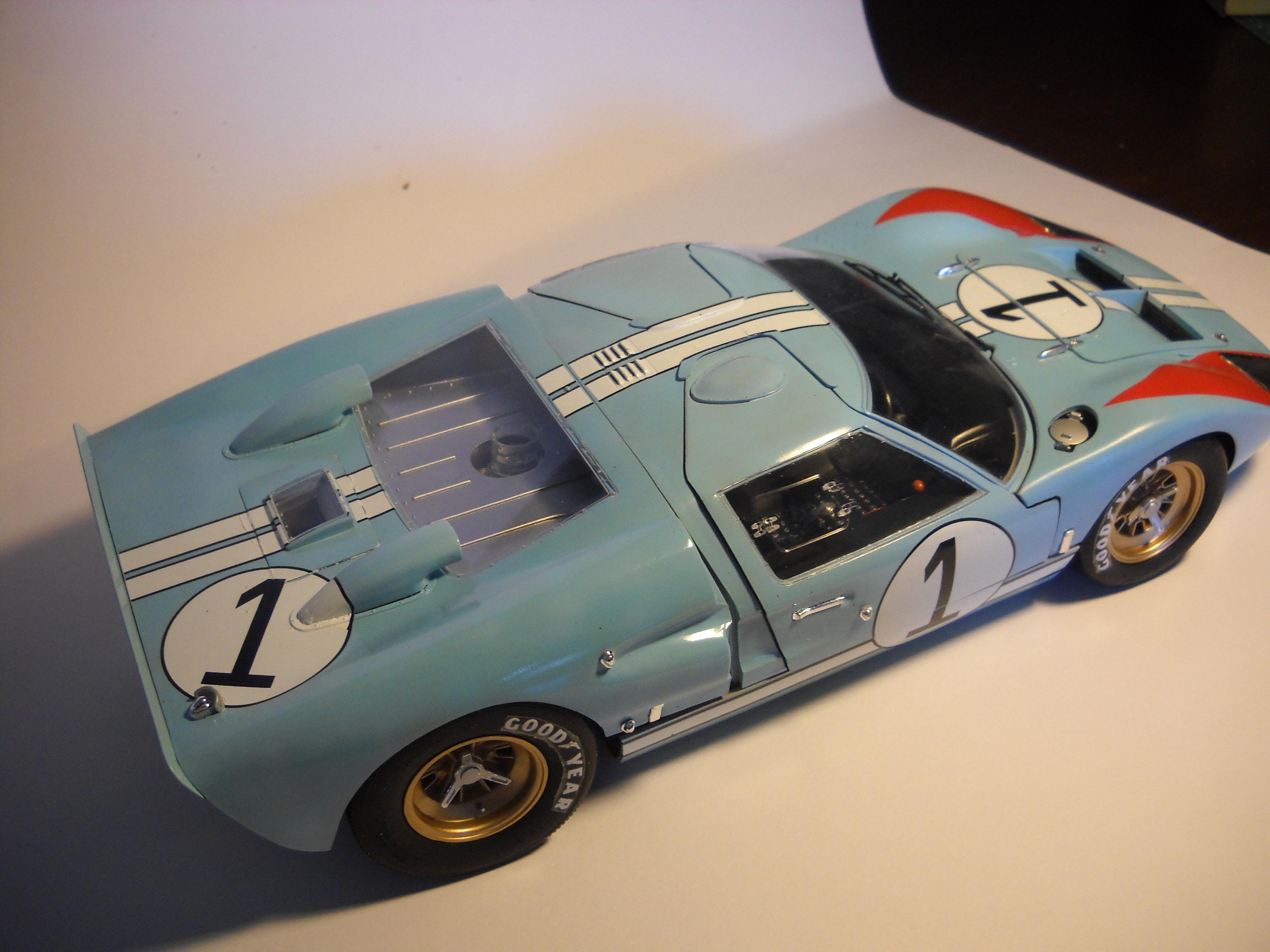

finished finally . I am looking for the electric ignition set combo to add . I might remove the tyre vinyl decals and spray paint on stencils . Have to look into the rear section not closing down on the chassis , adding windscreen wiper and rear wind shields plexiglass . -

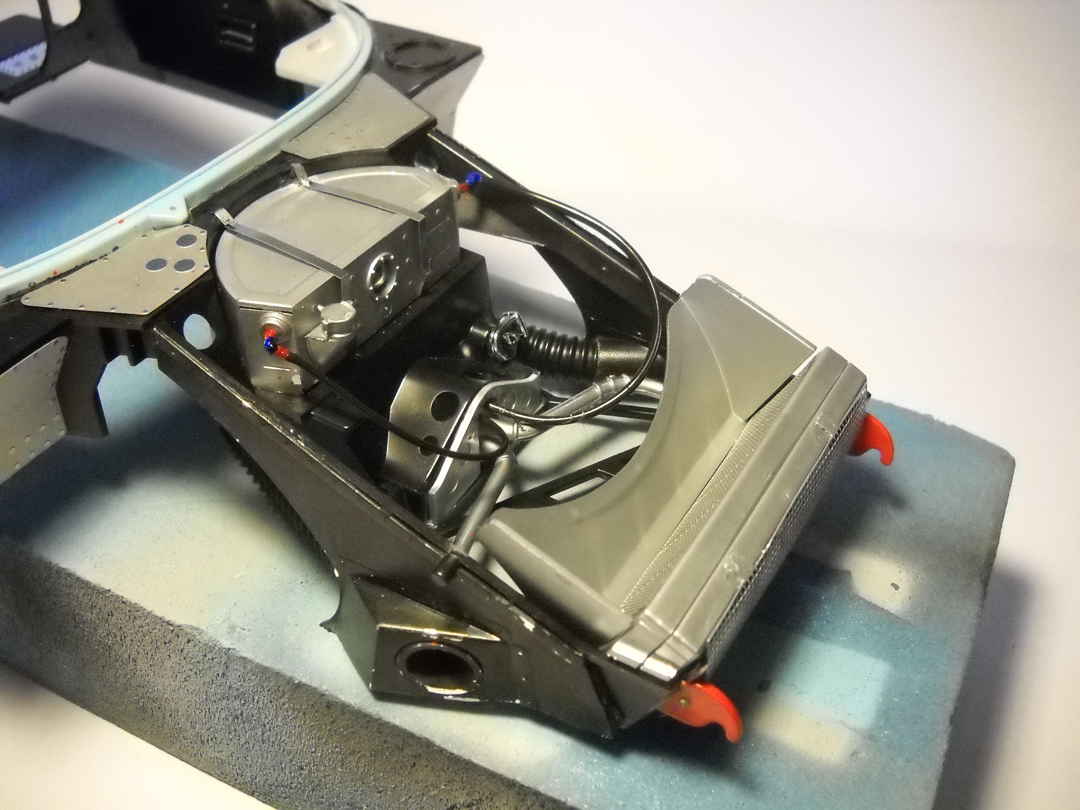

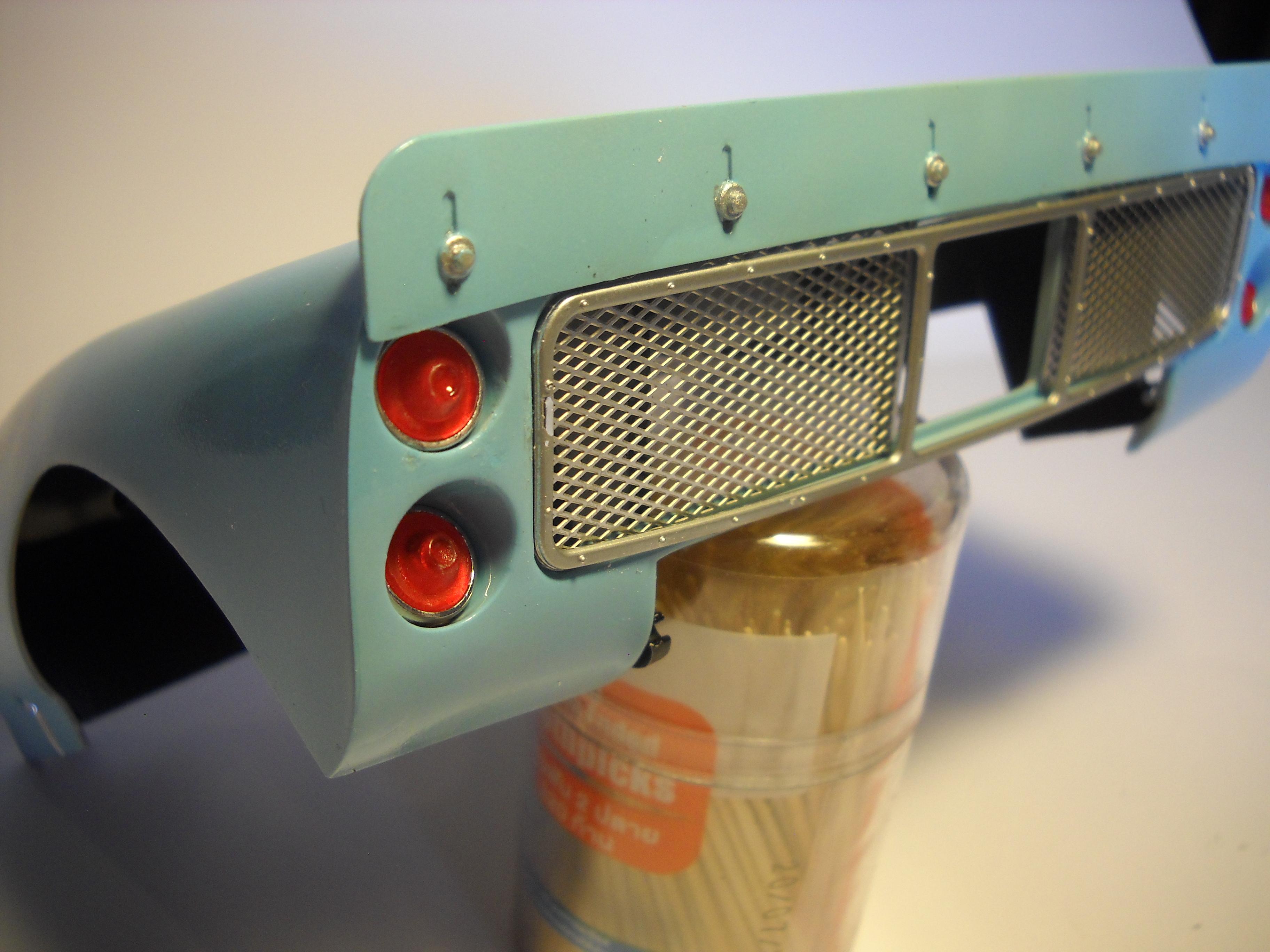

Hello i attach images off some work in progress for the above model . Please note the following so far : 1) there is no electric distributor and cables supplied . I am looking for aftermarket to drill in . 2) no fire extinguisher . 3) oil pan below the crank is false . 4) the screws holding the wheels into the wheel hubs are too small to withstand the weight . 5) the wishbones at the front are not secured on the wheel hub tips . 6) there is a gap in the engine behind the dynamo generator , 7) Both doors wont close . 7a ) the Goodyear vinyl decals are not my cup of tea . 7 b ) Too many chromed sprues . If you prime them and paint above they still wont withstand not peeling right down to chrome if you use tape above , so the best is to remove the chrome first . 8 The Ken MIles number one decals dont come with the decals or stencil for both flashes on the bonnet .
