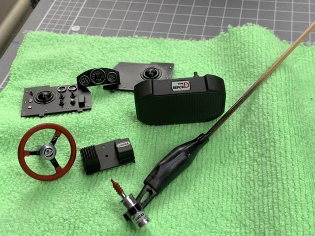

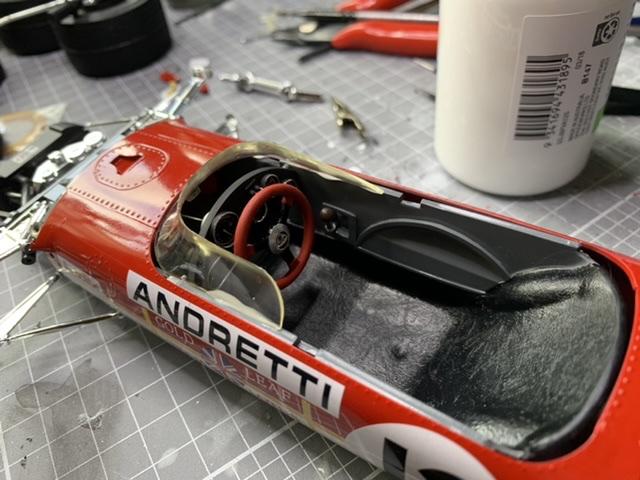

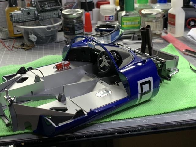

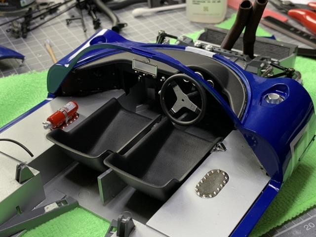

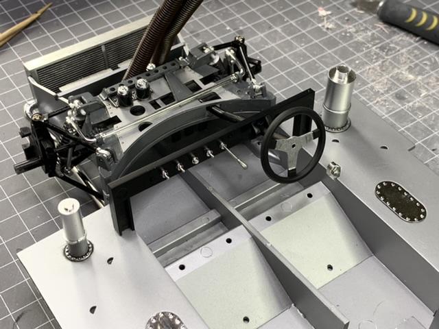

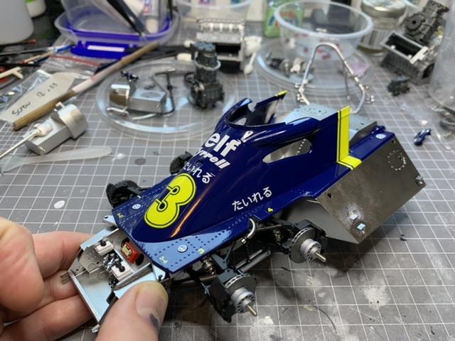

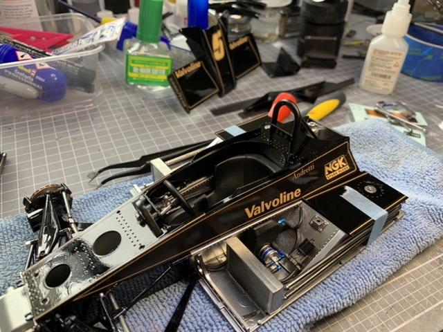

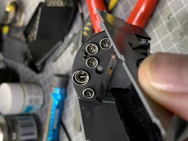

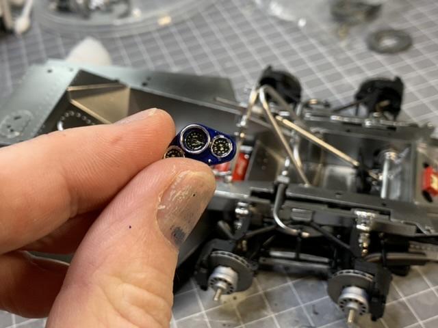

I then jumped back to building the “from scratch” kit a bit further along the process. I am mostly happy with the instruments. Not perfect but OK. Adding on the steering column and supporting structure, noting the barely sufficient clearance of the couple against the brake pedal. opening up the holes through the clear and decals. A nerve twitching process! Hope that everything is level and in place. Dry fit was good but it’s all “just fits” needing careful clipping down. it’s down and nothing mucked up! suddenly I feel the car/chassis is actually becoming a race car! Test fitted the cockpit cowl. Lovely! It’s going to look nice on the shelf!

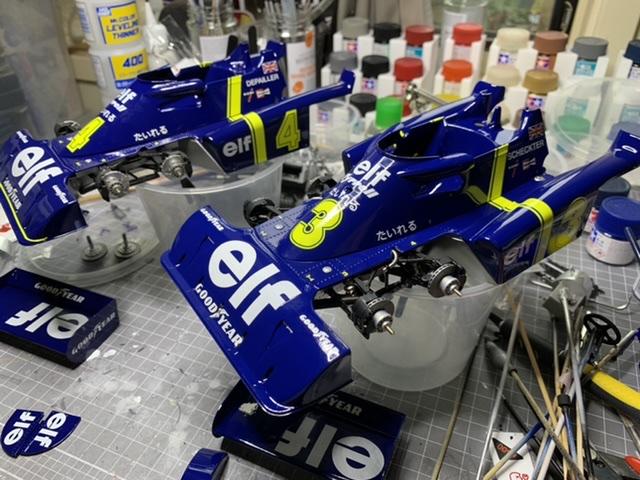

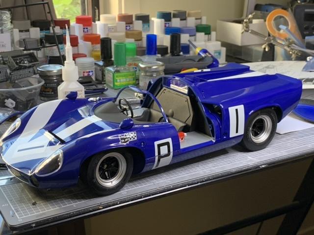

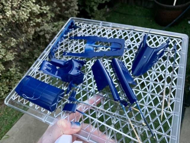

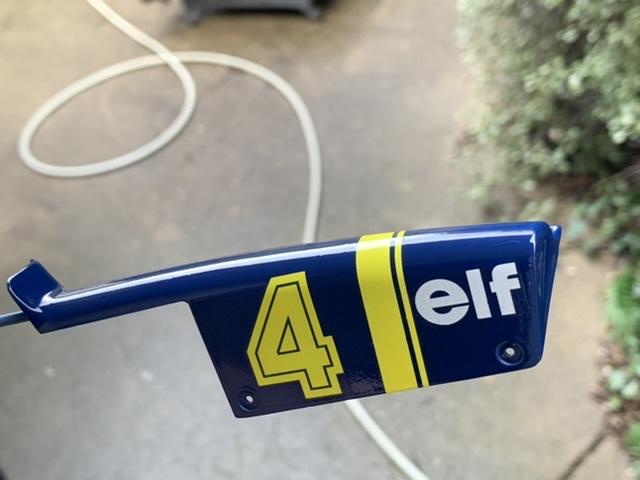

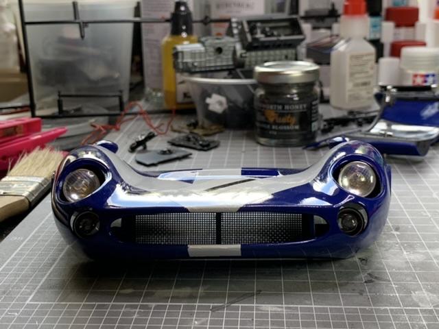

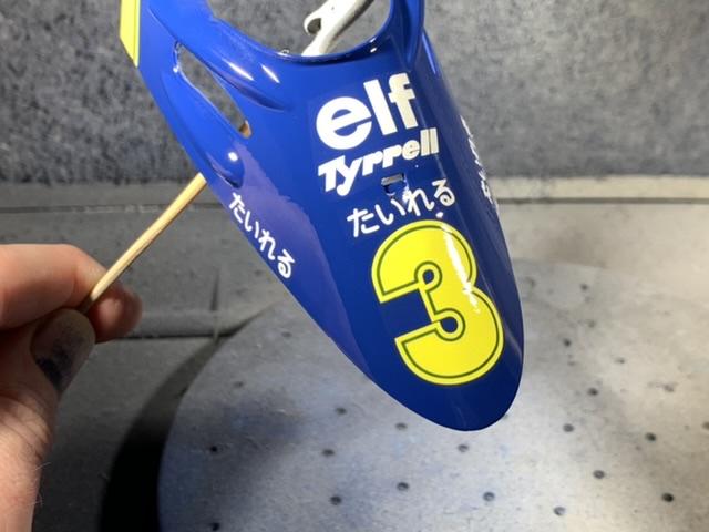

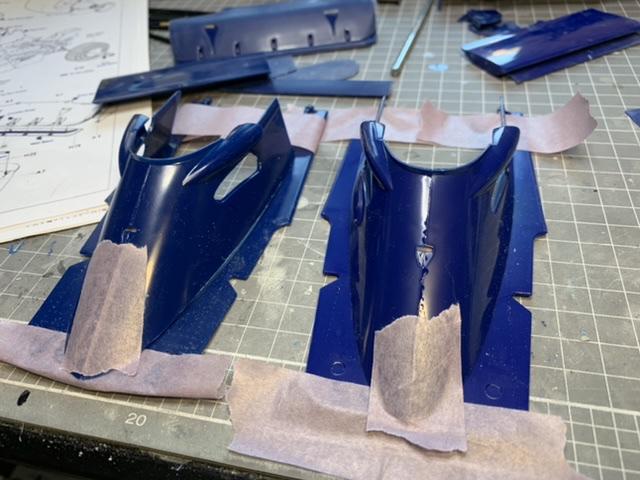

From all the pictures I’ve looked at the colour is very “on this day it looked like this” and the mix I have does exactly the same. So at that level I’m pretty happy, I do feel the OOB X3 Blue is too light by default, and the Royal Blue darkens it slightly and introduces that broad tone change as the light changes.

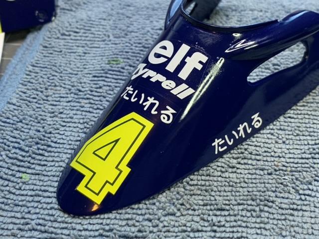

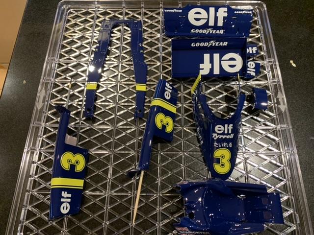

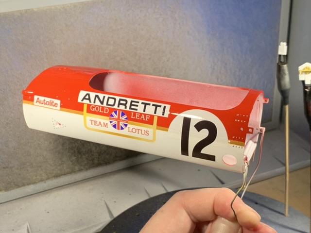

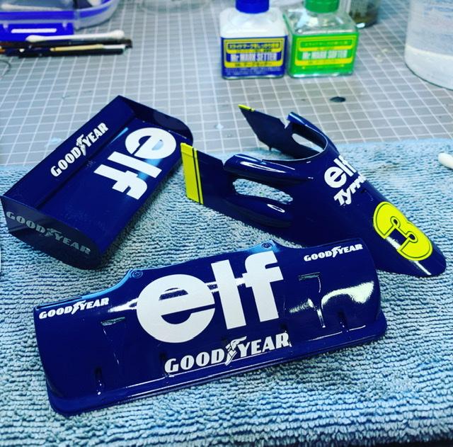

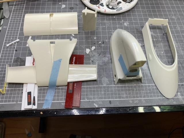

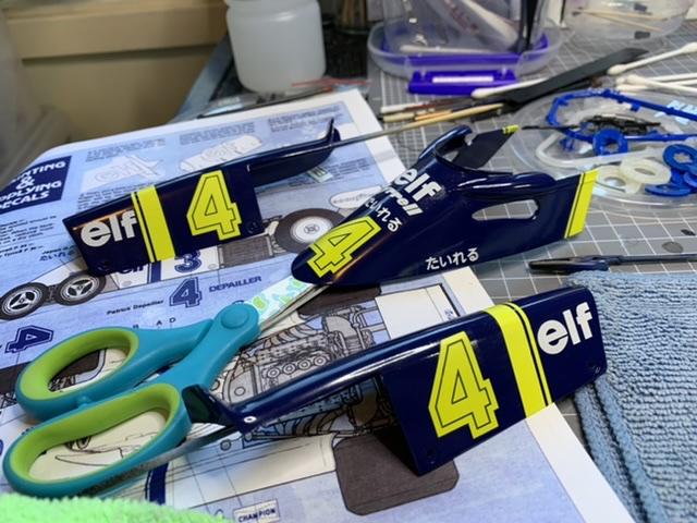

The clear cured on the first (#3) body set very nicely. That’s freed up the space to do the decals for the #4 car which is the auction will part built kit. They look ok but definitely for some reason or another having come together as well as the set on the #3. The no vent cockpit cowl is much nicer though. For an array of reasons it’s taken a week to finish the decals, but the parts I started on have dried up nicely so I was able to clear coat them. I used Zurc Mirror Gloss which is an amazingly forgiving clear and builds a really smooth hard finish with almost no effort. Recently I started stripping the chrome off chromed parts and spraying them with a more realistic silver-chrome finish. With the two chassis now up to much the same stage I’m struggling with the sheer volume of parts at play for each page of build. Wheels.. Even something simple like painting wheels becomes a wrangle! Today I built up the engines and gearboxes. Yet another variation of the DFV. I had presumed wrongly that Tamiya pretty much reused the engine sprues, they do look much the same, but every single build I have had with them there’s enough subtle changes to say they’re unique. I’m not 100% sold on the paint scheme but have followed it - the flat aluminium Tamiya LP38 (lacquer) seems just that touch too bright. Pics to come when the paint dries

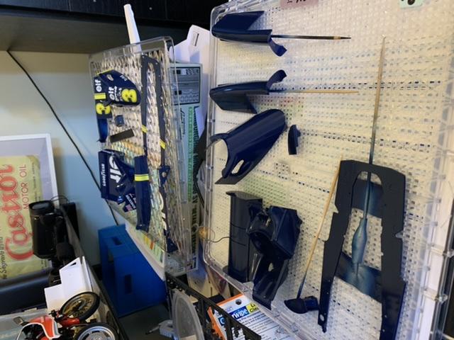

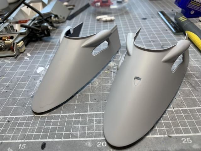

I’d seen a ModellerSite break down of colours and the mixing ratios for a lot of classic F1 cars. Noting that Tamiya colours are generally “close enough” I thought I’d use the mix and see how it came out. Tyrrell Blue is described as a 50:50 of X3 and X4 blues, and I mixed that then thinned with Mr Levelling Thinner for airbrushing. Time to start body prep. It’s moments like this where doing two at once is great. I may be making mistakes, but I’m doing the same mistake twice not making new ones Having a pet built chassis from the auction kit has allowed for testing fit and so on. One thing came up when I posted about the build elsewhere was the cowl vent. Depending on the research material the vent never existed or came and went from race to race and Tamiya simply amalgamated all the variations into a single model. I figured why not do one with and one without! While the various body parts were drying and curing their primer I started work on the chassis. I used the part built one as a key to working out what could be combined before paint and what would be done after. It then got sprayed gloss black in prep for my Zurc Hyper Silver top coat. Small parts for my chassis got prepped and painted up. Meanwhile removing the chrome plating from the next stage of build parts for both chassis revealed that the auction kit had clear plastic under the chrome and my kit was blue! Small things. I sprayed all the body parts of my kit first, aiming to get them well into the curing process before painting the next set. The juggle of trays and parts through this was consuming space, patience and painting clips. While the first body parts cured I started to add the suspension and small parts to the front of my chassis. I’m getting close to both being built to the same stage - just have to paint the brake rotors and assemble the front uprights and we will be then doing the builds fully in parallel. Im ignoring some of the missing parts. I applied the IndyCals decals to my bodywork, and while they dried out over the weekend I finished curing the auction kit bodywork. This morning I started the clear coating of all the bodywork. I’m doing two batches of painting per set, this will make it easier to manage the parts, and importantly reduces the risk of my bumping any before they’re dry enough to handle. I’m back to using Zurc Mirror Gloss Clear with an airbrush over the Mr Super Gloss rattle cans I have used for the last couple of builds. I feel the Zurc is tougher and Glossier - I can pretty much put these directly in the shelf without buffing and they’re “stunning” to most observers.

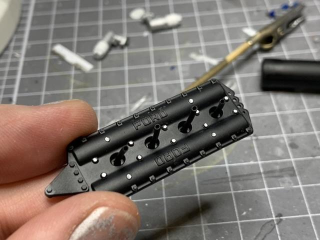

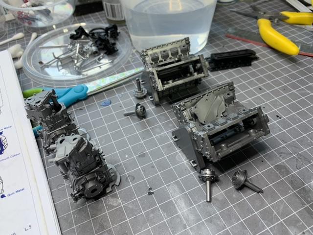

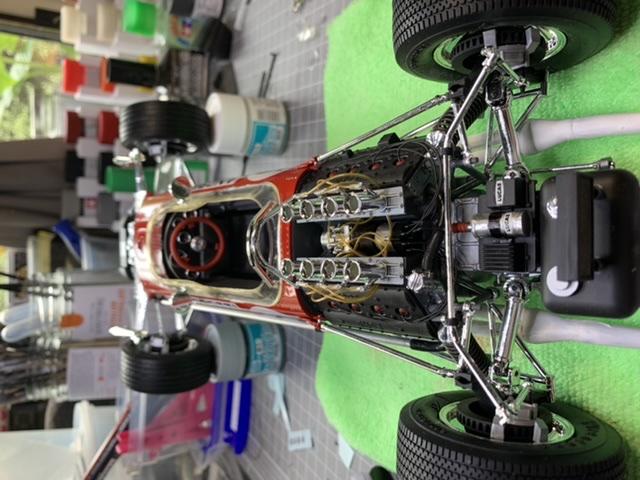

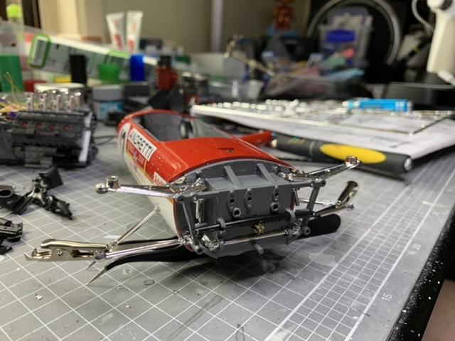

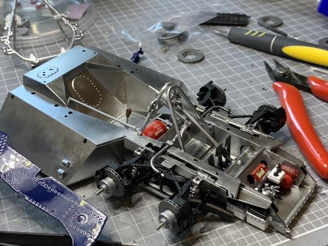

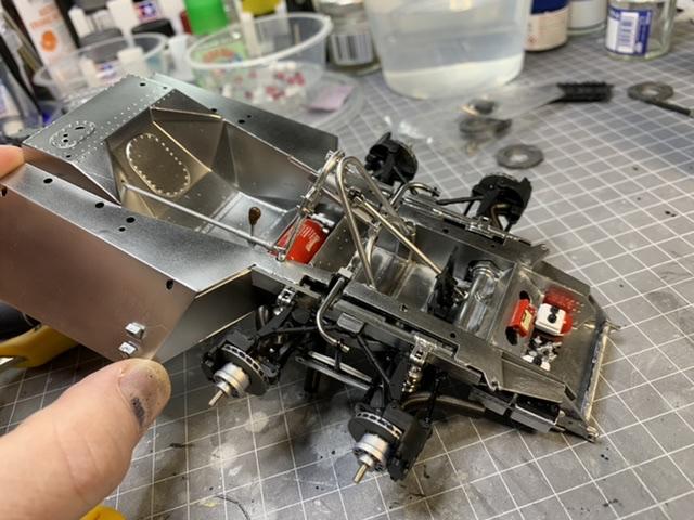

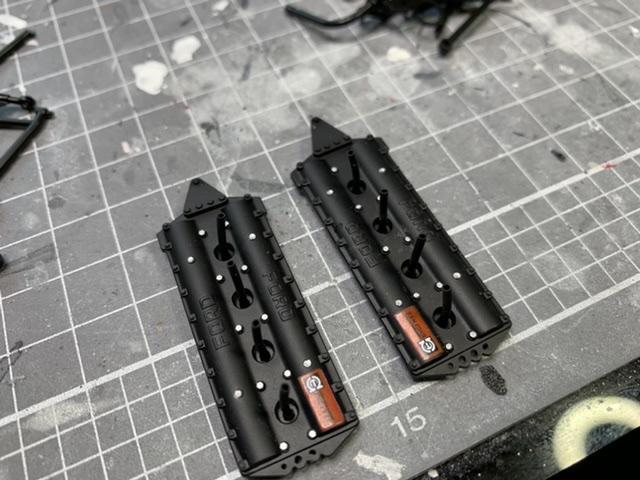

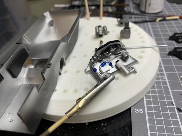

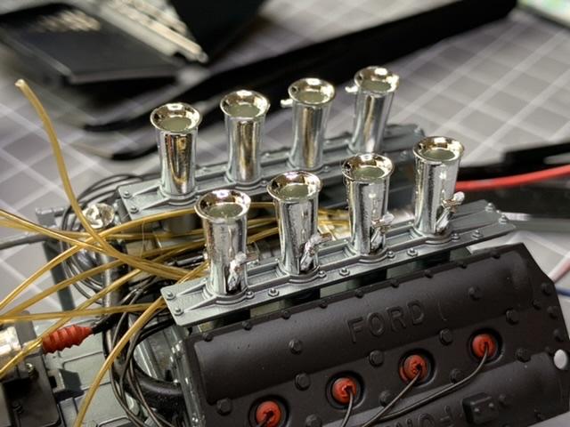

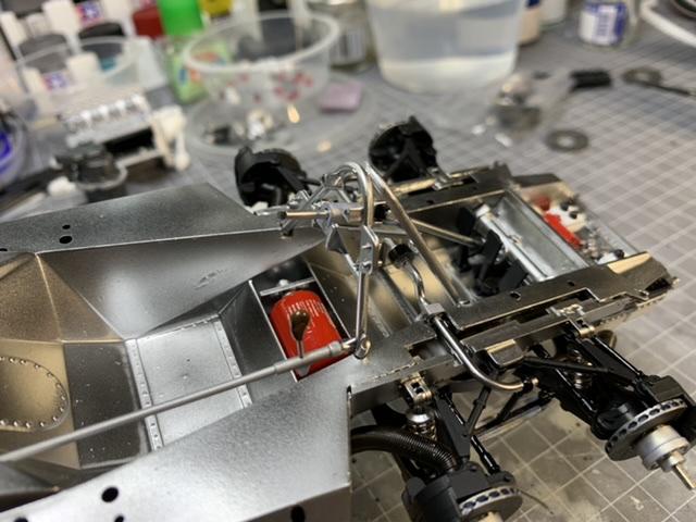

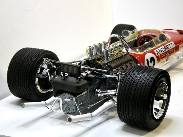

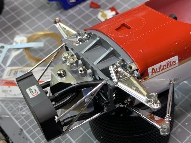

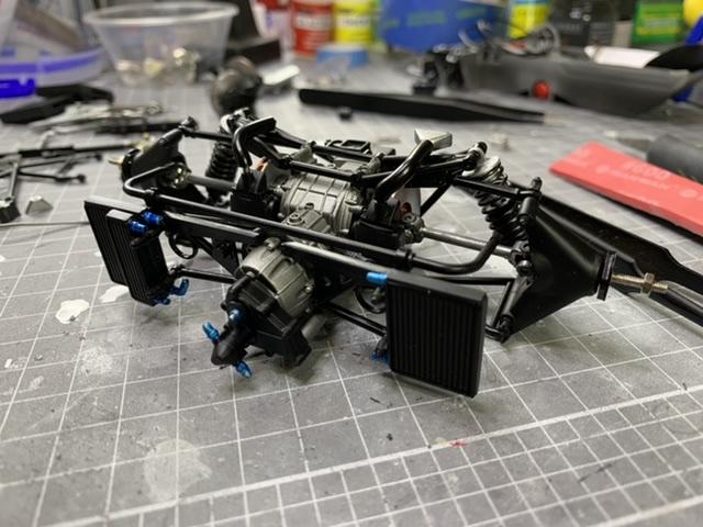

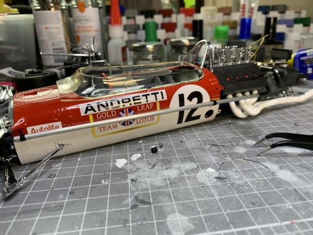

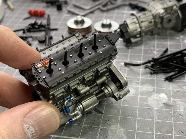

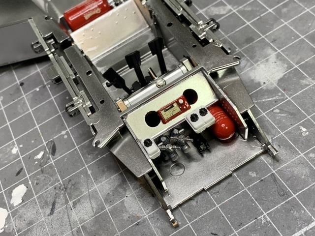

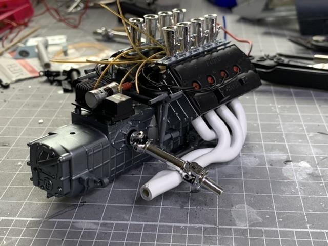

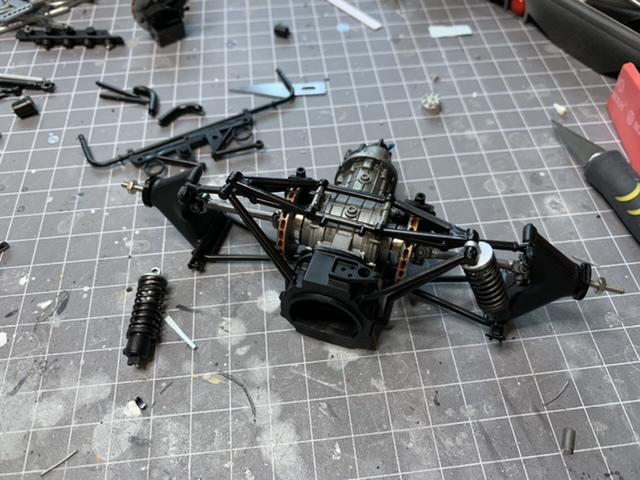

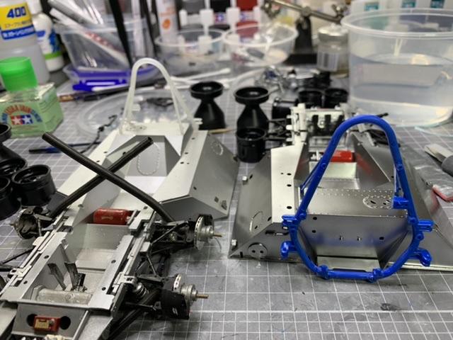

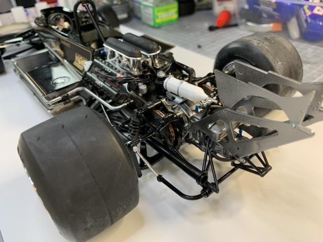

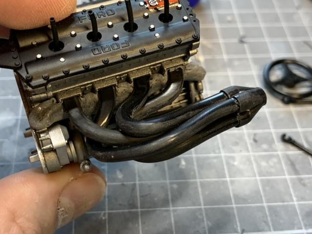

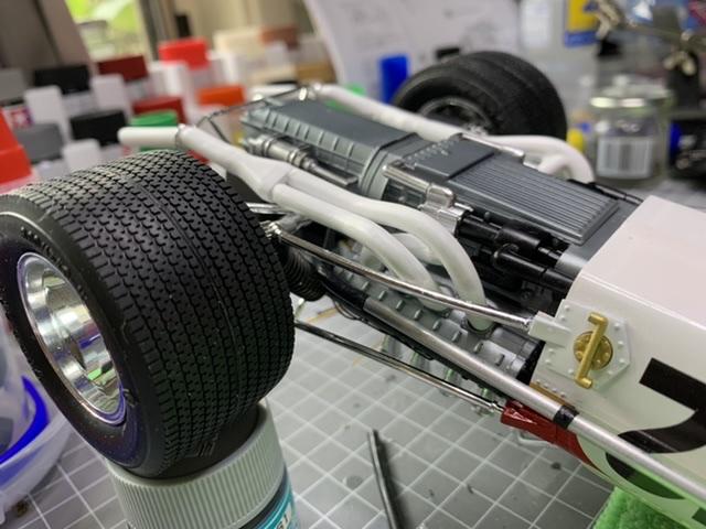

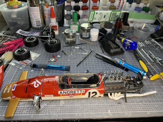

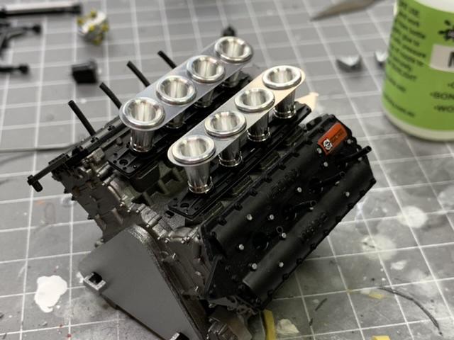

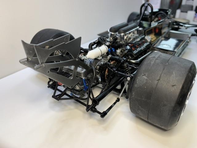

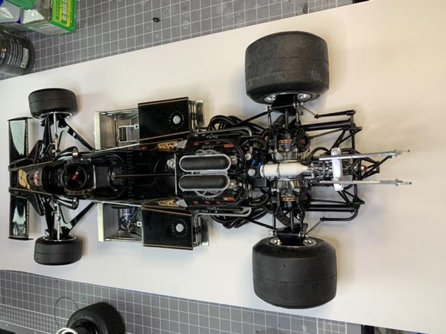

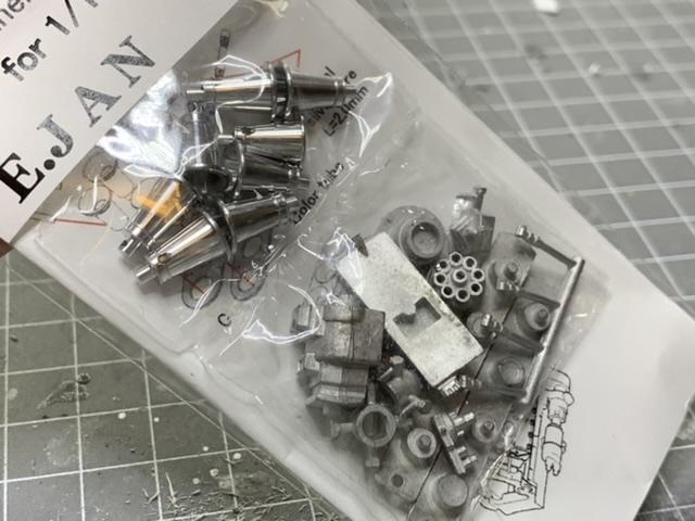

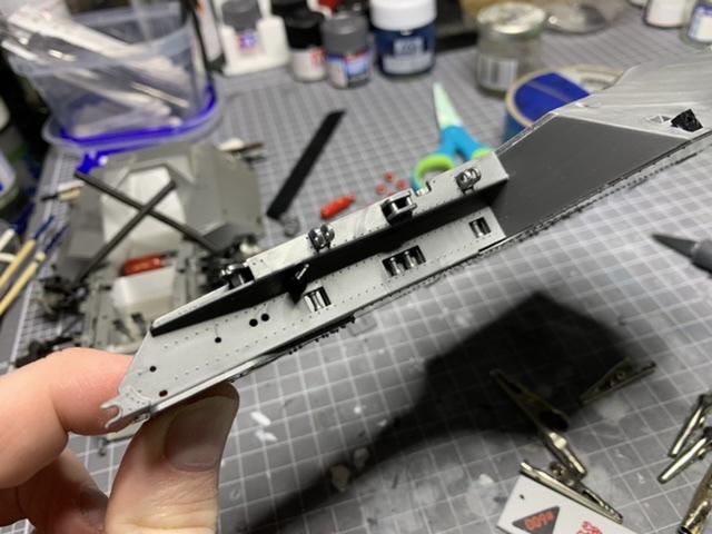

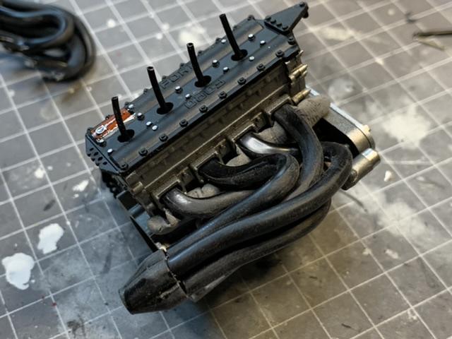

building up the gearbox. with the oil coolers mounted and anti-roll bar in place it’s nearly complete. the E.Jan alloy trumpets and matching injectors assembled and test fitting on the motor. build up the headers. Once cured they will get linked to the rest of the exhaust and then painted before being glued to the DFV radiators and rear bulkhead in place (and cockpit) loose test fit of the upper and lower monocoque, the cockpit cowl and airbox. Very happy that it all lines up.

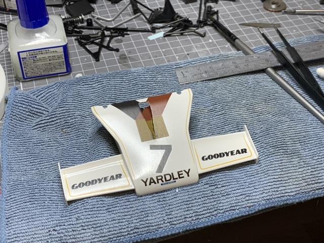

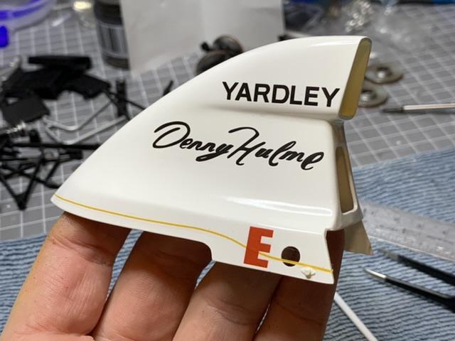

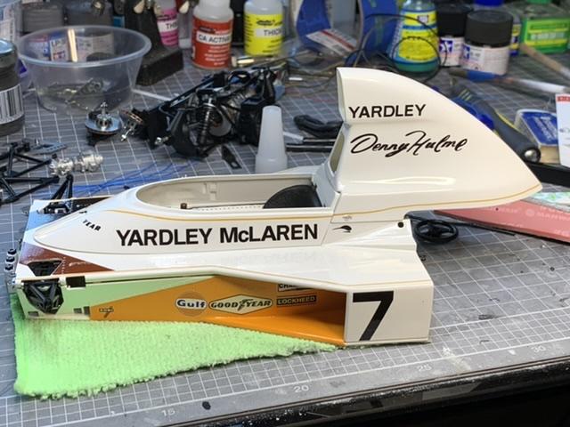

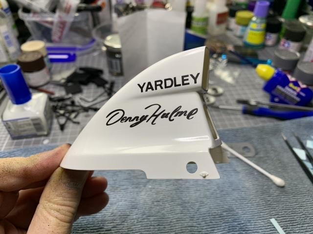

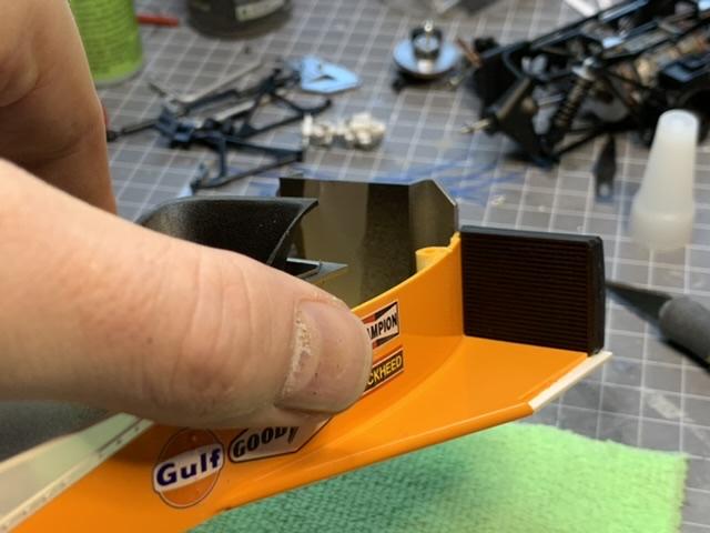

I acquired the kit (it’s a circa 1975/76 produced version) last year with a tatty box and decals but otherwise complete. So I jumped onto IndyCals and was a little amazed that I could get a decal set for Denny Hulme who raced the M23 in 1973 and 1974. Hulme was a WDC from New Zealand and was still racing in the 1990’s ultimately passing during the Bathurst 1000 touring car race in Australia 1992. This also earned the morbid title of being the first WDC to die of natural causes. The chassis is in a private collection and maintained for competition in historic racing. The Tamiya kit is a bit of a hybrid of the various body/wing/cowls from the 1973/74 seasons and races. Body parts came together very quickly I picked up an E.Jan detail kit for the engine. A few assemblies coming together So many pieces to paint. valve covers and plug wire boots (to be shortened) Cockpit tub assembled Cosworth decals applied front structure, battery and tray assembled and painted. small bits! Back of the instrument cluster Front suspension structure test fit to the cockpit tub. Engine water pump detail. Starting the rear suspension assembly Laying out the significant structures Laying down the IndyCals. Nose structure. The Papaya elements, painted in TS56 some trimming to come and then clear coat time! Nose completed with the jaunty angled race number as per the M23/1 raced by Denny. Doing the anodised pipe fittings which always make the details pop a bit.

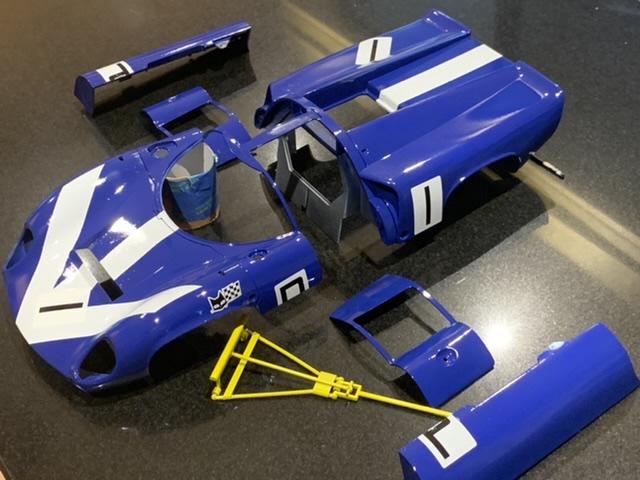

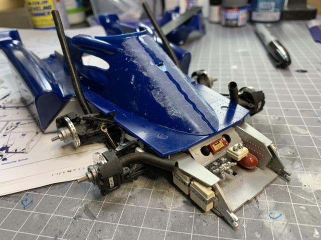

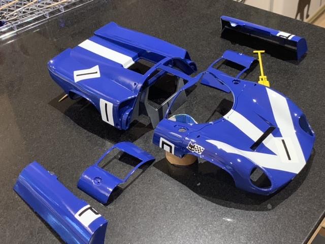

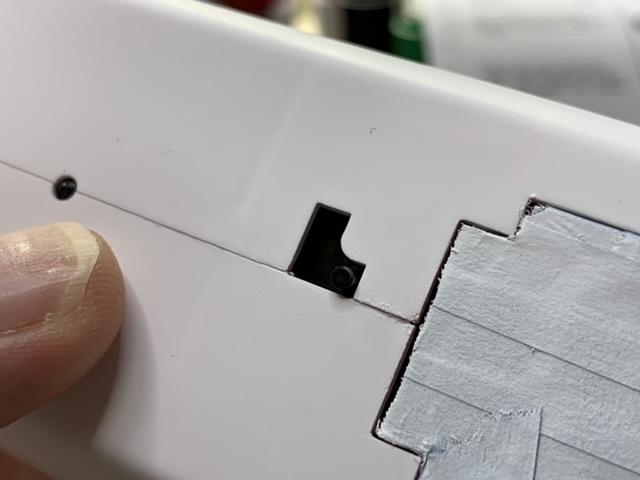

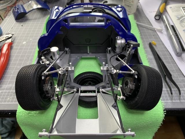

I’ve done a huge portion of the final assembly…. But… Assembly went pretty well for the core body components, and then when I started trying to tie together things like the doors, bonnet and so on it went south like most discover with this kit. Ive had to push it aside for a while as I need to approach the problems with a clear mind and deal with them progressively. For example the bonding of the inner and out door skins distorts the doors so the outer skins which aligned fine now don’t. The inner radiator grille and undertray on the bonnet foul on the font chassis structure. I won’t mention the bad luck of a few minor bits of damage trying to get some things lined up too. -

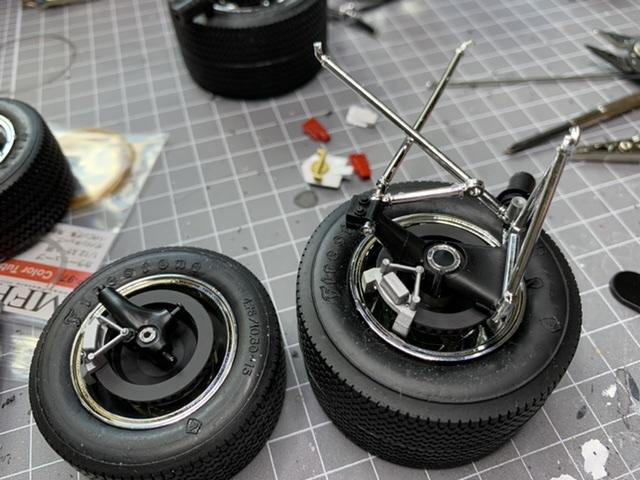

As I’ve discovered as building has progressed that I simply have lacked the patience and materials to fix enough of the issues. The kits massive reliance on the chromed plastics, which are for the most part poorly formed and some issues with the plastic itself on other sprues have made it extremely trying. Ive moved to more scale appropriate hose and wire for the engine details. The exhaust is horribly formed. I’ve got it in final paint now and still it could do will more work! Gloss clear does make things better. decal scaling isn’t quite right, but whether it would be IndyCals (these) or Tamiya doesn’t matter. The fact that it seems no one kit, instruction or model locates the diving stripe the same doesn’t help.

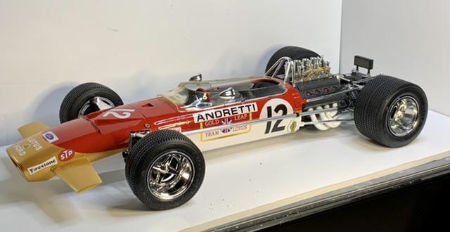

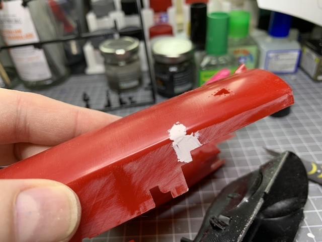

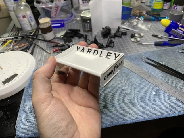

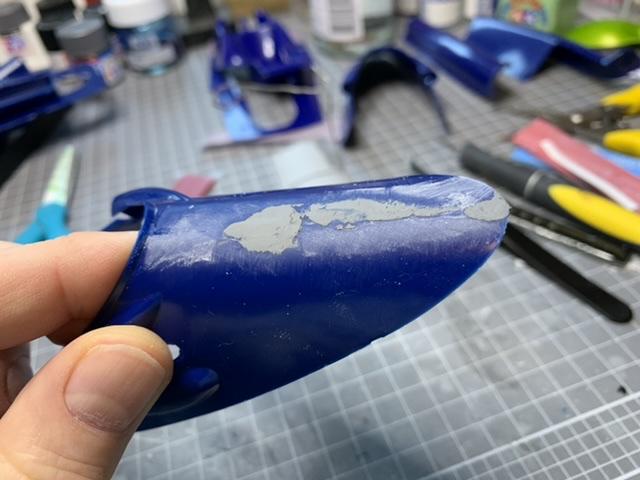

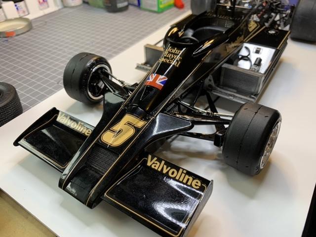

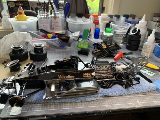

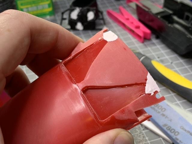

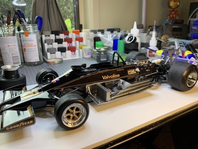

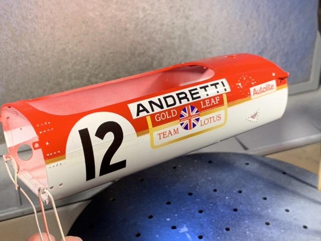

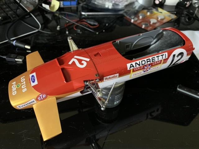

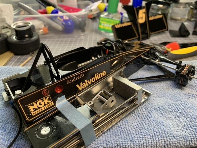

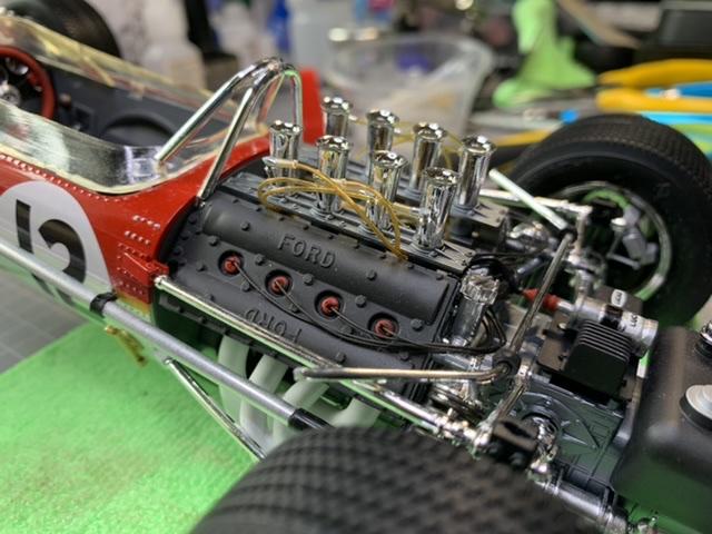

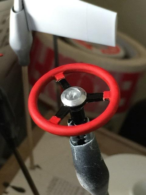

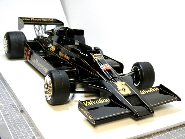

Engine/Gearbox painted, it’s Zurc Pewter Silver which gives a good pressure cast-alloy look. Steering wheel painted, I took some liberty with the colours but with the Lotus decal set in the center it does look good. Gloss white applied. This is the broken side piece, no trace of the repair has shown through so I’m quite elated! Doing small decals for the Lola build and this Lotus. While I have IndyCals for the body the sheet didn’t include some of the. Small engine and accessories decals, so I was pleased that the 50 year old decal sheet is still good. Im now tempted to use a combination of the Tamiya and the IndyCals to finish the bodywork.

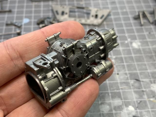

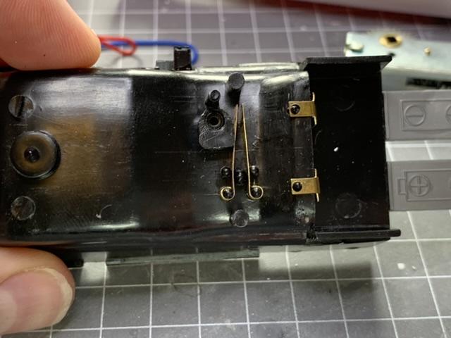

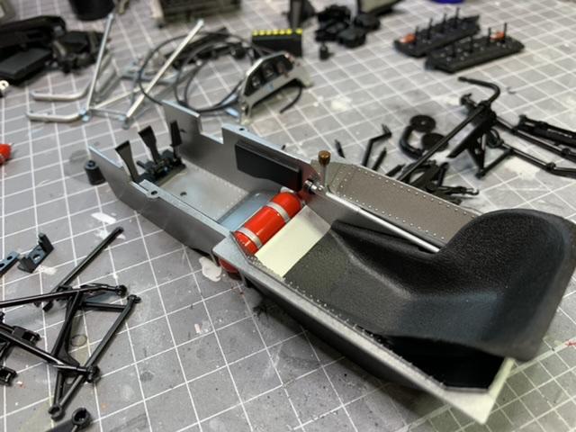

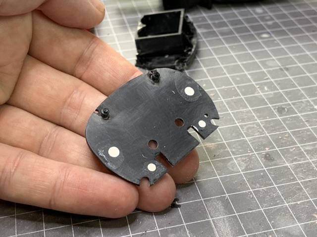

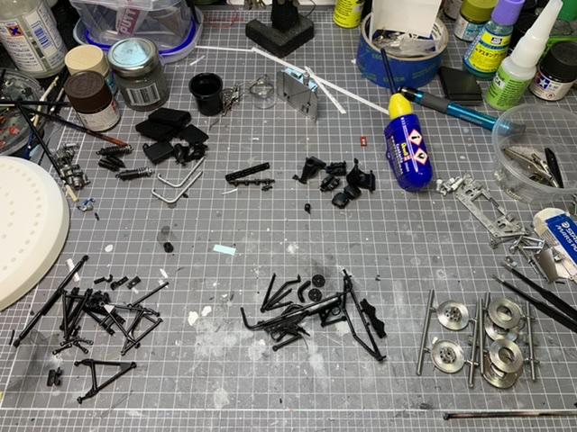

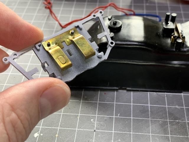

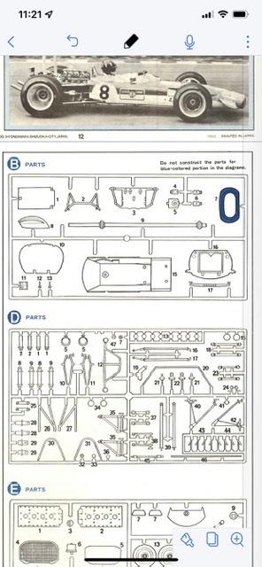

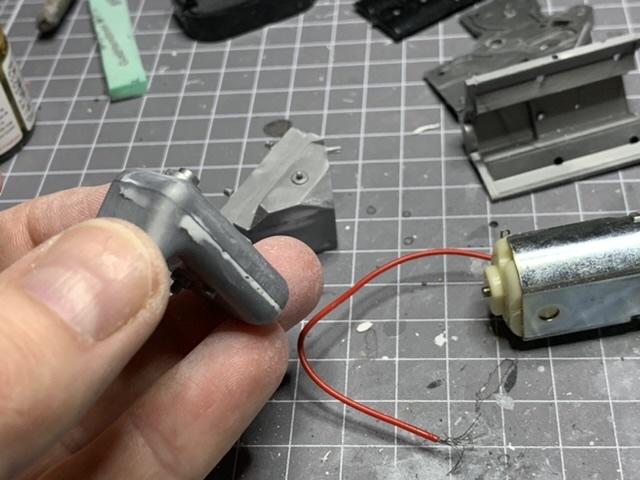

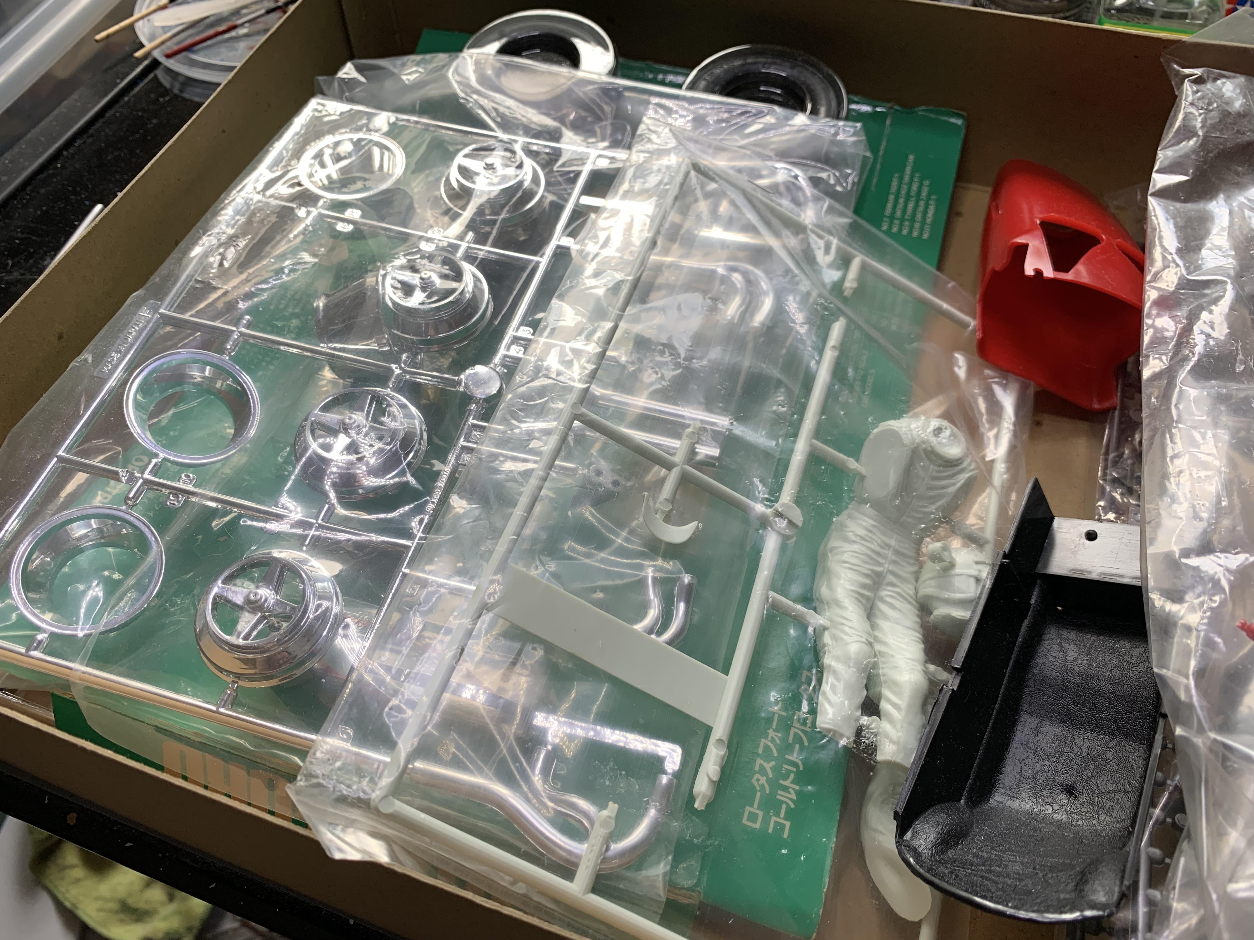

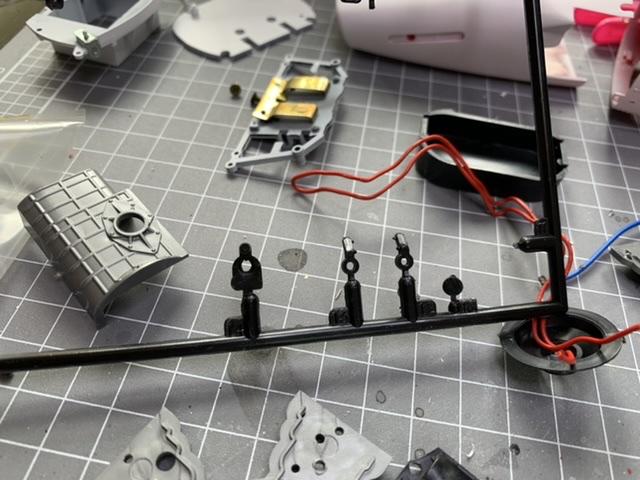

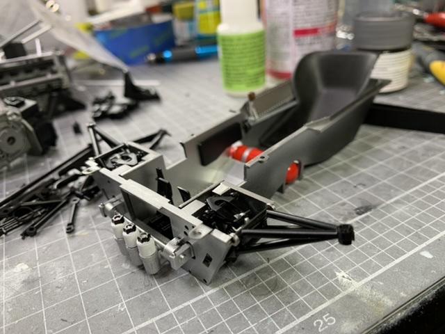

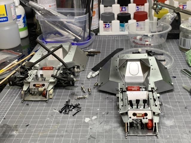

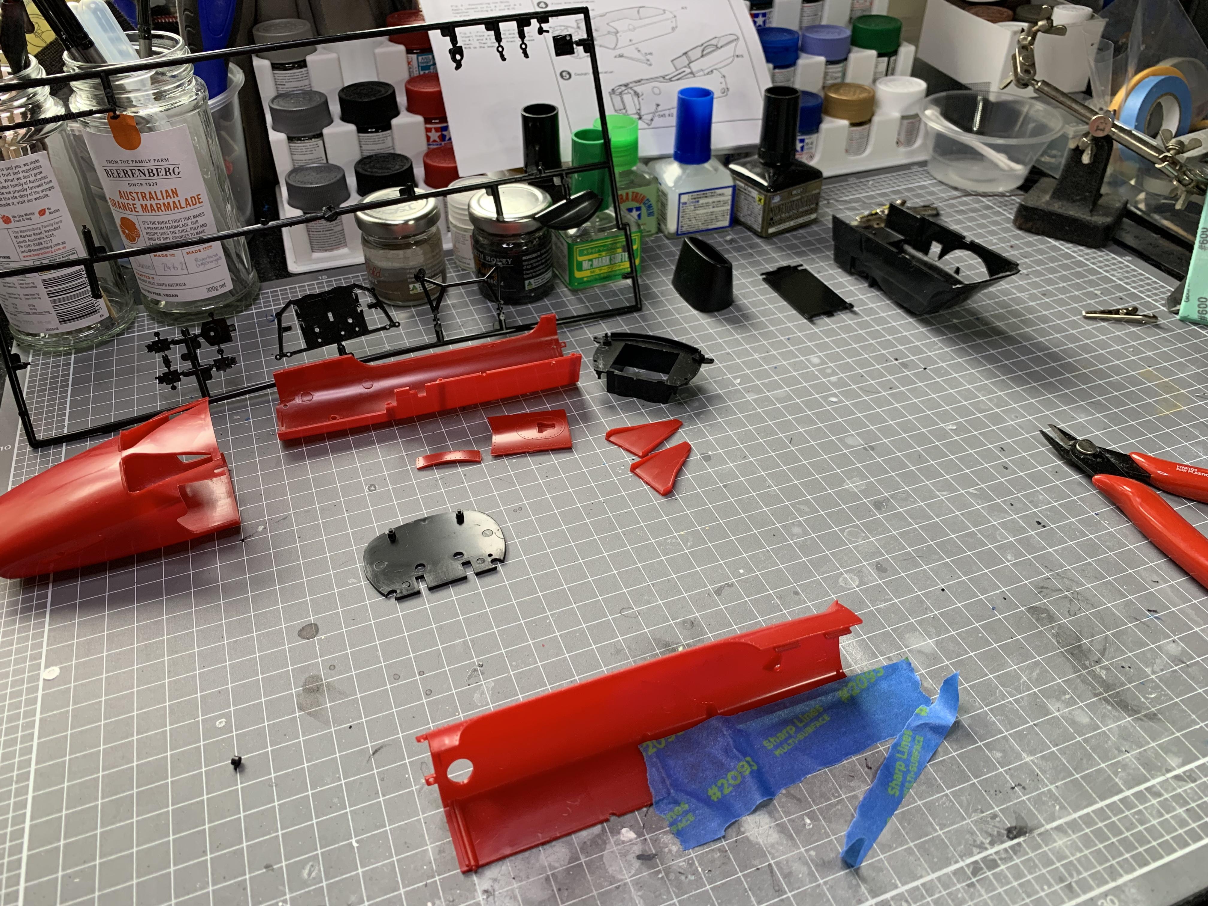

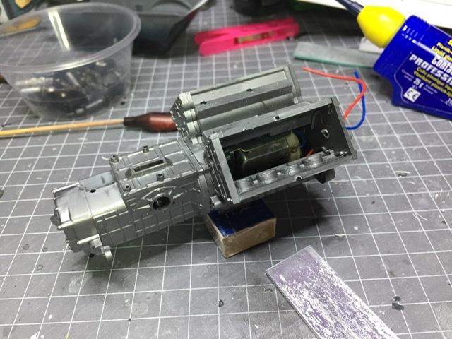

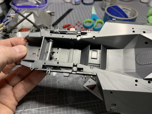

I’m starting to get a better grasp of just how much more effort I’m putting into this build. I think because the kit is a touch over 50 years old and because it was broken up so badly in its box I want to make it right. Every time I need a small part I have to tip out the loose parts tub. Right now I was doing this to find the parts that make up the motorised function. It’s not covered in the instructions I downloaded so this is pure guesswork! There’s two parts on this sprue B that aren’t in the diagrams in the instructions. And they form the switch! Thankfully that process of elimination and good luck means I have a switch! Working out the switch construction was another problem to overcome. The end contacts of the battery box are attached to the front bulkhead. Note to self: glue that thing in good! Switch pokes through the odd shaped cutout in the floor. Now that I know how the switch goes I get to do a better job in that seam Also have to work out the motor and gearbox assembly process. I decided to build from the gearbox as the casing has pins that located on the mechanical system. Then I’ll build the motor around the motor! Bulkheads are painted in a grey. This was pretty common in the era, with steel and alloy substructures painted in a heavy grey gloss. I presume they would wipe a dye over periodically and any cracking would show up. the same grey is used on the inner cockpit. Some instructions/guides say black, others Aluminium and others grey. Photos from the period show it to be any one of the three. I’ll still do the seat matt black. Coolant tank assembled. oil tank assembled.
I’m persisting with the Time Lapsing. https://youtube.com/playlist?list=PL2KdmnSb1UyKZvkhqF7DrfICxrdya7OFC It’s intriguing to me how much time I spend handling parts feeling for edges and rough bits. Admittedly this build is being done to a better standard again than my previous ones. Much more deliberate progress, I guess the low part count and simplicity mean poor attention to detail will stand out!

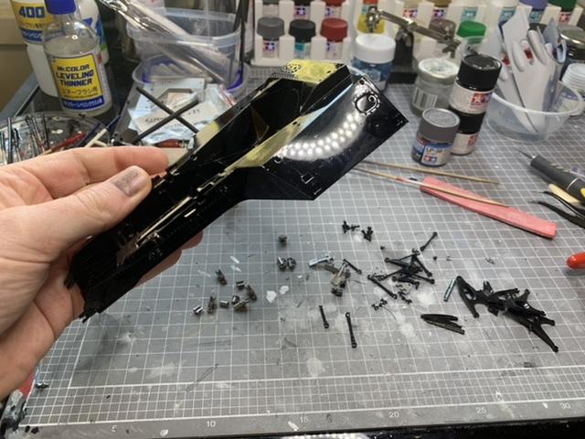

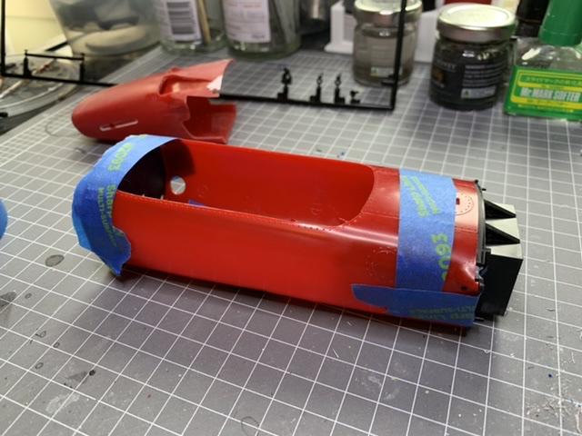

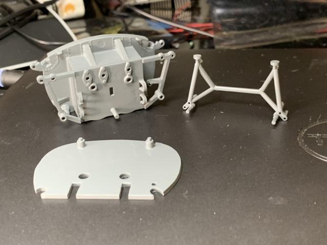

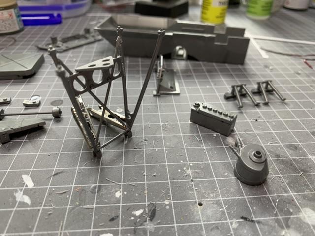

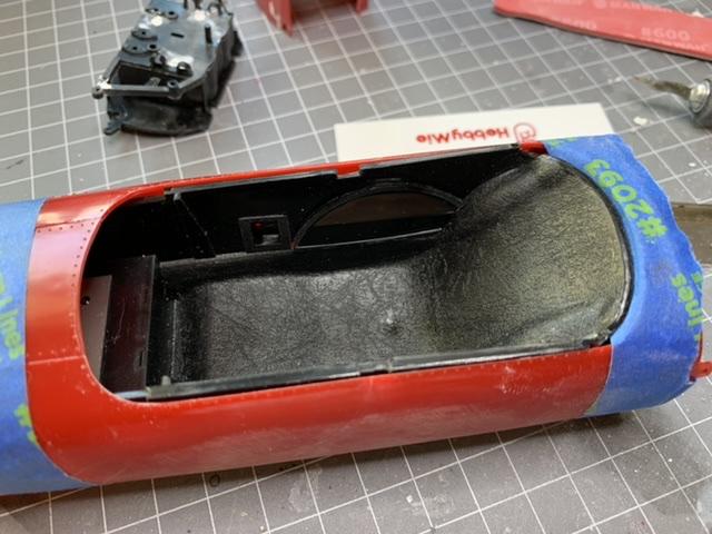

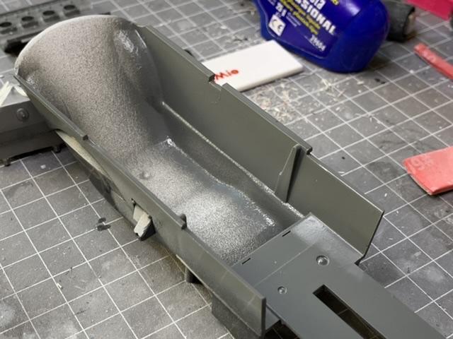

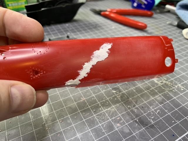

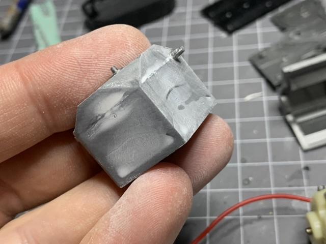

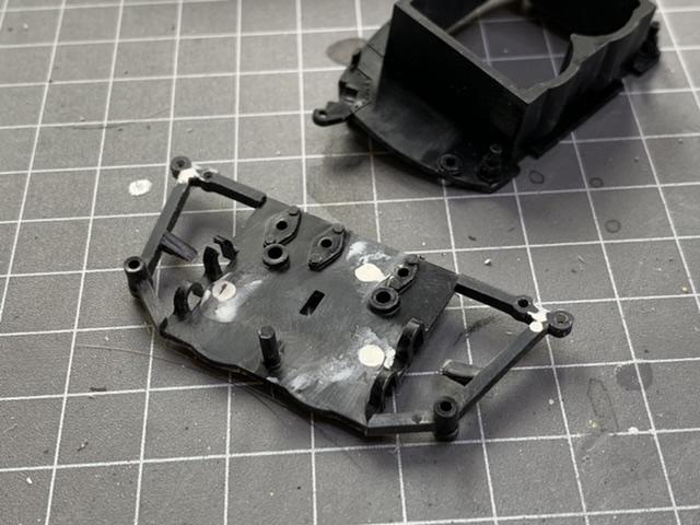

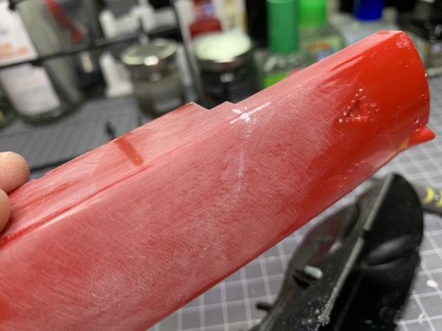

Progress has been continuing. Once the split chassis had cured together I ran a bead of thin cement over it and gave a jiggle in the hope that any small gap sections would draw in the cement and meld together. Then after that was sanded off a skim of putty applied. More sanding and it looks and feels really good. Priming will be the real test. The rear bulkhead had a couple of ejector marks filled and had been sanded flat. Front bulkhead ejector pin marks and some roughness from the mould has been filled and sanded. The opposite chassis side had a small sink that matched the filled sink on the other side. So this got filled. I’m less concerned about the underside as there’s a batter door in there too! The two halves and their insert pieces could be glued. The bulkheads used to hold the shape but not being glued in yet. Ducts glued into the nose cone. A sink/deformation across the tip was also sanded out. A little filler to help integrate the finish of the ducts Sanded to the bits that count. Test fit of the cockpit inner.

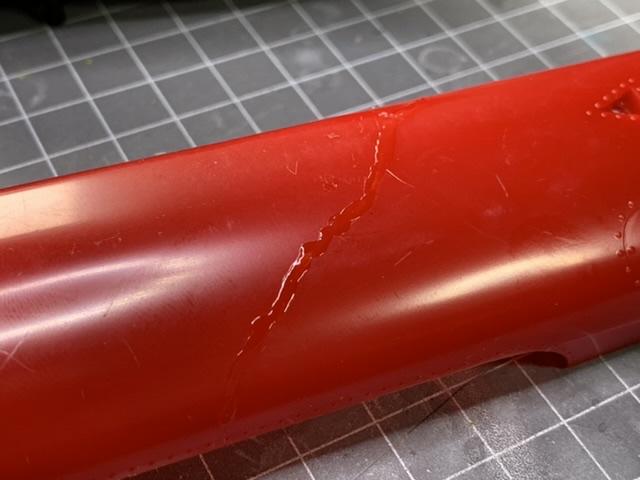

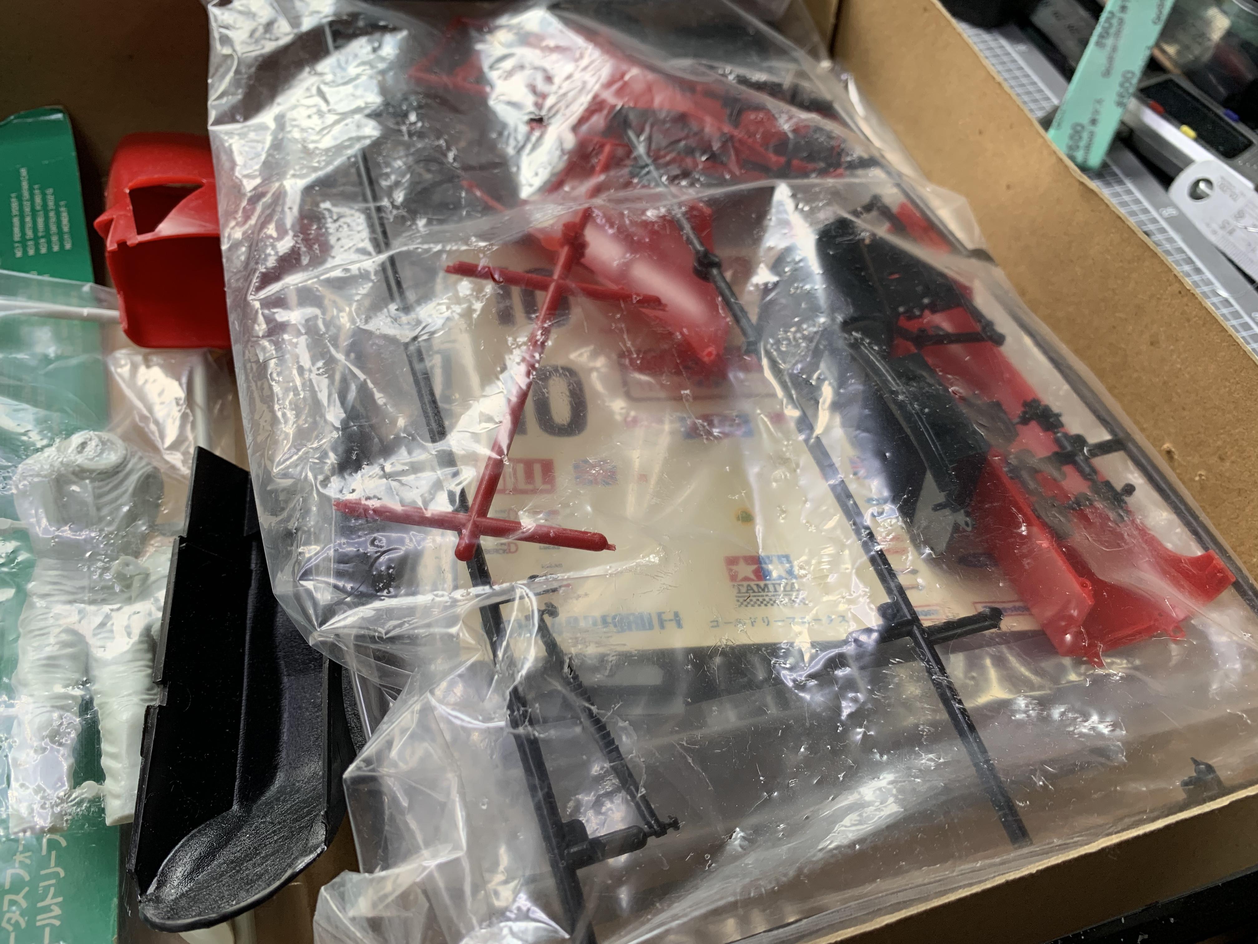

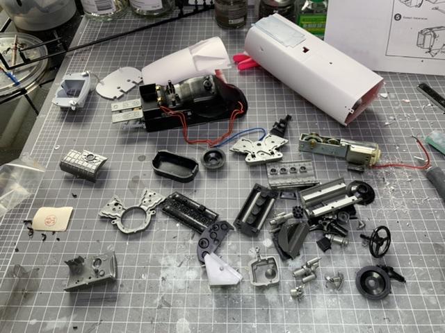

Following on from my recently completed Lotus JPS Mk3 build I thought I’d pull out my very beaten up box purchase from last year. The box is falling apart, and it has no manual so this will be fun. I did grab a copy of the manual, but it’s for the later non-motorised version. Oh we’ll make it up as we go! Doesn't look good in there! So many loose parts! But nothing loose in the box so hopefully the bags have caught it all! Step 1. Glue the snapped piece together! I’m also experimenting with time-lapsing this build. https://youtu.be/WyDGyQ8DGyM

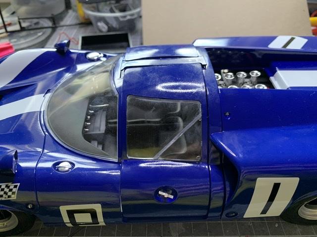

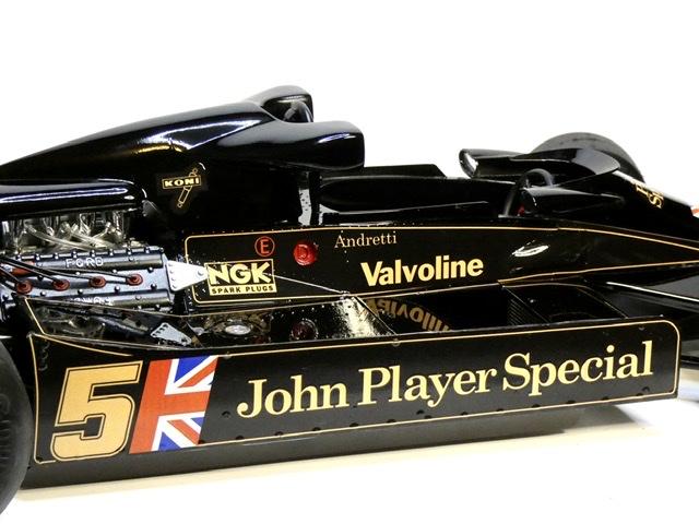

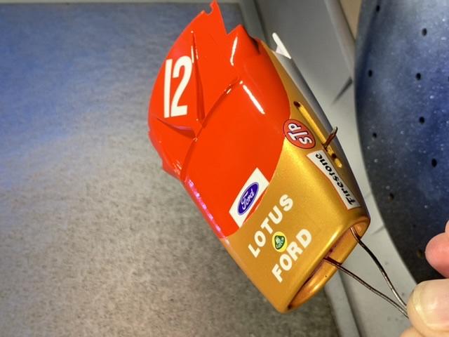

The clear coated body sections. Decal application has some issues but I’ll wear it. overall fit and finish is pretty good and in a couple of weeks (after a few more hours in the dehydrator curing the clear) I think I’ll be proud of it. (And it’ll have been a 4 week ish build) -
