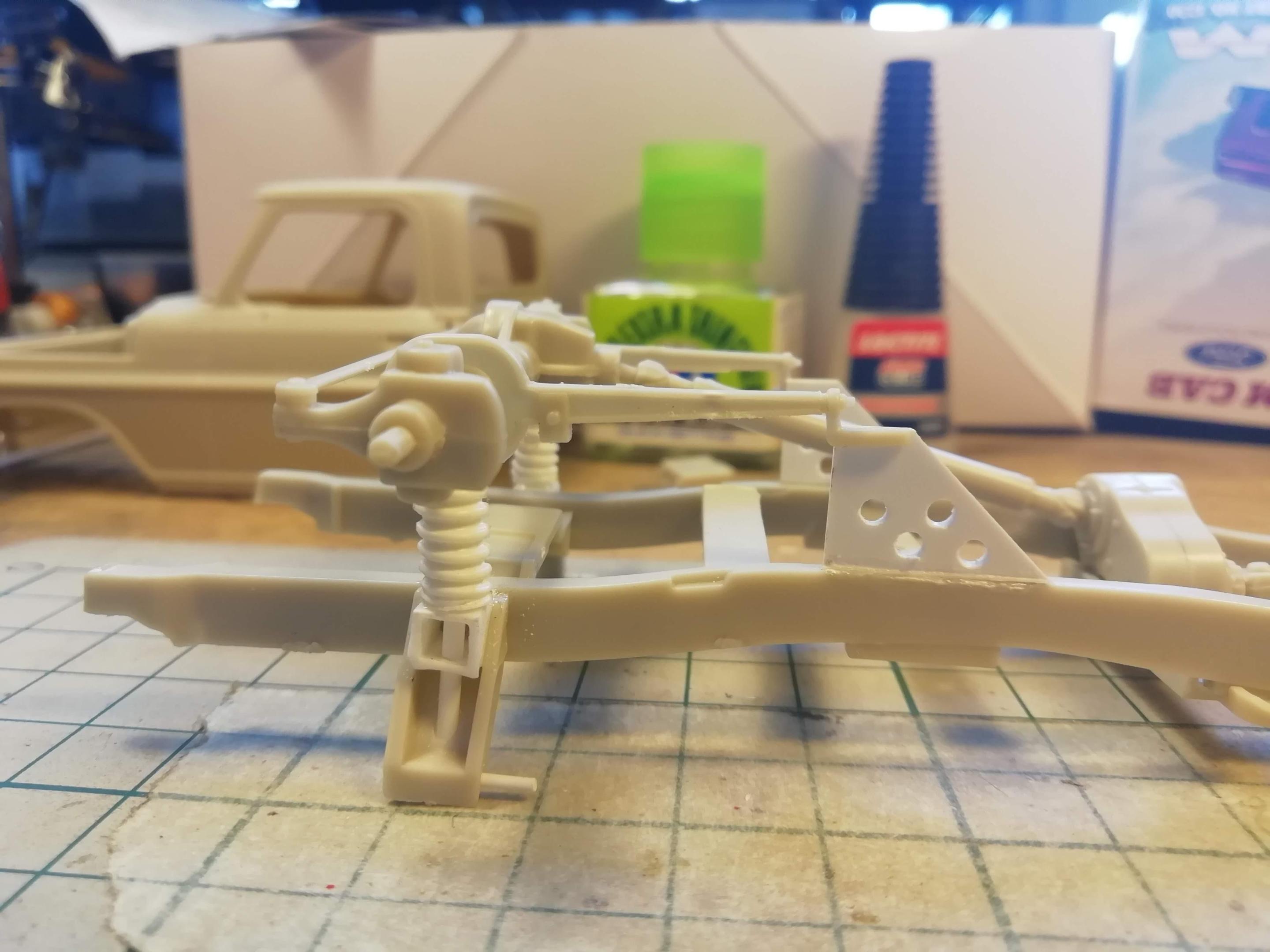

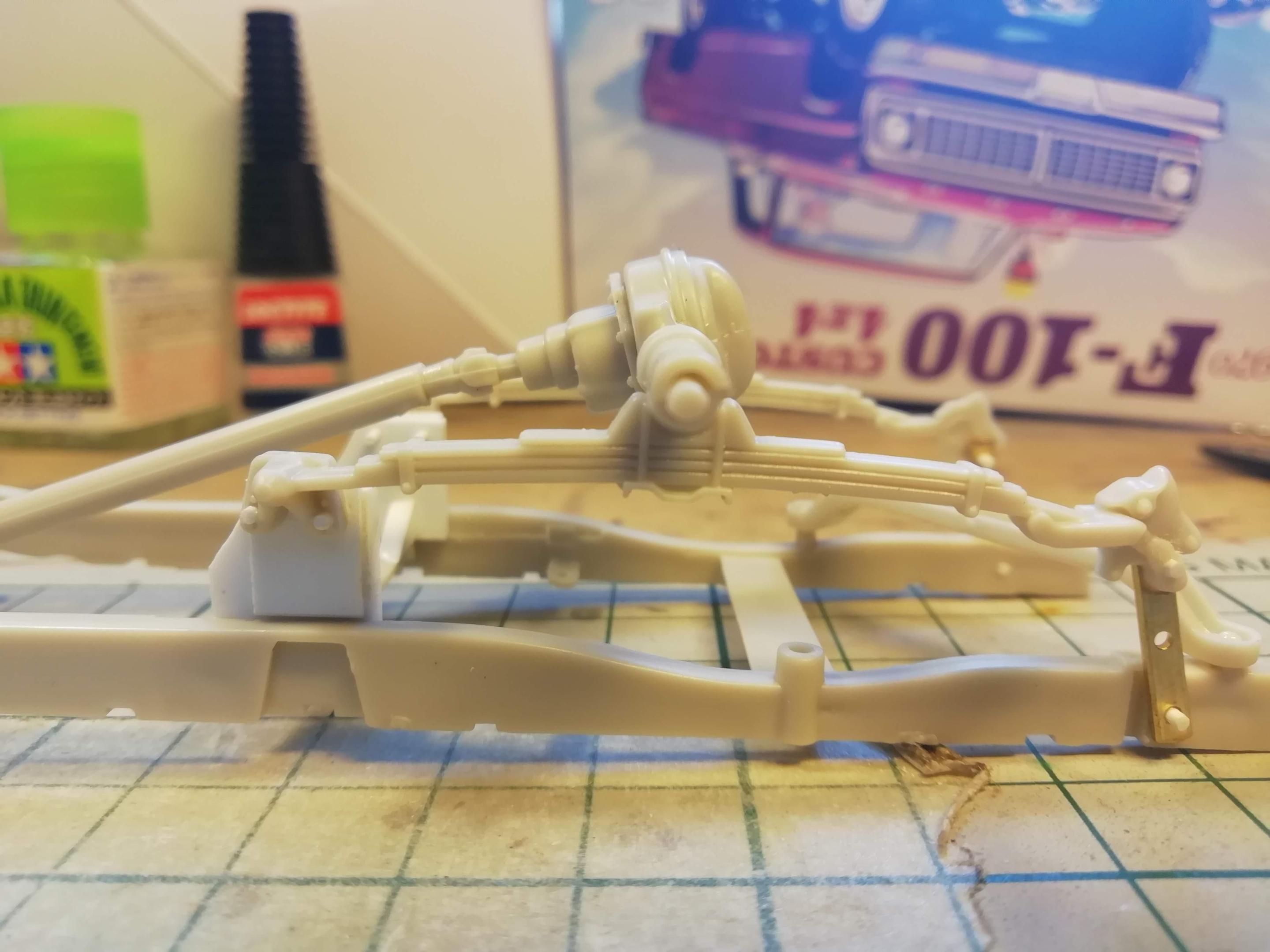

      I only have two photos of the lift.
      In front I added square tube where you attach the spring. Spring if from the parts bin. Also made plate where you can attach rear of the trailing arm.
      Same thing done to rear leaf springs. Plates to the front mounting points. Rear shackles are a find from hobby store jewelry section.
      Hope this explanation gives you some advice how to lift your Ford.

      Jurva - thanks ever so much!  This is a great help!  Once I decide what to do, I'll share it, including photos.
