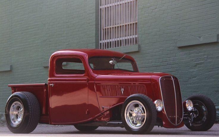

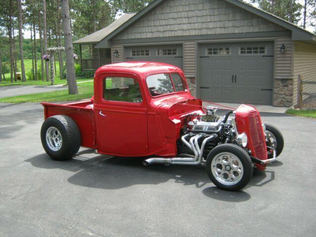

  5. I was admiring the header sweep, too, and have seen similar treatment on 1:1 examples. Combined with the modified firewall, it makes this 37 every bit as clean and integrated a design as any Deuce I've seen, scale or 1:1. My 37 reissue should arrive tomorrow. I have a separate thread going ( http://www.modelcarsmag.com/forums/topic/171790-has-anyone-channeled-a-revel-37-ford-pickup/#comment-2578788 ) and will post comments and photos as I work on it.
  6. These two are channeled about like what I want. Plowboy's modified firewall is indeed much cleaner than stock, so I'm likely to try something similar, especially if I go with no hood entirely, or even no hood sides. The latter photo gives me pause to consider keeping them as I rather like the curve they give.

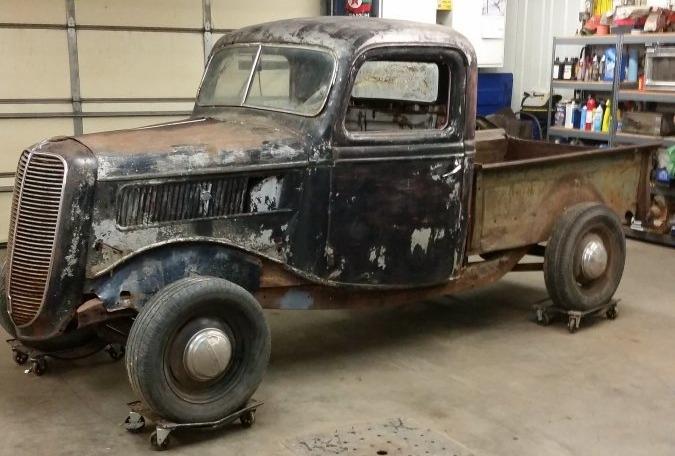

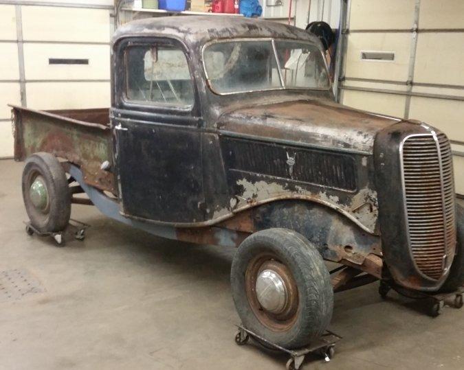

  9. Thanks for your input, everyone! It all aligns with what I've read about channeling (I have a half dozen or so Revell Deuces I also want to channel). Not having the '37 kit in hand yet, the advice from those who have that specific one already is especially helpful. I also forgot to say I have the '37 convertible kit, which I'm using for donor parts on a few builds (that chassis will go under a '40 coupe rat rod), which I may use for some stuff on this one. I've seen others, like me, use "highboy" as meaning no fenders or running boards, so "lowboy" is obviously a better term. Here's what a 1:1 '37 pickup looks like without fenders and running boards. The cab and box do sit on top of the frame if not channeled, and yes, they do go partly over the rails. Since (unlike a Deuce) the frame is not styled to meet the body, it leads me to want to channel it. In looking at these photos, the cab MIGHT be lowered some without lowering the box, but simply adding "skirts" and a roll pan to the latter. I've seen that done in 1:1 pickup photos. And yep, the firewall, radiator, radiator shell, hoses, & FEAD well all need some work, too. The hood sides will be open; I'm undecided about the top. I'll use the '37 pickup radiator shell, or maybe try something with the convertible one. I don't like the '38. I'm using the kit customized flathead. I may top the carbs with stacks instead of air cleaners, which will drive the hood decision. I'm leaning toward using the kit headers and duals, so clearance for those will be part of the channeling procesa., too. Thanks again for all the excellent input & your interest! I'll post photos as I go.

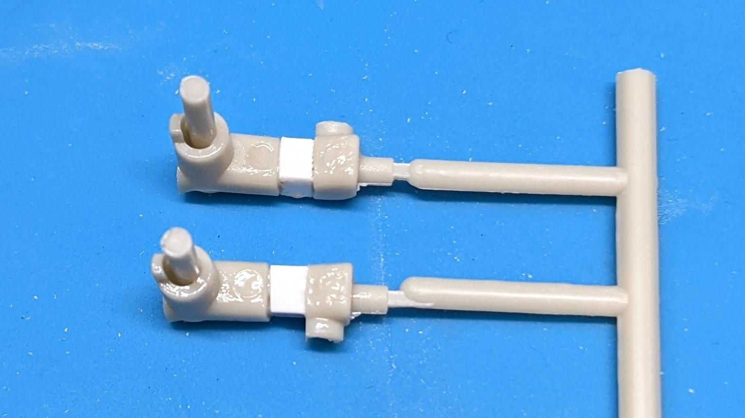

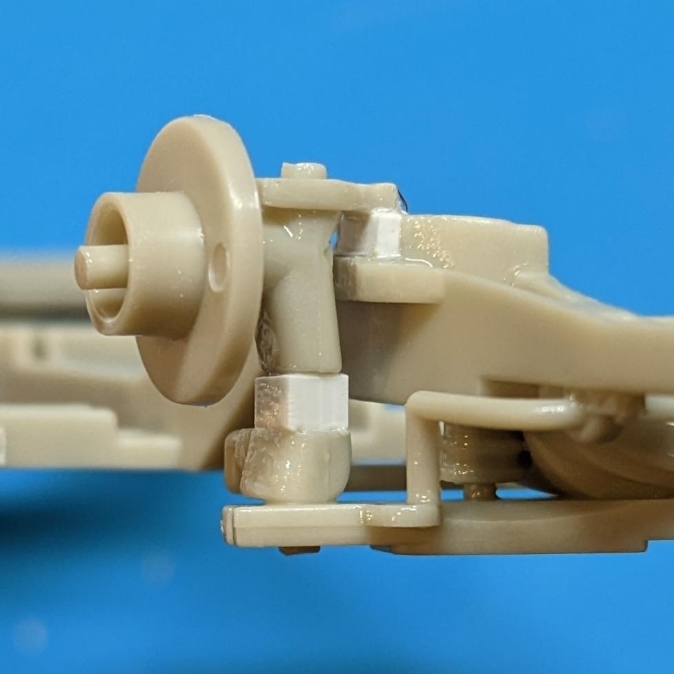

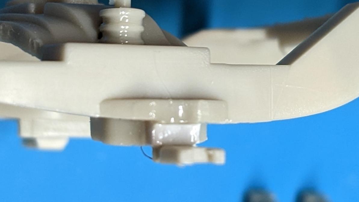

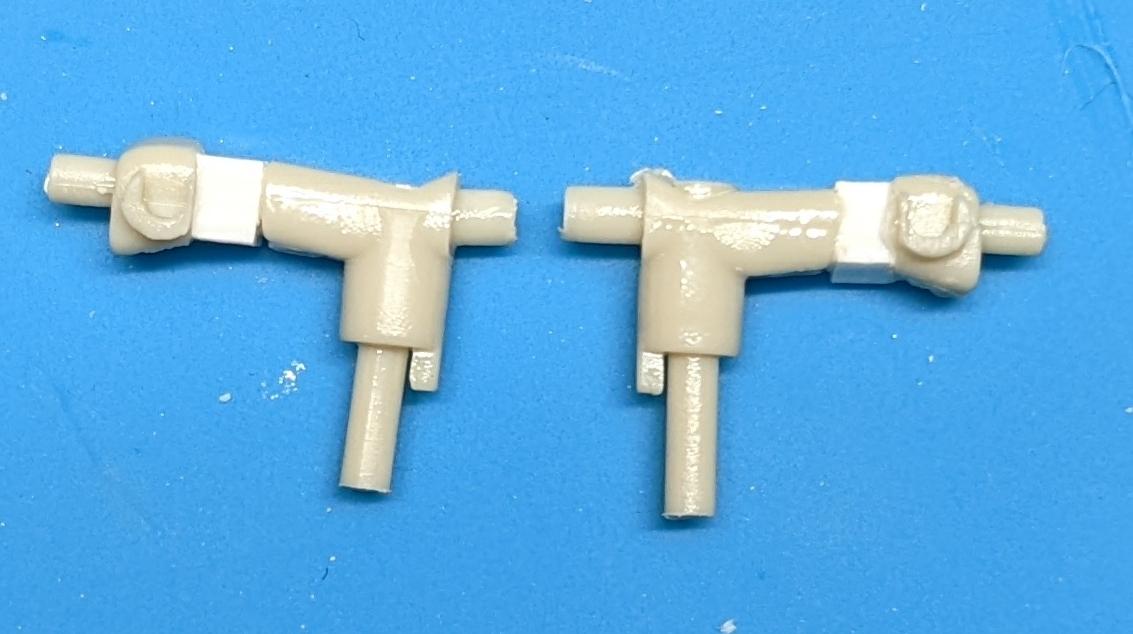

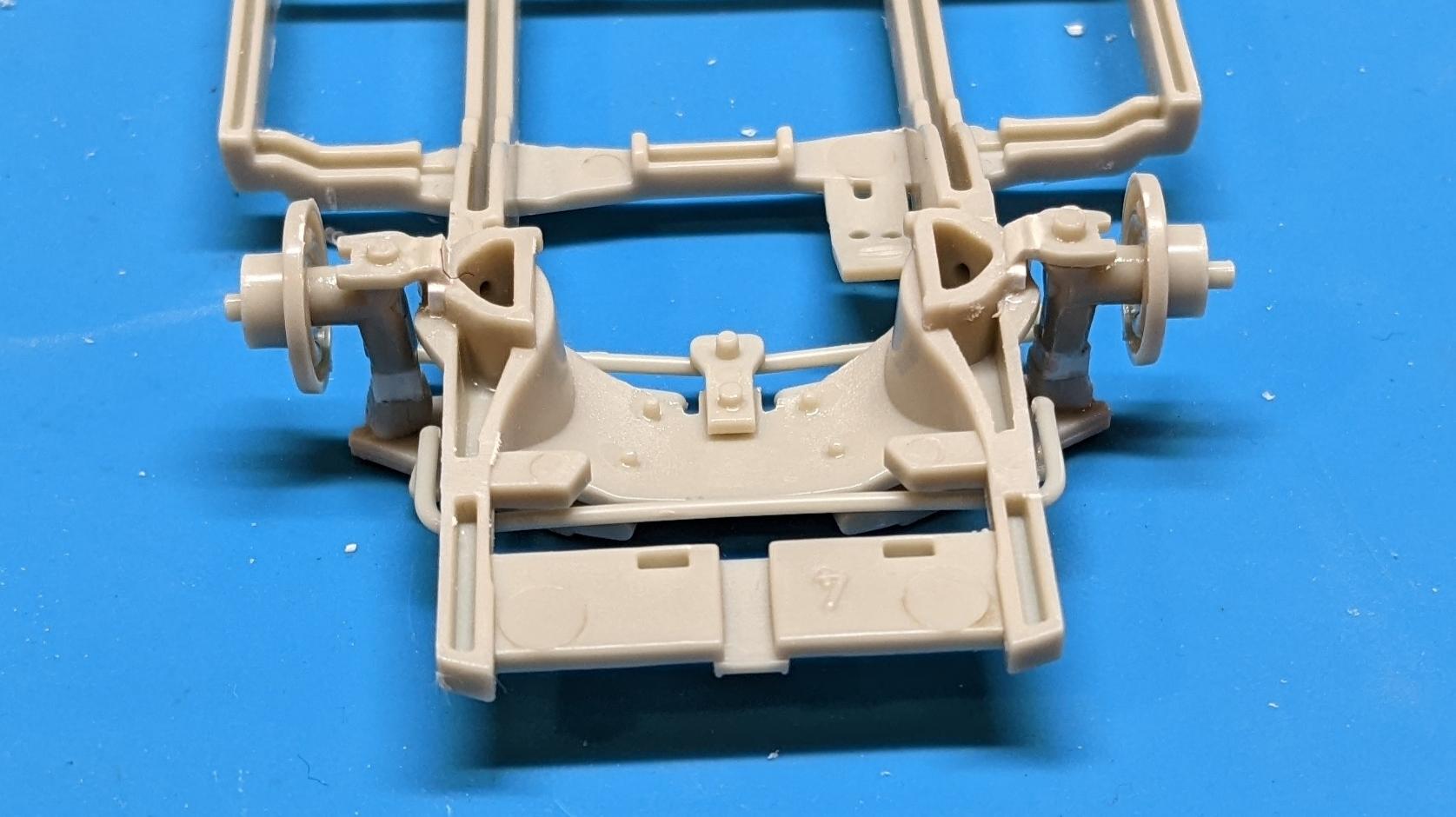

  18. I wanted to add some rake to a Revell '50 Olds Custom by lowering the front 3mm (~ 3 scale inches). This amount is in addition to the already-lowered suspension on this kit. I did not change the rear. The technique will work on the stock version of the kit, too, but specific dimensions will be different. First, I drilled holes through the frame where the upper control arms attach. In this way, holes can be drilled through the bottom of the lowering blocks, once attached, so as to ensure square location of the control arms. Then I added 3mm blocks from sheet styrene. Once holes were drilled, I shaped the blocks to match the frame. Then I cut the uprights from the lower control arms. I fabricated extensions from sheet styrene. To provide a stronger joint, with more cementing surface, I filed notches in the blocks. The blocks are 7mm tall, with notches that provide a 3mm longer upright. Next, I glued together the modified front suspension parts per kit instructions. Here is the resulting rake, for reference using the stock steelies also included in the custom kit. My car will have slightly more rake, since the rear wheels I'm using are slightly taller, and the fronts slightly shorter. Thanks for checking my topic and I hope you find it helpful. I may add updates as the build progresses, but thought this portion would be of use to folks. Your comments are welcome. Model on!

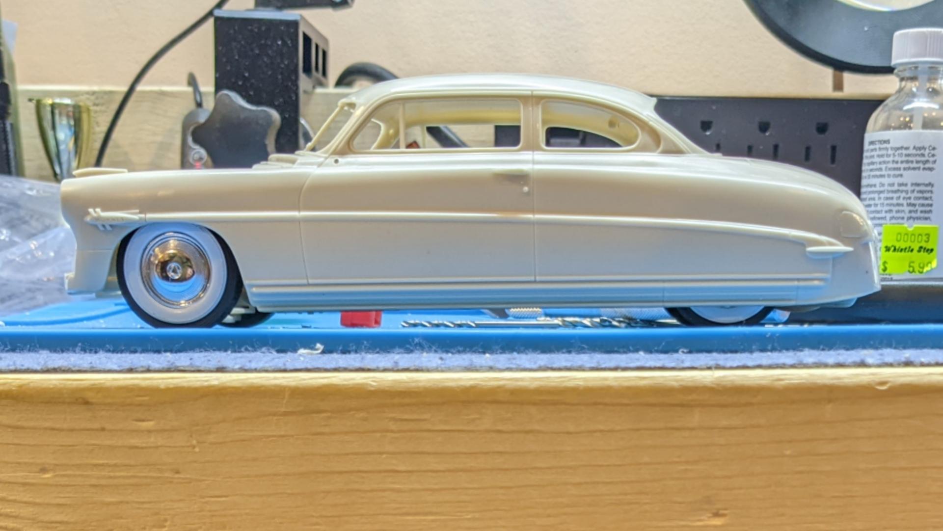

  23. I've built models off & on since I was a kid, but now I'm retired, I can put effort into modifying them. Here is how I'm lowering a Moebius 1952 Hudson Hornet coupe. The technique should work on any of their kits that share this chassis. I'm lowering the rear 3mm & the front 5mm, to also achieve some rake. I plan to use the chrome steelies from the convertible kit, which I also have. I'll show the rear, which is as far as I've gotten, then add the front later. Hope this post is useful to folks & comments are welcome. First, I notched 3mm from the frame rails to raise the rear axle relative to the body. Then, I cut out a portion of the floor to clear the driveshaft, and another to provide clearance for the differential. I added styrene sheet to fill in the holes. Finally, I added 3mm tall blocks to the leaf springs, made from square styrene tube. This mod provides an eventual connection to the axle, & allows the shocks ti remain unmodified. More to follow...
