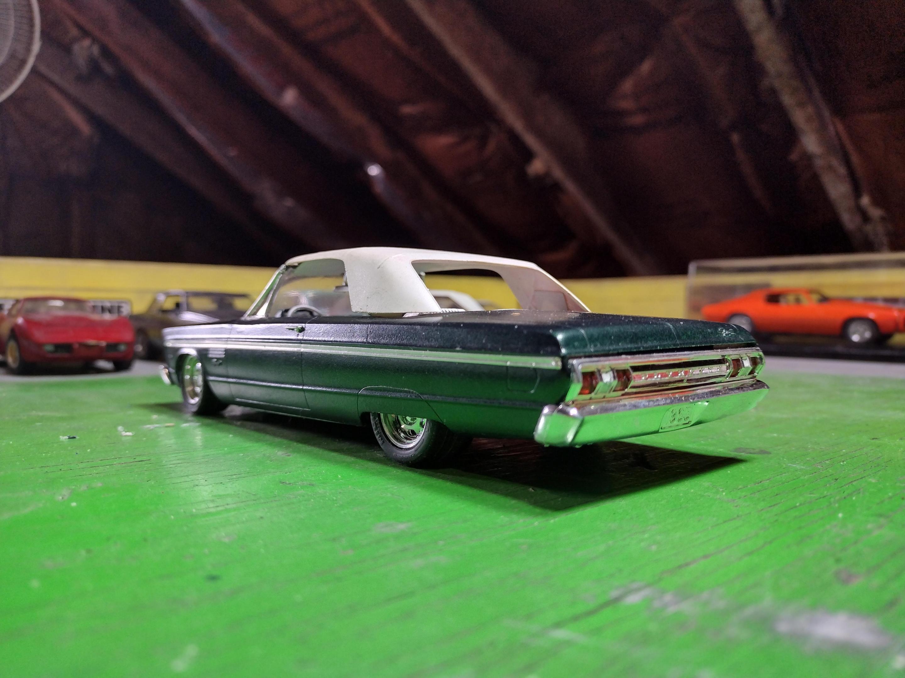

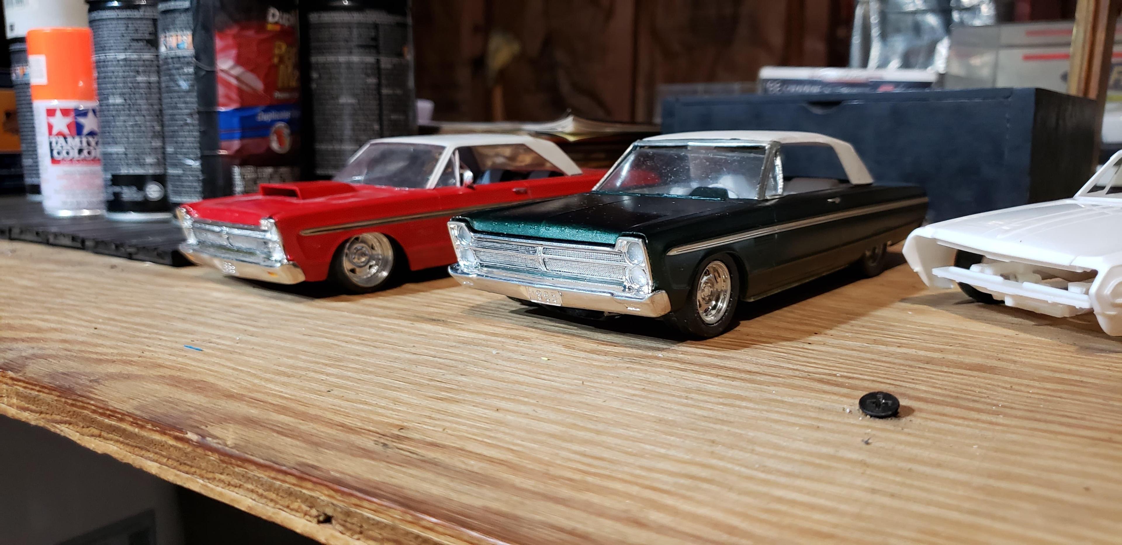

  8. JoHan 1966 & 1968 Plymouth Fury 2 door hardtop rebuilders.
  9. I'm waiting on a '69 body from the same source. Already have the Chevelle donor. If I were starting from scratch I'd use an Olds interior.

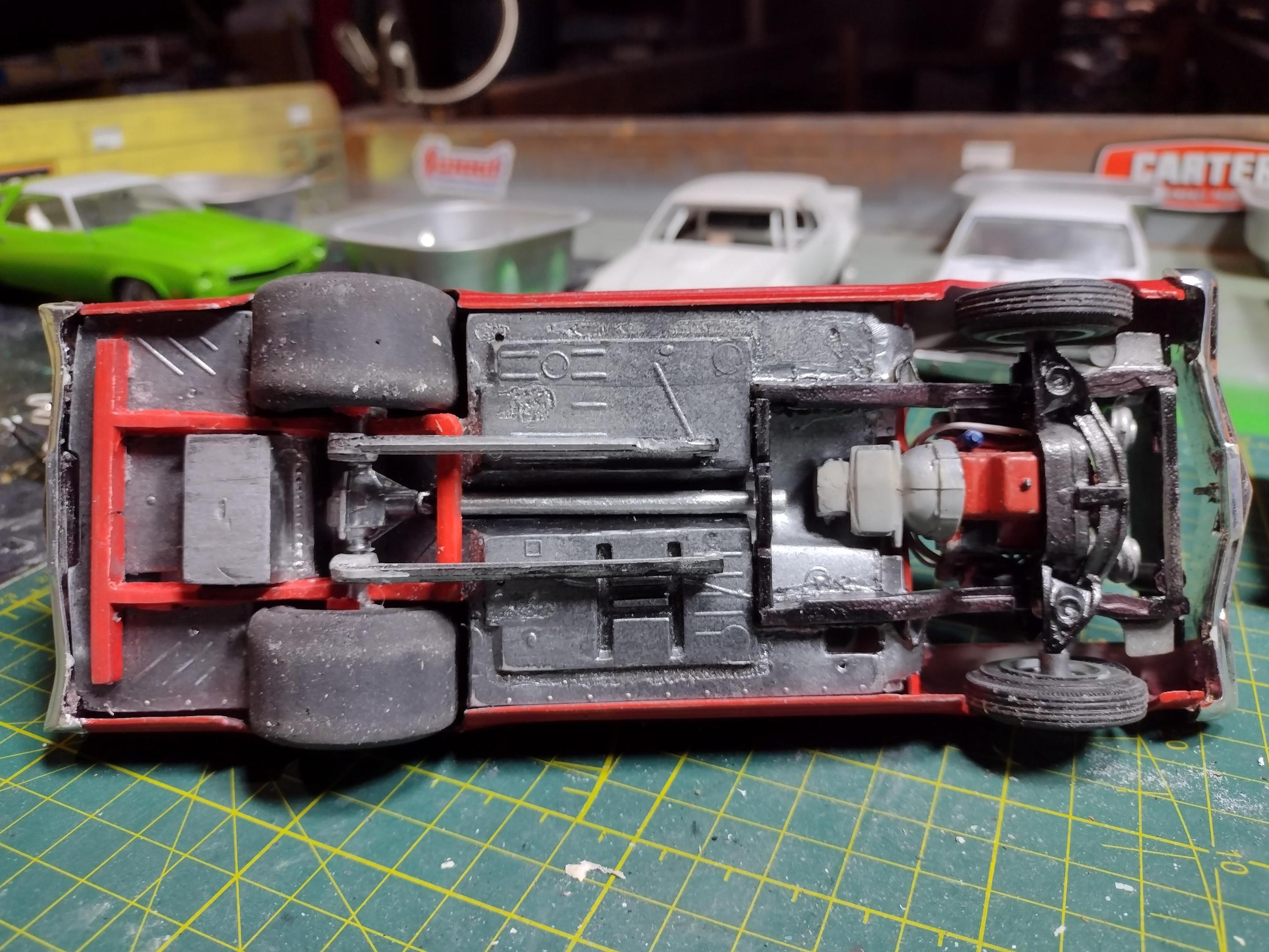

  10. Built to fit into the old SS/BA class. I know the Hemi Cudas were '68s. This build initiated on a challenge, that I couldn't fit a Monogram Hemi, this one from a '71 Cuda, into a 1/25th scale Mpc Cuda. I used the stock chassis but tubbed it, using the bottom of a prescription pill bottle for tubs. I used modified Amt '68 Road Runner front inner wheelwells to fit. Started in 2017, lost interest, was looking for a new project this year and decided to finish this one. Lost the taillight, grafted in a sectioned and narrowed '70 GTX taillight panel. Found the taillight after I finished the car.
