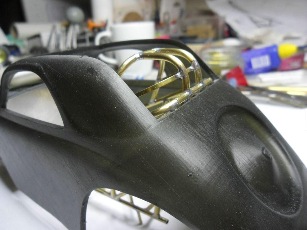

UPDATE; some motor works. Prepping the heads with brass tubes to accept the brass zoomies coming up, which just slide over these tubes. 3D material is so brittle, needing to beef up the pipe connection. The red material around the tubes is a homemade concoction, using ethyl acetate as a medium to melt red sprue leads to desired thickness to apply with a toothpick. The 'soup' dries quickly. Also getting the manifold detailed for fuel lines. The nozzles are movable so that adjustment later on is easier. Thanks for your interest. Mike.. -

Daniel, great fix there. QUESTION; 'sprue gloo', is that a trade name, or your own concoction? I make my own liquid filler. The reducer for styrene is ethyl acetate. Using a small jar, cut a mess of sprue leads, like maybe 1.5" altogether. Pour in just covering the styrene bits, wait 20 minutes, then you have applicable goop. Is quickly thinned out if needed, immediately. Apply with a toothpick, works great. Dries in 30 minutes max. But, I just looked online, the stuff in the US is very expensive. Germany is famous for chemicals, so a quart of the stuff is super cheap here. I know of no other liquid filler for styrene, hence the question. Looking good.

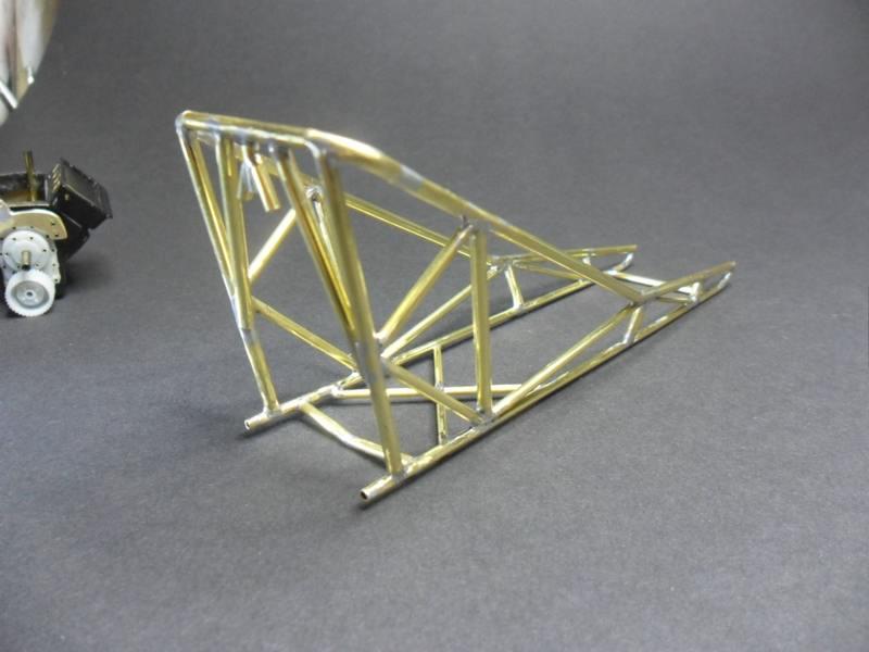

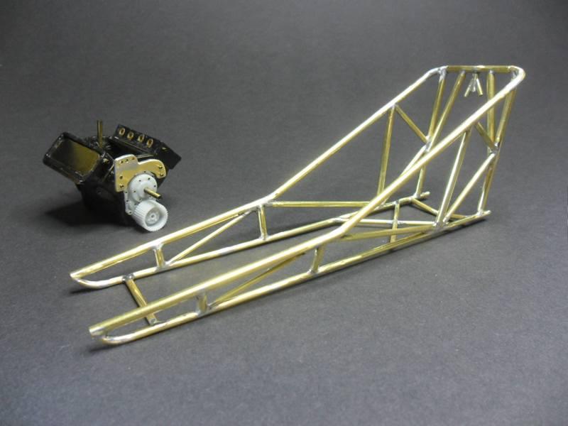

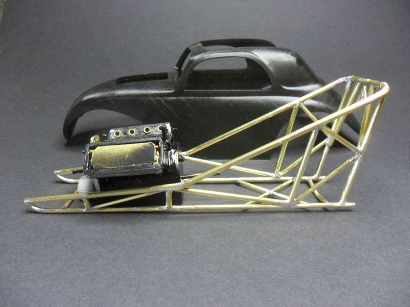

Hello guys, this one is a current WIP. 145" wheelbase, started this past spring, vintage 1965 car. Nothing fancy, just what I really like about the mid 60s, lack of chrome, down low and dirty with huge motors sitting way back!. No frills. Also shown are the 'studs' at bottom of chassis, thus keeping the ride height set throughout the entire build. These are removed after painting, after completion. The bare block sits, drive line established with motor dump, firewall. The car will show minimum of 3" to pavement. More soon. Mike..
