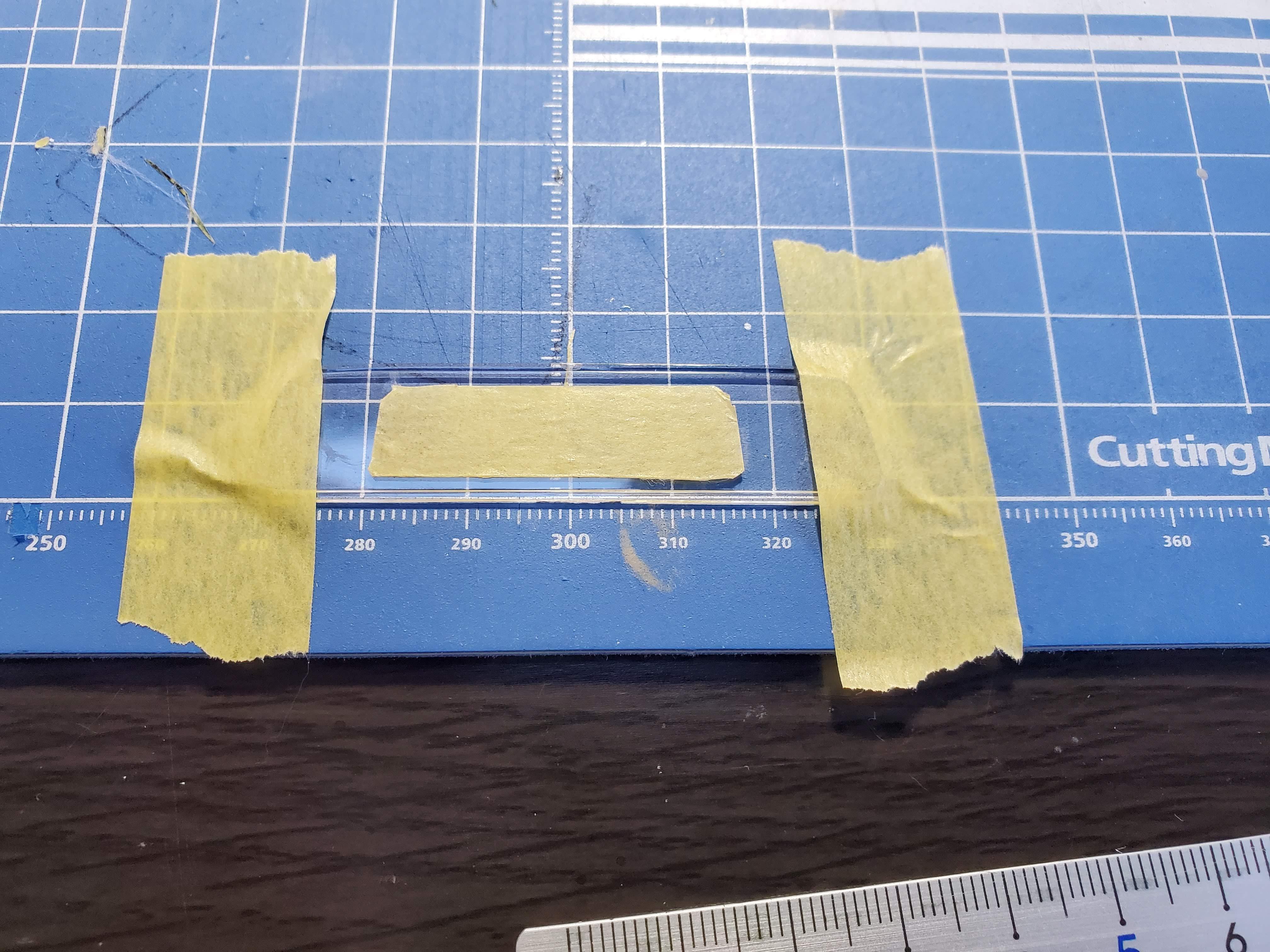

  2. So I had what seems to be an original idea (sorry if it's been done before, but I think I came up with it on my own) for making glass packs for 1:24/1:25 scale models. Put together a youtube video, I know I'm not going to win any awards for cinematography but I hope someone finds it useful. If you have any questions, please ask.

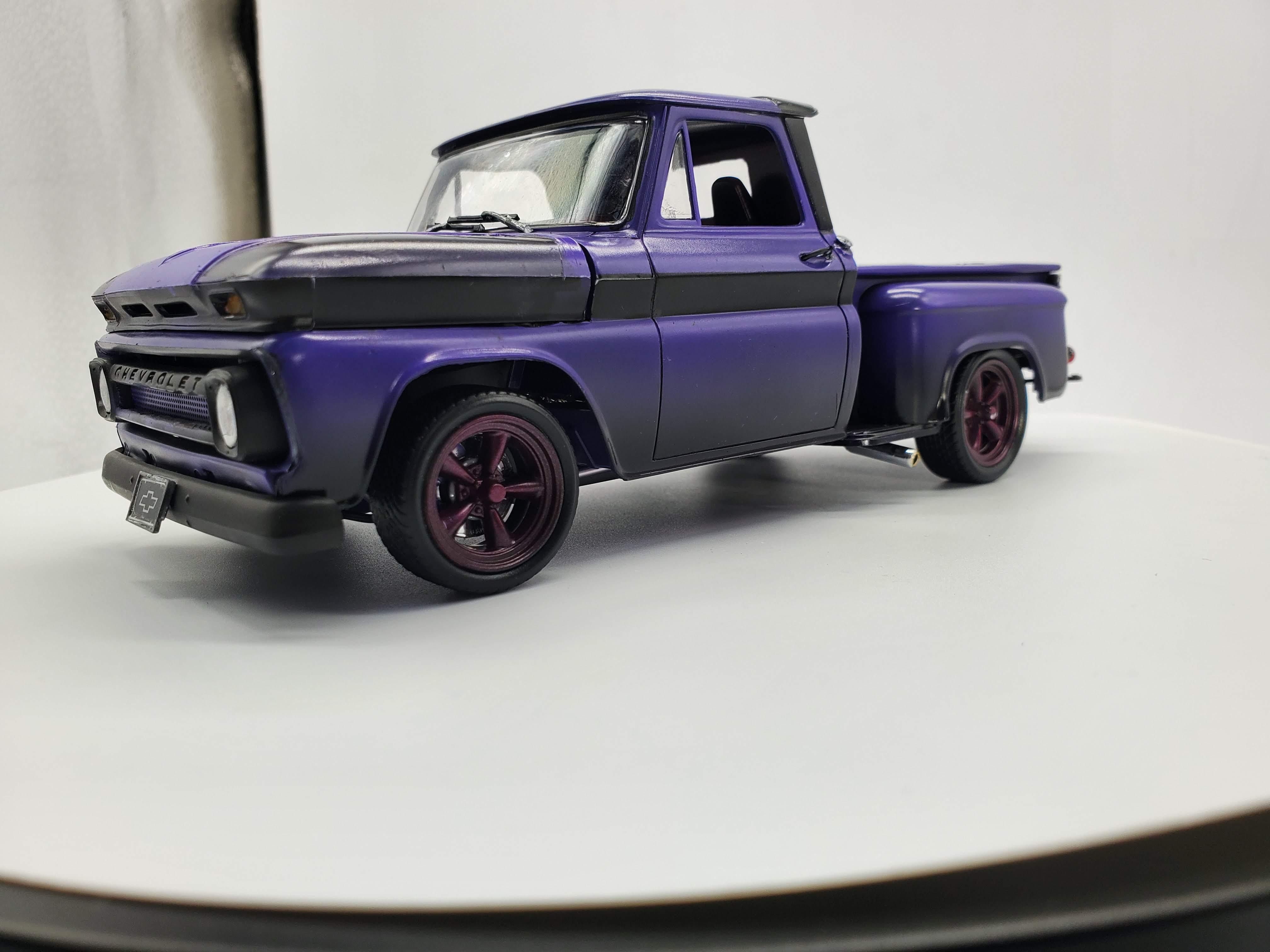

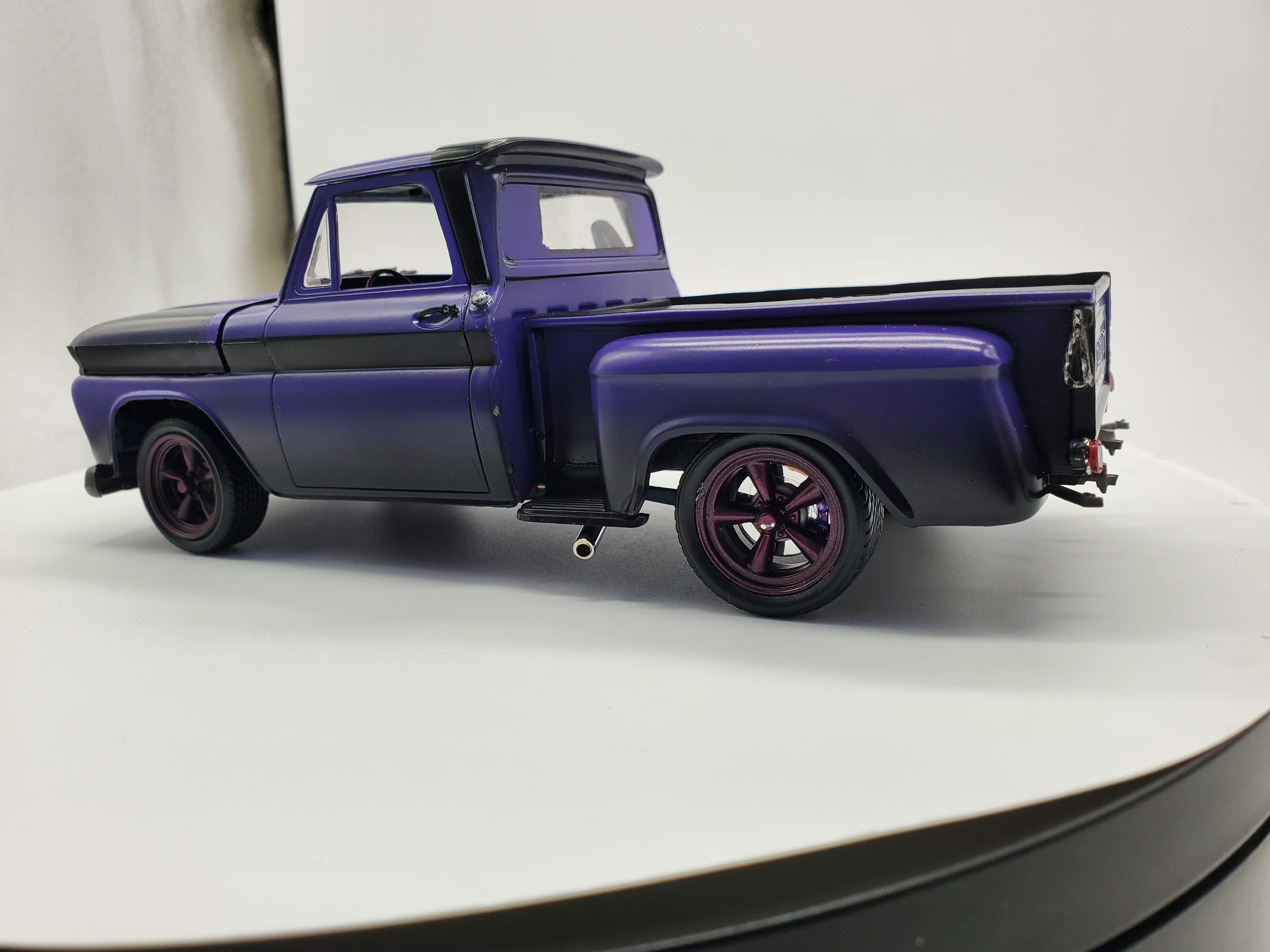

  5. In 1989 I got a 1966 Chevy Stepside that was a real rustbucket. My teenage self assumed he'd be able to transform it into a hot rod. He was wrong. So in 2011 I got the Revell 1965 Chevy Stepside model and re-created, more or less, what the truck looked like the day I got it. And this year I bought another copy and created what might have been if my life had gone a different path. So here we are. (The only difference between a 1965 and a 1966 C-10 is the badge. By not installing them, I've converted this to a 1966). It has known issues, but feel free to offer critiques on what and how I could have done better. I'm still very new to this hobby. Build thread is here.

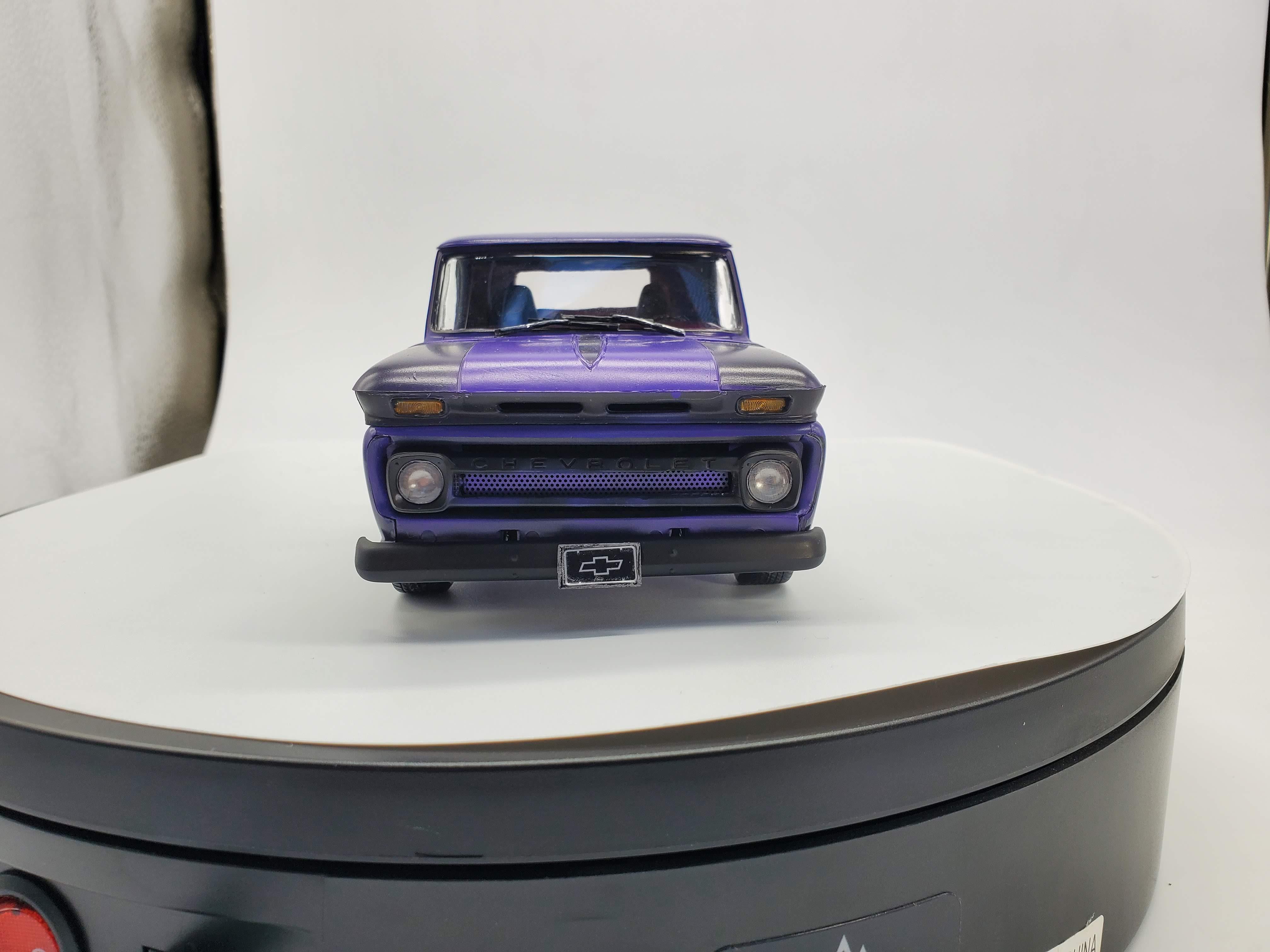

  6. Finally, did someone say cherry bombs? My truck as I bought it had dual exhausts and glasspack mufflers, but that was beyond my modeling skill when I built it back in 2011. No such issue this time. It took me hours to get the bends right, but by using some flexible 3mm hobby wire to make the pipe and some shrink tubing (used for soldering) I managed to pull it off. The mufflers were made using two pieces of shrink tube each. I don't remember the dimensions off the top of my head, but let's say I took 15mm of shrink tube and threaded it over the "exhaust," then heated it with a lighter until it shrunk down. I found it was still a little too mobile so I hit each with a dot of superglue to keep them in place. Then I cut another piece of tube, maybe 20mm long, and slid it over the first, now-shrunken bit. Make sure it's lined up and hit it with the lighter. The middle will conform to the slightly larger diameter of the first bit and the ends will shrink down to the diameter of the wire. Voila, glass packs! I do not recall seeing anyone having done this before. Not saying it didn't happen, but I'm pretty sure I came up with it on my own. I still need to make exhaust tips using an old telescoping antenna. That I know I learned from Jun's Mini Garage on YouTube. EDIT: Exhaust mounting brackets are outside of my current abilities. I just used superglue.

  8. One feature of the '66 is its small rear window. For some reason, maybe safety, lots of owners of the 1:1s go for the "big window conversion" which gives a full-width window in the back. I'm having none of that, my truck came with a small rear window and if I wanted to know what was behind me, I'd install mirrors (side note, I forgot to install the rearview mirror before gluing the cab together. Oops.) So when I built the rustbucket version I spent ages trying to create a rear body panel with a small window out of polystyrene. I was unsuccessful, but then I realized I could just mask out and paint the big rear window piece to look like the original small model version. And I still had the template this time, so problem solved. The template isn't pretty, but I use it to get the basic shape down and then cut the mask with a straightedge and a hobby knife. I put down two layer of masking tape, but for the second one I de-tacked it on my flannel shirt first to make the two layers (one for the inside of the window panel, one for the outside) separate easily.
  9. Thanks Greg and David. The rust was done with a Japanese product called "Sabiten" (sabi is the Japanese word for rust). It's a two-part formulation with part one being iron filings in a gluey gooey medium. Brush that on, wait a day or so, and then add the second liquid which is an oxidizer that causes the first coat to actually rust. I understand that the US has a similar product available at... Michael's Hobby/Craft shop? Not sure, but I know I've heard of it. The damage work was done with a lighter, a soldering iron, and some patience and good luck. The rust holes in the front quarters were done with a dremel and a ball grinding bit from the inside. Thanks! I just wish that my life had panned out so that I was posting this on a 1:1 car site, but so it goes. And... A quick thanks to everyone who has posted their build of a Revell 65 Stepside in the last few years. Before embarking on this project I did a lot of reading on the model and looking at different modelers' takes on it. I can't remember who or what or where, but if you see something that looks like what you did, you're probably right. More later.

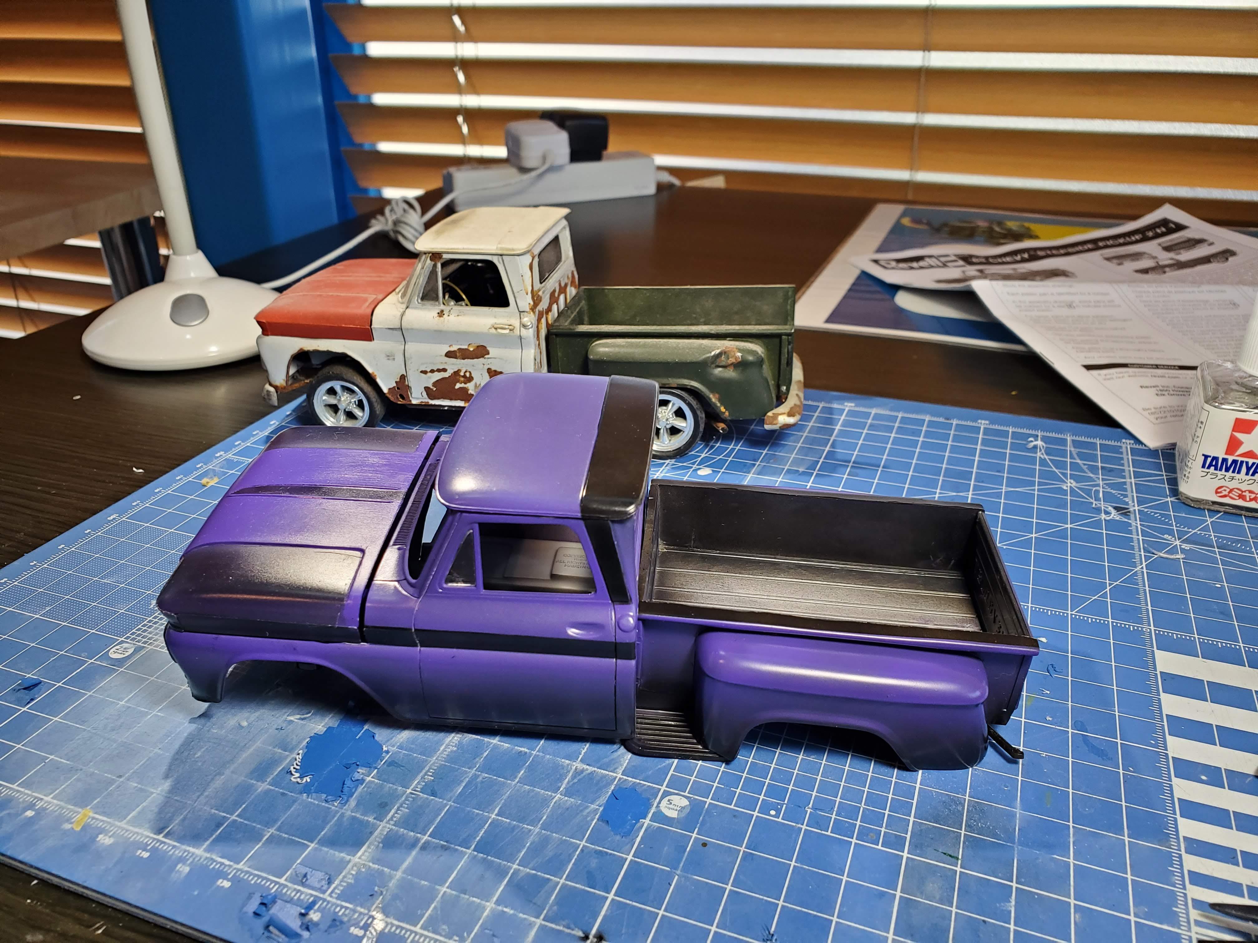

  10. I brought out the older brother for some repairs and comparison. The rustbucket version was built in 2011 when all I had was rattle cans and a windy balcony, so it's cruder in a lot of ways. It's also more distressed than it should be because in 2018 we had an earthquake that sent my whole hobby shelf crashing to the floor. Some of the pieces may have gotten swept up and discarded. Anyway, a comparison of what was and what could have been.

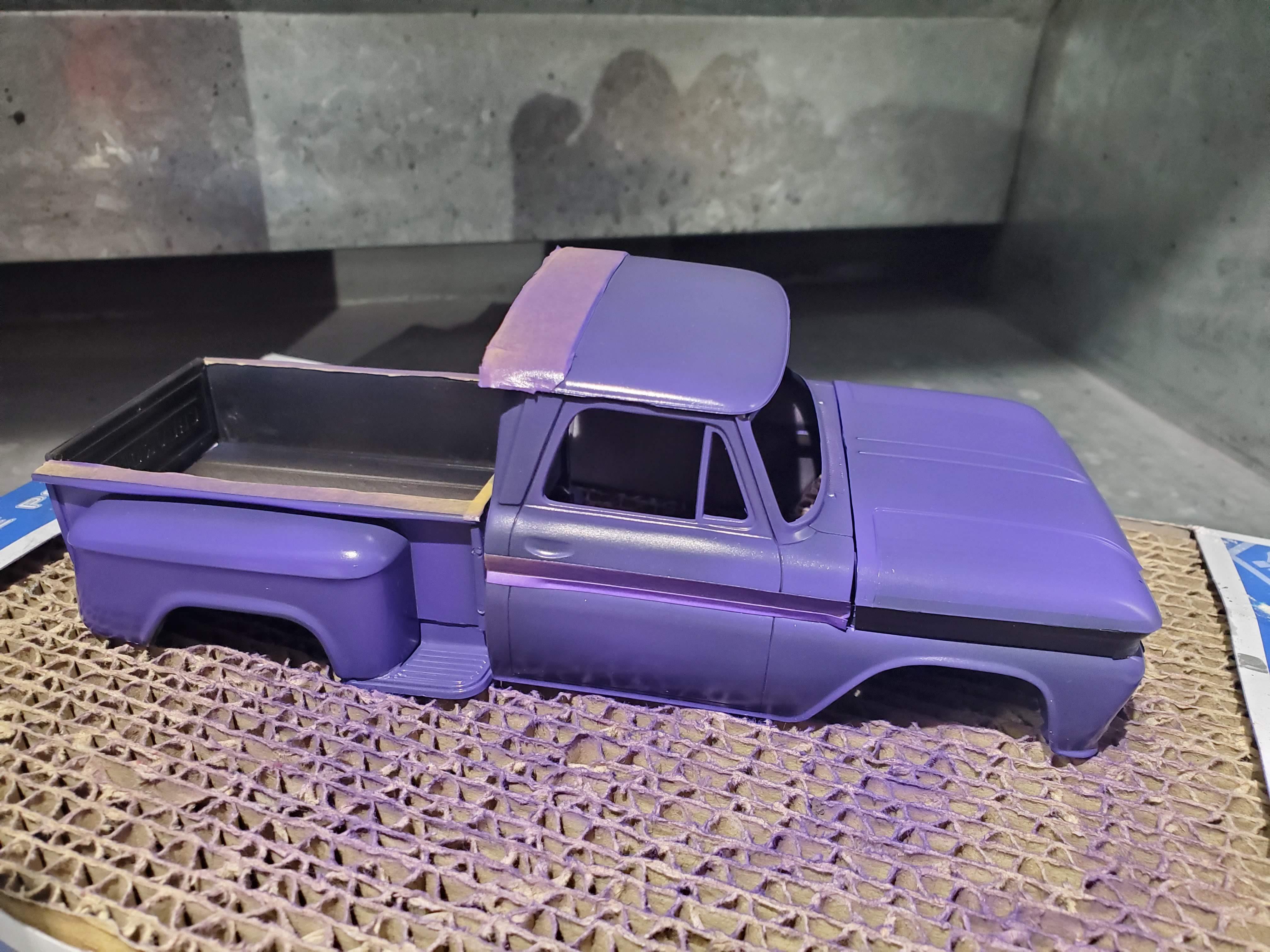

  13. Black base coat, Mr. Color Purple. Then I tried to do a fade to black on the bottom but it didn't work out so well. I may attempt to respray it since I think I know what I did wrong (I'm very new to the airbrush, so advice and tips are always welcome):

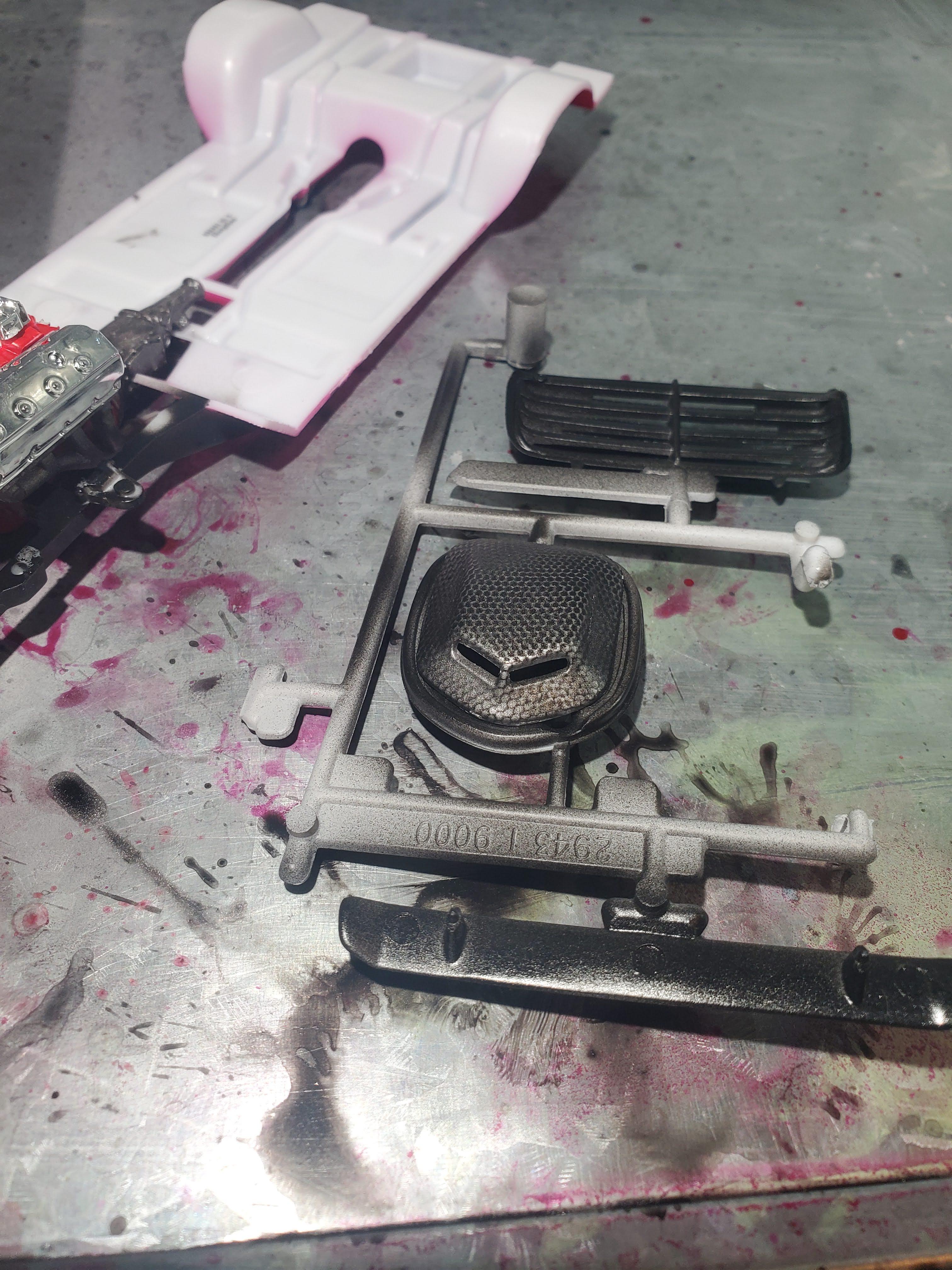

  19. Thanks Greg! I've still got a long way to go though. As for carbon fiber, I put down Tamiya grey primer (sorry to be so basic but I'm in a really basic point here and have found a lot of little details that I thought wouldn't matter do), then enough Mr. Color Silver to coat. The mask was a piece of a fishtank net (for when you need to get the goldfish out to do a good cleaning) from the dollar store, held firm underneath and then sprayed with black. That's on the shaker, the seatbacks were black first then silver but I think I like majority black better than majority silver. Thanks David! But I don't think I'm doing such a hot job of laying down the basic coats. I have a tendency to get impatient, open the air valve wide, pull the trigger all the way back, get in close... Basically I should just be doing melting paint jobs :). Still, this car and the Estima (under glass) are training pieces for a 66 Chevy Stepside I'm going to start on shortly. Make the mistakes here so that one comes out good.
  20. Some more progress today, think I'll finish it tomorrow most likely. Does anyone make a carbon fiber shaker? They do now. Carbon fiber seats too it seems

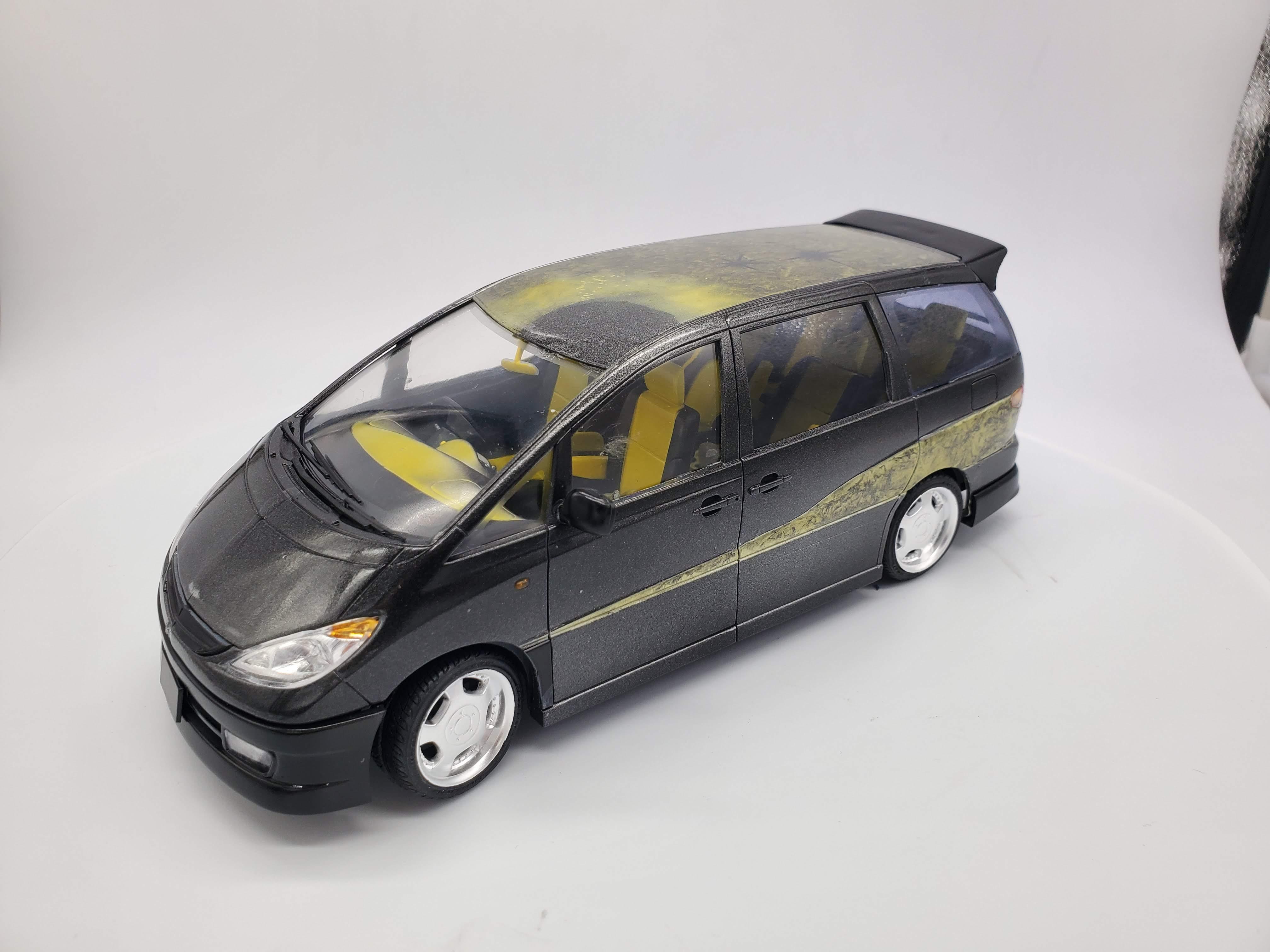

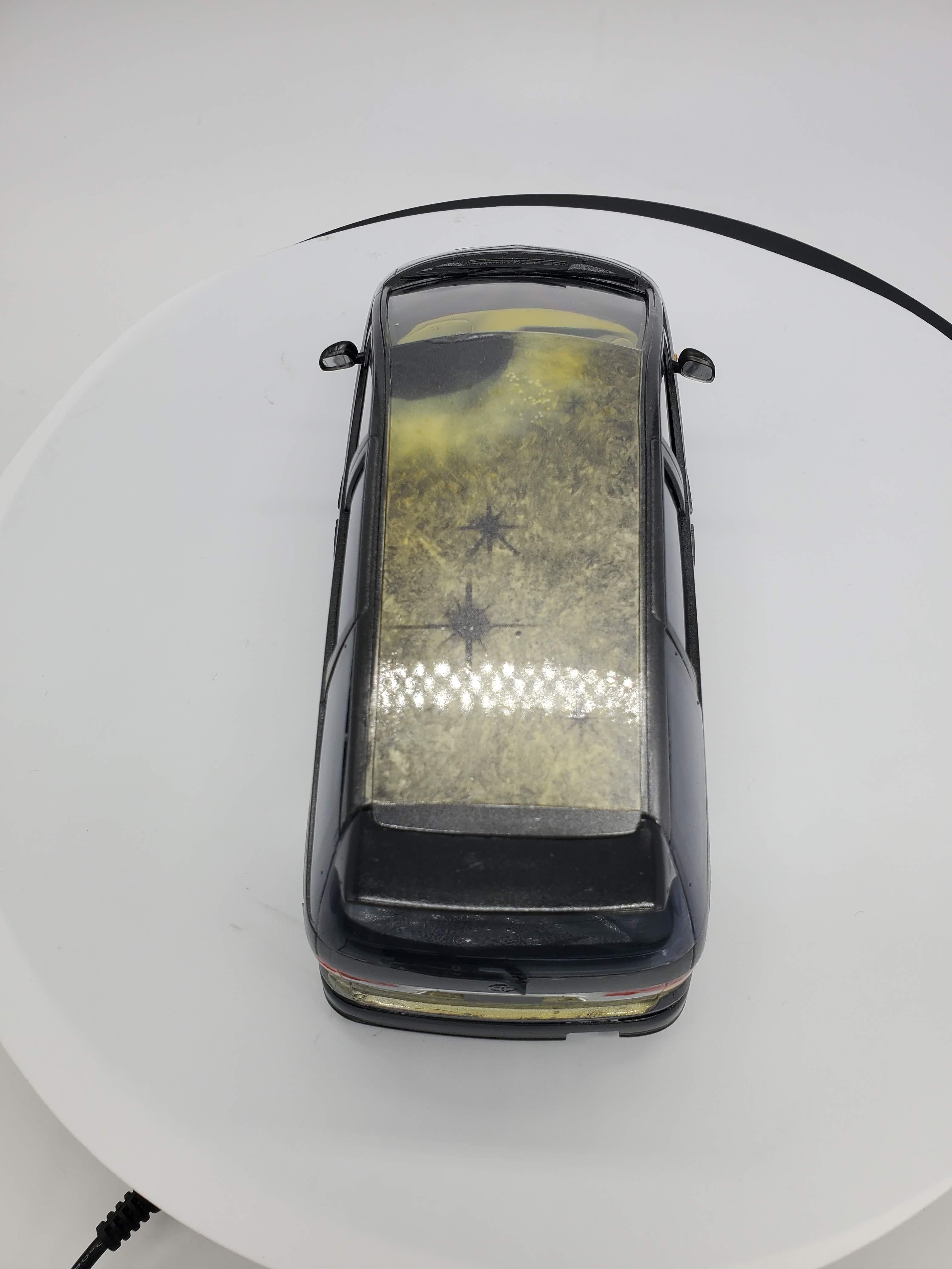

  21. I said in my earlier post about my Hemi Cuda that I hadn't really used an airbrush before. Kind of true, but I finished this one before starting on the Cuda. This is a 1/24 Fujimi Toyota Estima "Exclusive ZEUS" edition (whatever that means). It has upgraded bumpers and a more aggressive rear spoiler. As for the paint, I chose this because it had a large flat-ish roof and some accent lines down the side of the body. I'd seen an airbrush tutorial on making starbursts and wanted to give a space scene a try with a twist. The idea behind this is, if you are familiar with the Lovecraft mythos (and if you aren't I can't recommend it strongly. Lovecraft had many opinions that don't play well in modern society. Be warned) there will come a time “When the stars were right, They could plunge from world to world through the sky; but when the stars were wrong, They could not live," with "They" being the Great Old Ones, a race of elder gods who are inimical to humanity. So what you are looking at is a black sun and black stars, shining darkly in a boiling yellow (and here's where I learned that yellow plus black doesn't equal darker yellow, it equals some kind of:) green sky. On a souped up Toyota minivan Thanks for looking, and any comments (like how I put way too much clear on the roof and ended up with a puddle over the front windshield) are welcome.

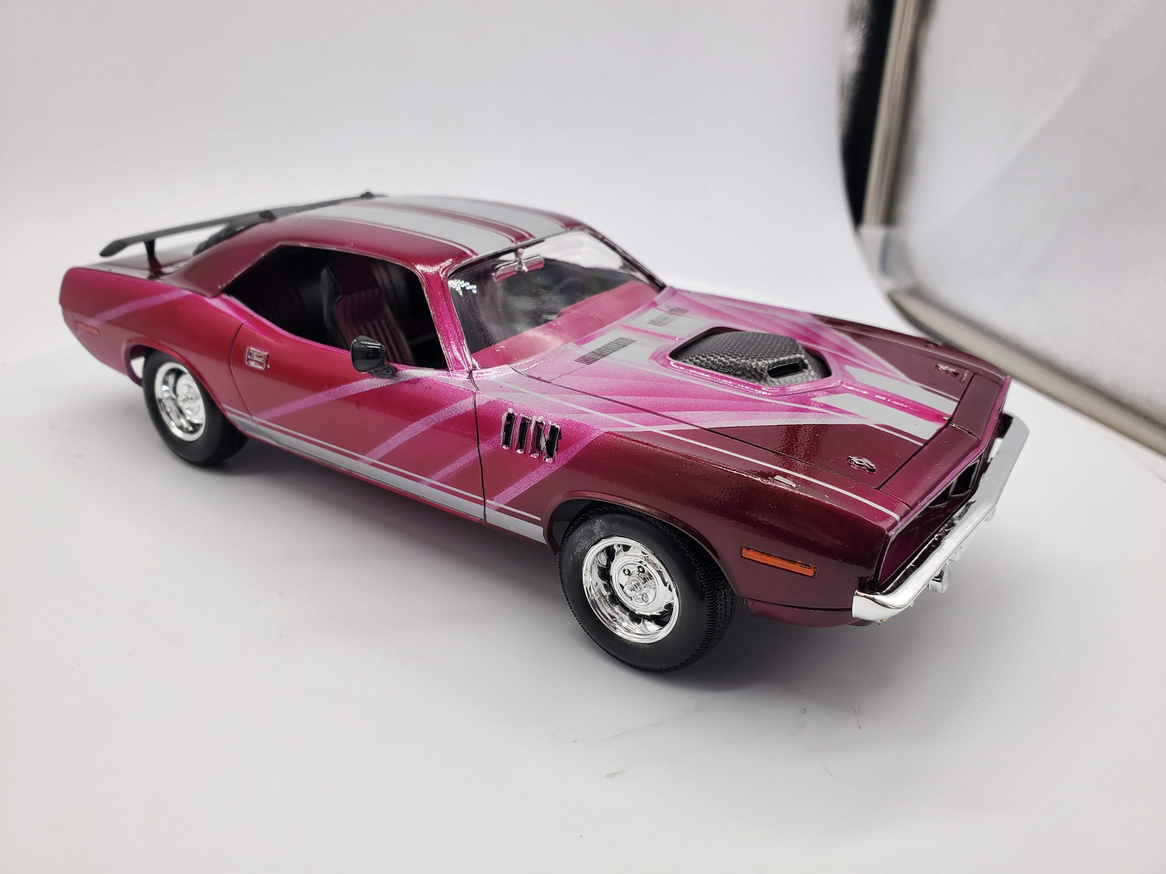

  22. So I got a 71 Hemi Cuda from Revell last summer and a membership at a local modeling makerspace. I've never really used an airbrush before, but I've been watching a lot of youtube tutorials and here's where I am so far:

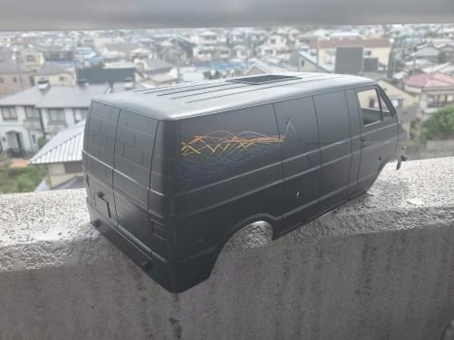

  25. Forgot to mention that I'd put several layers of clear pearl over the gloss black. Once it was all masked up, I sprayed it with a couple of coats of Matte Black. Unfortunately, I didn't wait quite long enough between coats or unmasking or something so it didn't turn out perfect, but the idea worked well enough that I was happy.
