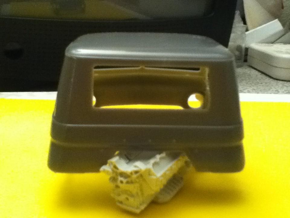

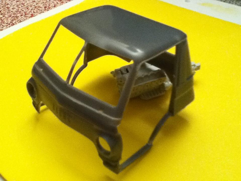

  7. Okay here is an update I did the chop now I am working on putting it back together again. First I made a mask around the cab to show me where I was cutting and scribbed it with the razor knife Here is the after picture I think the cutting turned out well I chopped it high enough that I can smooth out the detail in the back pillers so it runs up into the top I then took the top section and quartered it I am now working on spreading it out so it lines up with the bottom section. Does anybody have some tips on making this part easy. Thanks for looking Tim Kracht

  14. I think we are both on the same page I will need to cut the roof in to four pieces and widen it and lengthen it. (null)
  15. That was my thought as well, would make it look more natural. My thought would be to cut it horizontally through the back window. To take out the drop material. I don't know if it's been done before, but thought about cutting out the upper window section and keep it intact then just lowering it in place and filling in the gaps with sheet plastic. That way the window could be the cornerstone of the whole thing. Let me know if that makes sense. Tim (null)
  16. I was looking to get some thoughts on chopping the top on this Coe. I have had some suggestions from a friend to cut the roof flush with the top of the posts. Then cut them down and bend them in. My thought was just to take some out of the middle section and lower it. Thanks Tim kracht (null)
