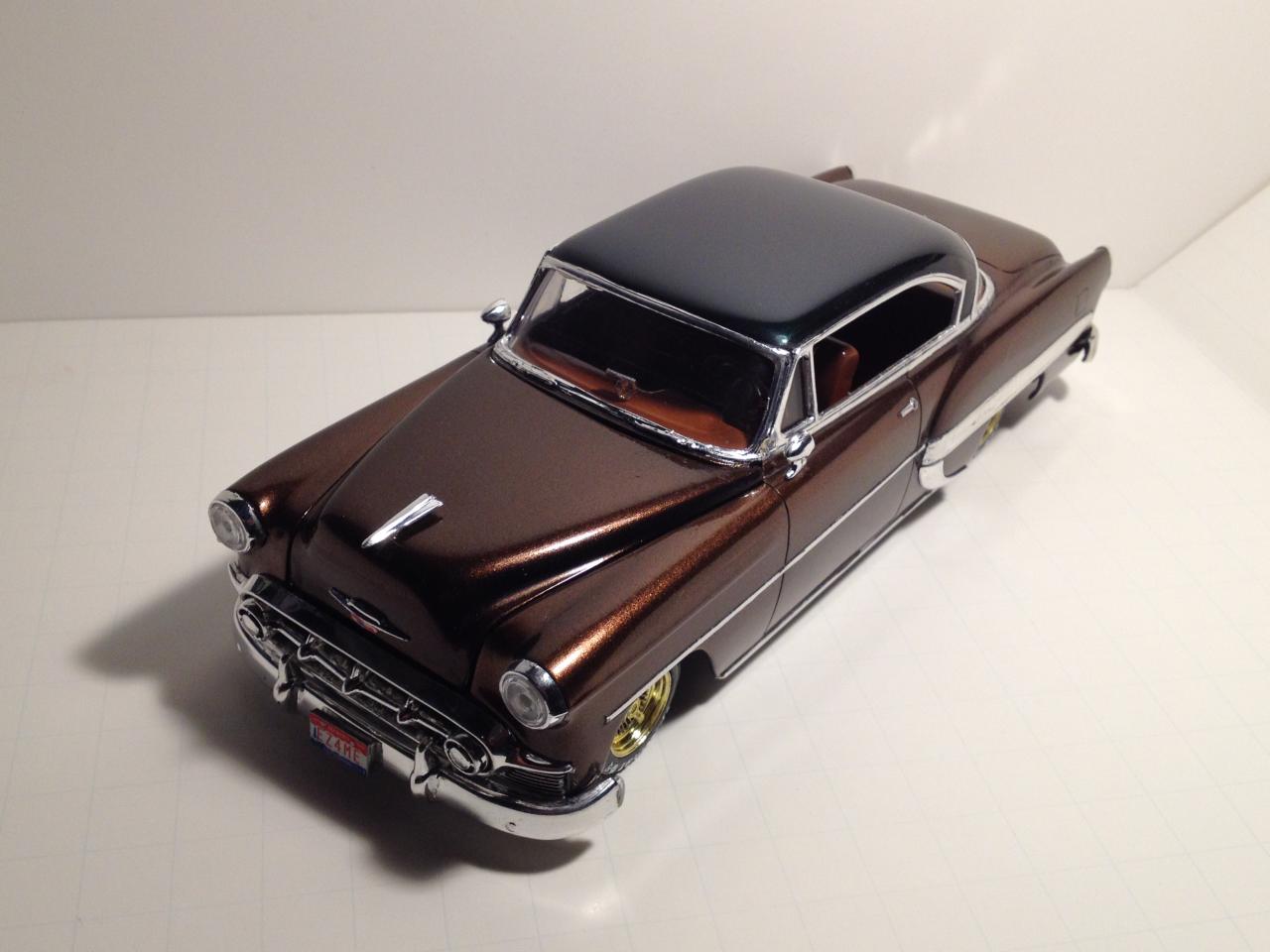

	  Tree House Studio Clear Acrylic High Gloss Sealercchapman195 replied to jdhog's topic in Tips, Tricks, and Tutorials Hey there JD. Your product lived up to exactly what you claimed when I used it on spoons. I tried five different types of applications and three got poor results like most of the comments by some who have tried it. One came out decent and one came out great. As with anything people need to take the time to experiment and find a way to make it work properly. It is different from one coat lacquer of which you can put on a fairly heavy coat. But if the time is taken this can be just as good and cheaper. That said. I can still get the one coat lacquer look, and the same look with this Tree house product with Pledge floor care. which is even a whole lot cheaper. But I have an airbrush and spent a lot of time practicing with it to get the results that I do. Your product is a great product for those without an airbrush as long as the time is taken to play and practice to get the great results. Here is what I can get with floor polish.

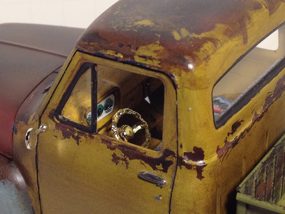

	Yes. Go get the light gray CRAFT acrylic and mix it the same way real runny and milky. I would suggest using a sponge. dip it into the paint and then dab on paper towel. then lightly dab on areas to be faded. Use a Q-Tip to dab little areas or creases along trunk or body. Let dry. Keep adding until you get the look you want. Then again sand along edges to feather into the paint.
	Start jumping for joy my friend. I did not mean aircraft I meant CRAFT paint. The Walmart .59 cent for two ounce bottles of cheap goo. Out of curiosity, are you using an airbrush? If so Painting with these craft paints will be a lot of fun. Also, it helps with fades. When you get your main colors down you can thin light gray or white paint with pledge floor care way way thin. 1 drop paint to 15 to 20 drops pledge. This is so it will bond. It needs to be thinned to where it looks like milky water and somewhat see through. Then spray light mist coats on the areas you want to look faded. This will show the color but have a dingy faded hue to it. You can also make it shiny. Add rubber cement where you want it to look shiny. Then spritz a little water and add some kitchen salt along the edges of the glue. Let dry for a few hours. Then spray a dull coat or a light mist of pledge around the edges. When you remove the salt and rubber cement it will have a faded dull look to it. You can now lightly sand with 1000 grit sand paper to blend in along the edges.

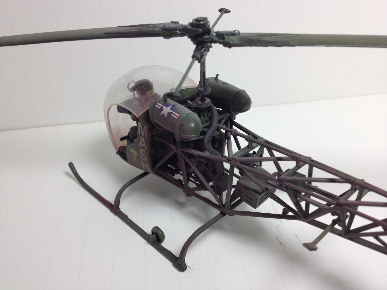

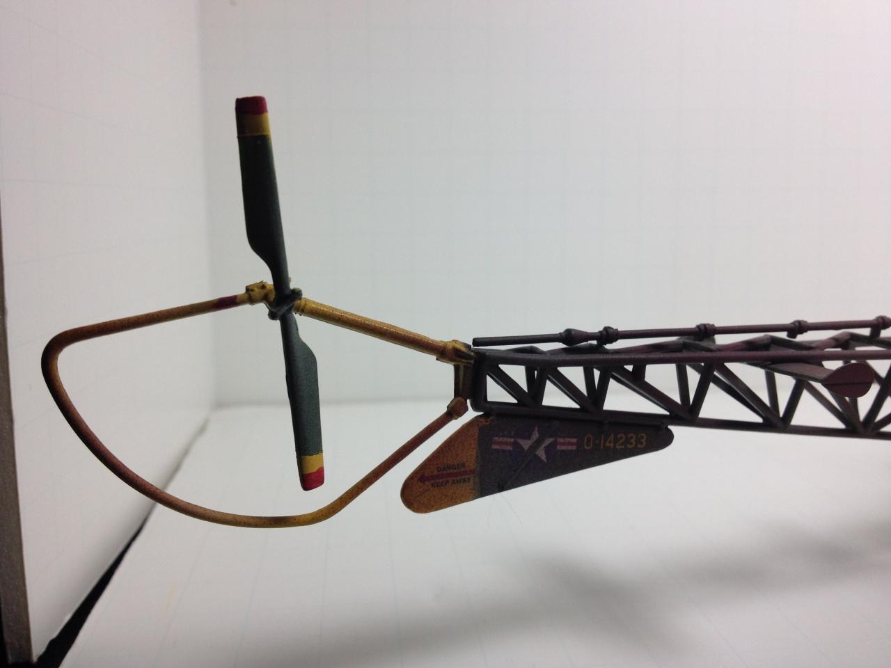

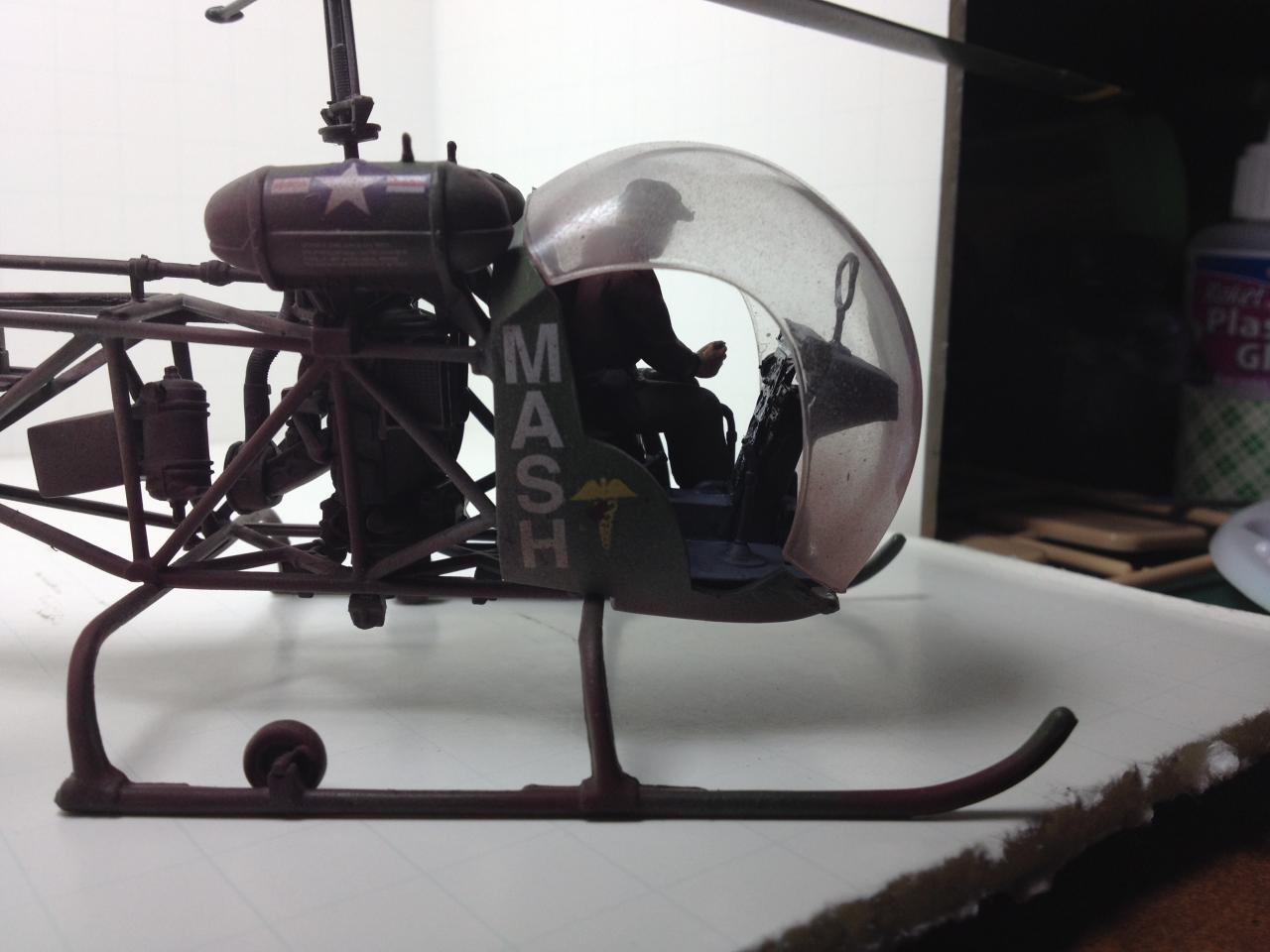

	This is one of the monthly pics winners for Dr. Cranky's 2015 calender contest. All craft acrylic paints on this.
