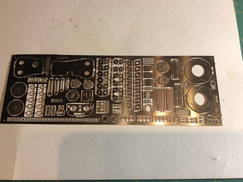

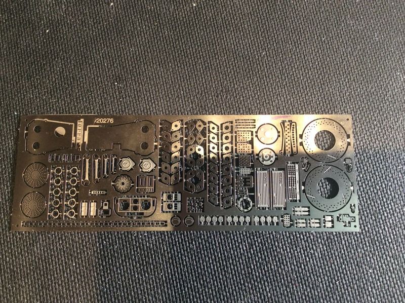

Hey, who wants to play "Let's Help Scott figure out where the heck any of this stupid photo etch goes so he doesn't go any crazier than he already is???
For your entertainment, I have four photos of the aforementioned devil PE
It is supposed to be for a Ferari F40 and Testarossa in 1/16 scale. No maker, no instructions, only ID is #20276...which I googled and can't find squat other than the seller. I think it is Testarossa only due to the obvious cylinder heads.
There are 33 numbered mystery PE parts drawn from the sprue. I left a couple obvious ones out and left a few easy ones in to get us moving.
So without further delay here are the pics

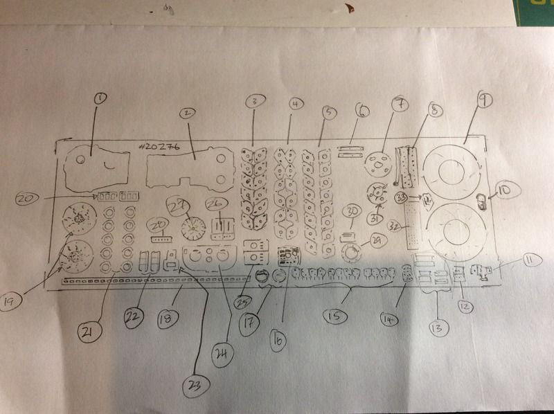

Our game board
So 33 blanks to fill in
I will start with an example
#17 air vents for dashboard
#24 dash panel......... Crazy Ed

You might have enough for both here. The TR has a v12 and the F40 has a v8. Look at #4, the four pieces with two holes look like intake or exhaust gaskets for a v8 while #3 is for a v12. #5 looks like more v8 parts since there is 8 of each part. Part #21 looks like exhaust system flanges, six of which would be used on the F40 to mate the muffler to the three exhaust outlets.

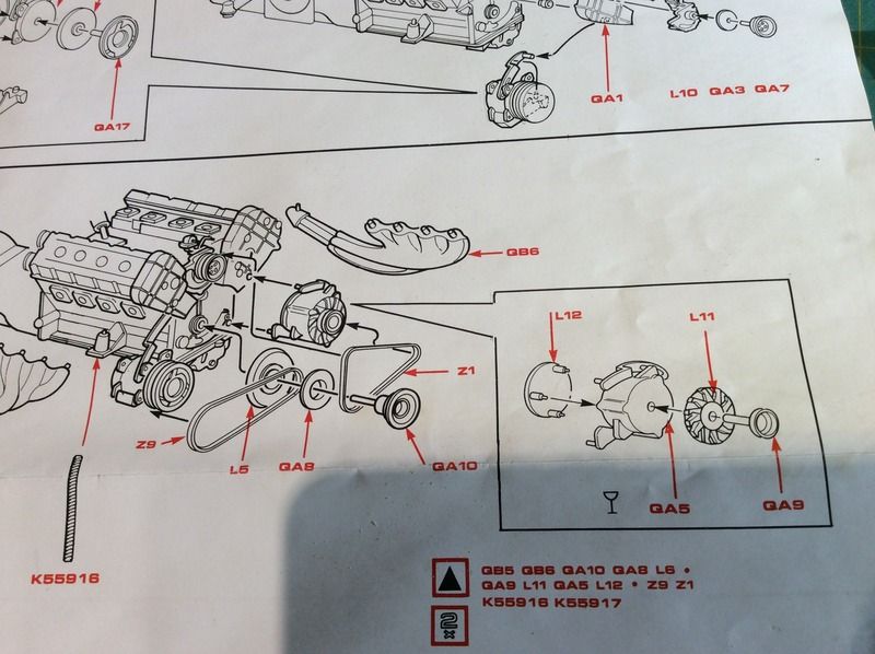

I think #27 might be the front of the alternator...I see similar in my Pocher kit I just started
Step 15 has a subassembly where a very similar front is added to the alternator...I suspect the wings bend backwards on the PE #27...that is the alternator, no?

1 & 2 are engine covers for the testarossa
#3, 4 & 5 are all exhaust and intake manifold gaskets.
6 I think are bonnet or engine cover straps for the F40
7 is a pulley face
8 looks like the gas pedal that you fold. They are usually like this in the smaller kits
9 are brake rotors
10 might be a key ring
my best guess on 11 is the mount for the gas pedal. You'll need to fold it up and see if it lines up
not sure on 12
13 definitely looks like straps for the engine cover and bonnet
14 looks like a pedal face or a foot plate for the passenger side
15 looks like some sort of gaskets for the Testarossa. There are 12 and it's a 12 cylinder
16 might be button or switch faces for the console on one of the cars
17 are air vents like you said
18 has always baffled me. MAYBE a vent for the front of the car
19 are speaker grills for the testarossa
Don't know about 20
21 I am not certain either. There is 10 which doesn't make sense. The F40 and TR are 8 and 12 cylinders, so not gaskets.
22 I don't know
23 should be a seat belt buckle
24 dash panel
25 I think are bezels for the console or something, to go around the buttons.
26 is a bezel of some sort for the interior
27 is an alternator blade
don't know 28
29 should go where the half shaft mounts into the tranny. Look at the kit and you'll see where the shafts go into the transmission there will be the mount with the bolt heads on it.
30 seat belt parts
31 pulley face
32 not sure. vent of some sort
33 no idea
