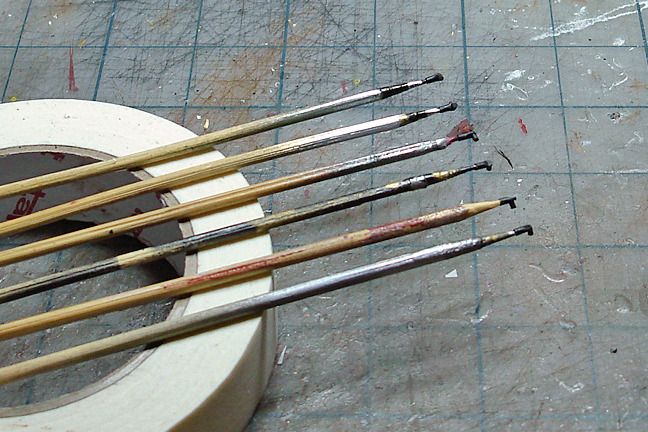

I made boots for the spark plugs out of bits of aluminum tube and painted them flat black before installation. You can see that I stuck them on the end of shish kabob skewers to hold them while I painted them. These skewers make great "handles" to hold various parts for painting... they have 1,001 uses!

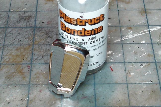

I like to skip around when I build a kit... I usually don't do step 1, then step 2, then 3, etc. I decided to put aside the engine and chassis for a while and handle some of the details. Let's start with the radiator shell. It has the open mesh molded solid. I could have tried a black wash to bring out the mesh detail, but the mesh is so faint and shallowly molded that I didn't think a wash would do. Here's the kit piece as is...

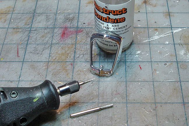

I decided I had to open up the grille shell and replace the molded-in "mesh" with real, open mesh. Also, the plating on this piece was really nice, so I wanted to save it and not mess it up while I reworked the shell. That meant cutting out the mesh area using a couple of Dremel cutting/grinding bits, and being very careful and working slowly...
Once I had the shell opened up, I cleaned up the bare edges, and added a strip of foil to cover the bare edges. Then I made a template of the opening, using an old business card. I folded the card, and held it over the outside of the shell and traced the opening from the inside. I added a bit all around so that my new mesh piece would have enough edges so that I could glue the mesh in place from the inside. Then I transferred my template to a piece of foberglass window screen, cut the mesh piece out, sprayed it gloss black, then "chromed" the mesh with Spaz Stix:

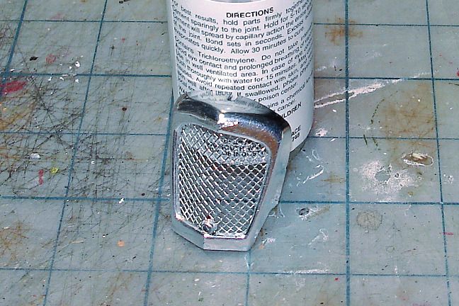

And here's the end result:
You can even use them for eating Kebab!

Looks like he just cut around it and left the original in place????
Exactly. I just carefully cut around it using that need-nose grinding bit in the photo.
Yep, awesome, was hoping you were going to do that

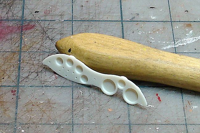

Notice in the above photo, however, that the dash has all the control knobs and switches molded in place. Getting that dash decal to snuggle down around all of those protrusions, and then detail paitning all of the switches and knobs, would be impossible. So I decided to remove all surface protrusions to allow the decal to be used. I drilled a small locator hole where each knob/switch had been (and added a couple of locator holes for items missing on the kit dash) to guide me when I replaced them all with scratchbuilt items:

Ok, the decal idea didn't go so well... :lol:
I do want a "wooden" dash, so there are two ways to go... either cut a piece of basswood to shape, drill out for all the gauges and control knobs, sand smooth, stain, sand again, then several coats of Future. Lots of work for such a small dash.
Option two: just paint the dash a "wood" color... at this scale, it would be visually almost impossible to tell if the dash was painted or real wood.

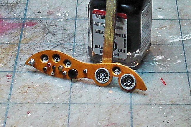

I went with Option two. I simply painted the dash to look like wood, and added bezels to the main gauges made of rings cut off of aluminum tubing. The minor gauges should have bezels, too, but I don't have the correct diameter tubing on hand, so I'll add those later. I scratchbuilt all the knobs, switches, and warning lights on the dash, everything made of aluminum tubing and sewing pins. The large black knob near the center of the dash is actually a leftover Pocher breather cap! And the slot for the ignition key is a leftover Pocher screw, the slot in the screw head makes a good key slot. :D
And yes, I know the gauge faces are not factory correct (they are the kit supplied decals)... but since my Jaguar owner switched out the stock dash and replaced it with a custom piece, he also switched out the gauges and replaced them with aftermarket ones... :P
