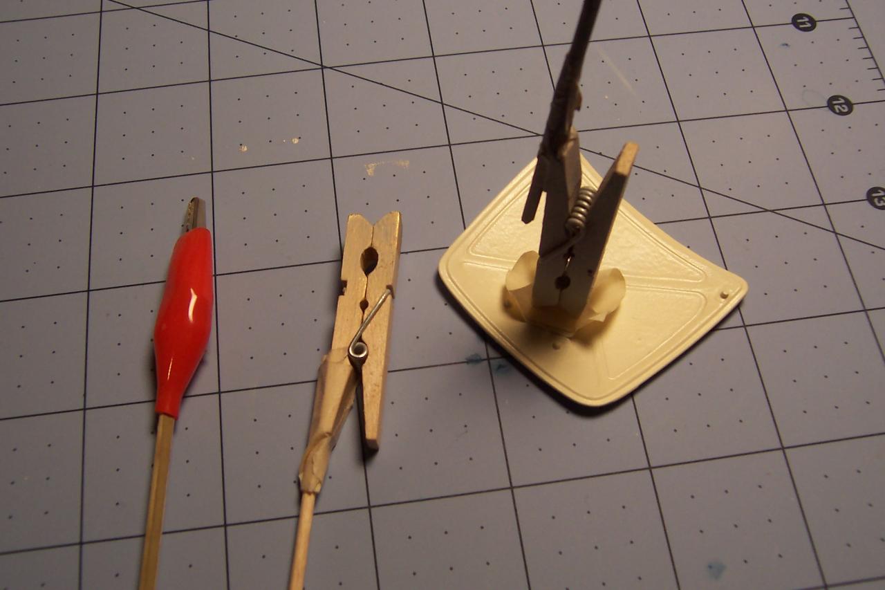

Drilling a small hole in a face of the part that won't show after assembly, and using a toothpick or wire, possibly lightly glued in the hole, is preferred.
For flattish parts where both sides will be seen when finished, like a hood for instance, I'll use double-sided tape to hold the part to a wooden stir-stick for painting...one side at a time, obviously.
As far as glue drying during assembly, I only use liquid cement for sub-assemblies, and you can just hold the parts together for the minute or so it takes for it to do its thing. You can make other creative jigs and fixtures from old wood clothespins, alligator clips, various kinds of tape, etc.

I also use the Tamyia paint stand for the body, but lots of folks use less spendy alternative like wire hangers. For small part, I like alligator clips or clothepins taped or glued to the end of some kind of stick, drinking straw, whatever. Tape on the end of a stick can work too.
