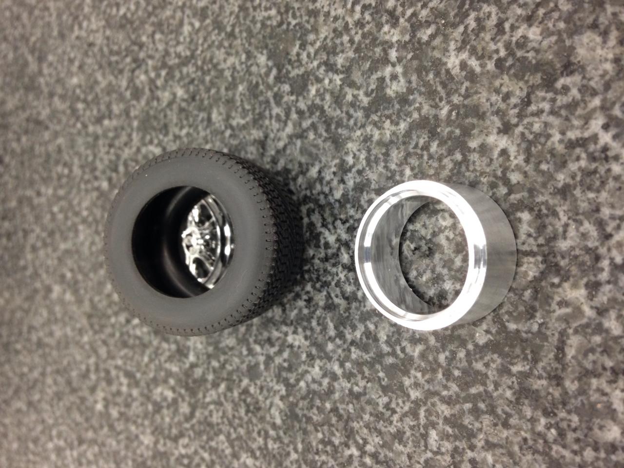

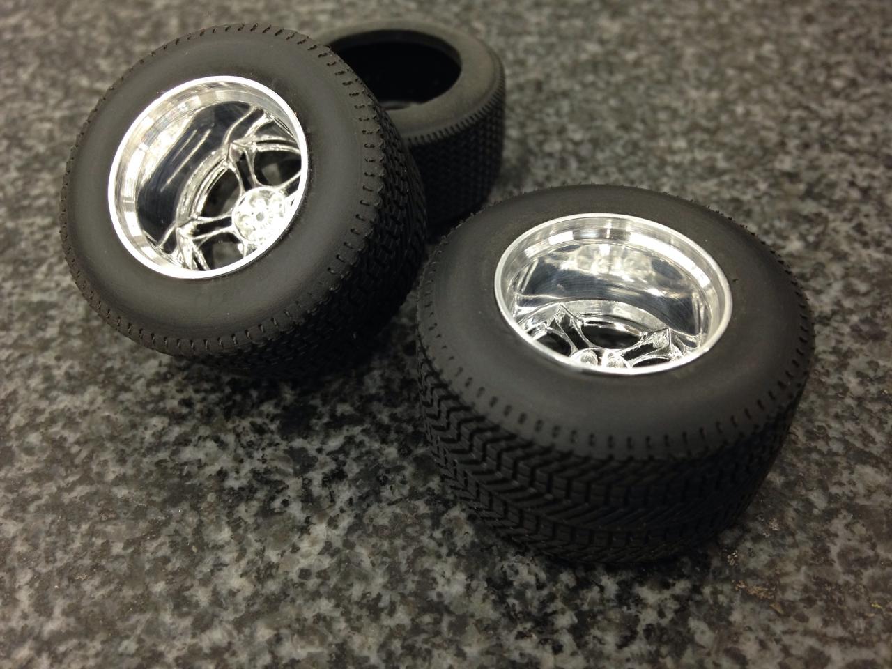

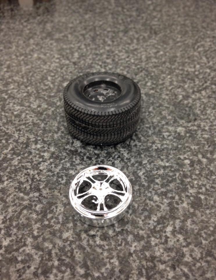

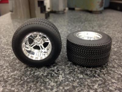

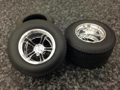

First priority , wheels and tires. I used Revell try 5 wheels and there
Firestone pro street tire . The pics pretty much show the process .

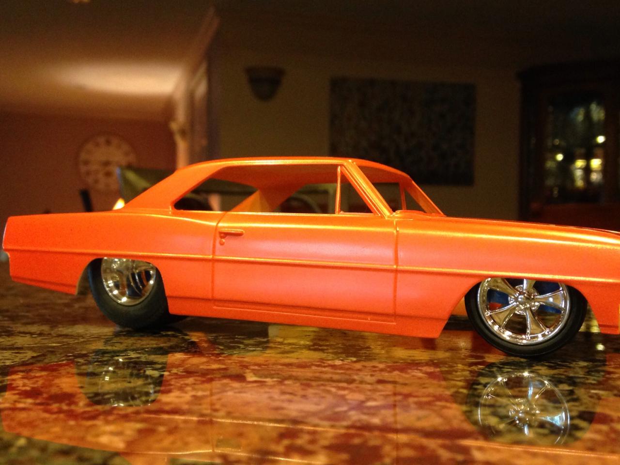

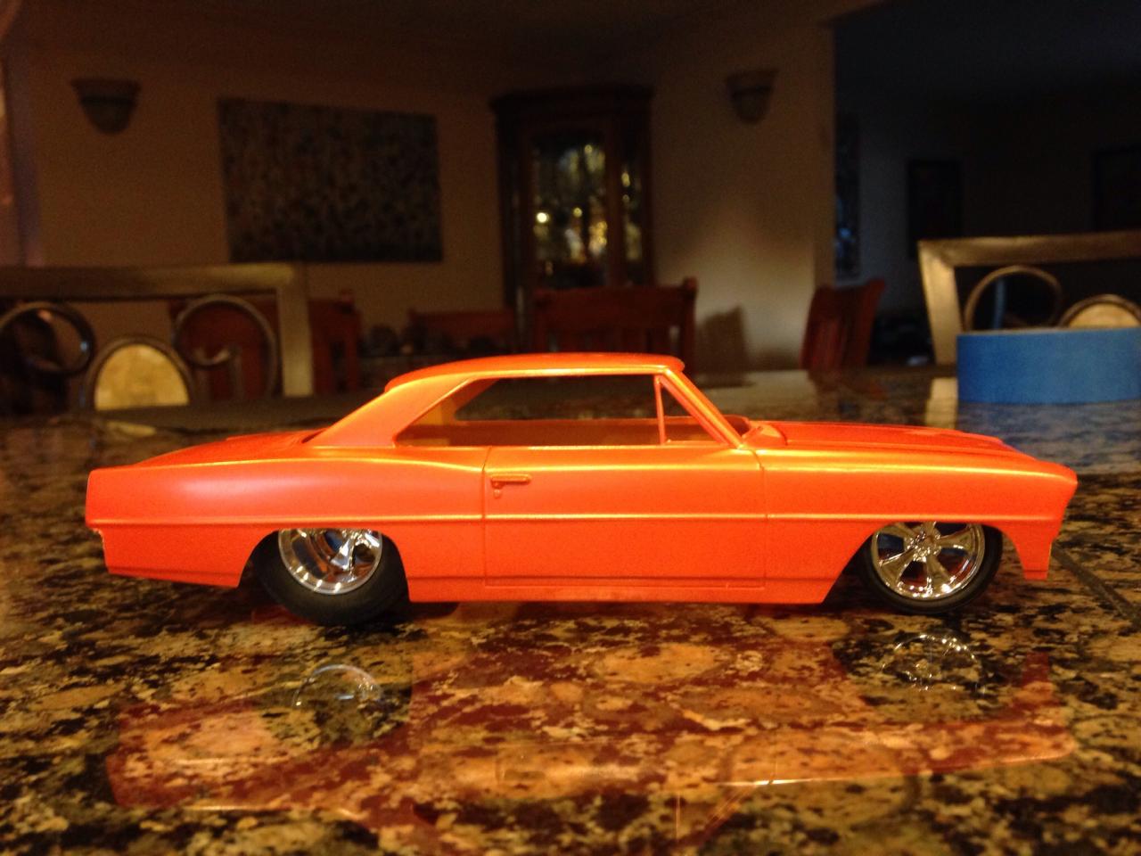

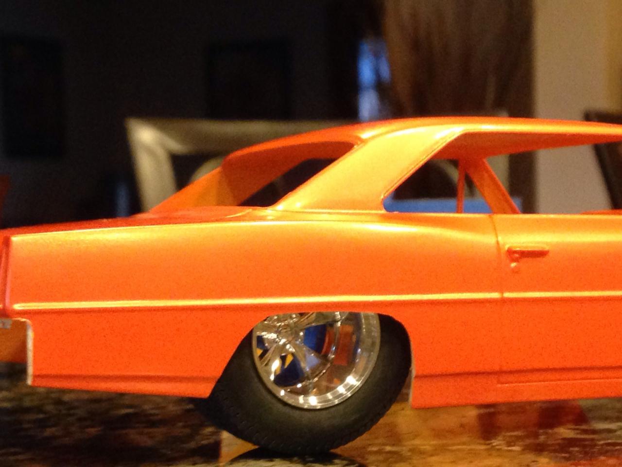

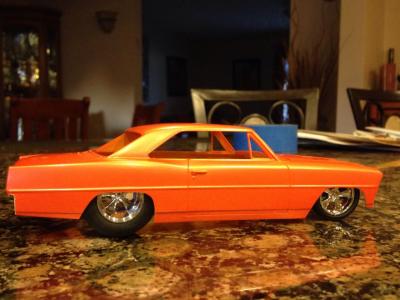

Had a little spare time to play. I'm using an old body for mock up purposes.
I switched to the 55 hardtop wheels same as the 67. Now it's time to stuff the
chassis under it . Thanks for looking in. Jeff

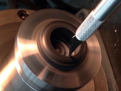

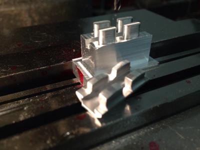

Hi Andy , thanks for your interest . I steady the blade movement with my
fingertip and just plunge in. Start with a smaller dia than your shooting for. Measure and adjust X axis.

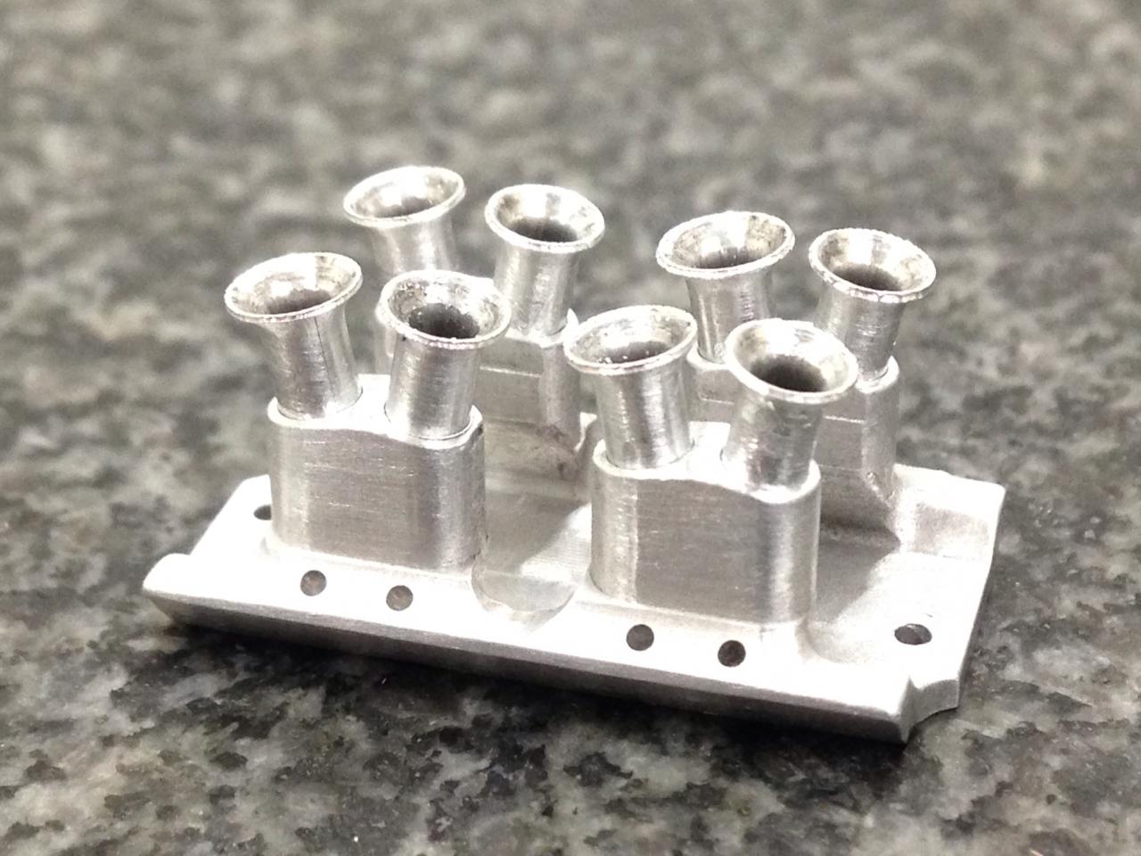

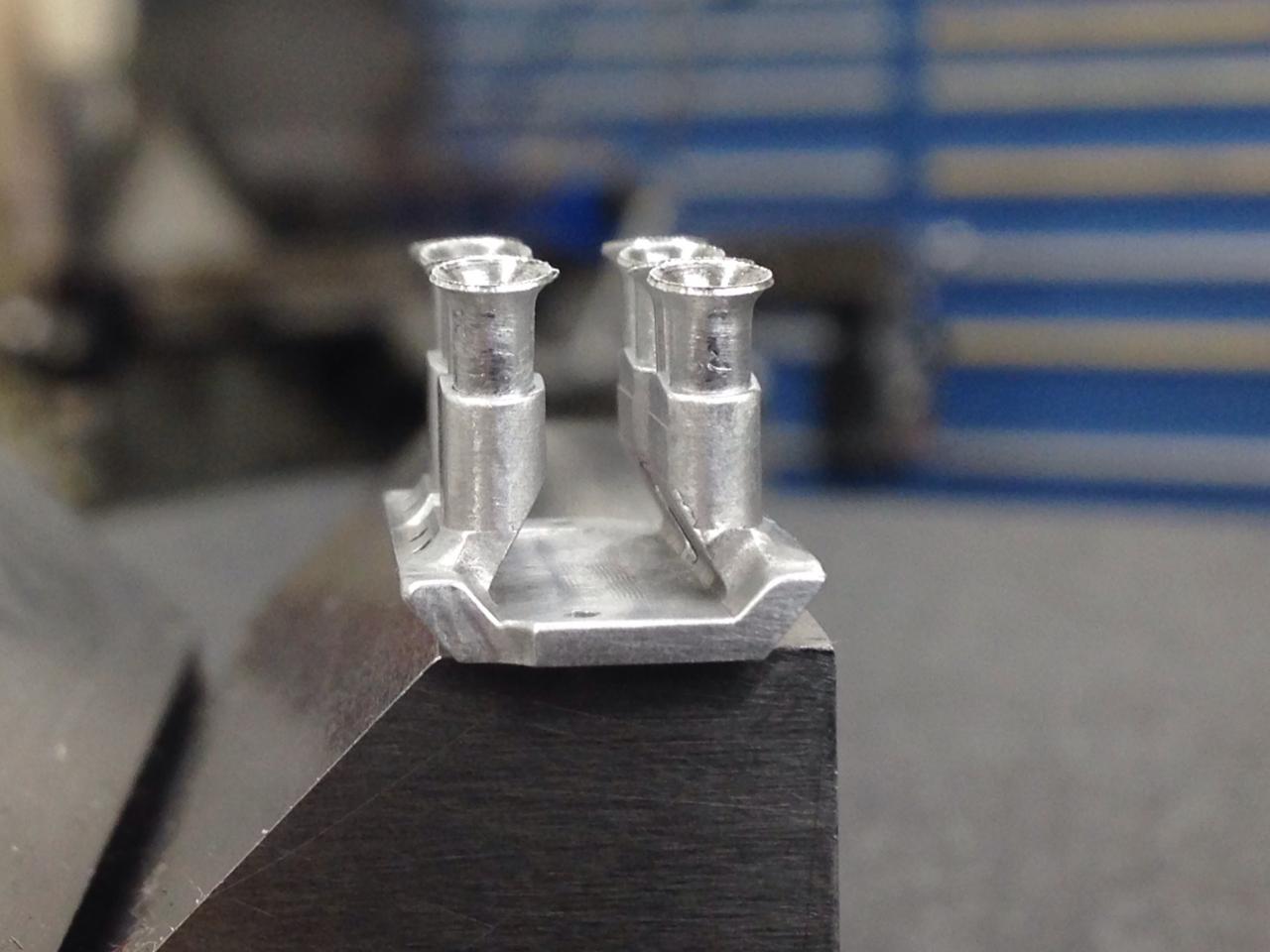

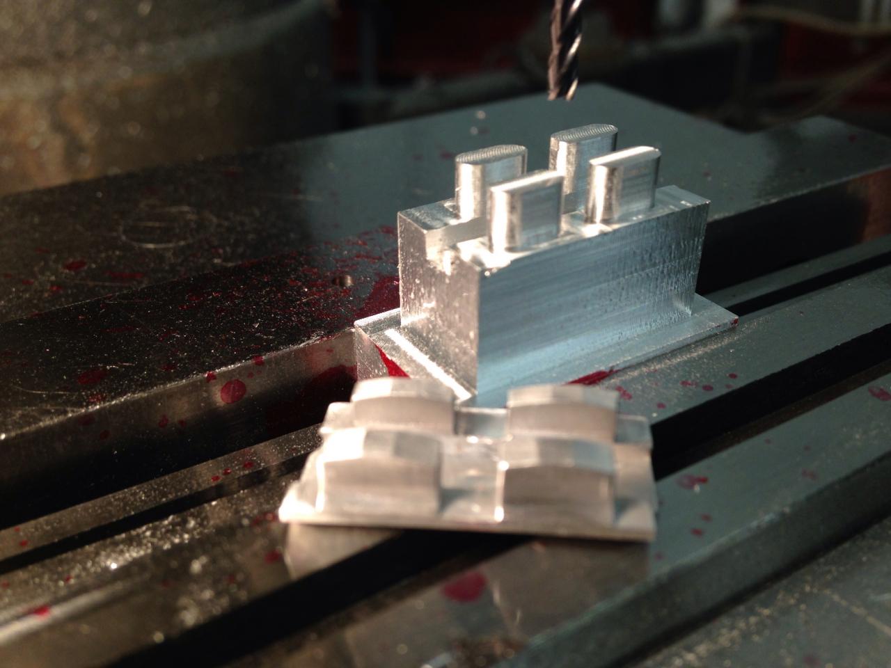

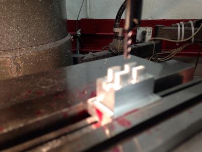

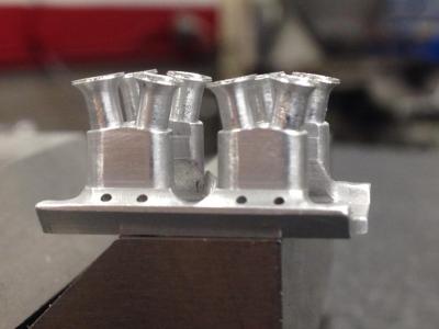

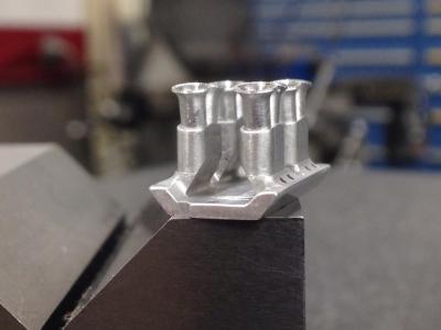

I've been looking at eight stack injection systems and desided that the manifold in the AWB kits are not correct. They direct the flow into the lifter galley, not angled into the cylinder head. So going to try and fab one up.
post-15078-0-64802100-1430402409_thumb.jpost-15078-0-22861300-1430402429_thumb.jpost-15078-0-98643400-1430402478_thumb.j
I finished up the manifold , then made the trumpet stacks out of 3/32 alum. tube. Each set are opposed 10 degrees from each other. I had a custom 60 degree dovetail cutter made to do the under cut. I think it looks more representative of the 1/1 part.
Thanks for the comments and time . Jeff
