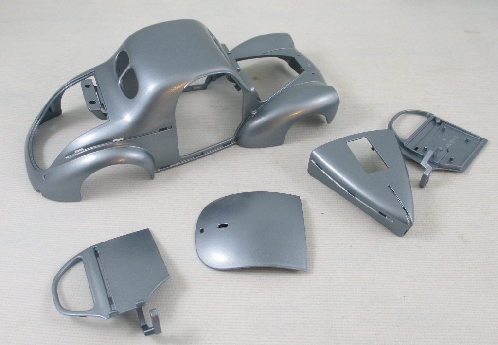

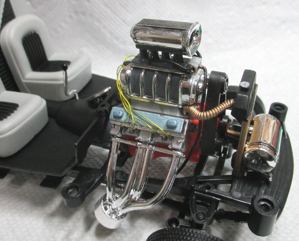

1/18 scale diecast 41 Willys. This is going to be a simple repaint and some small detailing.

That hinge thing is bloody brilliant!
I like the idea of a stock one, but how would you go about bumpers and wheels?
Thanks on the hinges.

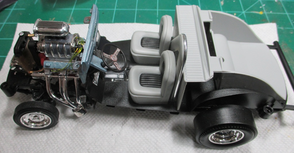

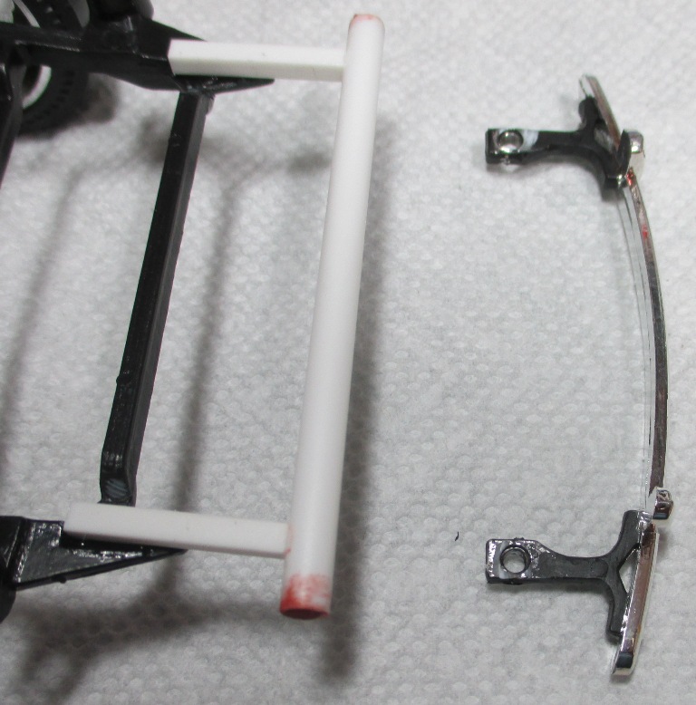

I'm changing the rear bumper on this one so I can use it on the front of the stock one. The wheels will be from a Henry J.

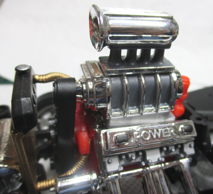

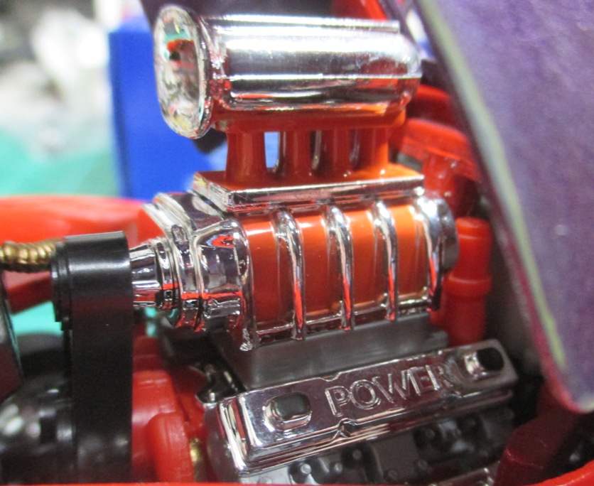

I took the "Power" off the valve covers and added plug wires and fuel lines.

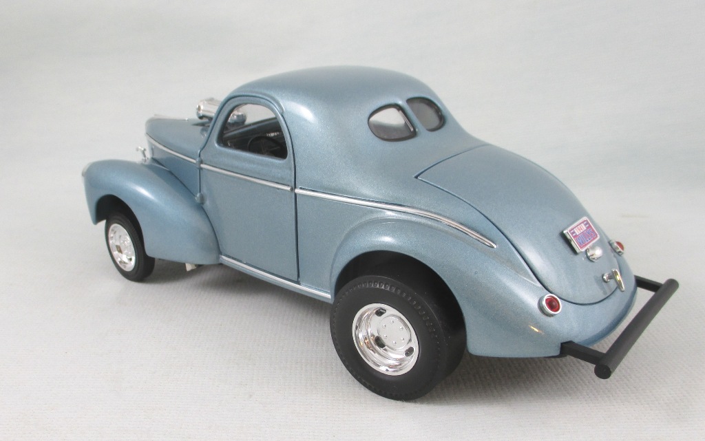

Changed the rear bumper to a pipe push bar.

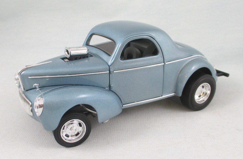

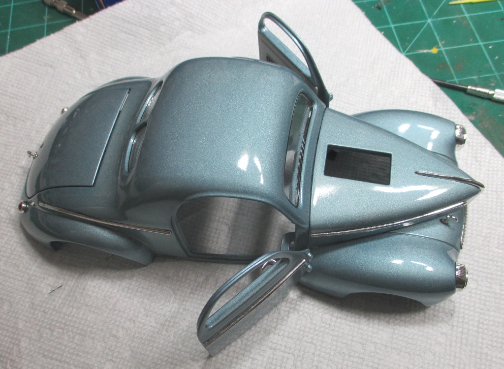

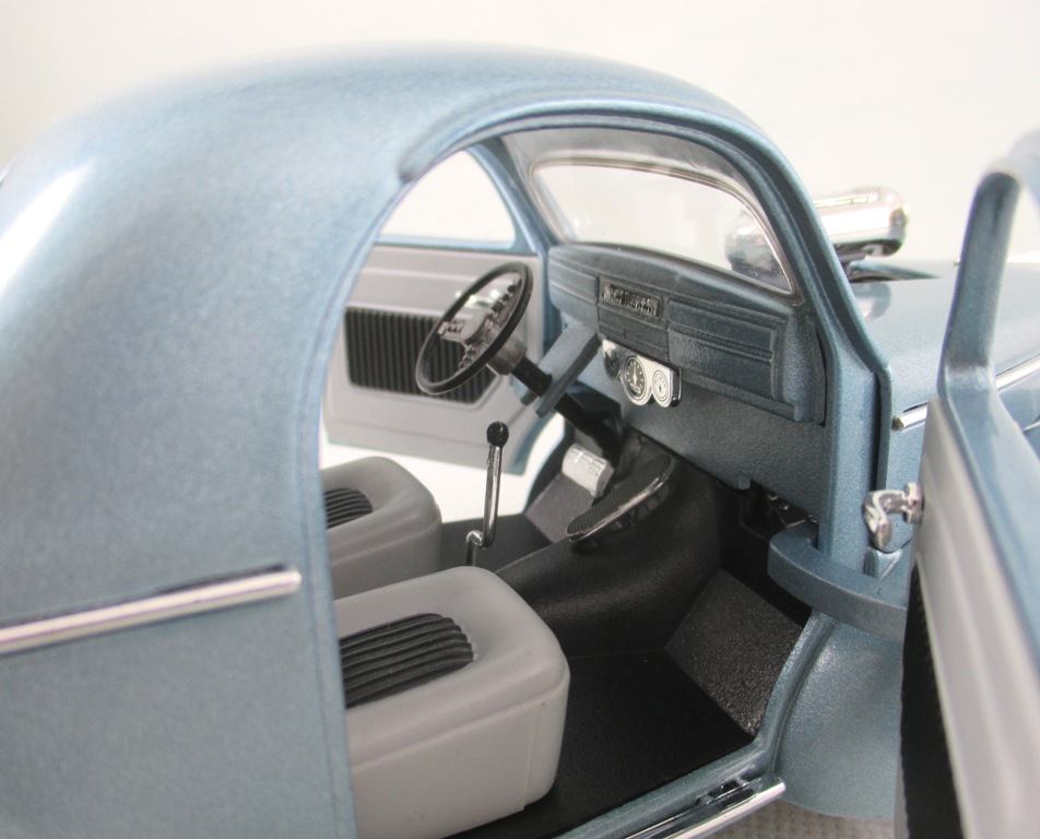

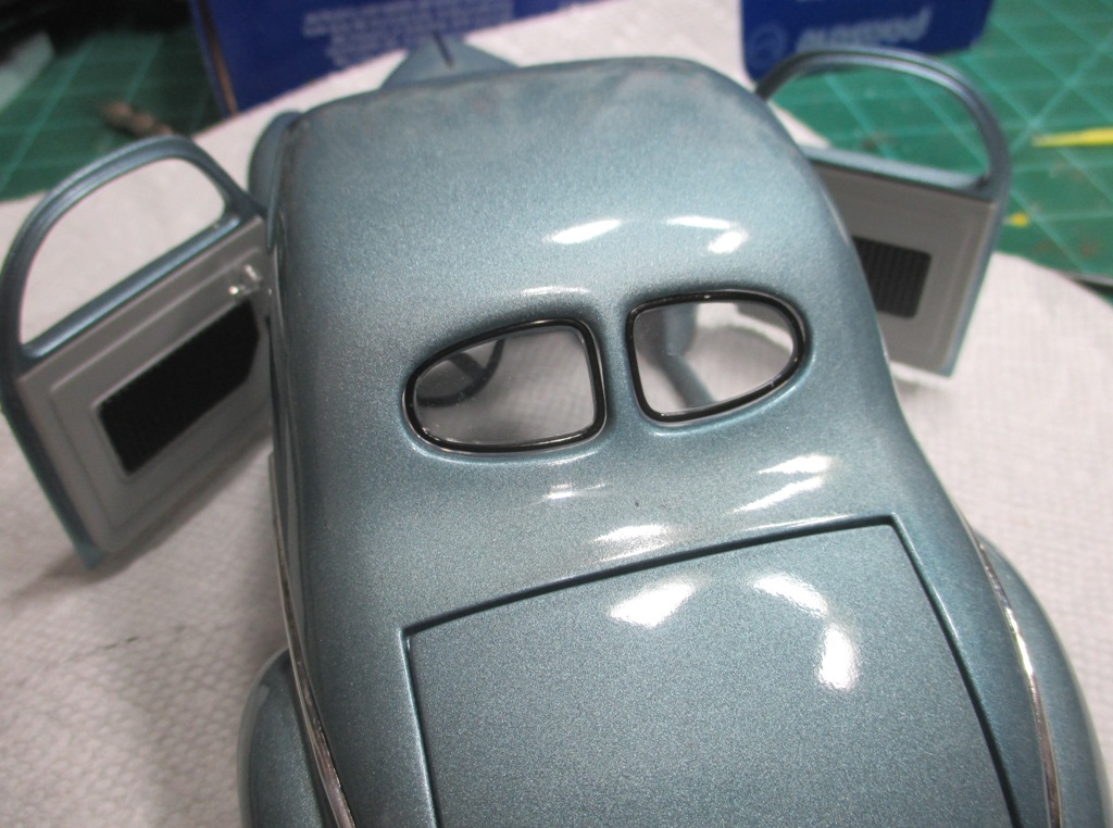

I got the body clear coated and the chrome back on. I also blacked out the chrome window trim as it should be rubber only.
I do. I normally use Dupont Self Etching but I have used other brand with success. On bare diecast it is a must to use self etching as the first coat.

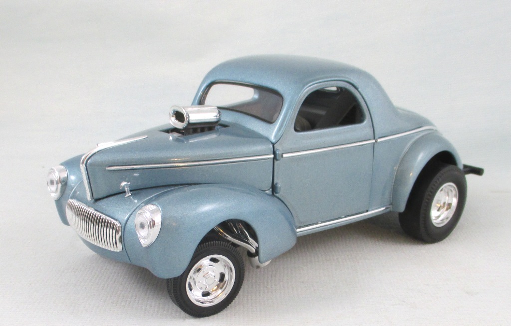

I finished it up except for the rear license plate. I have some 1/18 AZ plates made but need to find them.
Thanks for looking.
Thanks Harry.
Thanks David. I'm can't wait til the new Acme 1/18 40-41 Willys gets here. I have some coming in kit form.
Real nice job on that Willys. That so called "push bar" really is a tube to be filled with ballast to add weight to the rear end of the car. Gassers were street legal and had to have a starter. They did not allow push starts like on the early dragsters of the 50's & 60's.
The color is Silver Blue Metallic # 28145 from the Model Masters Lacquer System. I used Dupli-Color acrylic lacquer clear coat. Both are rattle cans.
