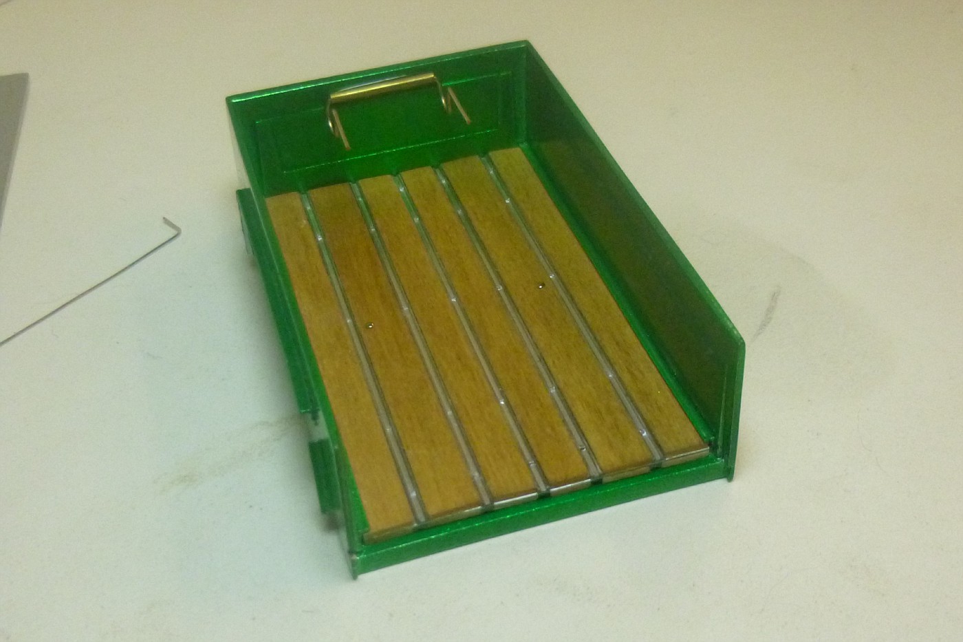

I started in on the bed floor by cutting my Basswood into strips and getting the retaining straps cut to length...
The mock-up, wooden strip, a strap, etc, etc. All this just to make sure I've got a good fit before I use any glue.
And the bed completely mocked-up...on the top side at least.
Once I was happy with the various pieces, I cut the bottom pieces to match, and marked each wood strip's location so I know where they belong.
Next up was putting one wood slat in at a time, then gluing the retaining strap tightly against the wood strip. It came out great, I think I'll keep this method, it works well!
I removed the wood, and this is how the .010 sheet of styrene looks with the retaining straps glued down.
A quick shot of the bottom side, the retaining straps are glued down here also. I need to add the cross bracing and the mounts for the frame still.
And a couple of shots of the whole assembly slid out of the bed, this was way too easy!

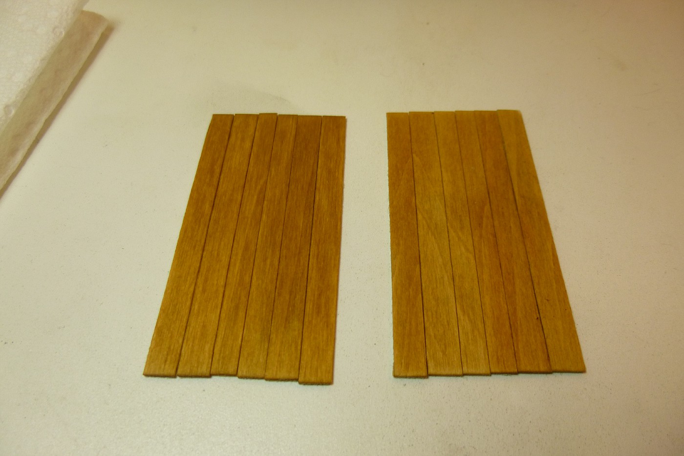

I located my stain and prepped the wood for some color. A bit of sanding to smooth out the wood, and some stain was applied, making the boards look nice and pretty!
A bit of 220 gets the wood all smooth and ready for...
The stain! Easy to apply (I used a paper towel!), and it makes the Basswood look great!
The wood is all finished, I'll hopefully be able to get the bed floor all together tomorrow. I've still got a lot of work to do on the retaining straps!

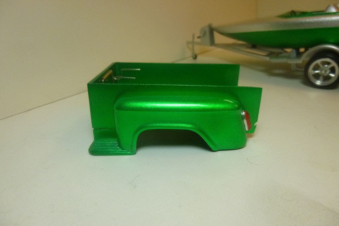

The next step was making a way to get the rear fenders re-attached to the bed. I started by holding the fender in place and drawing a line inside....
Then I glued some angle strip styrene to the line, giving me a place to glue the fenders to!
A nice tight fit, this should work out just fine!

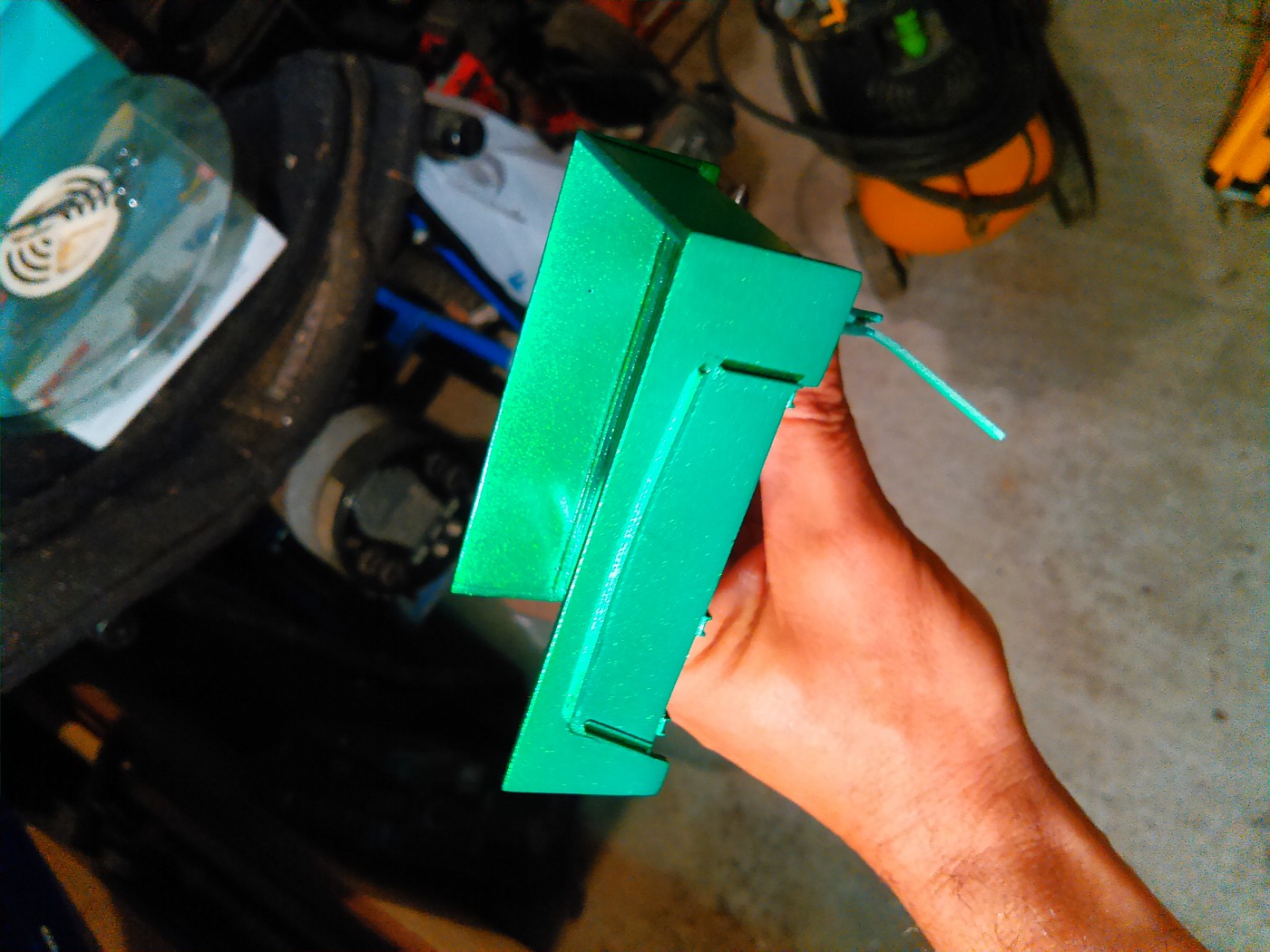

And finally, I came up with a devious way to attach the bed to the frame, and get the bolts that attach the bed to the frame on the 1:1 in there to, here's what I started with, I'll explain the rest later, wait for it!
Now, back to the bed floor, already in progress....
I buffed the Aluminum Plate up....

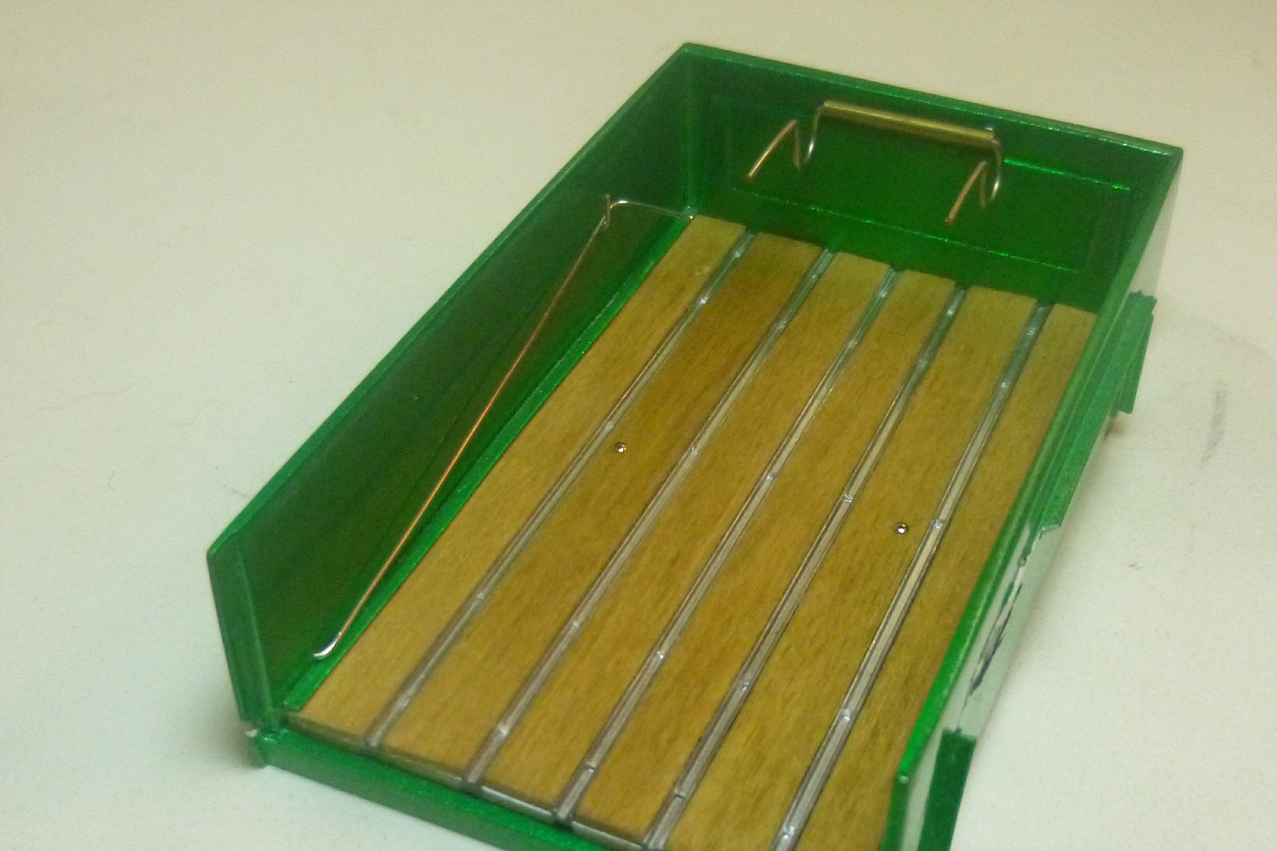

And glued the wooden strips in place! A quick mock-up in the bed....
I left the center slats out of the bottom just so I knew which side goes up!
Remember a few posts back I said I found a way to attach the bed to the frame just like the 1:1? Well, here's the proof. I took the original bed floor from the kit, and drilled holes straight through the mounting bosses. Once they were drilled, I laid the original bed floor onto the new floor, and drilled through the new floor using the original floor as a template. The next step was cutting some straight pins to go through the bed and into the frame. Turns out my modifying the slat layout affected this part, but it's nothing major. Turns out the bolts at the back of the bed would have ended up in the retaining slats, so I'll just find a way to attach the back side of the bed another way, but the front two "bolts" fit perfectly, and it looks good to boot!
You can see where the rear bolts landed in this picture, look just behind the center bolts on the top and bottom retaining straps and you'll see where the drill bit landed in the straps instead of the wood. I just shifted the "bolts" inward on the top side and clipped some straight pins really short for those two.
The last bit of work for the bed today was to add the cross braces back onto the bottom side. the old bed floor was once again used to show me where they needed to go, and some styrene c-channel was glued in the proper locations!

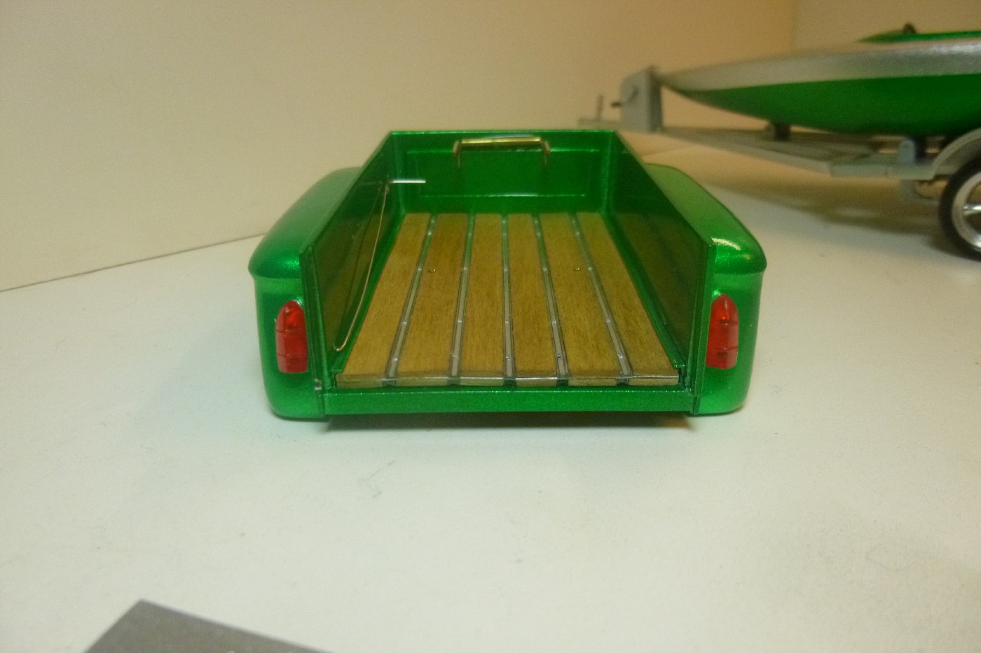

I mocked-up the entire bed to see how it all looks together, and I'm very pleased with how it came out, especially considering how horribly bad this bed was to start with.

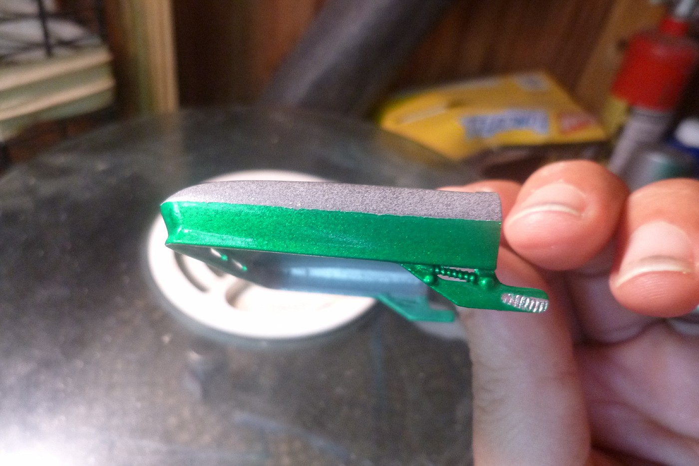

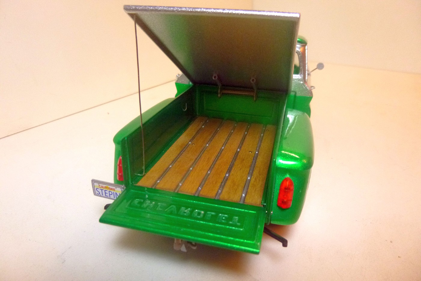

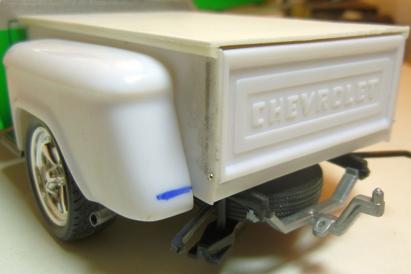

Looking at the back of the bed cover, I need to add something to cover that gap between the bed cover and tailgate...looks like I've got a bit more work to do on that part!
This shows the tailgate, it pivots on two straight pins, and a good shot of the new bed floor in place, enjoy!
Edited by Custom Mike

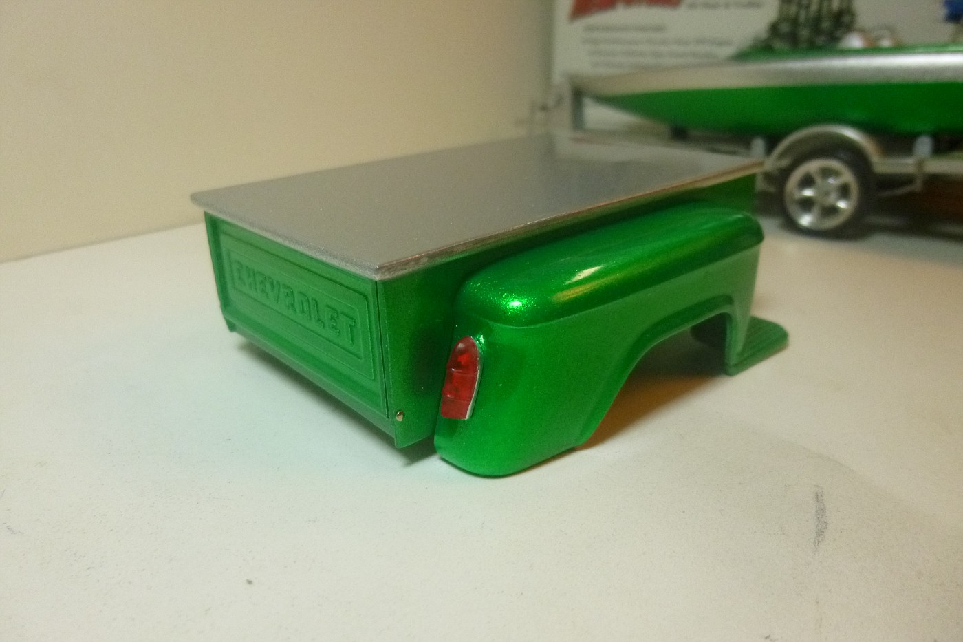

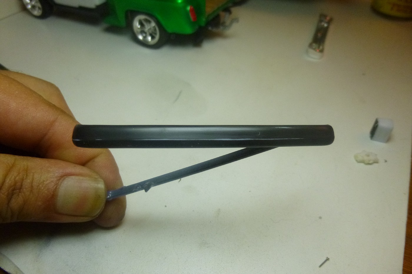

I capped off the back side of the bed cover with some half-round strip, blended it in and called it good. Then I glued the tubes for the hinge onto the underside of the bed cover, now it's all ready for primer. I added a prop-rod and hook for holding the cover up while I was at it, and it actually works the way my twisted mind envisioned it, who would have thunk it?

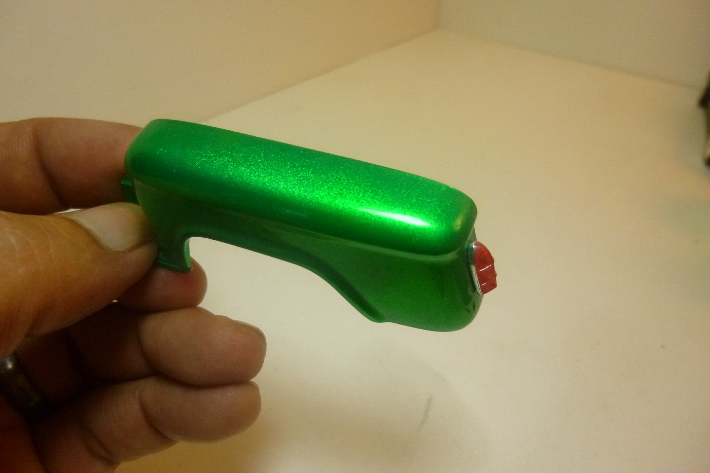

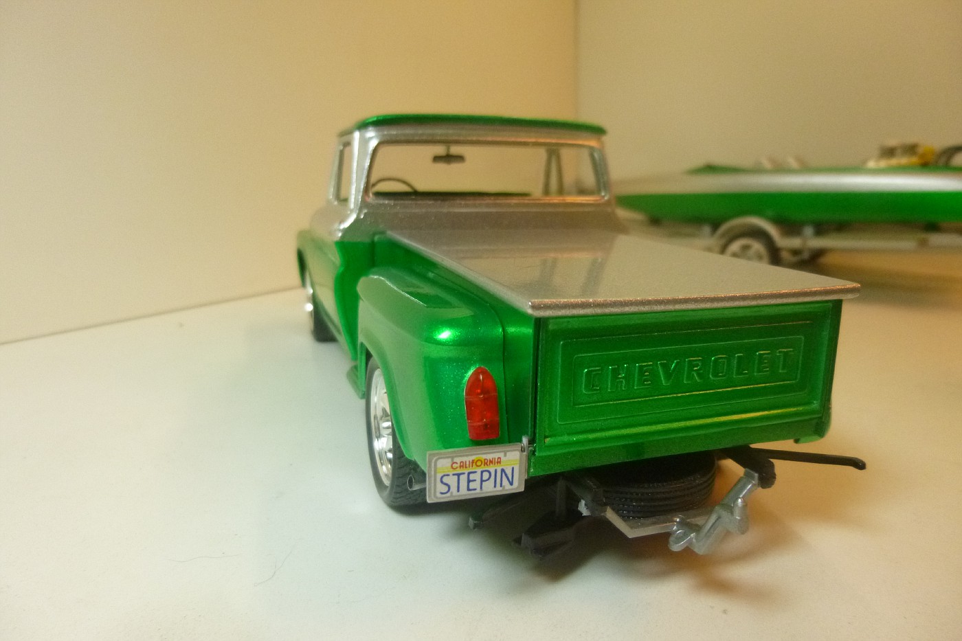

I dug into into my tail light stash, and I dug out what look to be '55 Caddy tail lights. I cut some sheet styrene out, drilled two holes in it for some straight pins. The pins serve two purposes, they look like bulbs through the lenses, and they give me something to attach the tail lights with!
Tail light laid on the fender...
Styrene backer cut out and drilled....
Pins glued down...
A quick mock-up, now to apply some glue!
And the backer trimmed up. Once it's all done, the backer will get some foil!
New tail light mocked up on the fender....
And an overall shot with both in place, these are my final answer, no more changes from here on out!

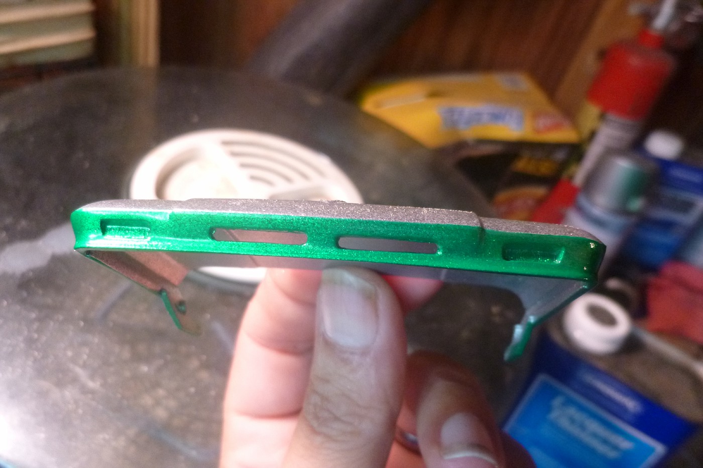

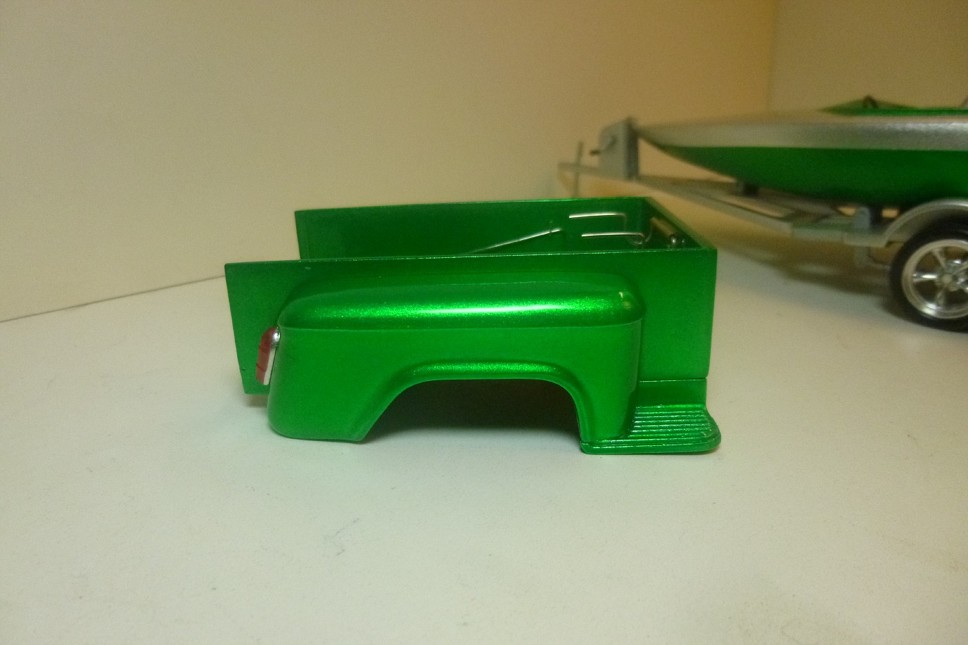

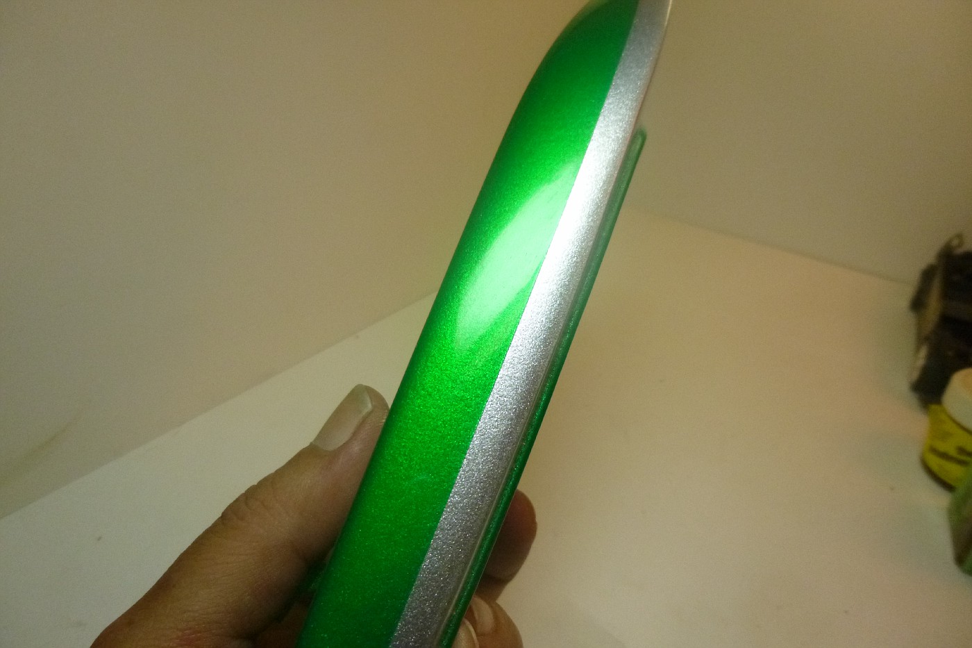

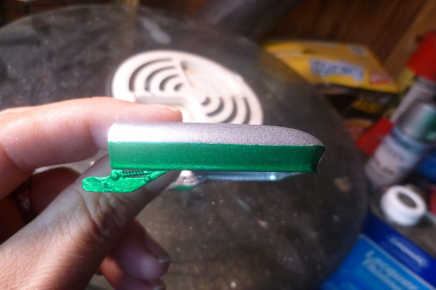

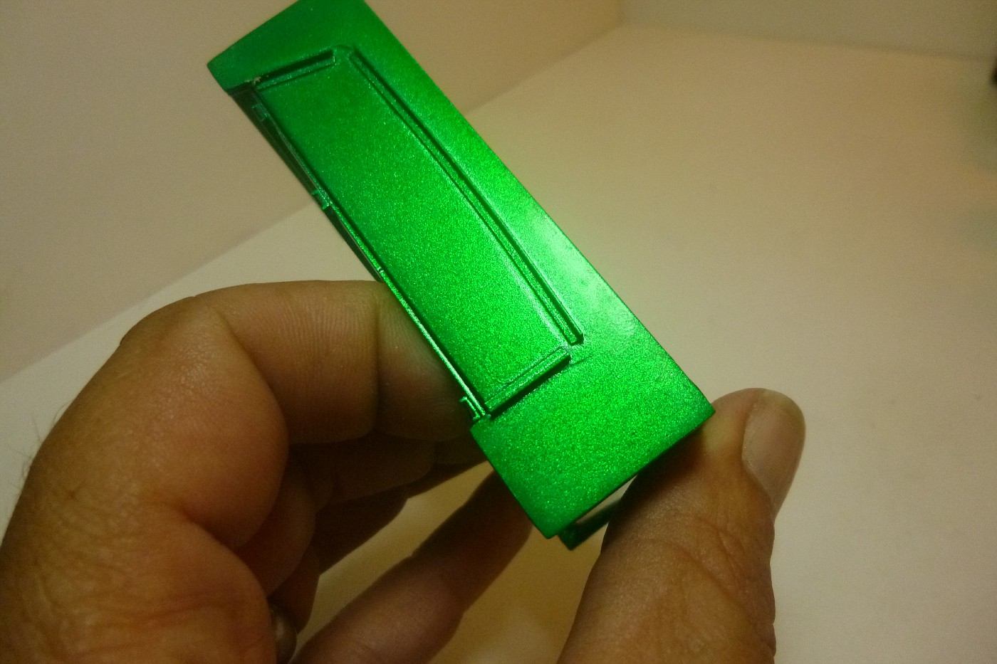

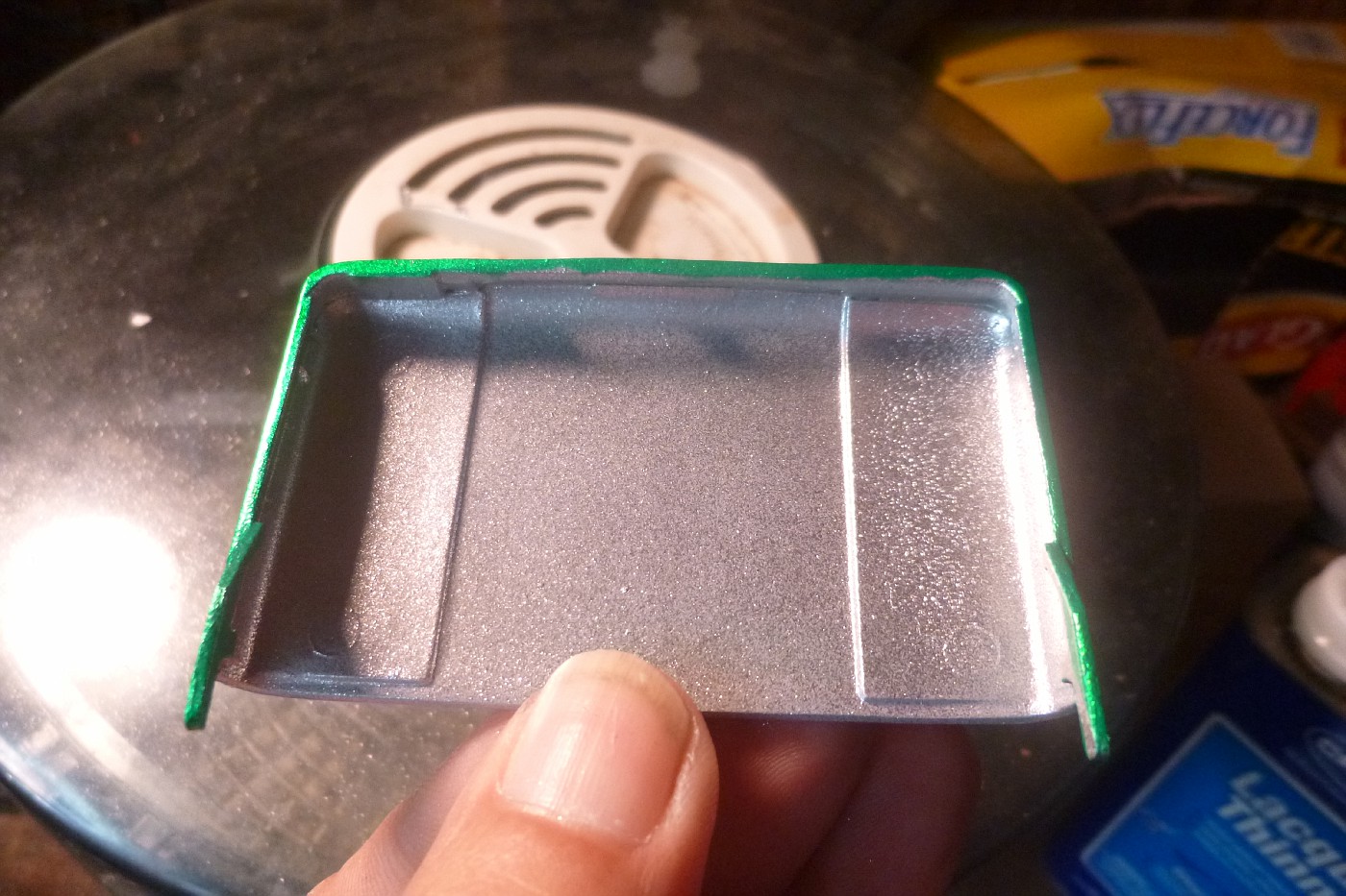

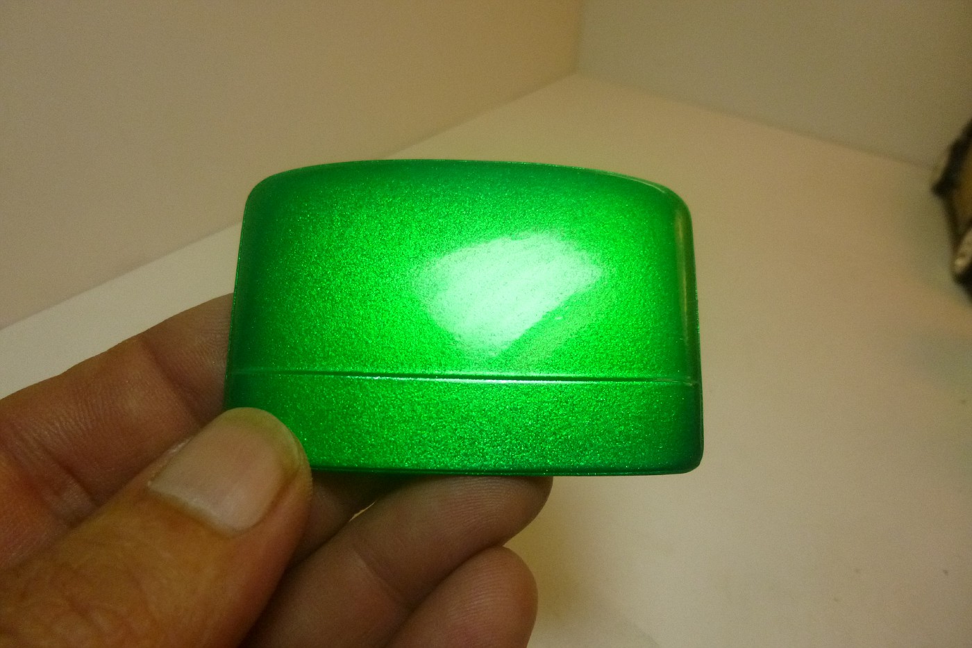

I got all the parts together for the bed and laid down some Candy Silver painted, I forgot to take pics of the back fenders, but they came out great!. This should be re-masked and sprayed with some Candy Apple Green soon!
A few more. I had to do a bit of fine sanding on the bed and tailgate, but nothing major that will require more silver, thank God!

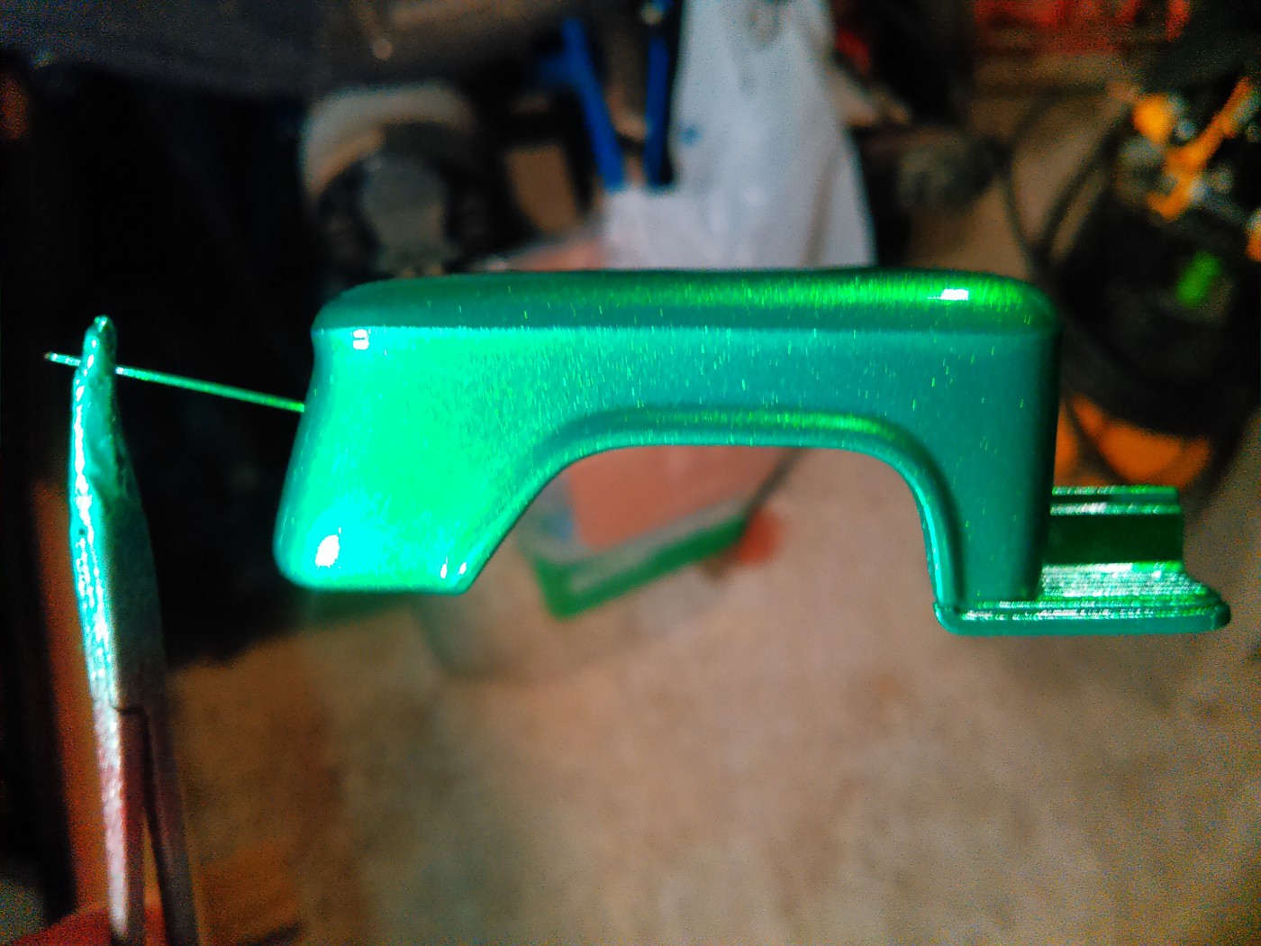

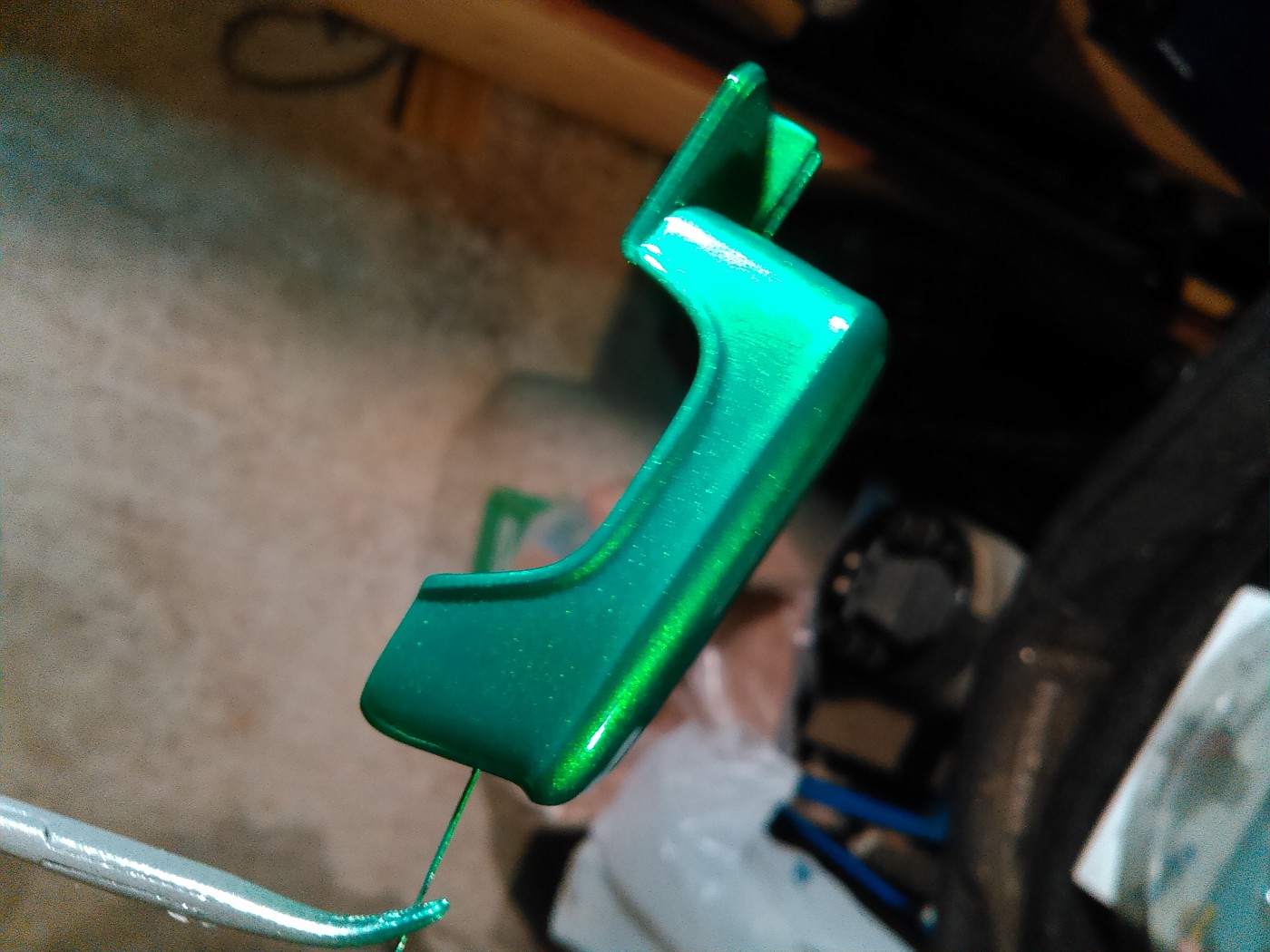

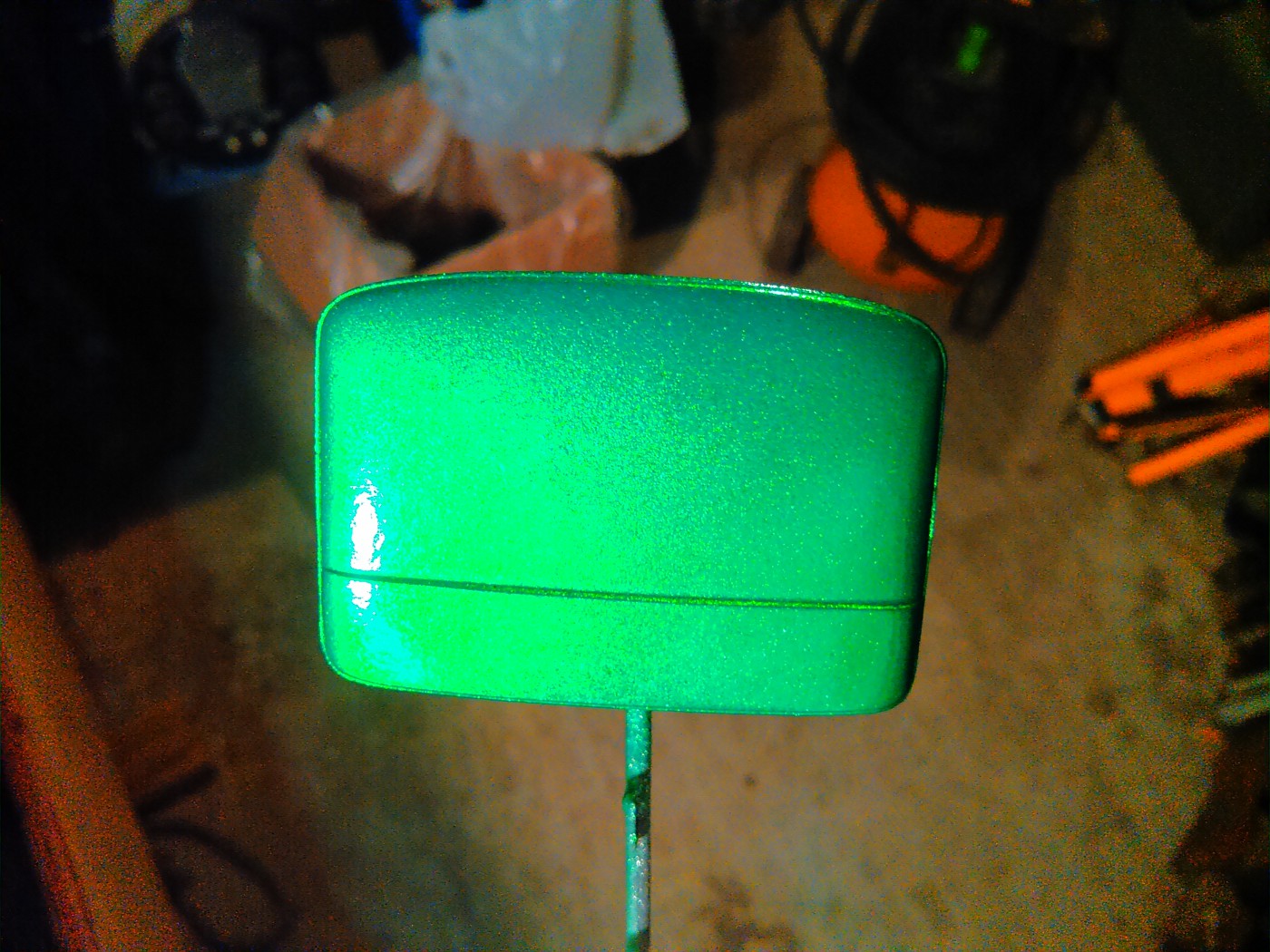

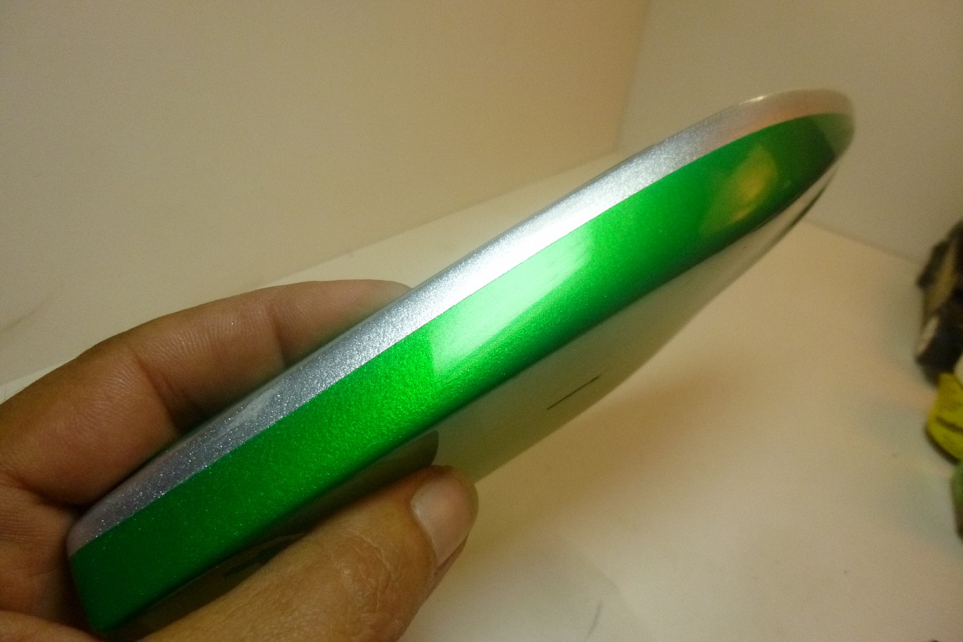

And the last update for tonight, the bed parts and the roof panel wearing their final coats of Candy Apple Green!

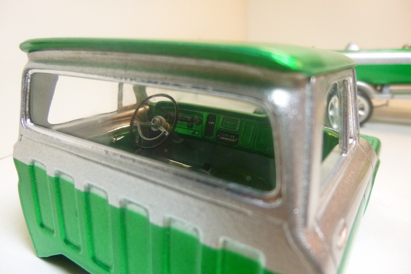

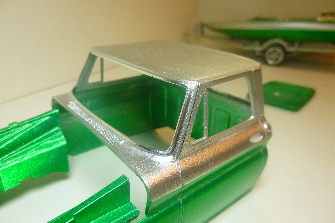

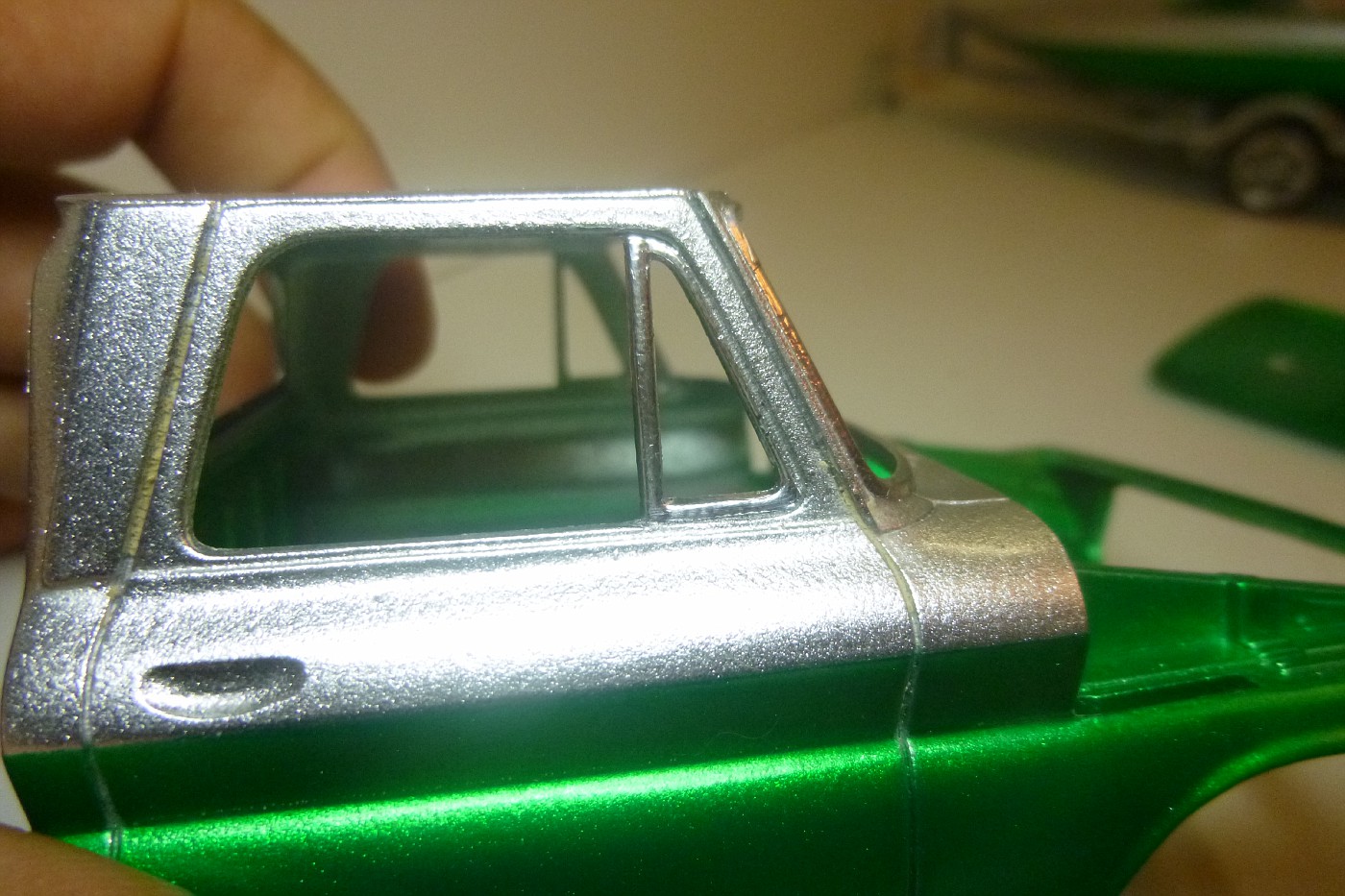

Alright everyone, we have everything polished up and ready to go together...except the hood, it's waiting to get masked and sprayed with some Candy Apple Green. Enjoy the pics, lots more to come!
The rear fenders didn't even need any polishing, I just hit 'em with some Meguiar's #7 and called 'em good!

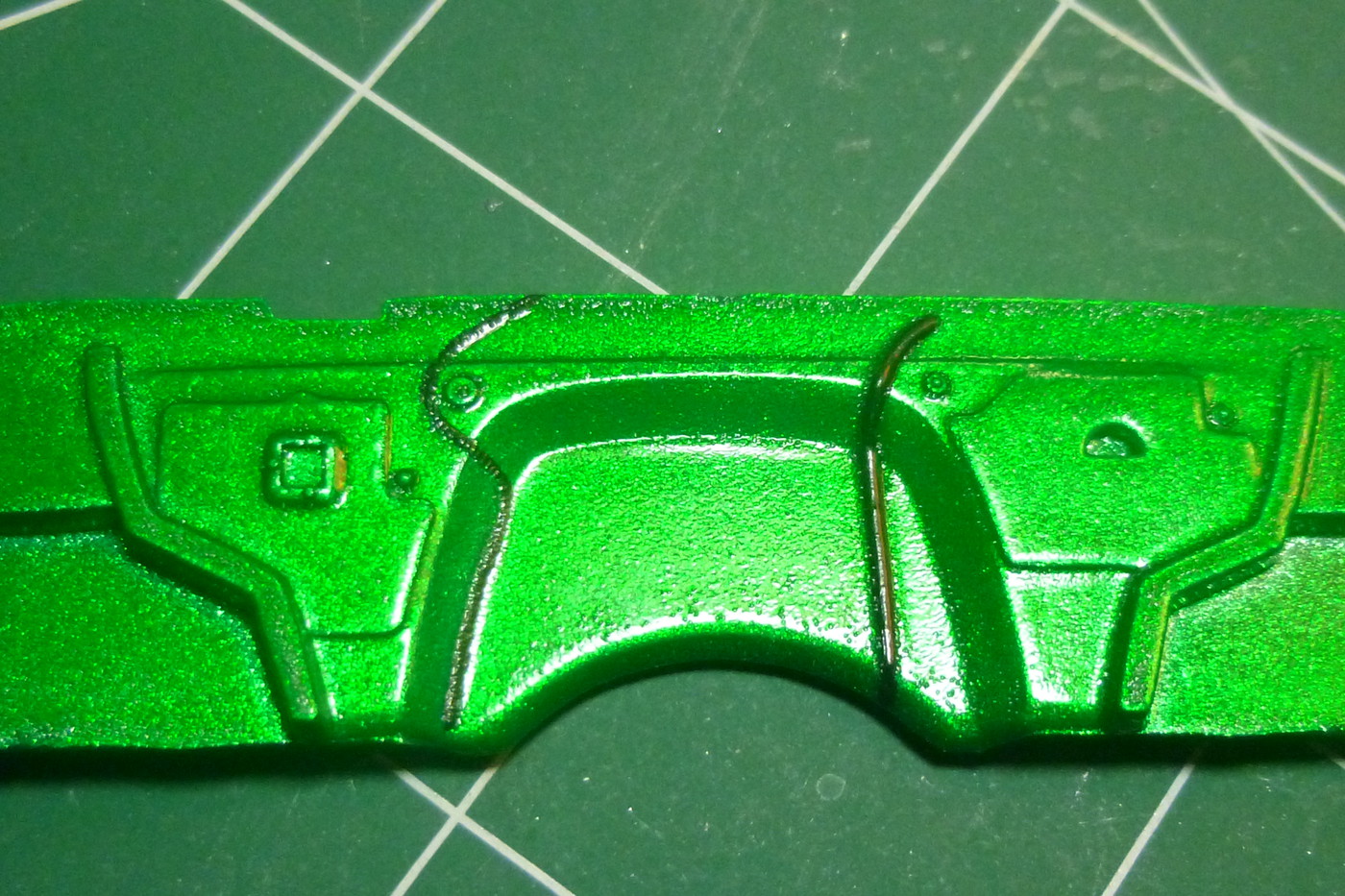

The hole that the tailgate attachment pin uses cracked somehow, and left this beautiful looking missing area in its place...we'll see what I can do to either hide it or fix it....

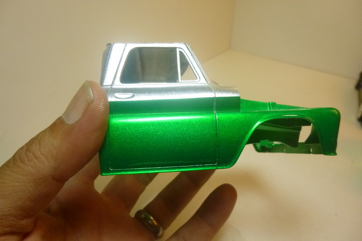

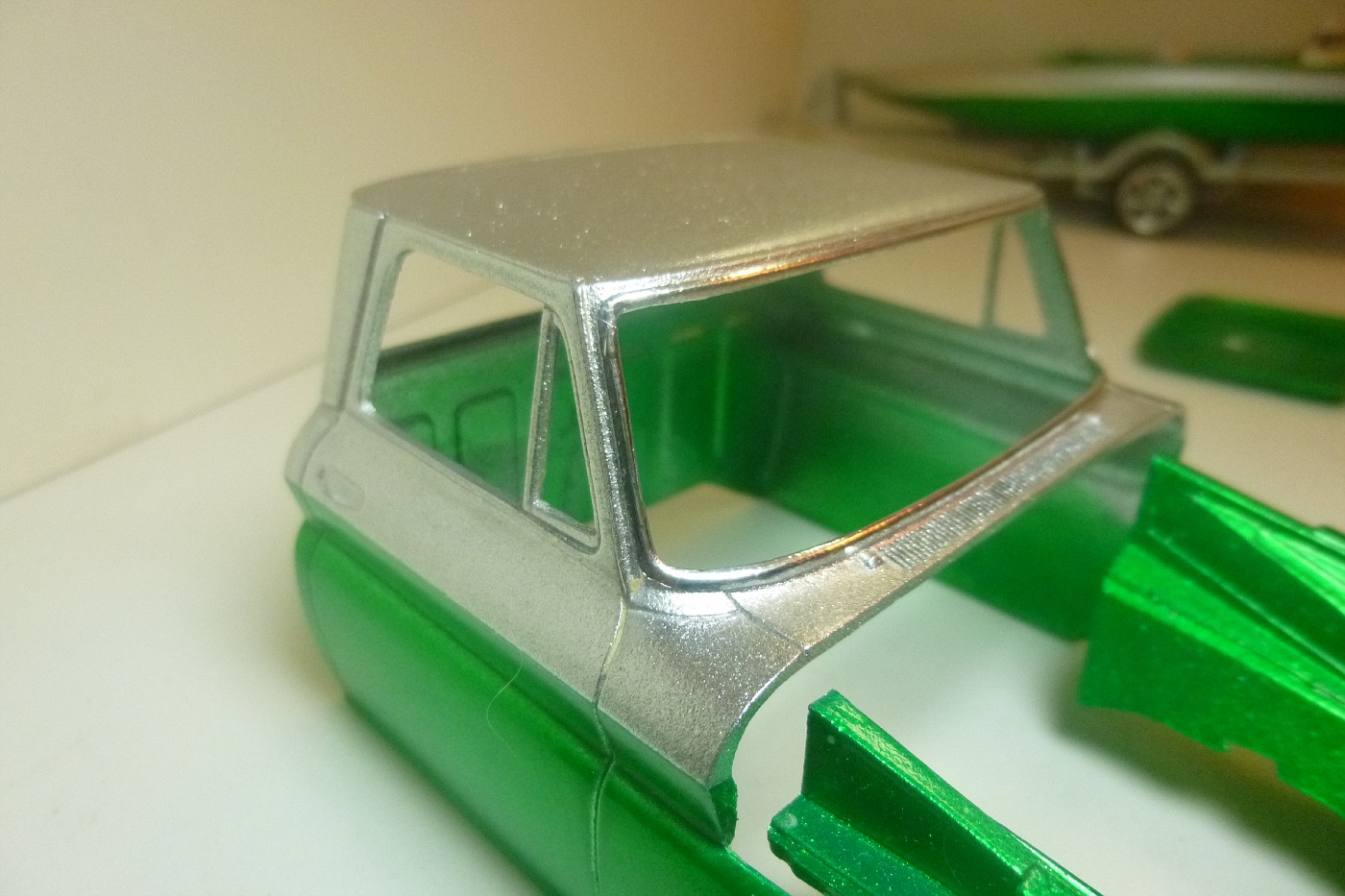

And the cab. I'm very happy that I messed up the paint, it came out so much better the second time around!

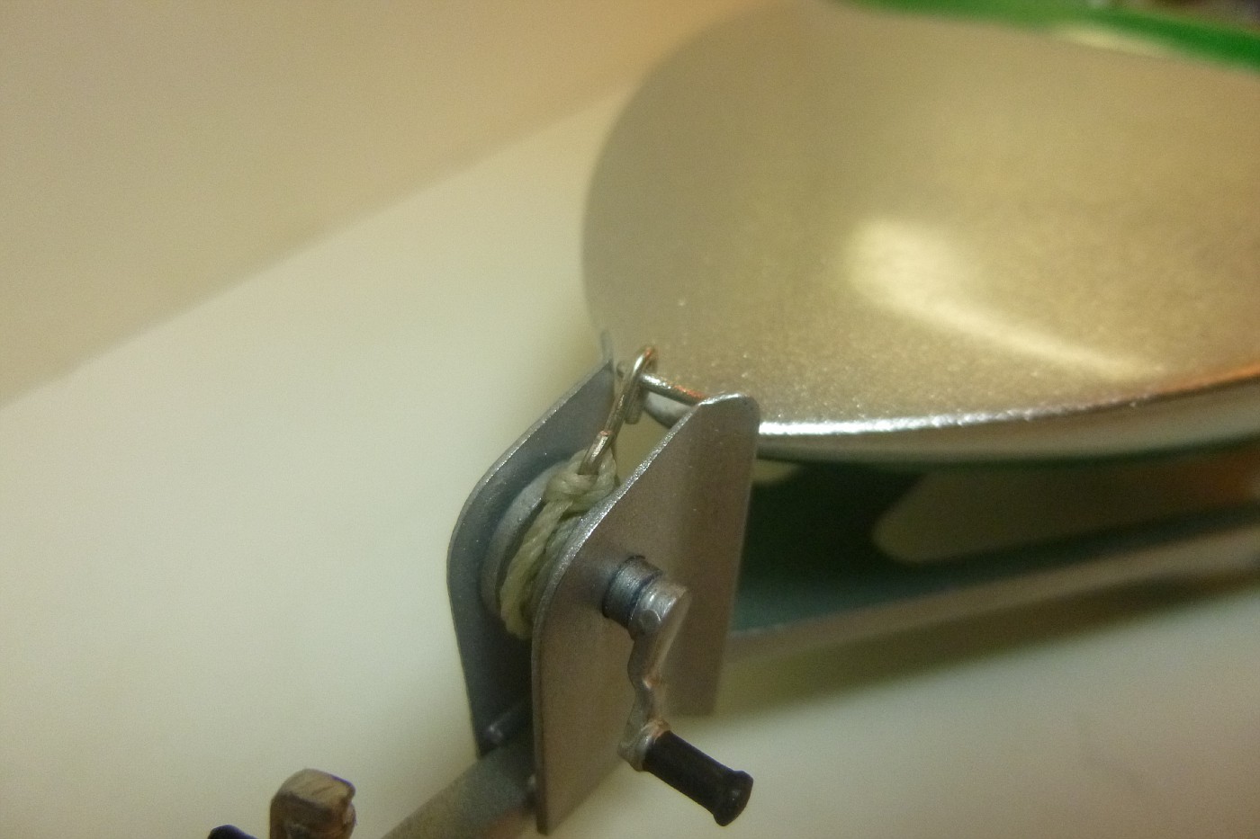

The braided line from the fresh-water pickup to the water pump was a royal PITA to get in place, but it finally gave in!
My lovely wife Pam's contribution to this build was this...some waxed thread for sewing leather! I removed as much wax as I could, added a hook, and put it on the reel...it actually works! I can hook it to the boat and crank the handle to pull the boat up, I didn't even plan that one, it just happened to work!

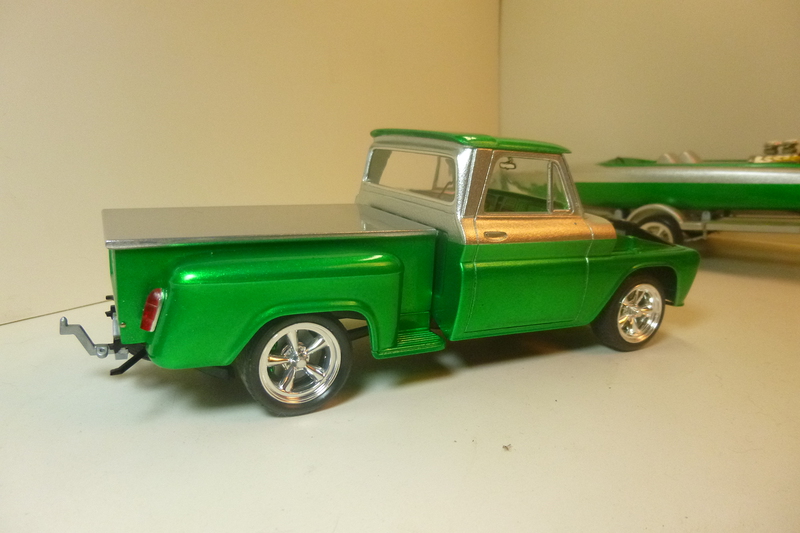

And the last bit of work for tonight night, a quick mock-up of the bed. The floor still fits perfectly, and the fenders and bed cover are also good to go!
Thanks Bob, I've used the Dupli-Color Candy Silver and Candy Apple Green before, and it's an easy paint get a nice, smooth finish with! A bit of prep work and it lays down smooth as glass every time!

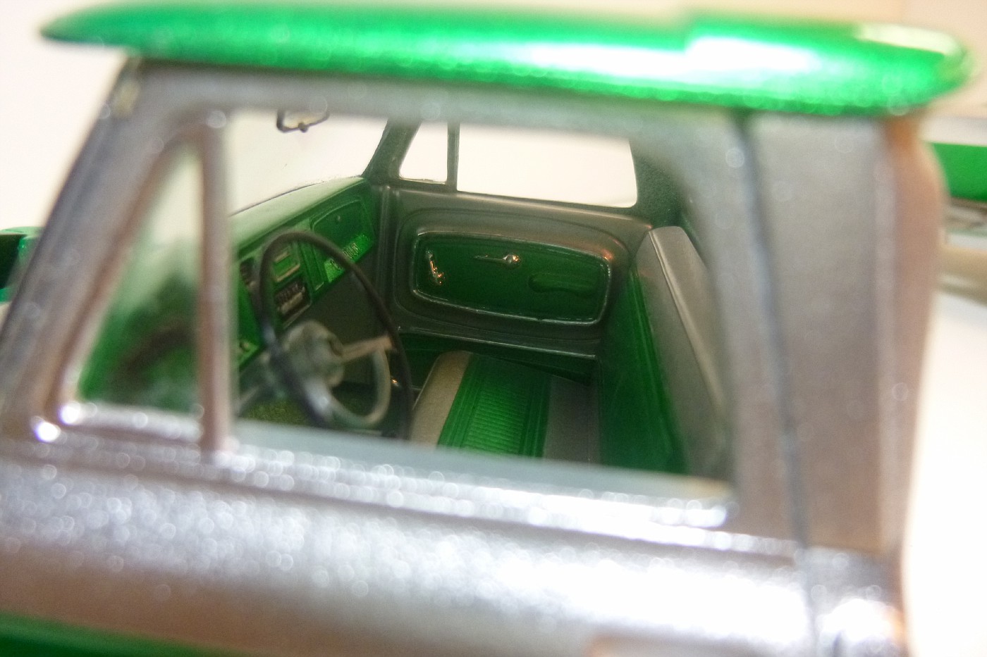

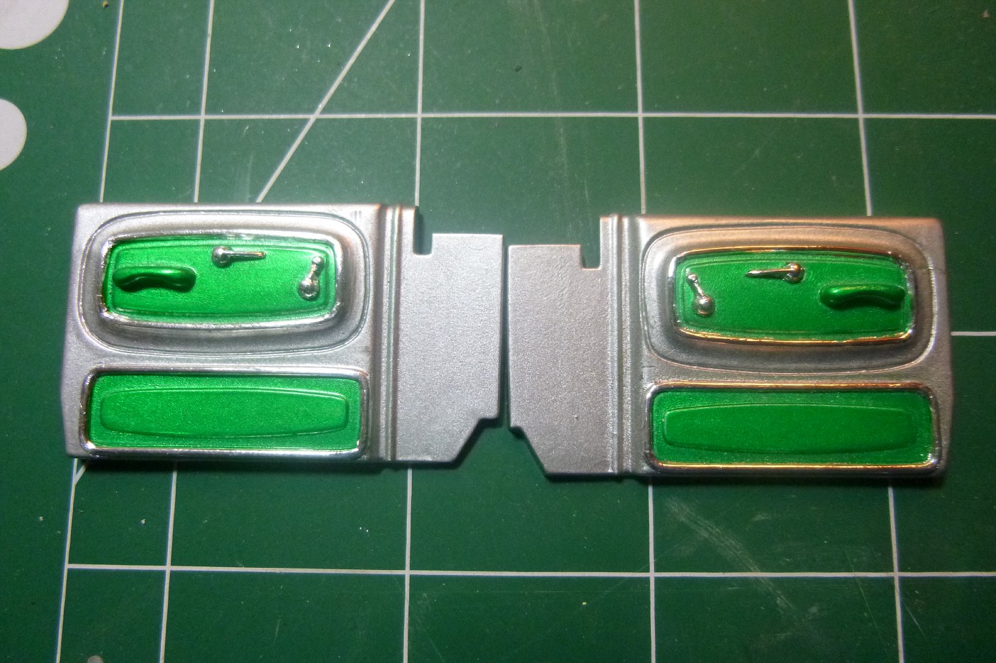

More progress! I got the door panels completed and interior all assembled, the set out to do the foil work on the cab.

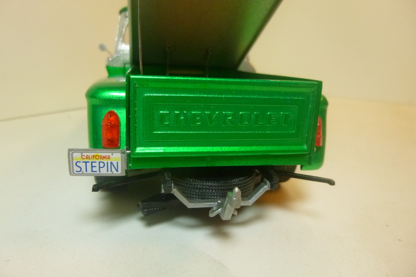

OK, we have a near 100% bed! I've still got to find a way to fix the broken section on the lower edge of the driver's side at the tailgate, that's gonna be a bear. But the rest is done, enjoy the pictures!

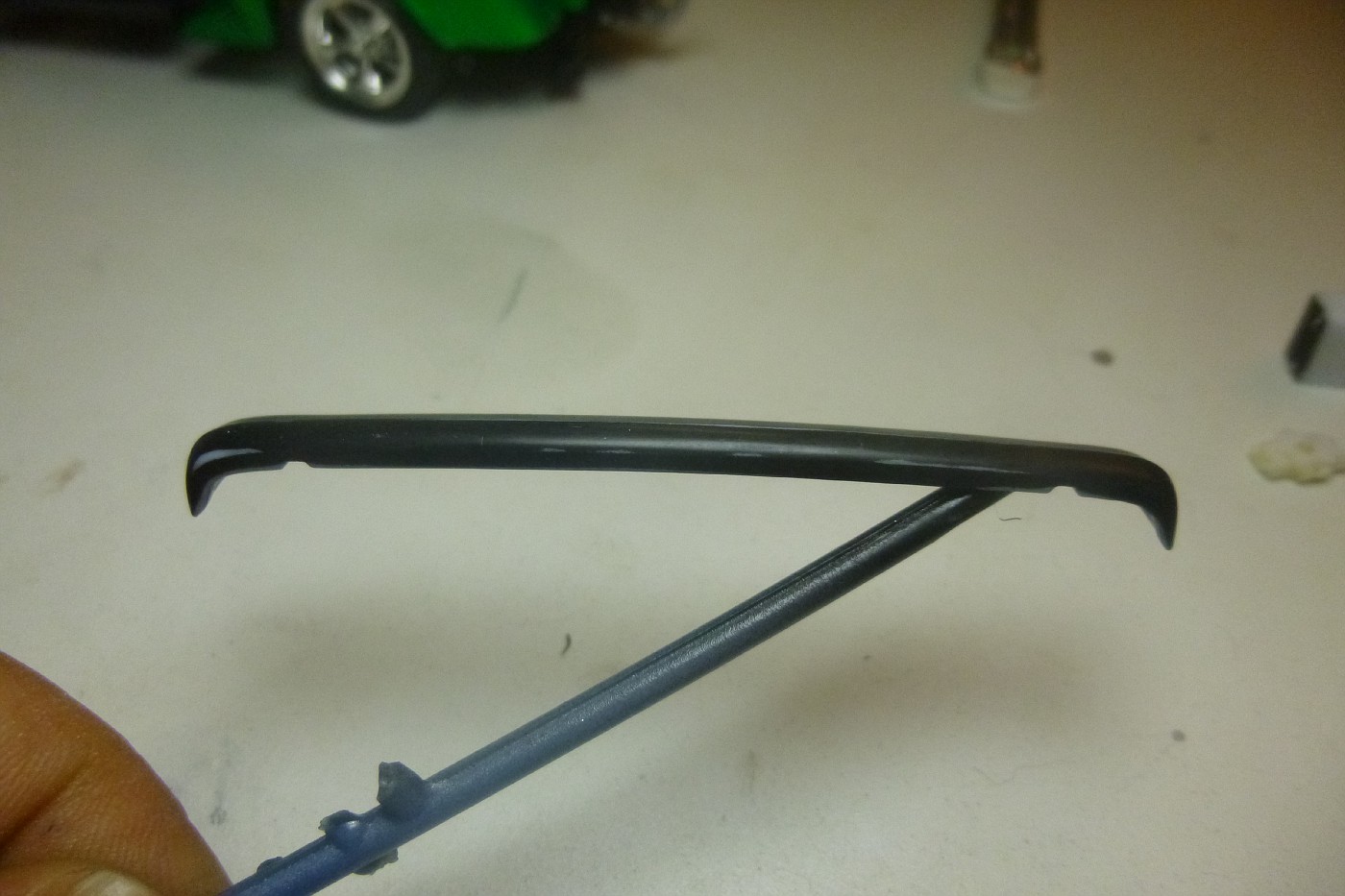

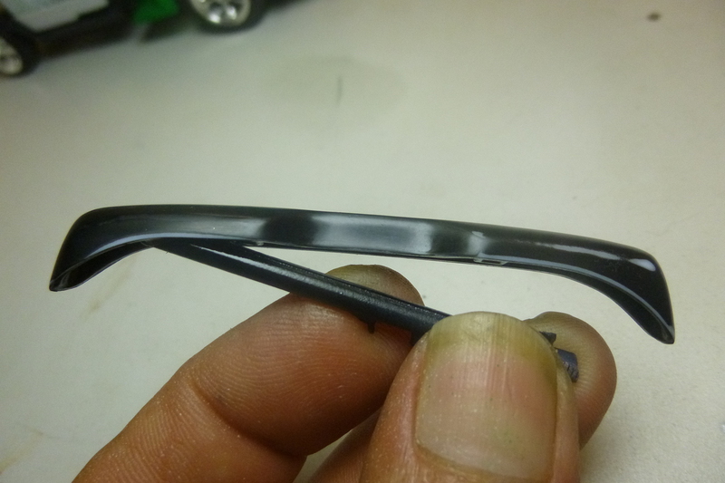

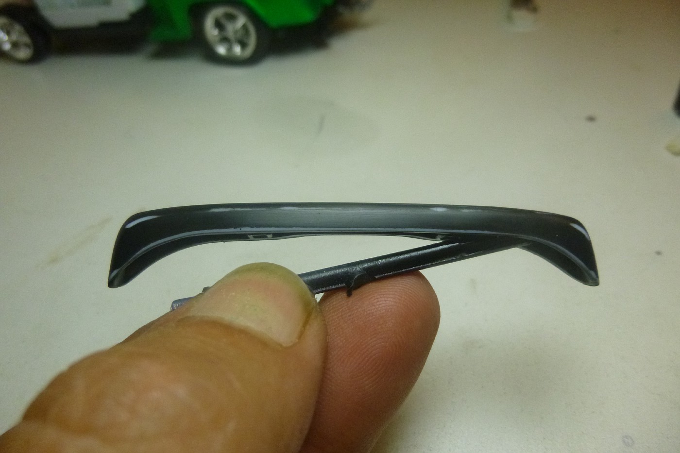

ome more prep work on the bumpers. the black was polished up, two more coats should cover the bare spots and then they'll be ready for some Alclad!

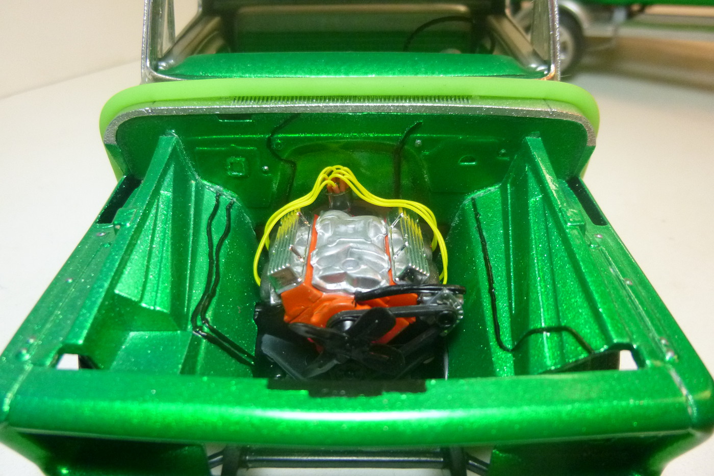

Firewall wiring detailed...
Same for the fenderwell wiring...

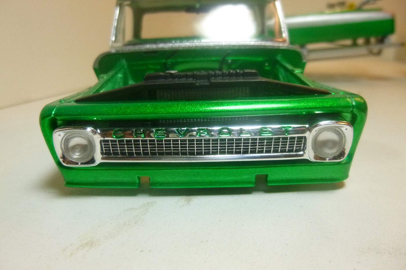

Grille glued in place....

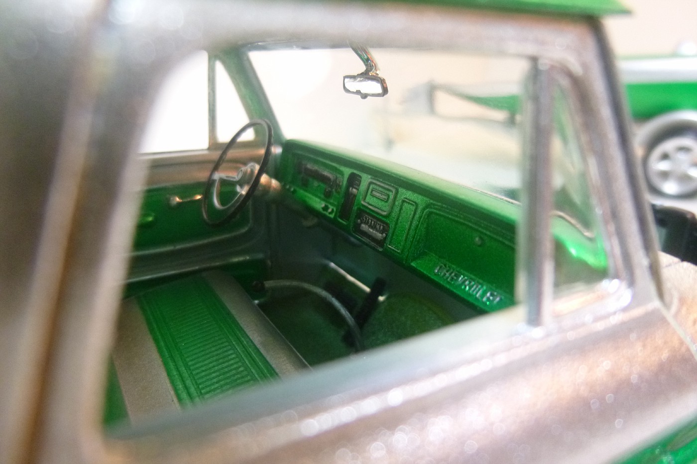

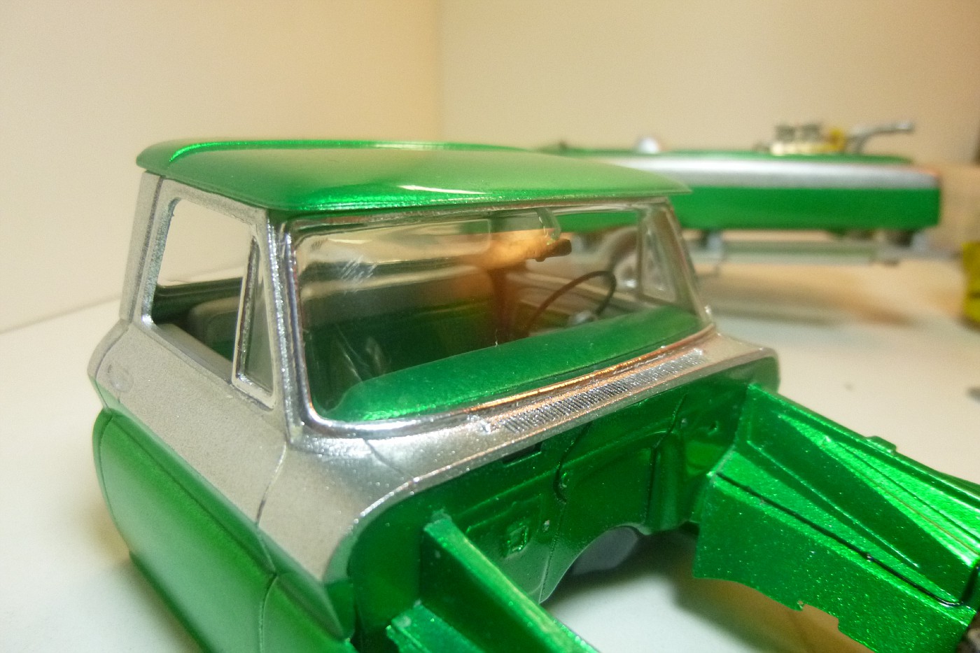

And the interior and windows place...we're almost done!
The windshield was a real pain to get in place and glued down, but I finally got it!
The back window went in perfectly, and is almost distortion free!

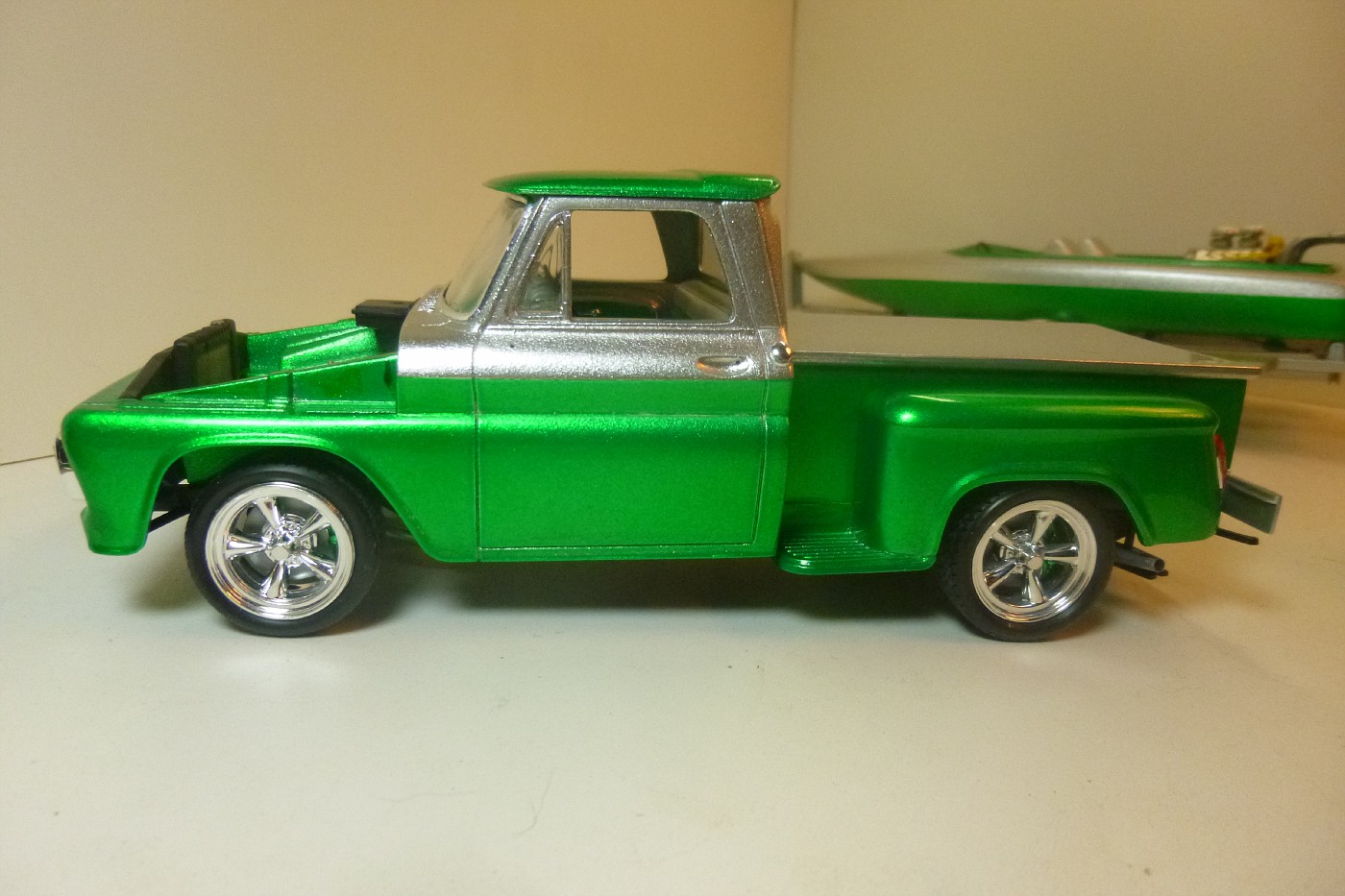

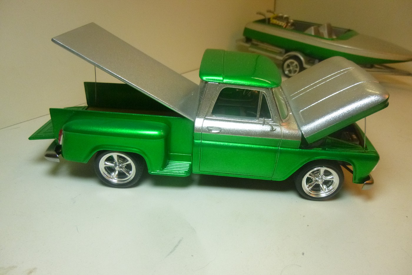

The bed and cab have been glued to the chassis, and the bed cover was placed on it's hinge...

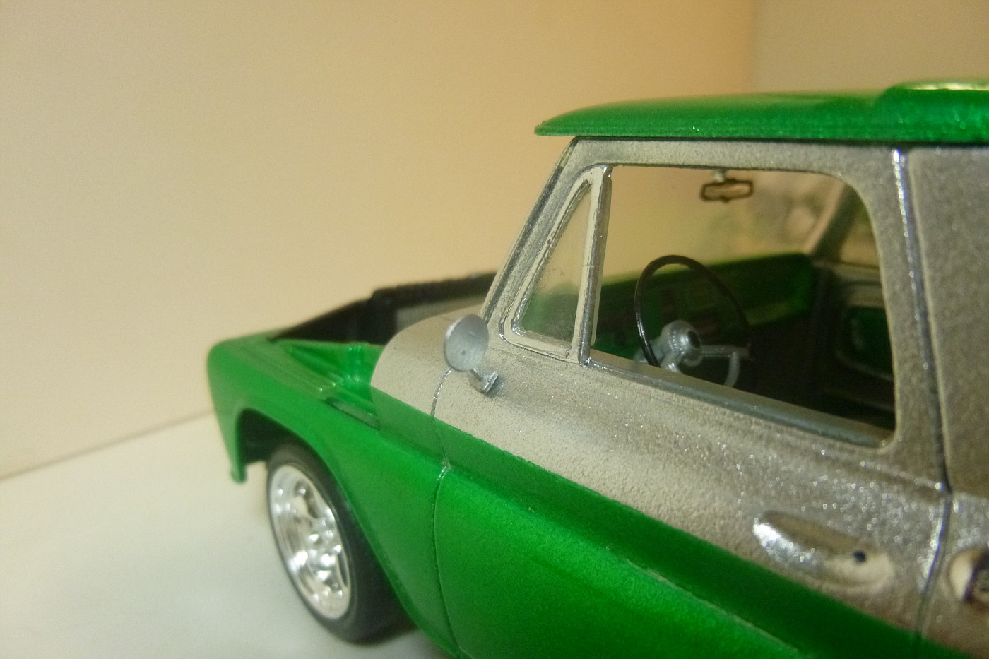

And one of the mirrors has been pinned and glued into place...adding the tiny piece of wire to these was a real pain, there's not a whole lot to work with! They were de-chromed and painted with some Metalizer...
And finally, the turn-signal decals were added to the hood!
And these two pics are of the bed, hard to believe this was the same messed up piece of plastic I pulled out of that box!

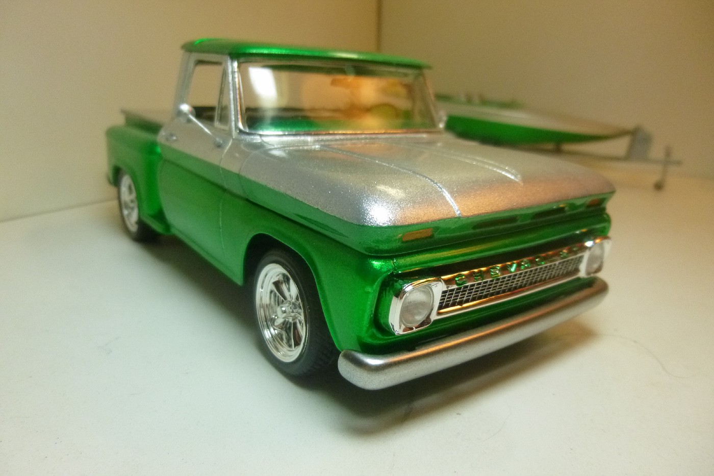

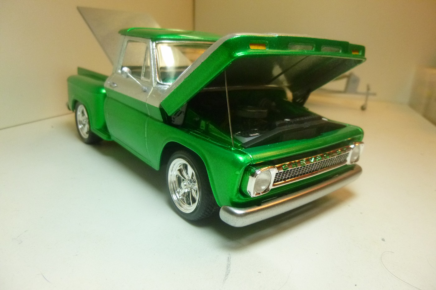

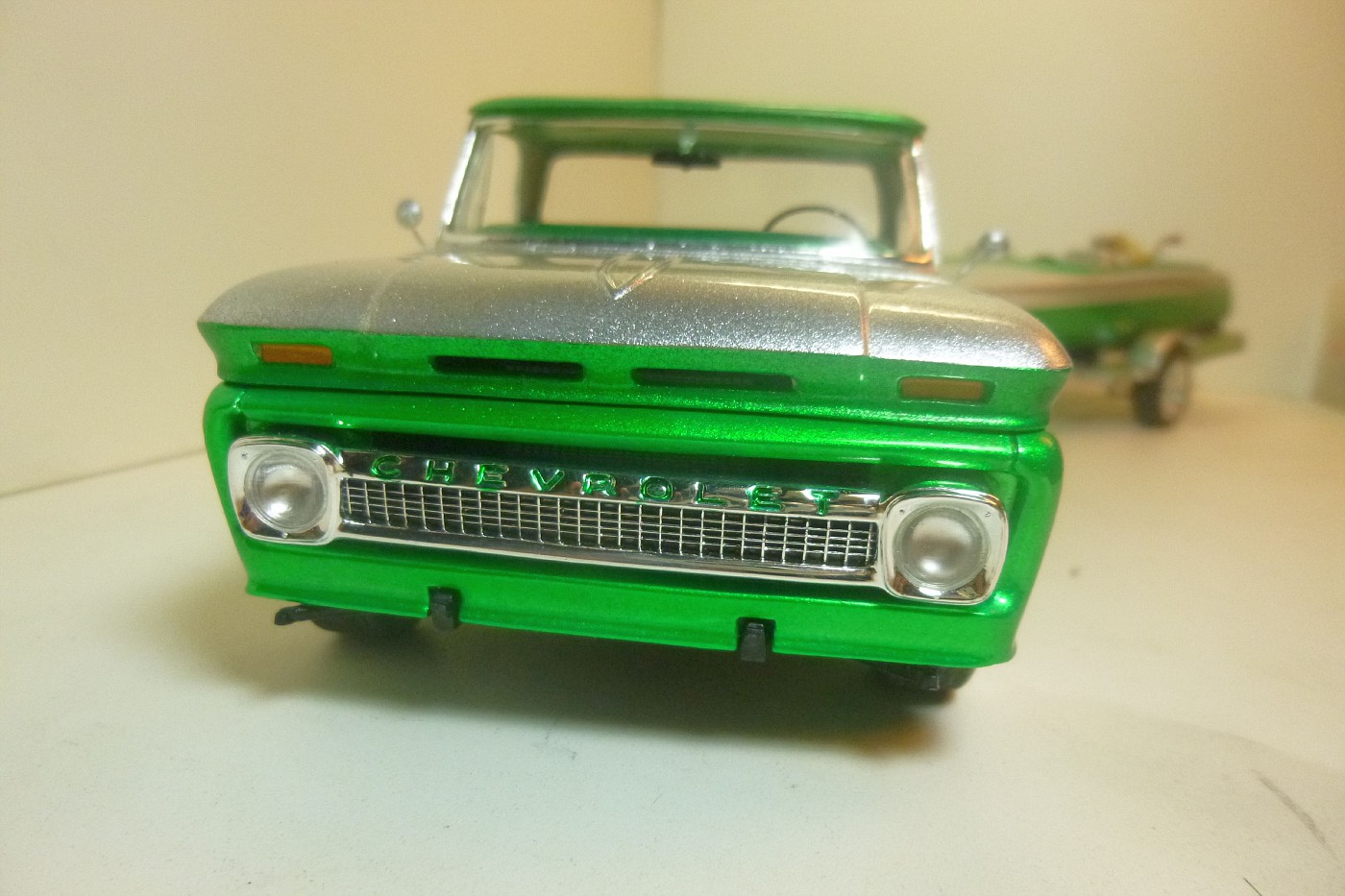

OK, it's pretty much done, just the lower radiator hose to install, and it'll be finished. The Alclad on the bumpers didn't come out as shiny as I'd like, but it looks good with the Candy Silver upper section, so I'll take it. Once the lower hose gets glued in place, I'll give the truck and boat a good clean-up and snap some outside pics for the Showroom. Thanks to everyone who followed along, and Toney, I hope you like it!

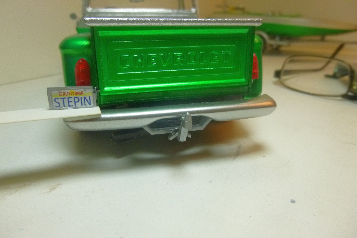

I had to remove the license plate and glue it back on a bit higher, since it still hit the bumper, that's why the piece of styrene is there, gotta keep it straight while the glue dries!

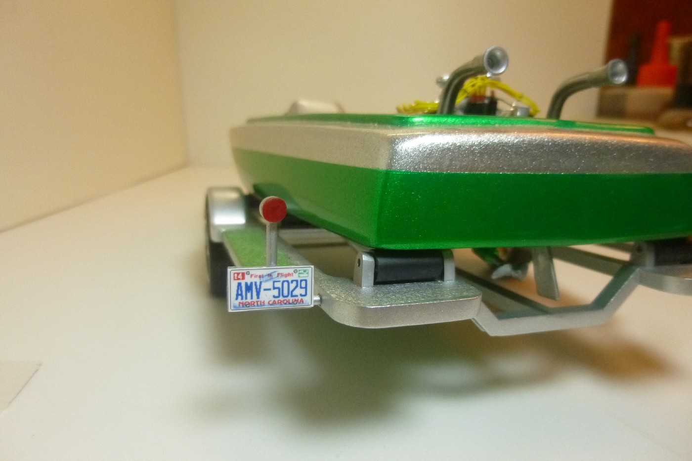

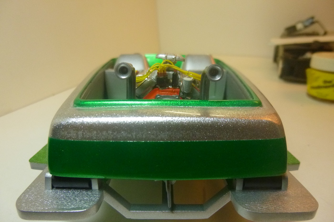

I got some new North Carolina license plates from Best Model Car parts, put one on the truck (Much better!), and made up some tail lights for the boat, and added a license plate to it, now it's 100% completed! I'll get some pics up Under Glass soon, thanks for following along!
