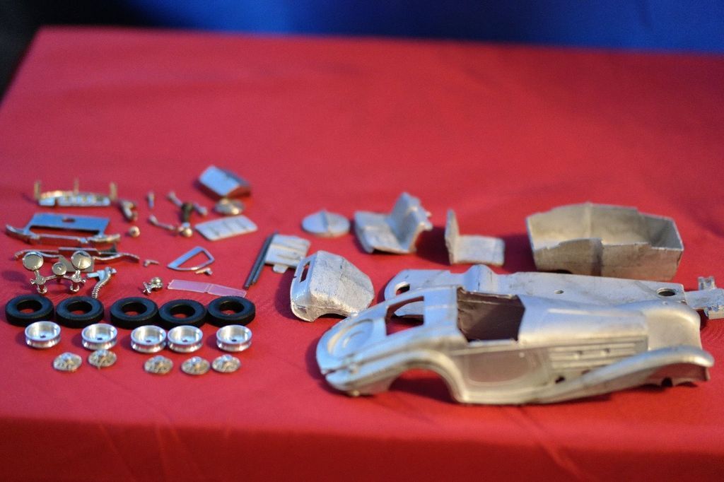

jaxenro Posted June 15, 2015 Posted June 15, 2015 (edited) Hi This is new for me my first 1:43 kit my first metal kit and my first model in over 30 years. Plus my first workbench post. Last thing I built was a 1:16 Rolls, if memory serves, with some horrible gold plated "chrome". Will probably have more questions than things to share but here are the parts they are sending me. Might be a few days until it comes in but meanwhile I was going to buy some sandpaper, self etching primer, sandable primer, and a few other odds and ends Edited June 15, 2015 by jaxenro
jbwelda Posted June 15, 2015 Posted June 15, 2015 that's a heavy little kit there and I think you might find the white metal a challenge to work with. good luck and keep us posted! I have a couple of Western 1/43 and I know they bring some high $ sometimes jb
charlie8575 Posted June 16, 2015 Posted June 16, 2015 I would skip the etching primer. I've read some real horror stories with it not thoroughly drying and continuing to dissolve the metal. Sandable primer does an excellent job on just about everything. I'll be interested to see how this comes out. Charlie Larkin

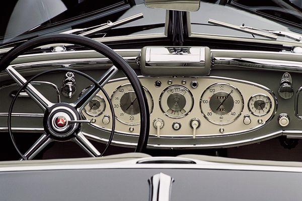

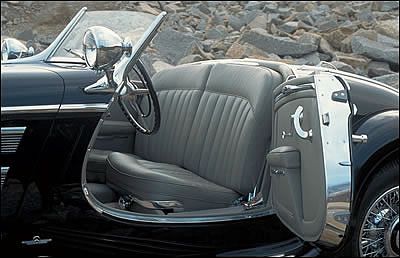

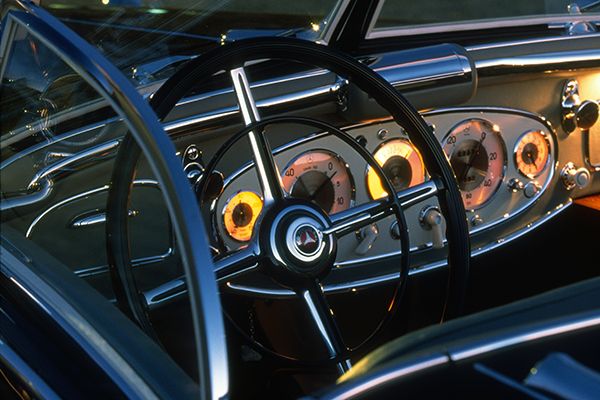

jaxenro Posted June 16, 2015 Author Posted June 16, 2015 (edited) Thank you I will keep that in mind about the primer. I am going to keep this one simple and focus on fit and finish as opposed to trying to add details or anything fancy like the rest of you do. Removing mold lines, smoothing the body, that type of thing. I am also working on colors was planning a black body with chrome trim. I found this photo of the interior figured I would try for something like this, it is Jack Warner's 540K so looking for a good color match and also a photo of the dashboard that wasn't hard Edited June 16, 2015 by jaxenro

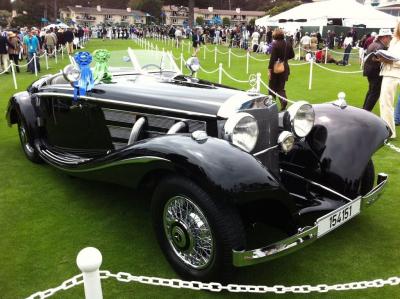

MAGIC MUFFLER Posted June 16, 2015 Posted June 16, 2015 I work on the actual Jack Warner car every month. I've been taking care of it for the last 11 years. If you need any detailed photos of the car, let me know and I can always shoot some pics when I'm there. Here we are when we took "1st in class" at Pebble Beach". I also work on the 540K Baron Von Krieger" car too. You can see both 540K's that I work on here > www.corbettclassics.com Looking forward to watching your progress ..
jaxenro Posted June 16, 2015 Author Posted June 16, 2015 Wow thanks. I doubt my little model will need the level of detail you can provide I am just hoping not to embarrass myself here
philo426 Posted June 16, 2015 Posted June 16, 2015 Is that the "Shepards Benz"that a farmer had stored on his farm in England?

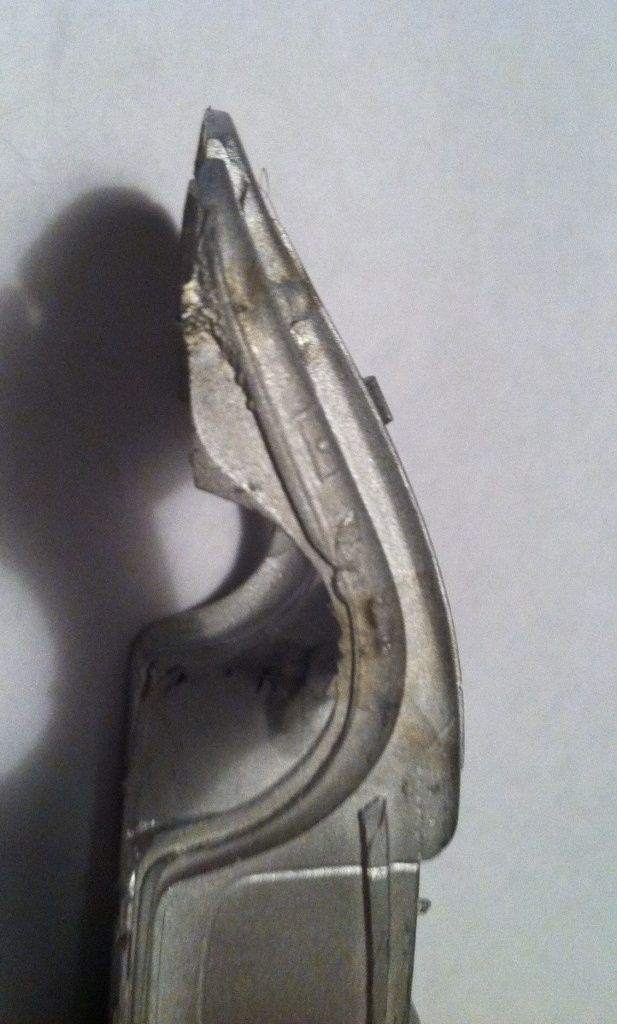

jaxenro Posted June 18, 2015 Author Posted June 18, 2015 (edited) Ok it came in and like I said I have more questions than things to share The body looks mostly good but parts look rough, like the mold was chewed a little in the corners, and other parts look like they are missing a little metal. I was going to do a little cleanup on the bare metal but is it better to spray a coat of primer sooner than later to see what I am dealing with? What's a good filler to use to build up the missing trim? What would stick and not shrink later or crack under the paint? Looks like only one missing piece (one of the side window frames) that I can tell so far so I am good to go there it looks simple enough that I can duplicate the other one. I will try to do a close up of the body issues I see but all I have for photos is my phone so we will see how they come out One other question the wheels look rather nice actually look like maybe turned aluminum with wire inserts the tires are rubber but they have huge sink marks the tread. How do I fill rubber? Should I move this "build" thread to the question board instead? Edited June 18, 2015 by jaxenro
charlie8575 Posted June 19, 2015 Posted June 19, 2015 I don't build a lot of metal models myself, but the best way to deal with the sink-marks in the tires is probably to position them in such a way that they're not visible. I don't think the vinyl (or rubber) can really be filled easily. Window frames can probably be replicated with either brass or plastic strip. Go to an auto-body jobber and see if you can get some All-Metal or Aluma-Fill for the body issues. The rough spots can be addressed with sandable primer like Plasti-Kote T-235 (gray) or the other colors. Sandable primer covers nicely and is good for evening out rough surfaces. Charlie Larkin

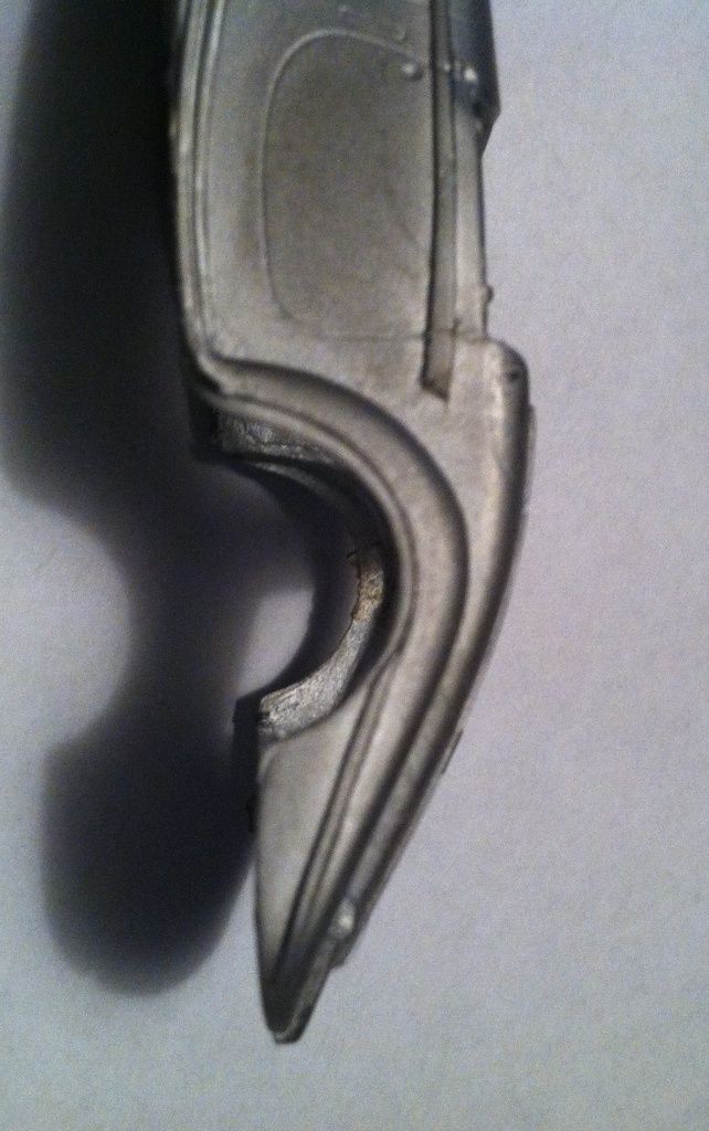

jaxenro Posted June 19, 2015 Author Posted June 19, 2015 (edited) Just to show what I am dealing with one side not to bad the other a bit rough but I suppose this is natural for white metal kits. Starting the sand and prime now then will need to add some missing detail Edited June 19, 2015 by jaxenro

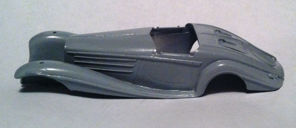

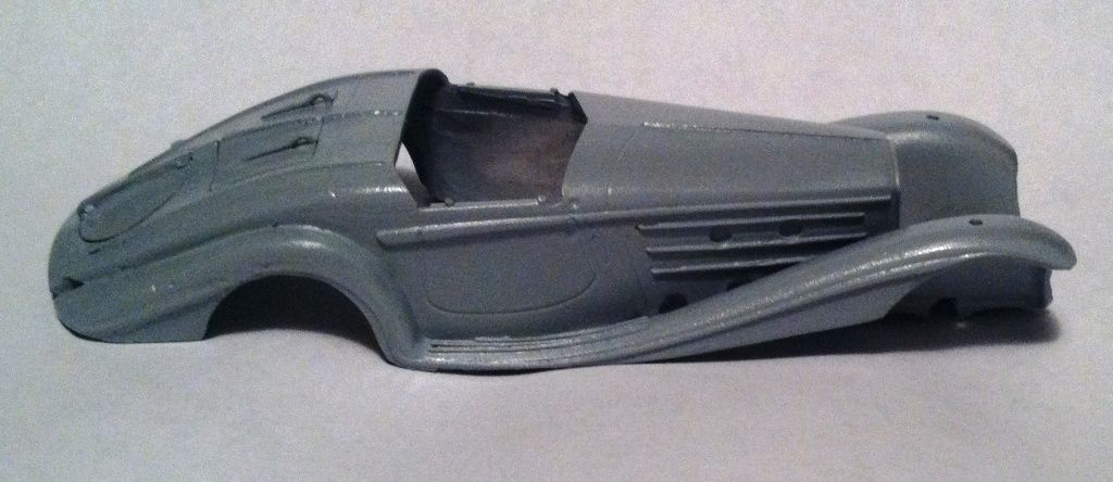

jaxenro Posted June 25, 2015 Author Posted June 25, 2015 Got some primer on and started on the body work still a ways to go with the cleanup

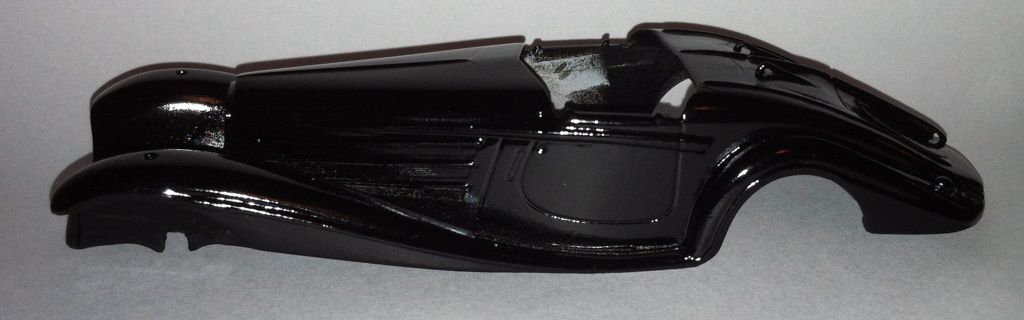

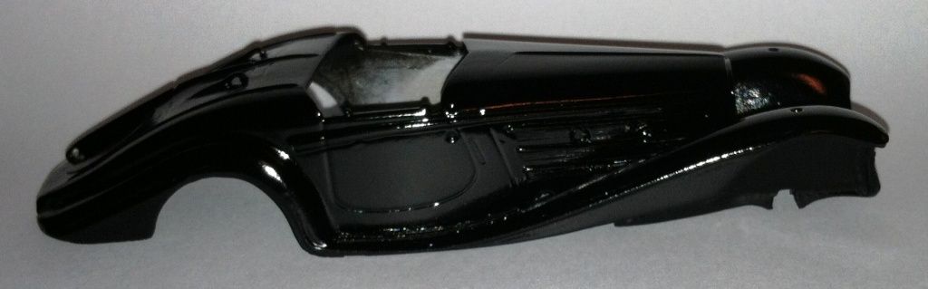

jaxenro Posted July 6, 2015 Author Posted July 6, 2015 Put some color on it the flash in the picture makes it look like it has white spots that it doesn't.Going to let it dry a few days then rub it out and foil it
