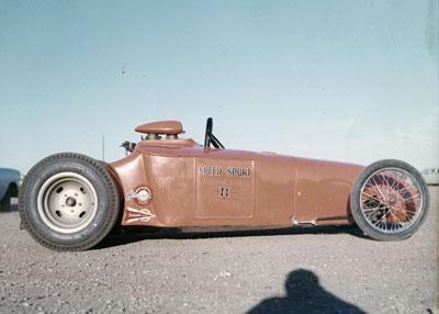

Whether It came from the Speed Sport Roadster or their AA/FD I'm not sure , as Al Eshenbaugh didn't say. They were Red Greath and Lyle Fishers arch rivals from Phoenix. Maybe the Greek fits in there somewhere, they all ran the local strips, Tucson Dragway on Houghton road and Bee Line here in Phoenix. For me, High School in Tucson ('61-'65) was a blast. B)  looks like they had more than one. :P

Very cool roadsters! Red Greth must have made way more of those scoops than we thought, there were several cars running them. A distinctive design for sure!

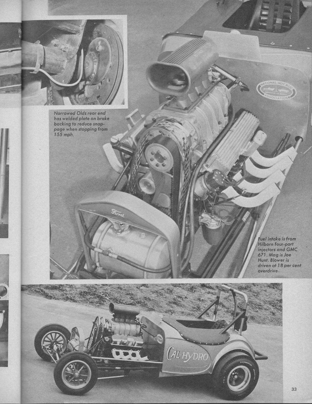

BUT, I realized these magazine scans from the Feb '65 issue of Popular Hot Rodding better illustrate your altered questions ( I hope).
Solid mount rear ends are NOT directly welded to the chassis, there Are  flanges ( one on each side )  welded to the axle housings that bolt to steel brackets or plates that ARE welded to the chassis. These scans are of two altereds, the Cal Hydro Bantam and  the Sterling Engineering T.
Study the scans, I think you can see what I mean. I have also scanned the interior shots. As an aside, note the "steel cable" that runs under the engines. This was to prevent the engine from dropping if ir blew. Most "hot" 60's cars used these cables.

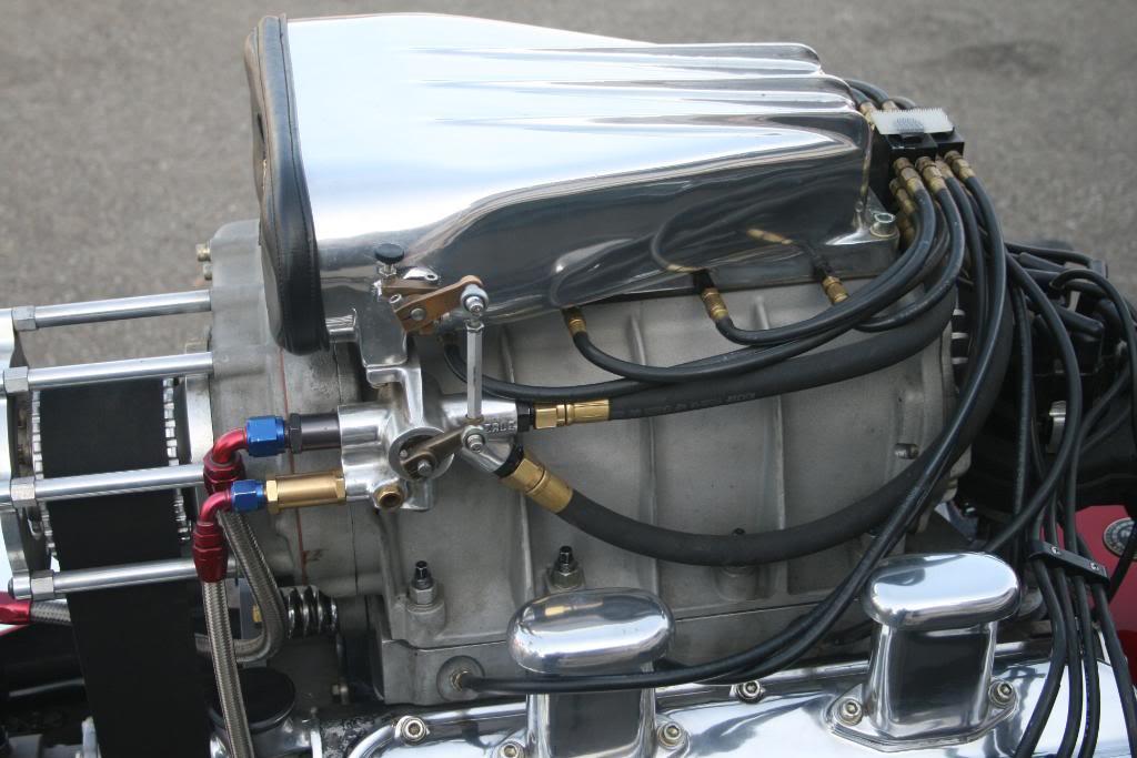

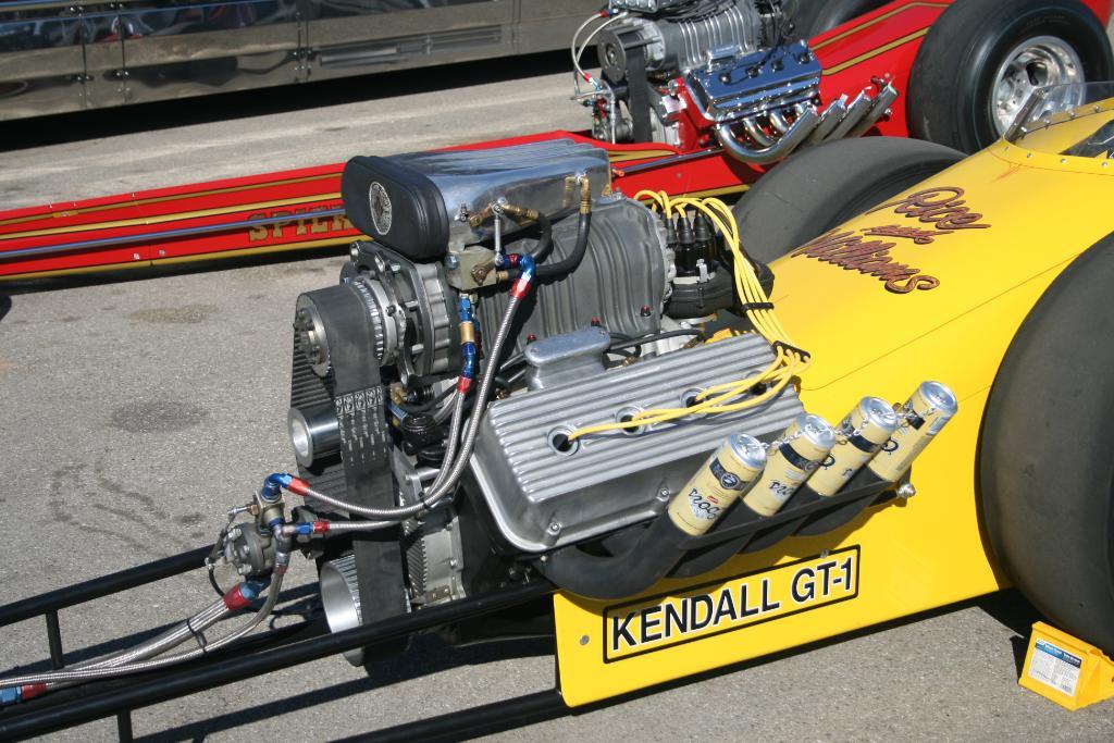

Jeez, my scans won't post!! The first one did. Anyway, here's some shots I took of the Winged Express.
The first one is not mine.

Hi Gary, those are very interesting old pics!  Also the captions.  Concerning the plates mounted to the rear axle, the word "snappage" is interesting, I don't recall ever reading that word before.
Cool too, I've never seen the restraint cable for motor blocks either.  That will be a nice feature for upcoming builds should I choose to make one from the 60's.  I didn't realize the details about the fixed rear end either, thanks for showing this.

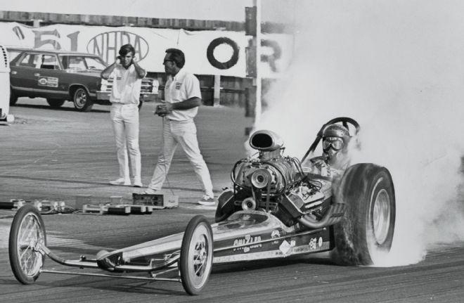

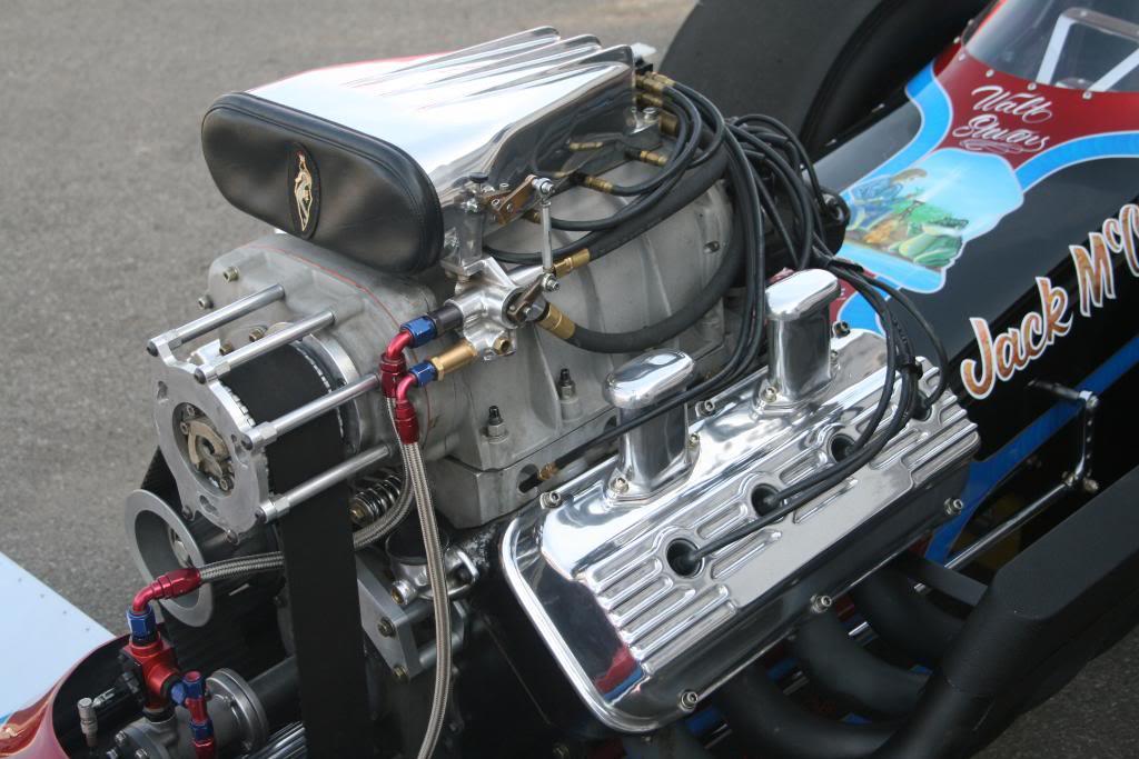

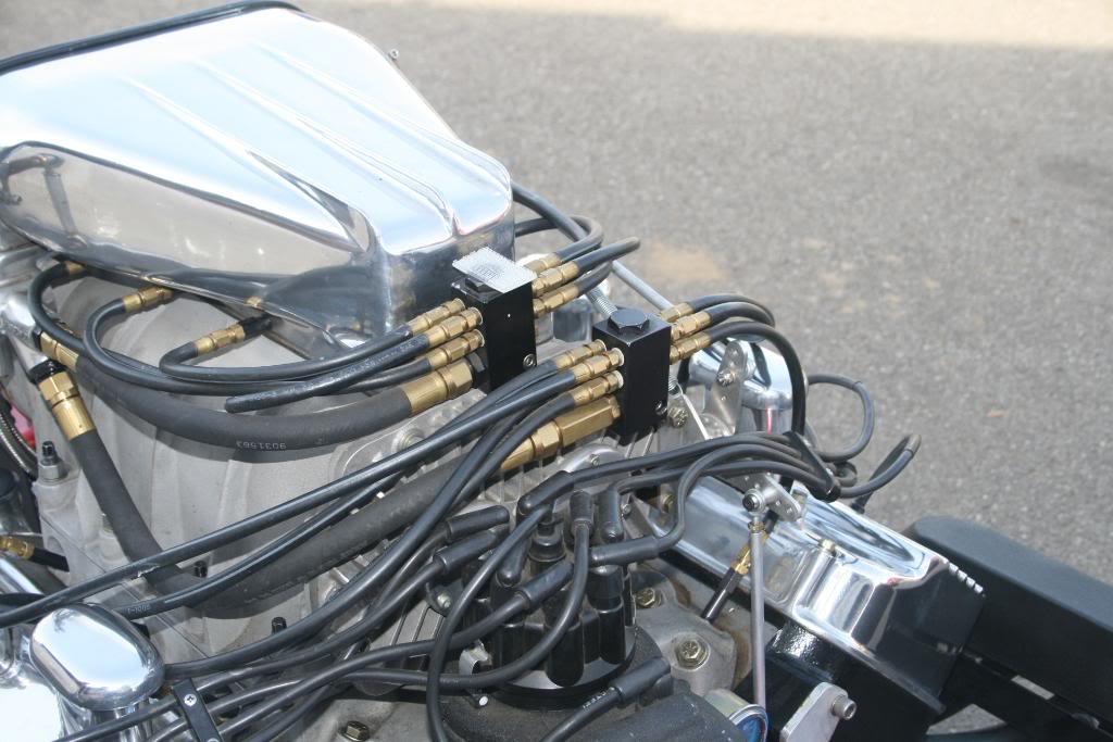

Here's some generic fuel systems from late 60's cars. Not really any difference between funny cars and dragsters. The main changes into the 70's were: bigger fuel pumps, use of steel fuel lines and more of them. By more of them I mean injectors started in the early 60's with two lines, then four, then eight. About 1966 splitting the fuel by introducing intake manifold lines, one per cylinder with ( usually ) eight on the injector hat. More fuel, more power! This is called "over" and "under". There is no one setup, though all are very similar. 70's were pretty much the same. I included another solid mount rear end pic from a dragster that more clearly shows the mounting.

The fuel lines are very clear with these pics.  Interesting too the absence of A/N fittings in lots of pics.  This suits me just fine, better scale possibilities.  I like the real look of the different metals too, this is something all modelers can work on.
I like the view of the crankcase ventilation, very important and often neglected.  I'm doing it on my current project.

Fire bottles are deployed by the driver by pushing or pulling on a lever. Look at the Winged Express pics, the bottle is on the roll bar. the lever is the orange T handle. The spray is directed by a line and nozzle to the driver, the motor or both. Lots of FC's use two bottle mounted on the chassis, one for the motor, one for the driver. Look at the FC chassis pic above. The fire bottle is mounted right by the front tire on the outside of the chassis. MOST 70's cars mounted the bottle(s) on the chassis close to the driver.There is probably one on the other side as well, most modern cars use two.
