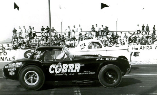

My goal starting this project was to build El Cid. I created the hardtop based on photos of the restored car and in line with what the factory car used.   While I am happy with that current hardtop it is not correct for the style El Cid originally ran.  So I started over with the hardtop from the Monogram/Revell “Baldwin Motion” 427.  Again I sectioned it down the middle and reshaped it to fit the AMT body.

Thanks Steve, the car you saw is indeed a genuine Dragonsnake, chassis CSX2472.  What's unique about this car is that it was never drag raced!  The original owner used it as street car, and a subsequent owner road raced it.  That extra tall roll bar is unique to this car as well.
