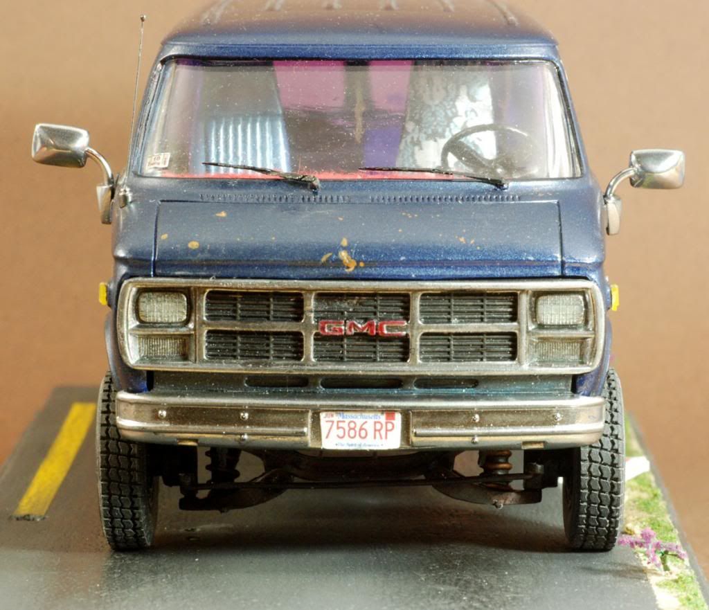

Foxer Posted August 20, 2015 Posted August 20, 2015 (edited) I think any wash of your choosing would work. I used Alclad on the grill of a GMC van I did and used my usual India ink 10% wash on it. That's usually stronger than the washes most use. I'm pretty happy with it. The center did need it to be all black. Edited August 20, 2015 by Foxer
Speedfreak Posted August 20, 2015 Author Posted August 20, 2015 That grill looks good, as does the van, thanks for the input, I'll experiment.
