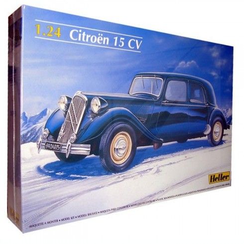

Foxer Posted January 19, 2016 Posted January 19, 2016 I agree. There's nothing boring about this model at all. You make me want one of my own. .though I do not think my skills are any match for yours. Not sure I have a big model like this in me. I sure admire your work with this one. I don't like building large scale kits myself, mostly because I want my builds to look natural next to each other on the shelf. Heller does make a 1/24 Traction Avant .. the 15 CV. It is a very nice kit and even has an engine! I started it but have no wip started. This one will fit on my shelf!
Eric Macleod Posted January 19, 2016 Posted January 19, 2016 I did not know about the 1:24 Citroën. I think I need one!
