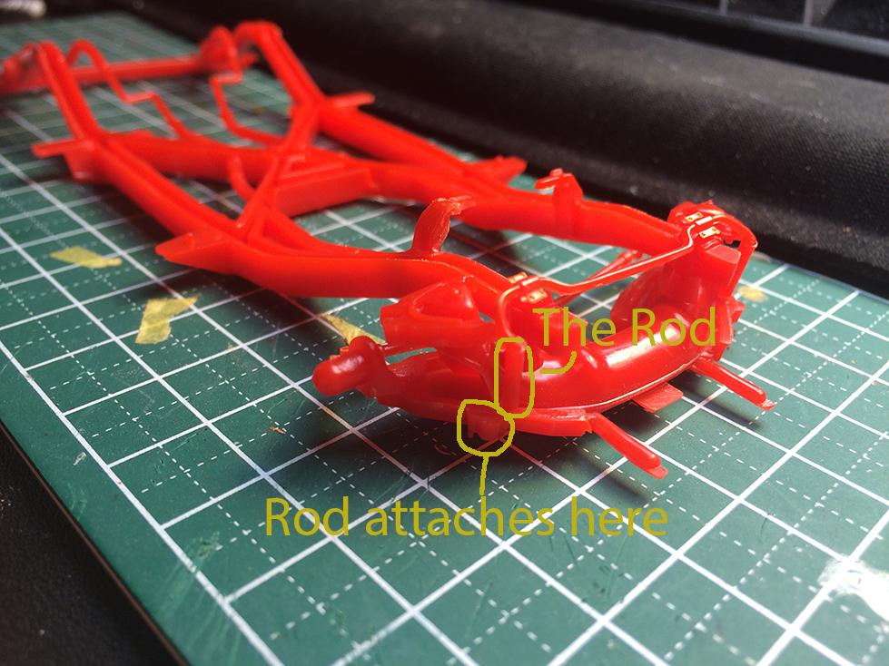

I am putting together the front suspension and the Front sway bay they supplied me with is horribly warped. I would like to know the best way to bend the bar into shape. My plan was to glue the sway bar down at the brackets, let it dry and then glue the 2 bars down to the cross member or whatever it is called.
The pic does not illustrate how bad the warping is but you get an idea.
IMG_0123.thumb.jpg.10f9d24622137082d6076
The next two Illustrate how it should attach. The rod attaching points are flat with no holes in them. I can see now it would be a pain to do this even if the part was not warped. They provided no holes or anything for the sway bar ends to mount into. I have not yet glued this down I am worried I might break the part.
IMG_0125.thumb.jpg.cbf797989359df7677b12
IMG_0126.thumb.jpg.929fed222adaee7da5c82
If you guys need more info let me know.
Matthew...  I use the same method as snacktruck...it takes a light heat if the item is thin or small then after heating bend it slowly hold in the correct position blow on it or hold in front of a fan till cool again.  You might try on some scrap plastic the same size first just to get the feel for it.
Ok. Thanks a lot guys. I really appreciate it. I just need to find an easy way to heat it up. Maybe a few quick passes with a cigarette lighter while not getting too close.
I wouldn't do the cig lighter thing. HOT water is your friend. Honest. You don't really get even heating with a flame...only the outside gets hot while the inner part stays cool...and we see a lot of "smoked" roll-cages, etc. from time to time.t3009.gif
good thing I did not attempt it yet. Hot water, Check!
Sad thing is however I discovered that I will need to cut the sway bar in the middle, take out 1-2mm to shorten it as it is too long. Of course, the ends are the problem area I was worried about breaking accidentally while trying to bend them.
Fill a coffee cup with the hottest tap water and put it the microwave for 30-45 seconds.  Dip the end that needs to be straightened in the water for 15-20 seconds then bend the end to the position you want it then do the other end.  You may have to experiment with the time in the water and bend slowly/gently.  Works for me.
