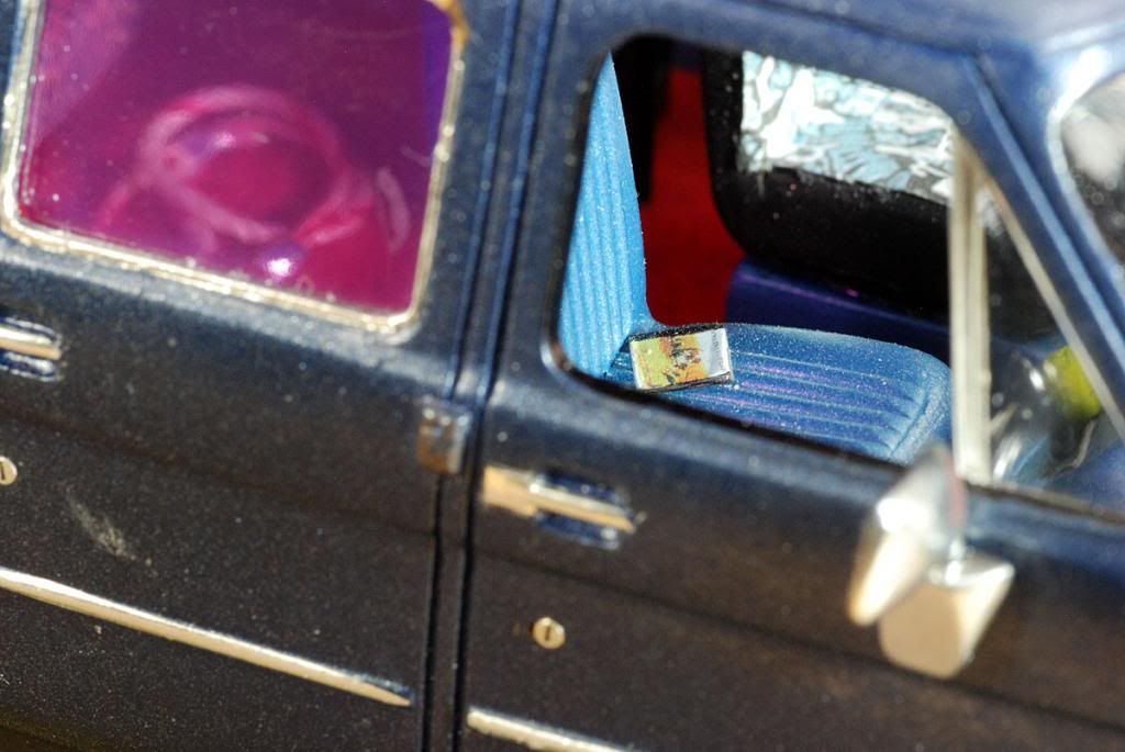

Foxer Posted October 28, 2015 Posted October 28, 2015 I have some PE keyholes from Model Car Garage that I like to use. They are on a rubber backing so they don't have to be cut off a fret and trimmed . very easy application. I checked so I could give a link but they don't have them listed. They were called Door Lock Cylinders MGC-604. I'm going to have to look somewhere else as I'll be needing some soon. This is a van I used them on ..

Ramfins59 Posted October 28, 2015 Posted October 28, 2015 For me, keyholes are way too small to try foiling after painting as are scripts. I use Steven's method of foiling before paint, or, carefully paint the keyholes with chrome silver paint on the end of a toothpick after painting. The MCG PE keyholes are great if you can get them. The Galaxie Chevy kits come with some nice keyholes on the sheet of chrome trim too.
crowe-t Posted October 28, 2015 Author Posted October 28, 2015 I really like the look of the MCG door lock cylinders. It's too bad they are so hard to find now.The kit I'm building is an MPC 69 Charger and the key holes or rather raised bumps aren't very pronounced to begin with. I'm not sure they will show much after the color and clear coat are sprayed on.
