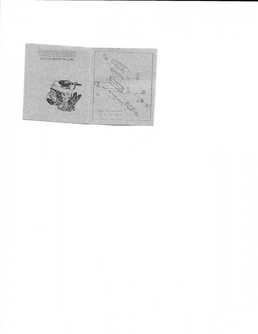

I have an unbuilt AMT '64 El Camino, which has a 230 6 in it. I may look into having it cast in resin for a van and a pick up project. I am not too crazy about the hole in the block, but it may work.
Have you looked at the Chevy 6 that is offered by Replicas and Miniatures Co. of MD? I had one, and it looked very nice.
