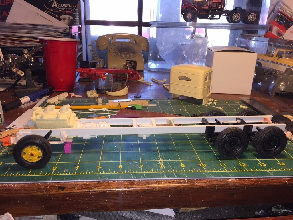

DRIPTROIT 71 Posted January 29, 2016 Author Posted January 29, 2016 It's kind of crude mock up, but you can get the idea of how its going to look.
Travis T Posted January 29, 2016 Posted January 29, 2016 Should be an interesting looking truck when you are done. I like where you are going.

DRIPTROIT 71 Posted February 11, 2016 Author Posted February 11, 2016 Thanks for all the comments!! After fighting with this frame time and again, I finally took some of my son's Legos and made a jig to put this frame together. It is finally straight! The air ride minus the bags and rear axles are installed thanks to the help form Sean "Old buckaroo". R model springs were used on the front. The frame on an R model gets wider at the front, but on the B and H models it does not. After installing the springs, the Mack front axle from both the AMT kit and The MPC/Ertl kit were slightly too wide at the spring perches. Since this is a custom, I installed a Road Boss front axle with poseable front wheels. The engine is 85% together, the transmission will be a 4x4 Spicer. A 4 speed auxiliary is mounted as well. I'm casting tank mounts and brake chambers. It seems that I didn't have as many as I had thought. The wheelbase is right at 270" in scale. Still a long way to go!
Old Buckaroo Posted February 11, 2016 Posted February 11, 2016 Brian, I am very happy to have been able to help you on this. My most favorite part of this truck is the rear window. That is just so cool the way it is shaped - it has personality. Your progress is is looking real good!
gatorincebu Posted February 11, 2016 Posted February 11, 2016 Brian, You are making some good progress on this one. I am usually not into the long tractors. But I am lovin this one. Be Well Gator
10thumbs Posted February 12, 2016 Posted February 12, 2016 Good progress. I'm looking forward to the rear end setup.

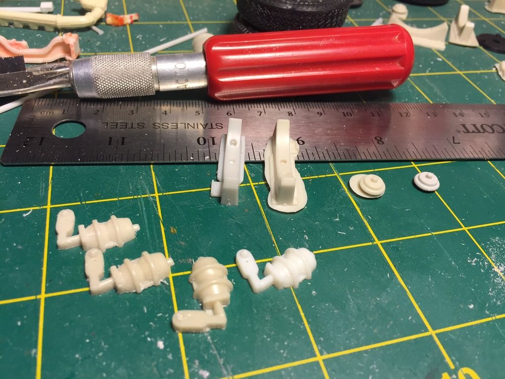

DRIPTROIT 71 Posted February 14, 2016 Author Posted February 14, 2016 (edited) I went to my trusty parts box to get some much needed parts and found that I had 1/2 of a piggyback brake chamber, 1 single diaphragm brake chamber, and 1 fuel tank mount. I tried my luck at casting once again and cast the rest. They turned out pretty good, considering that a few weeks ago I had never cast anything. Thanks for all the comments and encouragement!! Edited February 14, 2016 by DRIPTROIT 71
