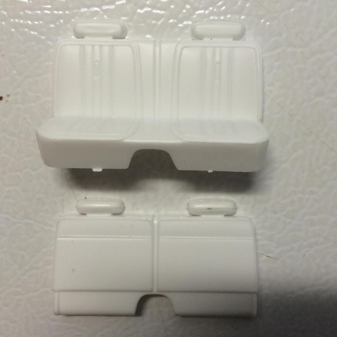

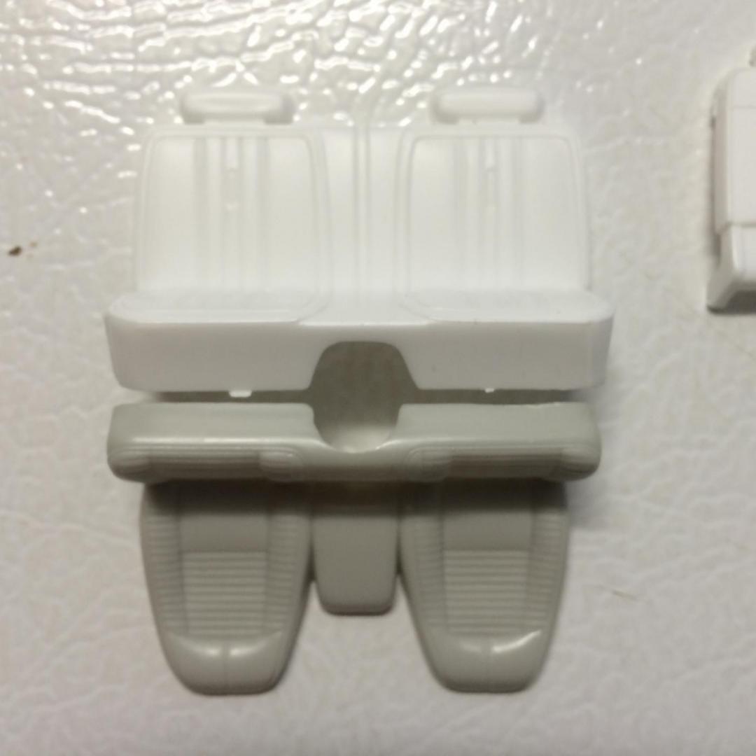

If you want to go the route of trying to replicate those exact seats, then my advice would be to work with plastic. I'll briefly describe the process down further. You could start with any kit bench seat, but you'd be a little closer using either the bench seat from the Revell Monogram 1970 Road Runner kit, or the bench from the AMT '68 Road Runner.
I think the Revell '70 RR bench would be the best starting point- it has a pretty plain pattern that you could sand down pretty easily, plus, I think the shape really looks the part. I have spent some time with bench-seat '70's B-Bodies, and I think the '72 Bench you have shares the same seat frame assembly as the '70 bench, as in the Road Runner.
You would essentially:
1) Sand down the existing upholstery pattern.
2) Cut out the insserts- the sculpted fields / panels within the seats with the patterns you don't need.
3) build new inserts mimicking the right patterns, using quarter- round plastic, scrap plastic and/ or sprue. You would sand off the top of the curve length-wise in order to shape it more like a single pleat first, then join the 7 or so pleats you would need for the top portion of the pattern with a lower portion formed/ shaped from scrap for the seat back pattern, and join the 10 or so pleats to form the seat bottom pattern. You would then cut each piece to fit the windows that you cut out of each seat, then fill any gaps.
I have seen this technique used in a few magazine articles. I have never attempted it myself. It does not seem easy.
Your other alternative would be to sand the detail off of the seat, lay a thick layer of epoxy onto the seats, and sculpt or carve the pattern onto the epoxy. I'd be more likely to try the first method than the epoxy method.

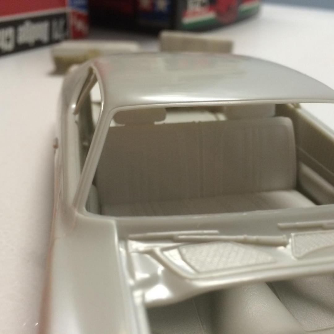

Here are some pics, showing the '70 Road Runner bench compared to the '71 Charger bench. It's a bit wider, so you might have to cut it down, but I mocked it up in an unbuilt '71 Charger and the fit doesn't seem overly tight. You could also just cut the upper portion of the RR bench free and combine it with the '71 Charger bottom, piecing something together that might be a better look or fit.
