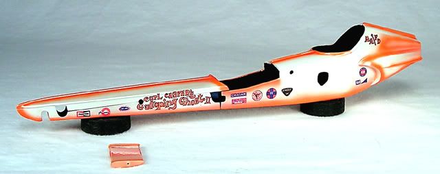

This isn't hitting my bench full force quite yet, but I am doing some preliminary work on the body getting ready for paint. I got a set of repro decals from billygooche, the pad printed M+H slicks from AMT, and I'm working on procuring a set of pulleys.
I am able to slide the frame into the body through the engine opening, so now I can mold the entire back half of the body together. The top half of the front will remain separate, but I added some strips of plastic the inside to help hold it in place.

Not necessary with this one. There is no roll bar hoop over the driver, the seat fills up the entire opening to the rear bodywork. I'm sure the real car has a hoop, but it's not visible on the completed model. So, I can slide the frame in through the front, and slip the seat in through the cockpit opening and I should be good to go.
Worked on molding the two halves of the body together last night. Should be ready for paint soon if all goes well.

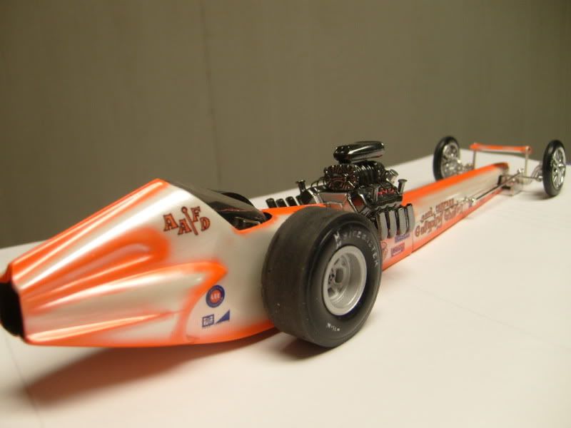

I painted, and decaled this one for a friend a few years ago.
Good luck on yours Craig!!!
That's awesome. I'm hoping mine turns out as good as yours.
