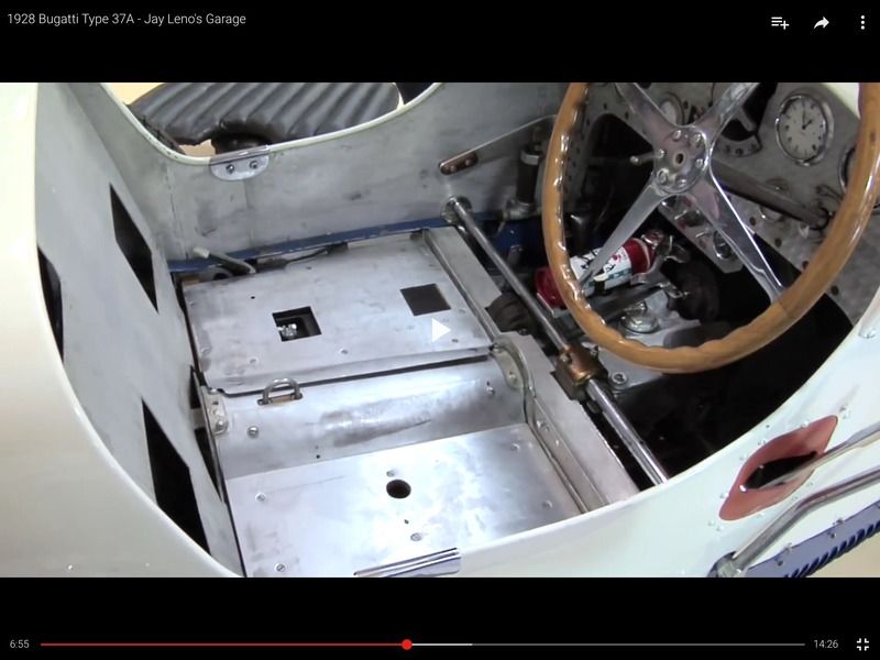

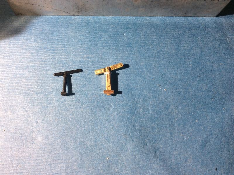

Made a brass manual oil pump last night. Used by the copilot to add extra oil during a race.
Located far left here in Jay Leno's type37

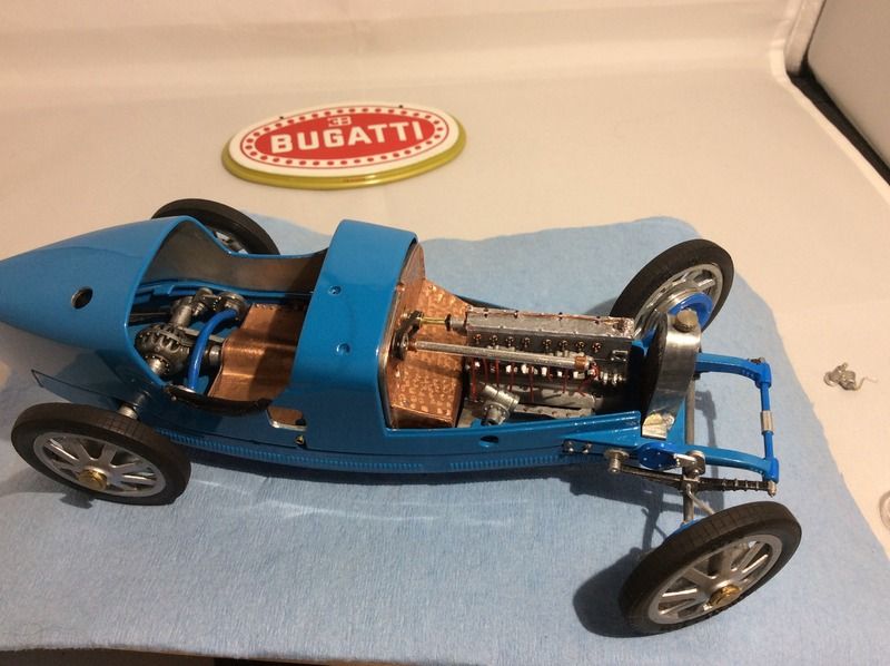

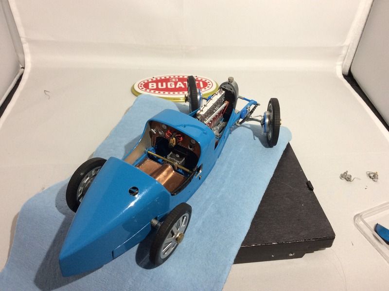

Firewall/dashboard cemented together with brass linkages and then test fitted into body. Cut a strip from the  band-aid on my hand to make the drive belt for the tach
Firewall fit is poor with side gaps I will need to fill with copper.
This wasn't easy and broke some stuff along the way:wacko:
