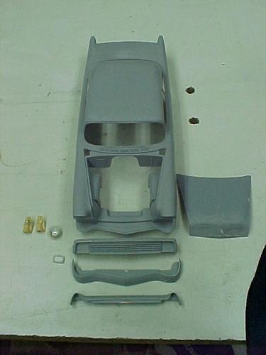

Oh I got pleaty of them, I'll have some posted in afew days here after I go through them. I don't want to post to many on here. So I will select which ones to post. Right after I get the floor boards detail done I still have to do the whole back seat area and also trunk area yet as well. I am really enjoying this kit corrections to be honest. In the words of ol Rosco P Coltrain "I love it, I love it, I love it, I love it"!
I'm going to let the photos do the talking here, any questions about the project please feel free to ask.

I haven't started on the floor pans yet, just getting to them now, got to tie all the firewall into the bend downuder, Then tie in the fender aprons to the firewall. This stuff here is only really the start to the project.

Now lets talk about those incorrect front fender wheels on this big beast

working on the wheel well opening plus body lines at the same time

i you use styrene then glue nd bondo?
Hi Jim, you are doing some good work here BUT I cringe at all of that supeglue you are using. The problem with superglue, and I am sure you are very aware of it is, it sands so much harder then the base styrene. If I could make a bit of a suggestion to replace that superglue with a 2 part polyester filler.

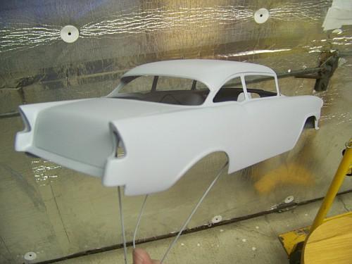

I use this stuff exclusively when doing conversions or for ANY body work that needs to be done on a kit body.
I added a couple of pics of a 1/16th scale '56 post conversion I did from an AMT '55. all of the major bodywork was done with styrene sheet and the Icing. The Icing does not shrink when it cures, sands VERY easily and feathers out beautifully. If you get it and try it I think you will like it. It will cut your sanding time down by a ton.

I agree, that's a lot of superglue.  It's harder than the styrene and can get brittle.  When I build mine I plan on using sheet styrene and putty to fix the front fender openings.

Using styrene to completely fill the openings is the better alternative. Cut and shape your filler panels to completely fill the opening then sand to level to the rest of the body. Styrene is as stable as the rest of the body so shrinking and cracking are virtually eliminated. use the 2 part filler to fill minor voids and build up low spots.
