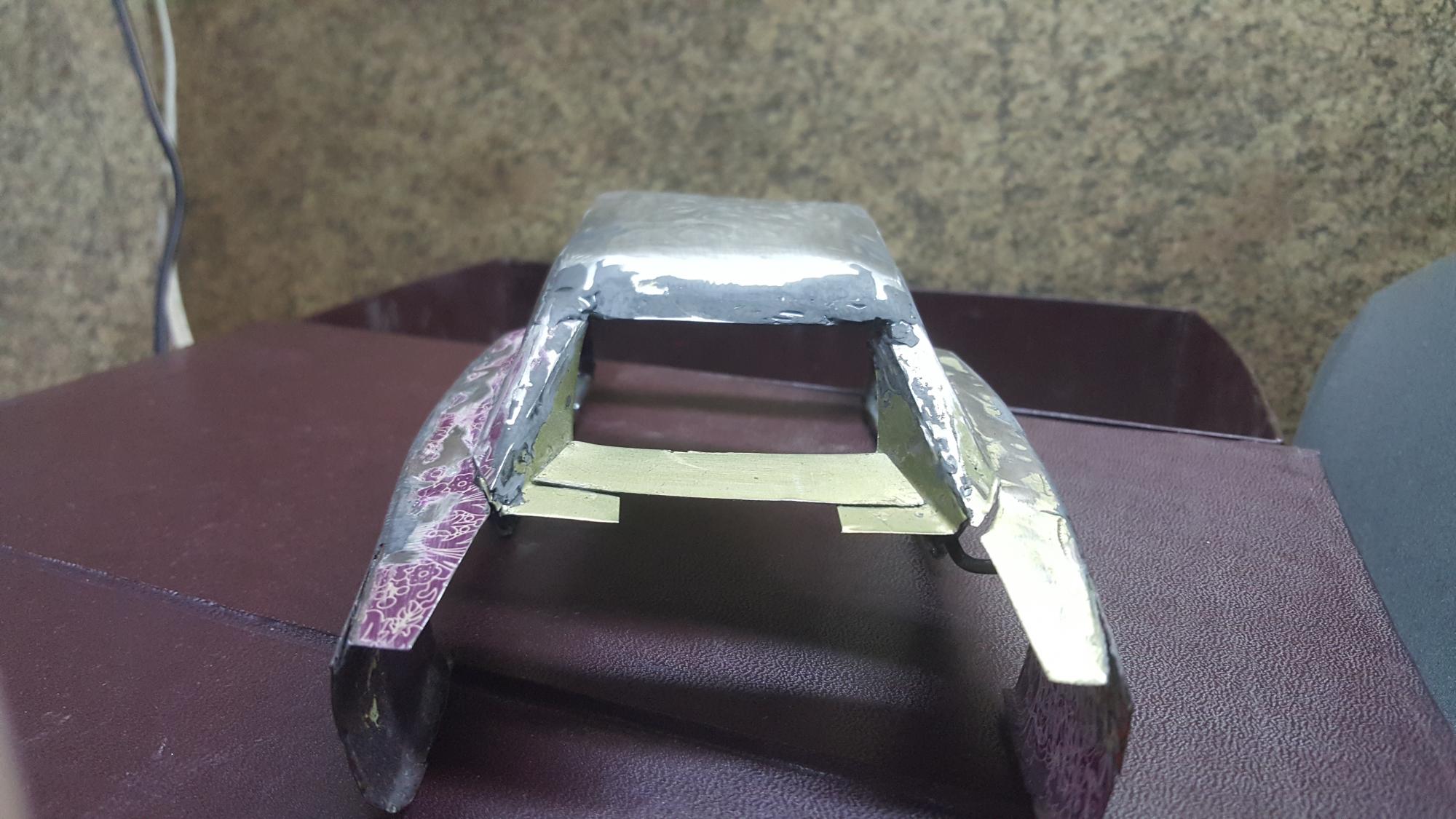

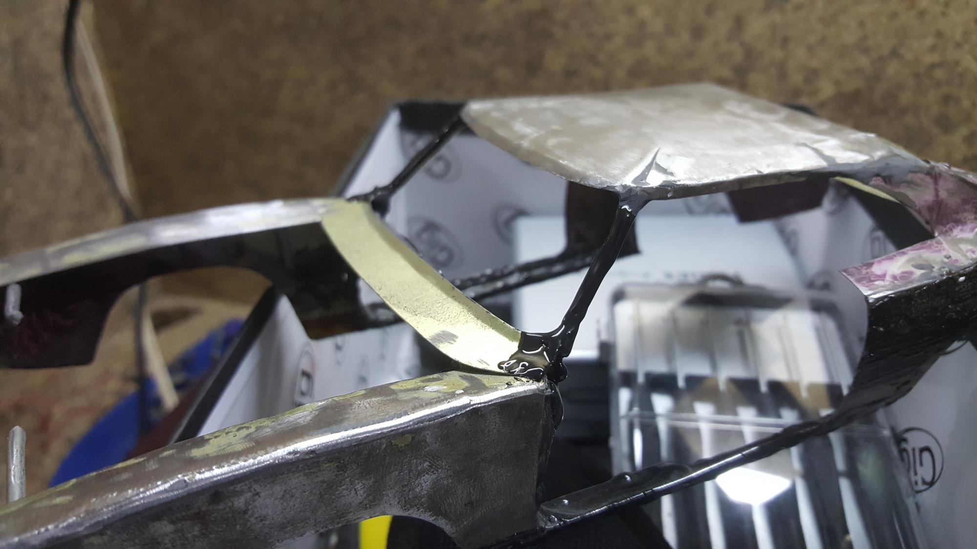

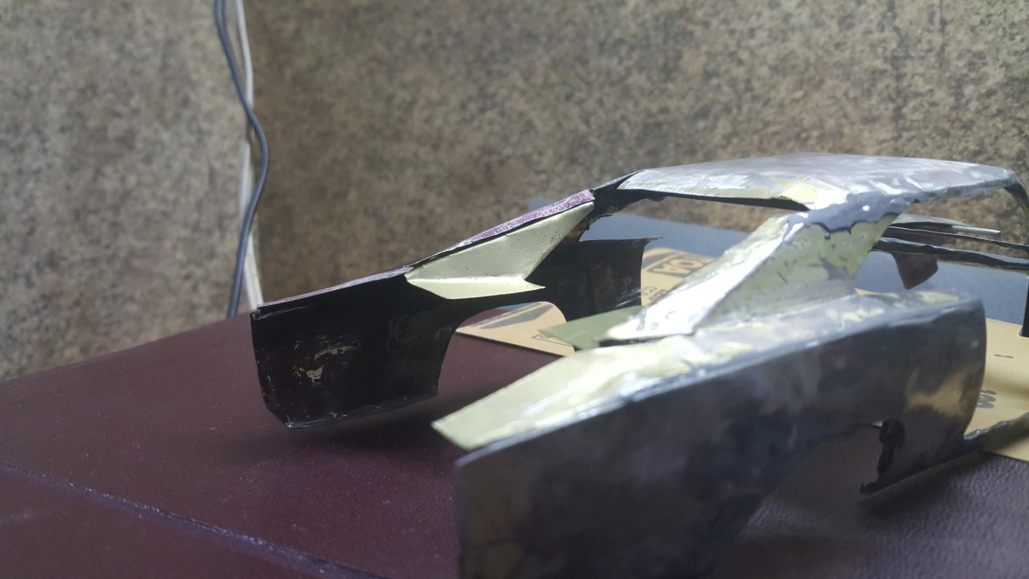

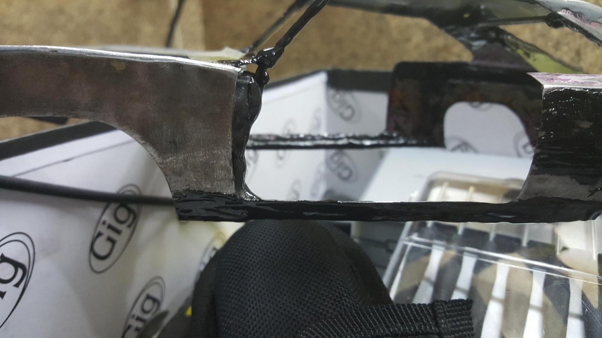

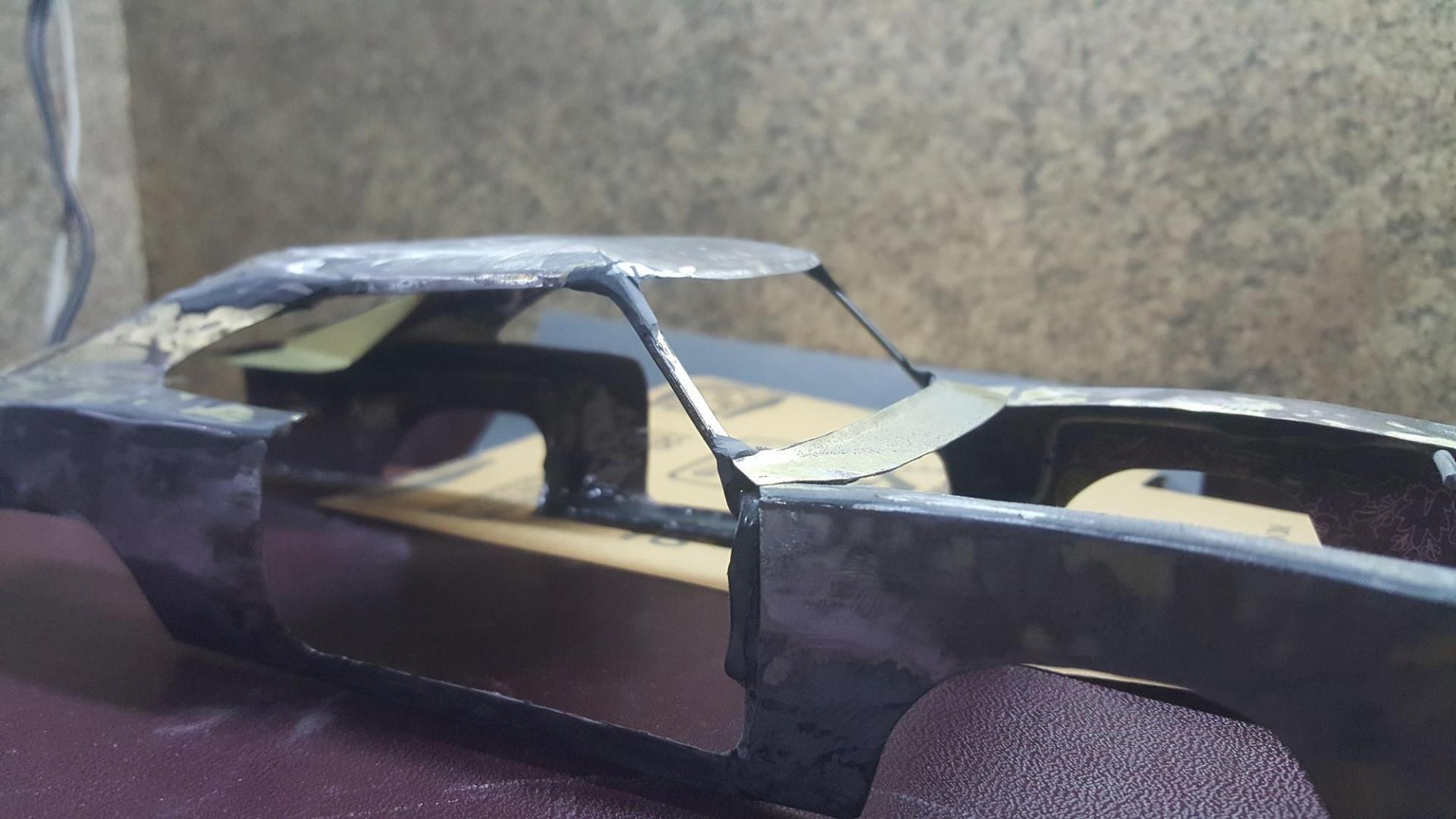

dosimeter Posted June 18, 2016 Author Posted June 18, 2016 Added B pillars insides, and A pillars. More filling and sanding too. Getting A pillars aligned was tricky, and I messed it up a little bit. But then I covered them both in depoxy and sanded until they looked the same, pictures of that later. These ones are before the correction.

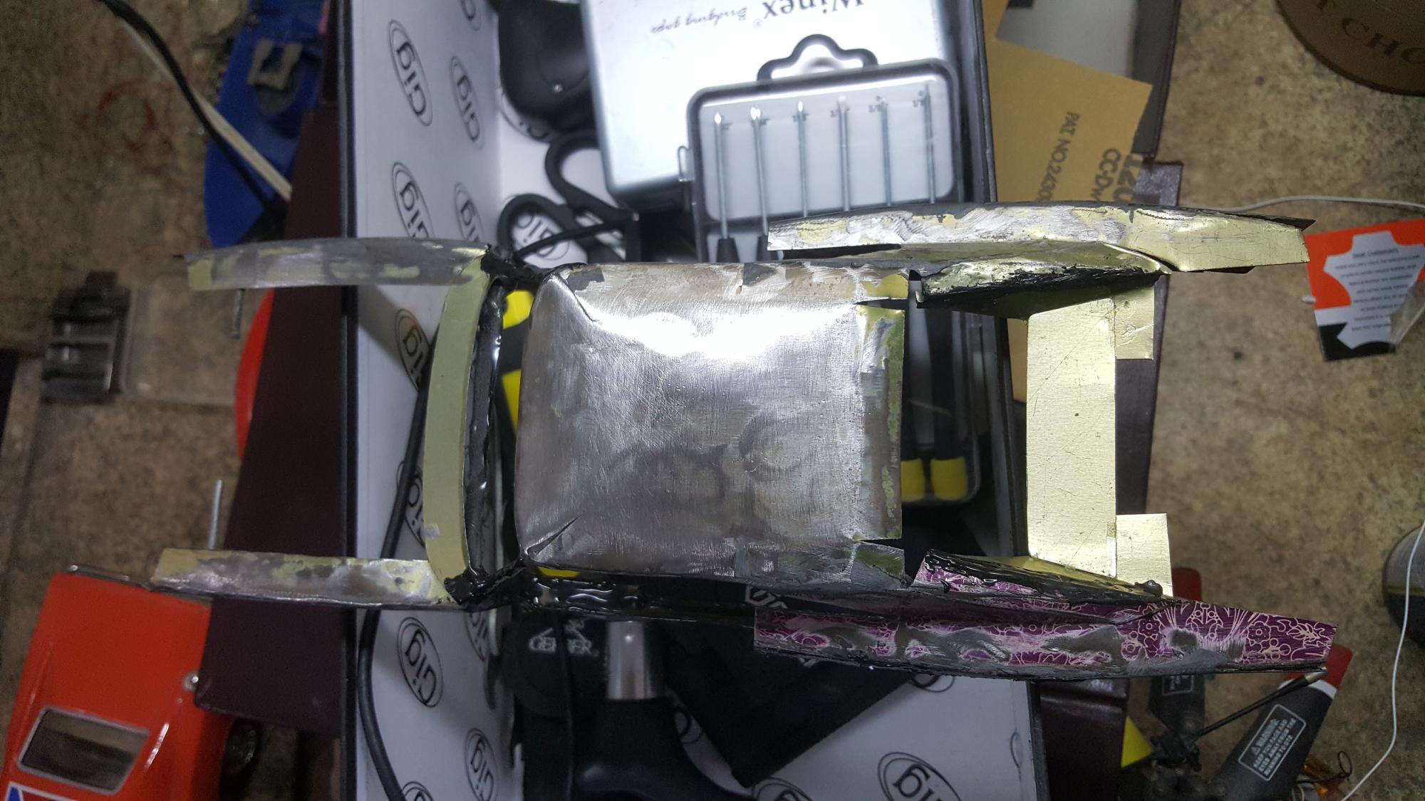

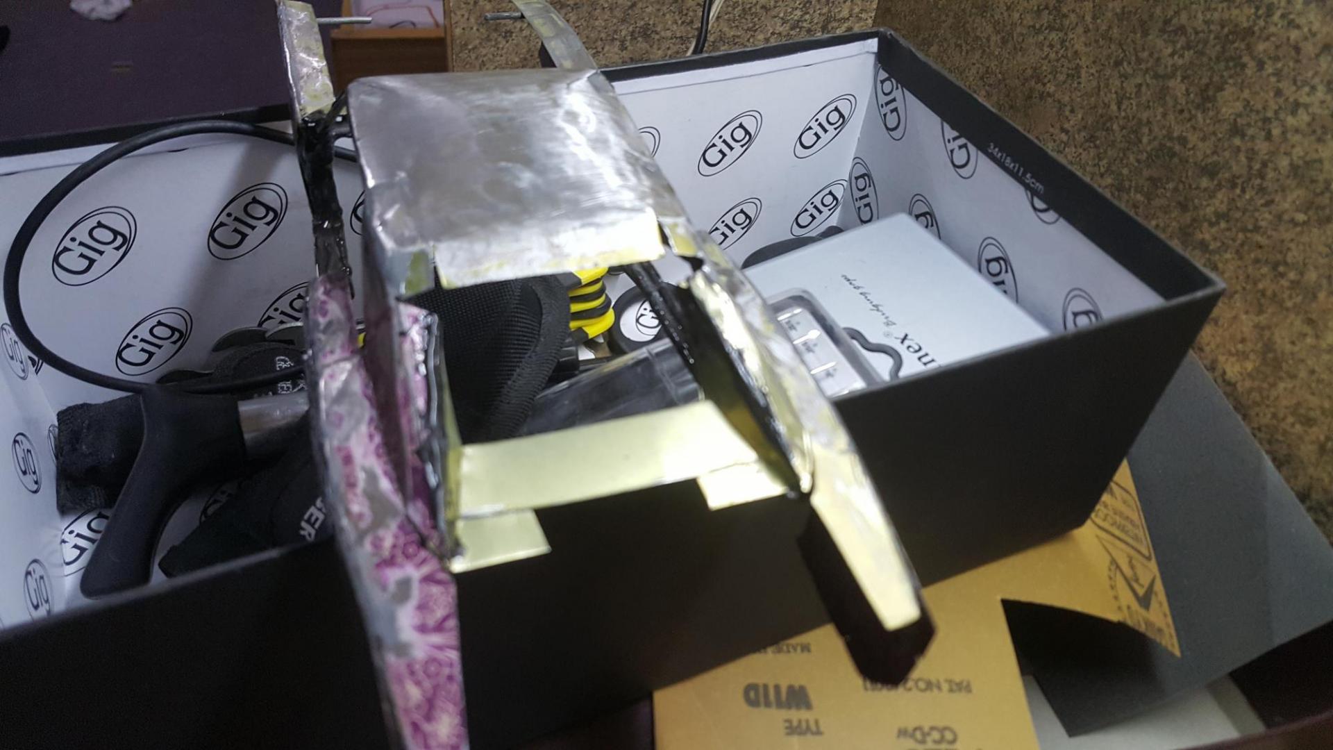

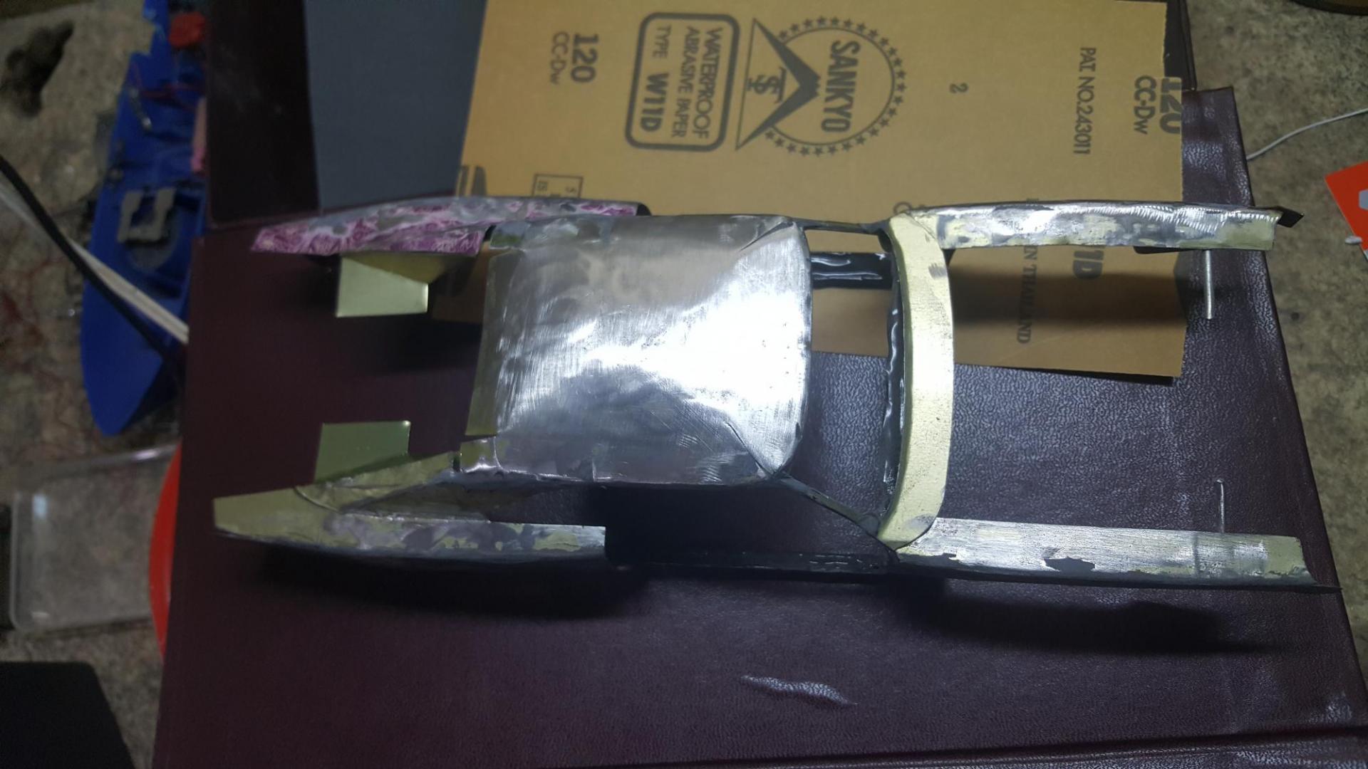

dosimeter Posted June 18, 2016 Author Posted June 18, 2016 More sanding and filling. Added this flat piece on the rear deck, the trunk comes after this. A pillars still not sanded in these pictures.

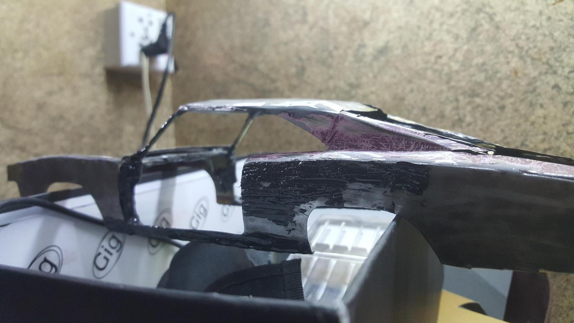

dosimeter Posted June 19, 2016 Author Posted June 19, 2016 Sanded A pillars today. They do look symmetrical but there is still some fine sanding to be done. Also the rear is taking shape very well. Sanded that too. Still needs some filling but I ran out of depoxi. The part where the roof ends is a little more curved downwards when I compared to the original pictures and other models. I am thinking of leaving it as is though I can change it by filling. Also, can I use plaster of paris for filling?
dosimeter Posted June 19, 2016 Author Posted June 19, 2016 Could someone please answer these?1) What sandpaper should I be using for final sanding? Currently I am using 120 and 220 grit. This works well with metal but when it comes to filler, I think I should be using a finer grit because it leaves it rough.2) Wet sanding or dry sanding? I haven't tried wet. Is it preferred? If so then why and when?3) Can I use Plaster of Paris as filler?
crowe-t Posted June 19, 2016 Posted June 19, 2016 For final sanding 300 and 400 grit should work and then some 600 grit. Wet sanding keeps the sand paper clean with no build up. For filler you might want to try Bondo or some other auto body filler. These will adhere well to the metal which they are made to do. Plaster may not stick as well on the metal. You can spread the auto body filler right over the panels and shape it to match the die cast body. The auto body filler sands easily.
