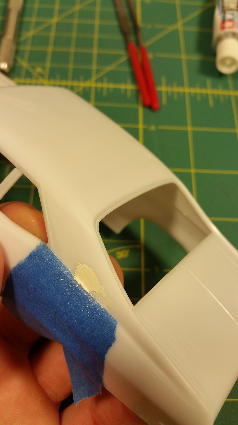

Upon taking this one out of the box, I was impressed with the contents, but not with the mold lines left on the body. The trunk has the most hideous mold line ever on it. Also looks like something happened during shipping to the store that left a huge indention on the drivers side C-pillar. So I addressed this first and foremost. I used Tamiya putty and the painters tape to keep my bodyline present during the sanding.

Here you can see the big dent left in the body from shipping.

Pretty deep as it almost went through the plastic to the inside of the body.

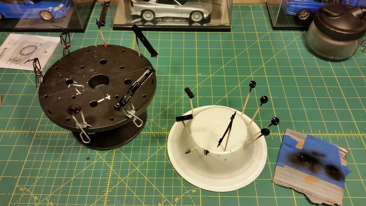

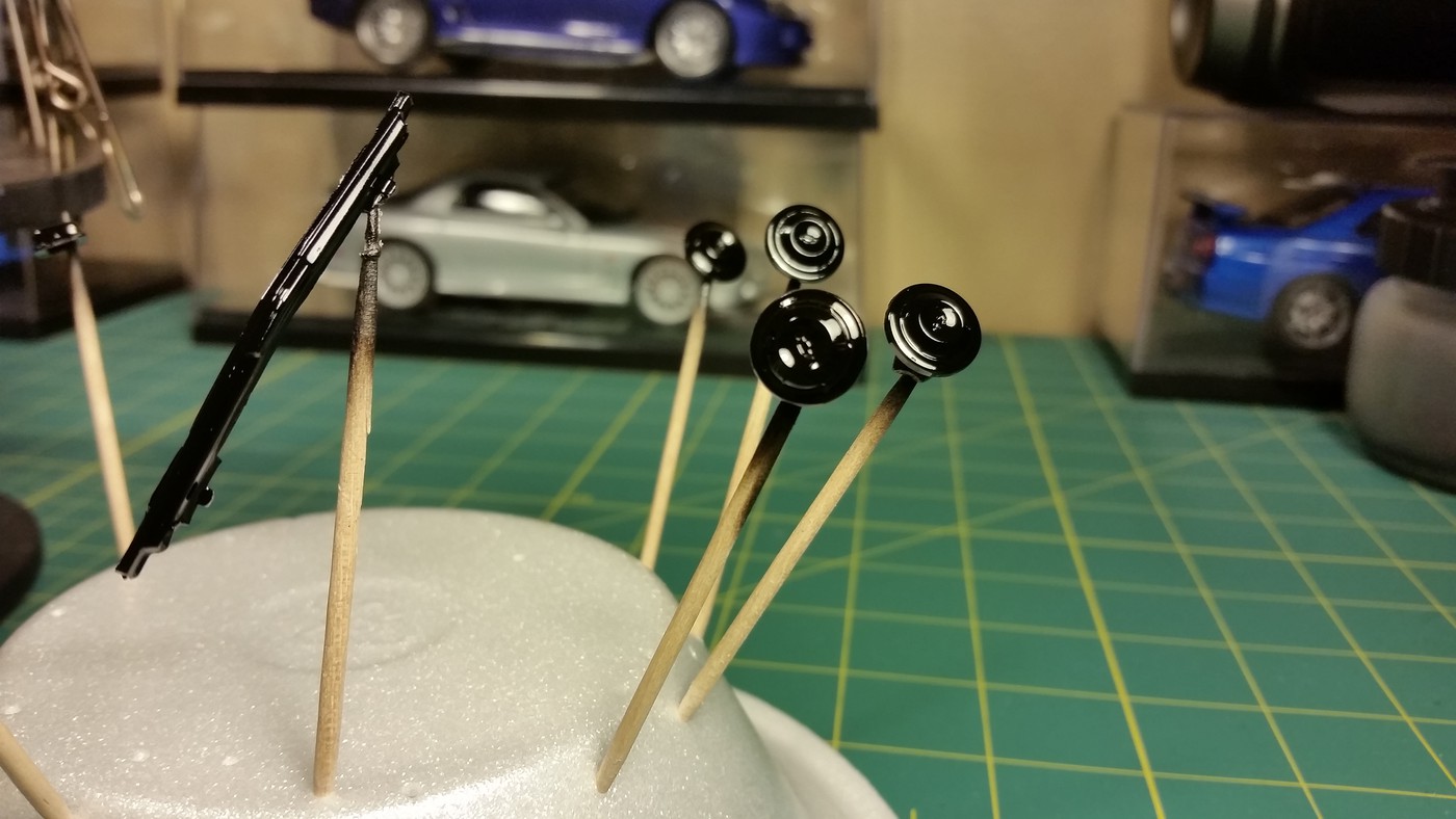

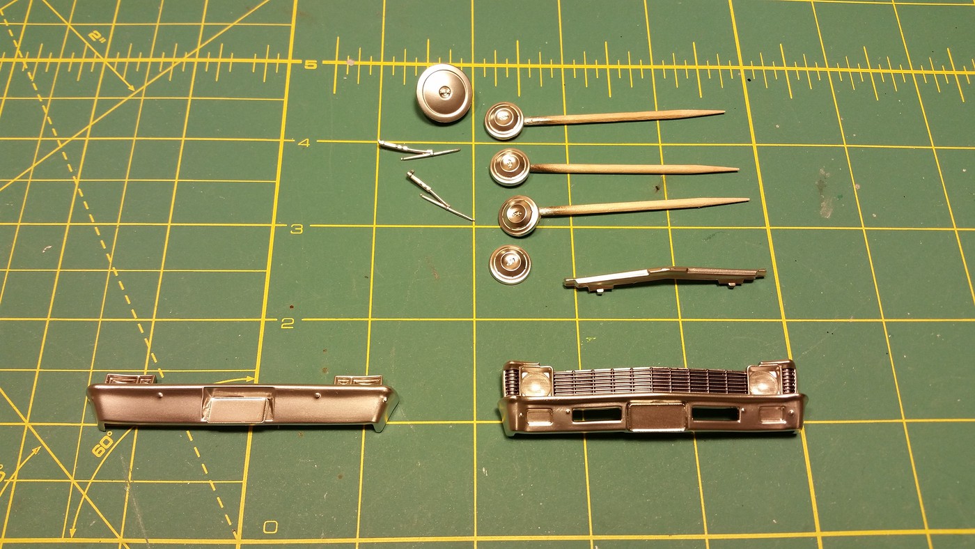

Yesterday, I stripped all of the Chrome plated parts in  Bleach, and got them sprayed in Tamiya X-1 Gloss black to get ready for Some SpazStix Chrome today after work. I love how smooth this paint lays down with an airbrush.
Edited by lghtngyello03
I had a little time tonight to spray all of my chrome parts with SpazStix Chrome through my airbrush. All of these parts pictured have NOT been buffed yet. Everything laid down good and smooth and looks really chrome-like, a much more realistic look compared to the kit plated chrome. Again, I'm much more impressed with the SpazStix Chrome vs. the Alclad Chrome.

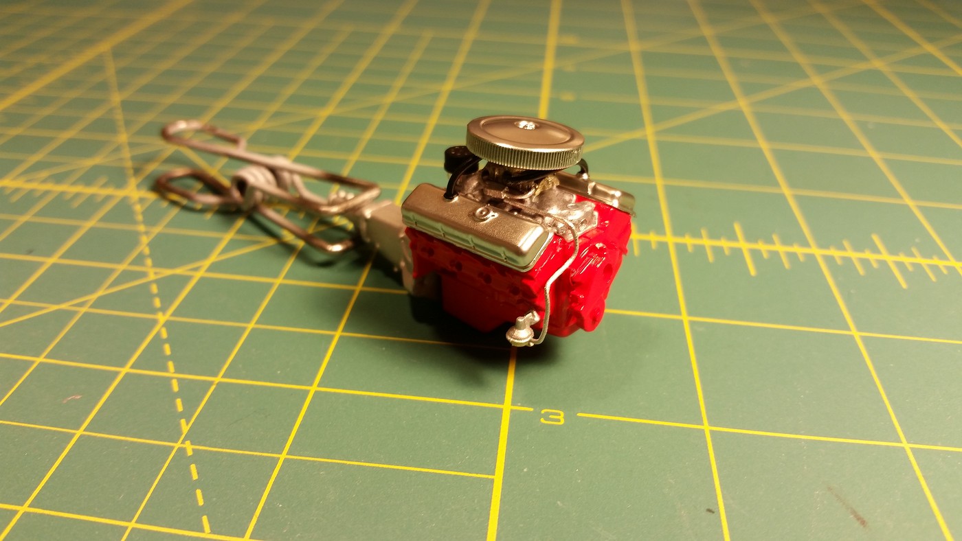

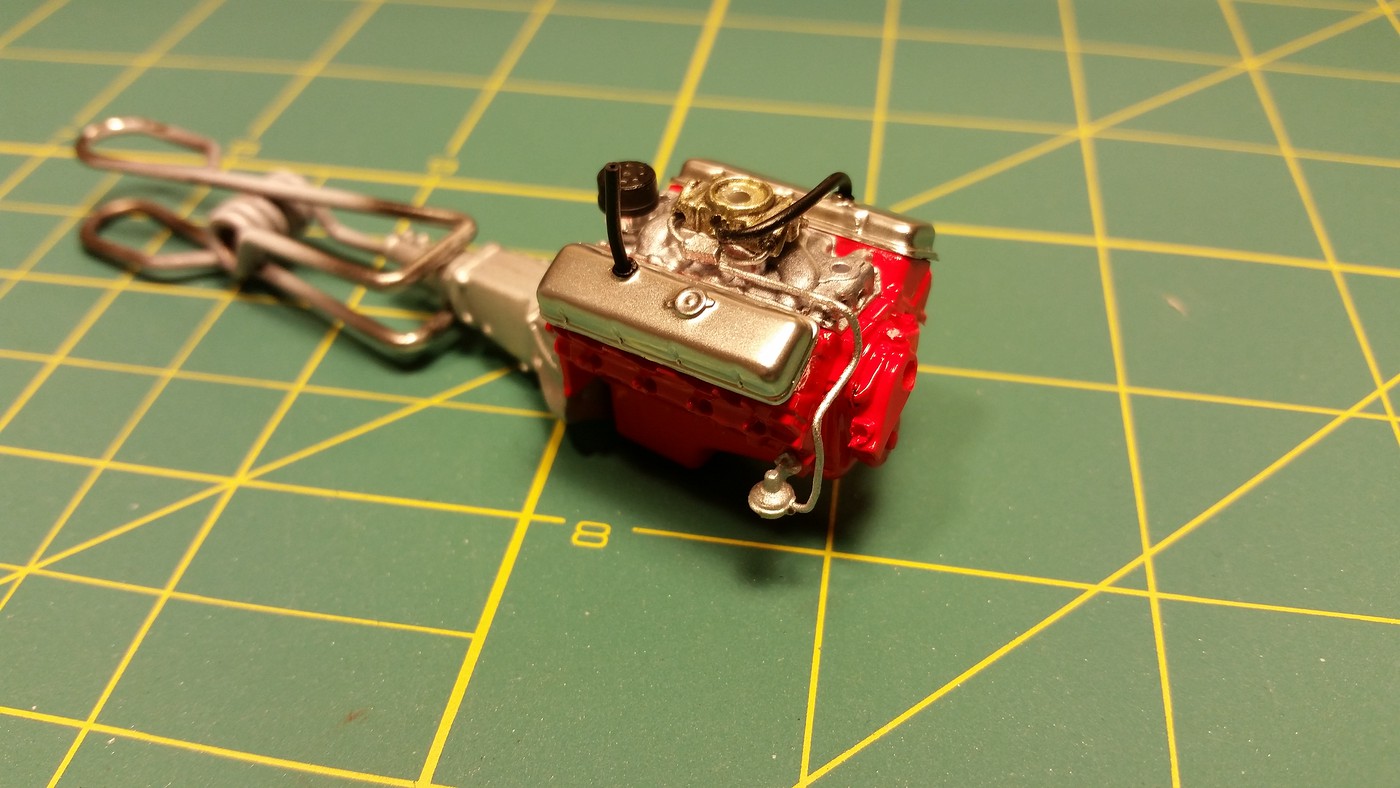

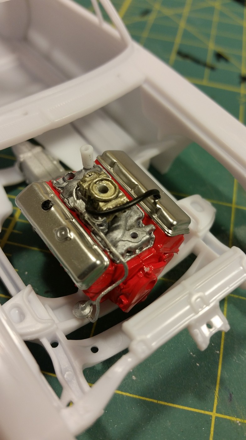

Got a good bit accomplished last night with the small amount of time I had. I sprayed the engine, with my airbrush, using Model Masters Chevrolet Engine Red enamel last Friday. So, it has had 4-5 days to dry so I can handle it with no worries.
I really want to go detailed on this build so, this is my first build with plug wires, breather hoses, heater hoses, and fuel lines, so go easy on me, lol.
I also managed to get my front bumper/grille detailed and ready to go after painting with SpazStix Chrome. I just noticed while I was uploading the pics, I have to detail around the headlights, doh, lol.

Also pictured are all parts after painting with SpazStix Chrome.
I know the air cleaner isn't pushed down all of the way, I just did this pic for reference of the breather on the passenger side valve cover.20161115_213954.jpg
 I just noticed while I was uploading the pics, I have to detail around the headlights, doh, lol.20161115_213640.jpg
