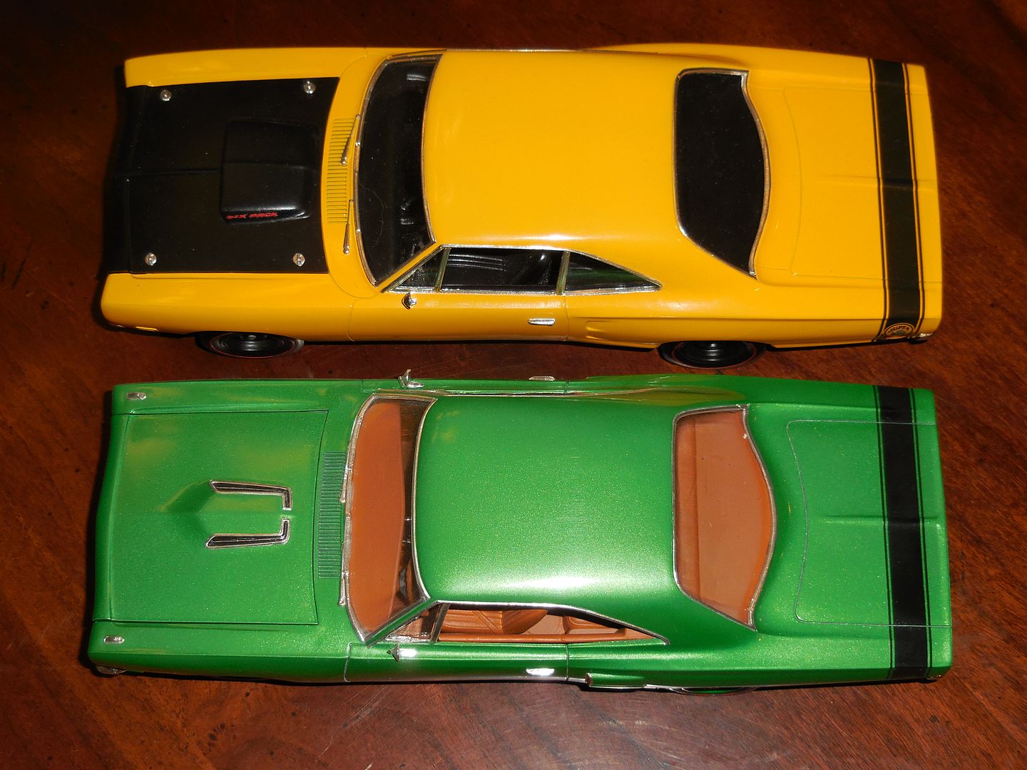

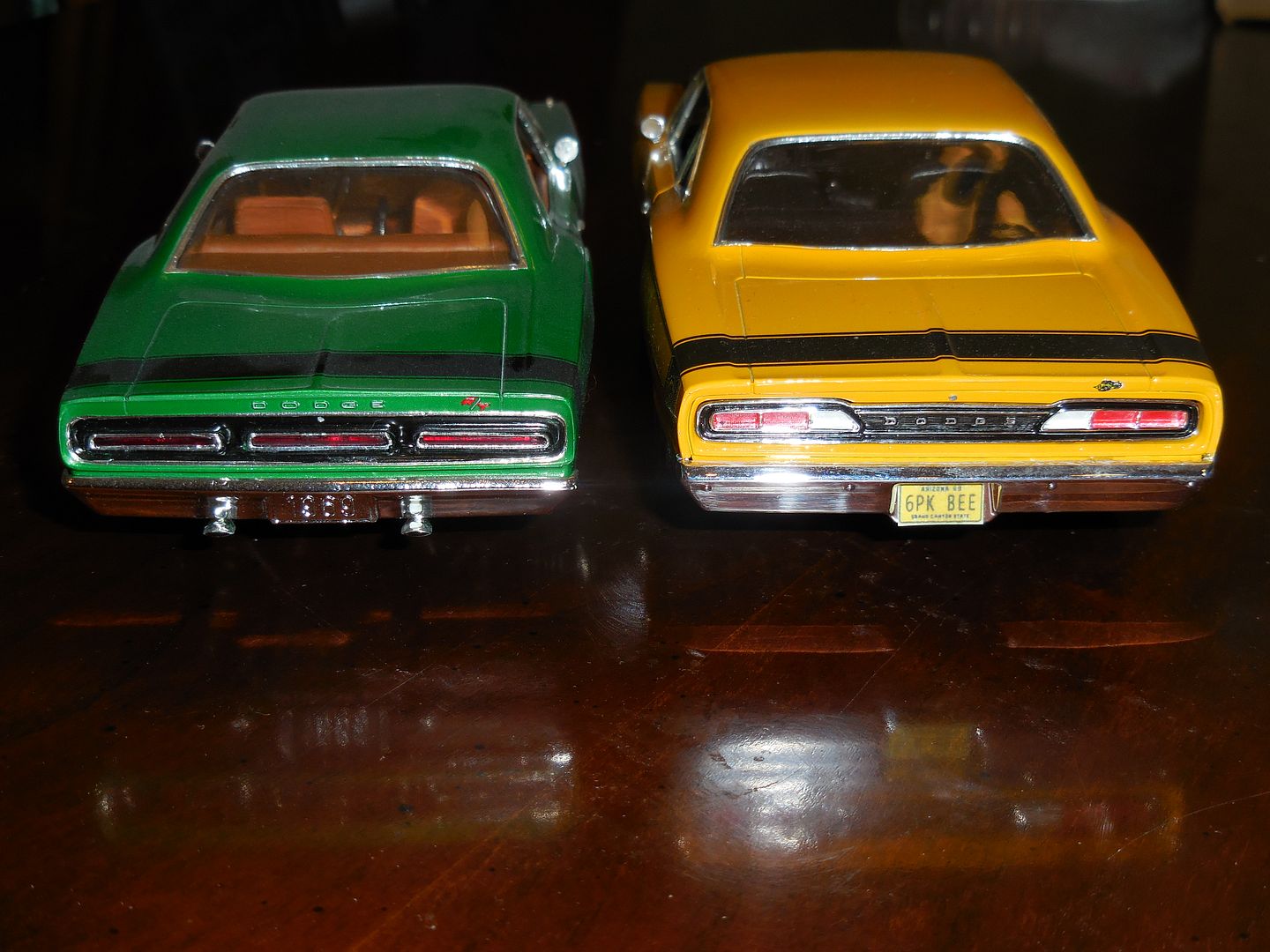

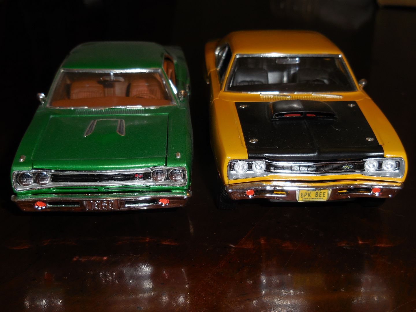

Sport Suburban Posted November 11, 2016 Posted November 11, 2016 I have built both the Monogram 69 Super Bee and a resin version MPC 69 Coronet RT. I can take photos side by side. I have not done what you want to do thou. I did however convert a Modelhaus 68 Coronet RT to a 68 Super Bee.
mopargreg Posted November 11, 2016 Author Posted November 11, 2016 Hi Raoul, Yes please if you get a chance could you take a a few side by side photos please? Im leaning towards doing the MPC conversion, what have I got to loose & I like a good challenge!
Sport Suburban Posted November 13, 2016 Posted November 13, 2016 I hope this helps. The monogram kit is much bigger.

mopargreg Posted November 15, 2016 Author Posted November 15, 2016 Thanks for posting the photos. Im going to modify the MPC kit to make a A12 Superbee. The Monogram kit does look good but it will look huge next to my 1/25. Thanks for your help. Once I start Ill post my progress on here. Thanks again.

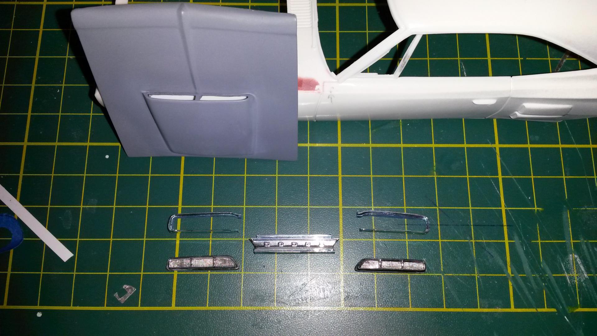

moparmike Posted January 14, 2017 Posted January 14, 2017 I'm doing this exact conversion right now. It's been on my to do list for ages, but the rear panel always stumped me. It had been suggested that cutting the panel in three, on an angle just inboard of the tail lamps would work. It does, sort of. But then you have a seam right through the ribbed section, not easy to correct. I had a couple of spare panels, and I tried it out, just not satisfied with the result. Current attempt, and this one looks like it's working involves cutting the panel into 5 pieces.
High octane Posted January 14, 2017 Posted January 14, 2017 On 1/14/2017 at 5:21 PM, moparmike said: I'm doing this exact conversion right now. It's been on my to do list for ages, but the rear panel always stumped me. It had been suggested that cutting the panel in three, on an angle just inboard of the tail lamps would work. It does, sort of. But then you have a seam right through the ribbed section, not easy to correct. I had a couple of spare panels, and I tried it out, just not satisfied with the result. Current attempt, and this one looks like it's working involves cutting the panel into 5 pieces. You could get the rear taillight panel from Hart's Parts and make it smaller, as it seems like less work to me?
