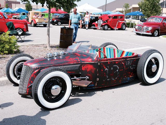

Has anyone yet test fitted the duval style windshield from the AMT Phantom Vickie on the recent Revell '29 roadster? Something like this has to happen.

That's a Hallock windshield in your photo, actually.

FYI the windshield in your photo is actually a Hallock style.The basic difference between it and the Duval id that the Duval has a frame on all four sides of the glass and the Hallock has no frame at the top edge.Great reference photo BTW.
Okay since the other pic was distracting, I've replaced it with a pic of the windshield in question. Thank you for the info.

The first photo was actually very cool and just might inspire some to attempt to clone it in scale.I noticed the highboy did not have any visible headlights.Maybe the luck guy was going racing.
