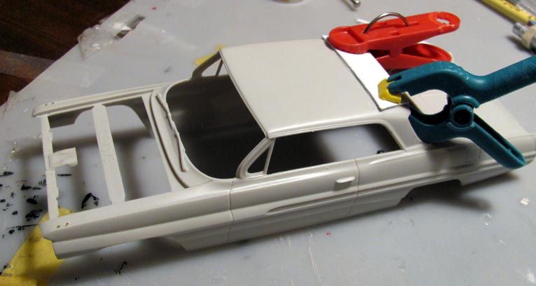

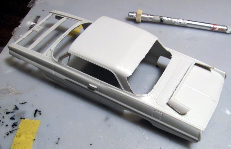

MarkJ Posted January 11, 2017 Posted January 11, 2017 I'm pretty much a Nascar only guy but I have finally decided to build this model. I'm probably going to need a lot of help from you drag race guys so please chime in if you see me doing something wrong.
MarkJ Posted January 11, 2017 Author Posted January 11, 2017 The kit. I have to make it into a 2 door sedan

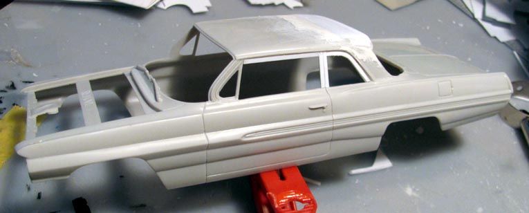

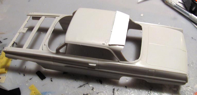

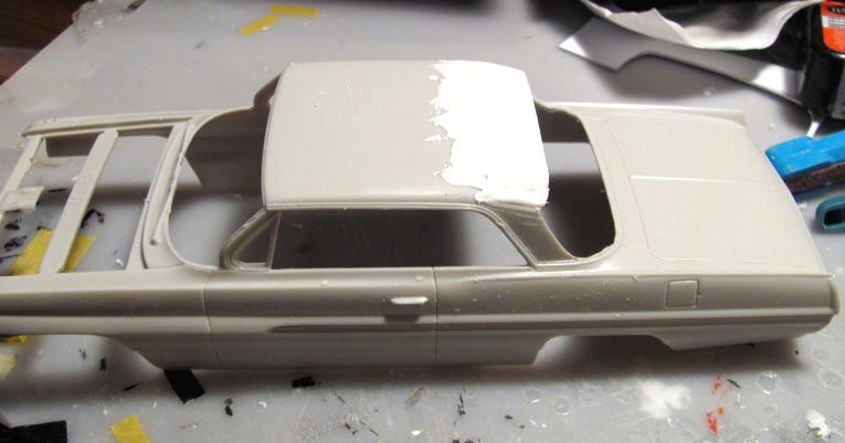

MarkJ Posted January 11, 2017 Author Posted January 11, 2017 I need to get rid of the sloped area at the back of the roof that the hardtop has but the sedan does not..

Old Coyote Posted January 13, 2017 Posted January 13, 2017 (edited) As you know, I don't usually comment on builds in progress ............. but I just have to tell you I'm watching this one .......... it was one of my favorite carsYou're doing beautiful work sir ! Edited January 13, 2017 by Old Coyote
MarkJ Posted January 13, 2017 Author Posted January 13, 2017 As you know, I don't usually comment on builds in progress ............. but I just have to tell you I'm watching this one .......... it was one of my favorite carsYou're doing beautiful work sir !John, Thank you so much and also thank you so much with your help. I think it will be a much better model because of your input.

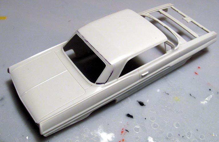

DumpyDan Posted January 14, 2017 Posted January 14, 2017 Now this is what I like, really nice work on the roof. I will be watching.........awesome
MarkJ Posted January 14, 2017 Author Posted January 14, 2017 Now this is what I like, really nice work on the roof. I will be watching.........awesomeThanks, Dan. I appreciate the feedback.

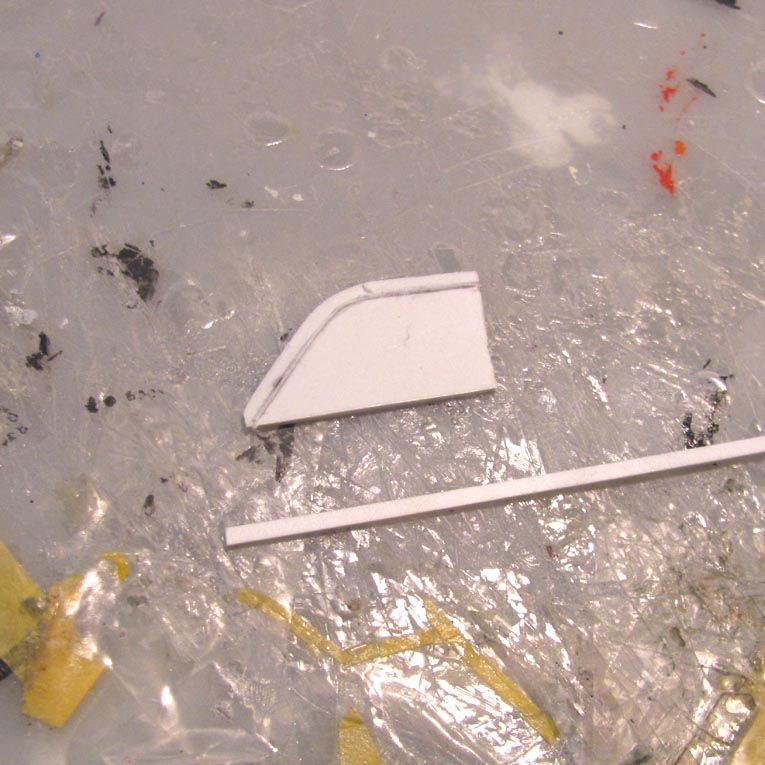

Alan Posted January 14, 2017 Posted January 14, 2017 Mark, how come you did not use strip styrene for the frames ? Seems like you went the hard route .....
MarkJ Posted January 14, 2017 Author Posted January 14, 2017 Mark, how come you did not use strip styrene for the frames ? Seems like you went the hard route .....Alan, I don't understand your question. I did use strip styrene for the frames. The quarter glass frame was cut out from a piece of sheet styrene because its much harder to make a strip adhere to a bend like that.
Alan Posted January 14, 2017 Posted January 14, 2017 I see, I have done conversions like that and use the strip and zap .......
MarkJ Posted January 15, 2017 Author Posted January 15, 2017 (edited) I see, I have done conversions like that and use the strip and zap .......Me and zap don't get along. The fumes are tough on my asthma. Regular testors glue doesn't seem to bother it. I have to make things fit before I glue them unless you have a situation where you can use small clamps. also I have had things glued with zap come apart with age. BACK GLASS AND MORE IS ON THE NEXT PAGE. Edited January 16, 2017 by MarkJ
