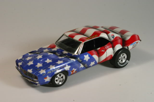

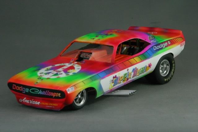

Old Coyote Posted February 3, 2017 Posted February 3, 2017 John, did that regulator come with your compressor or did you have to add it. When I bought my compressor about 9 years ago at hobby lobby I didn't research very well what I needed to have and bought it without a regulator. It had a built in regulator set at 40psi so that's where I always had to spray at. Needless to say I didn't have very good results. That's why I gave up on it and just used rattle cans. I'm hoping this needle valve will allow me to get better results. I bought the regulator separately when I purchased my first airbrush setup. It's a stand-alone unit that connects on one side to the compressor and on the other side to the hose. The connections are made with quick connects. Before I got it I had to use the non-accurate regulator which was built into the compressor (used the compressor for my 1:1 air tools). If I remember correctly it cost around $15. John Pattison, the man who taught me to use an airbrush told me I had to get an external regulator/trap. He is an absolute master with an airbrush as you can see below
MarkJ Posted February 4, 2017 Author Posted February 4, 2017 Wow, that's some awesome work. Especially the American flag car,
