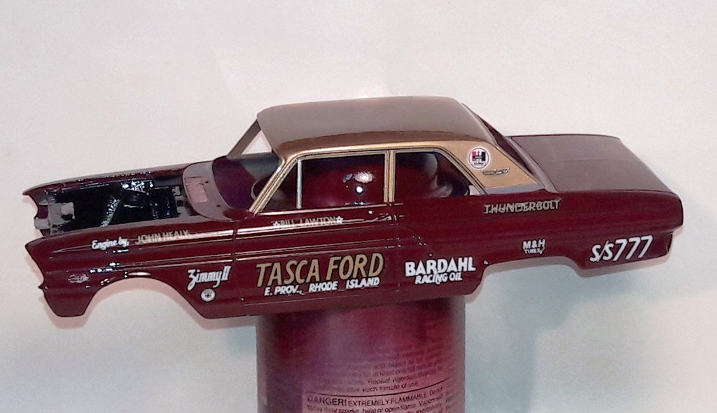

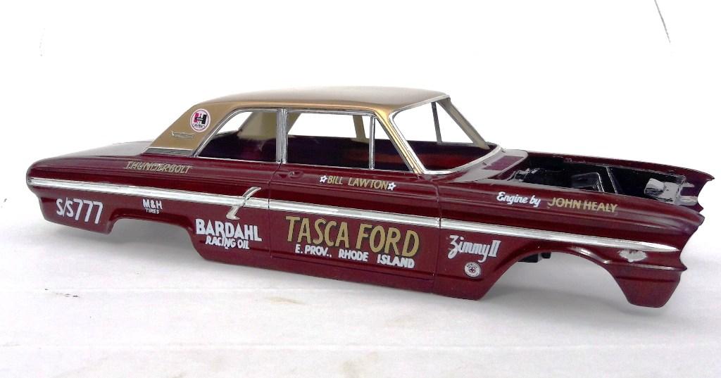

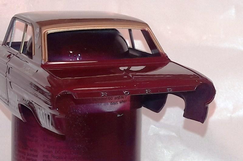

gtx6970 Posted February 24, 2017 Posted February 24, 2017 (edited) Having seen this actual car in person many many years ago. I knew someday I needed to build one in scale. And that day has finally arrived. After doing a little research a couple years ago I found out that Tamiya makes the colors that gets me extremely close if not dead on to the 1/1 . TS11 for the maroon and TS21 for the gold . Having built the Gas Ronda and Hubert Platt cars in the past . So I'm somewhat familiar with the kit itself. And IMO , its one of Revells best in 1/25th scale . Nothing special really, its just going to be a simple box stock build to fill a hole in my display case . Painted it earlier this week, did all the decals a couple days ago. and while the house was all quite this morning, I cleared it. All the emblems were covered in bare metal foil before any paint or primer went on , then wiped off with a Tamiya Q tip and lacquer thinner once painted , but prior to clear coats. Interior tub is just Testors champagne gold . I masked off the door panels with bare metal foil and painted the white accents. ( still undecided if I want to attempt fate and do the darker upper portion of them or leave well enough alone and call it good ,,,my gut says stop now before I screw something up) Tub was masked off so I could paint the floor in a satin black to look like the rubber mat in the 1/1 . I'm a big boy so comments or criticisms more then welcome Edited December 9, 2017 by gtx6970
Snake45 Posted February 24, 2017 Posted February 24, 2017 Beautiful paint and finish! When I contemplate doing a job like that, it makes me want to take a nap.Were the engines on these Ford Blue in 1964? For some reason I have it in my head that that color didn't come in till '66. But maybe that was just for the small blocks. (Then again, I had a friend who had a restored '65 T-bird and that engine was black with gold valve covers and air cleaner.)
gtx6970 Posted February 24, 2017 Author Posted February 24, 2017 (edited) Beautiful paint and finish! When I contemplate doing a job like that, it makes me want to take a nap.Were the engines on these Ford Blue in 1964? For some reason I have it in my head that that color didn't come in till '66. But maybe that was just for the small blocks. (Then again, I had a friend who had a restored '65 T-bird and that engine was black with gold valve covers and air cleaner.)Thanks, I want to think the actual car when I saw it the long block was blue,,,,but that was over 20 years ago now I guess. Not to mention I looked at A LOT of vintage super stock cars that day. On top of the fact my memory isn't what it used to be. That trip was a very last minute idea and forgot to pack my camera ( cell phones didn't exist in my world back then ) But now you got me thinking I may need to change the color . Oh well best change it now if need be ,,,,,,back to Google images if I can find it . Edit, the only under hood pics I can find of this car are of the 1/18th scale diecast. And its blue. 100% accurate or not. I " think " I'll leave it as is . On a positive note I did find a nice article on the 1st Thunderbolt. The Dick Brannon / Romy Hammes car. And it has a black engine in it . Edited February 24, 2017 by gtx6970
mr68gts Posted February 24, 2017 Posted February 24, 2017 It may not be correct (and Im a stickler for the details) but I think the FoMoCo blue sets it off nicely. And quite frankly there is no telling what was done to the car day to day or race to race. Could have had a replacement longblock as a back up engine. I would brave it though and paint the accent on the panels as you metioned. Imo I think it would complete it an already beautiful model.Nice work!Paul

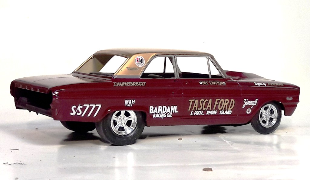

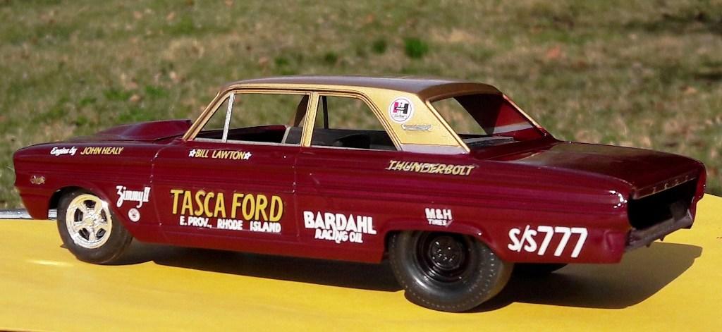

gtx6970 Posted February 24, 2017 Author Posted February 24, 2017 (edited) One with it assembled dry to ck stance and overall how it looks. Out in the sun this color comes alive . Thank you Tamiya . I cant decide if I like the black rear steel wheels or go with the Radar that match the front. Ive found pictures of it both ways Edited December 9, 2017 by gtx6970

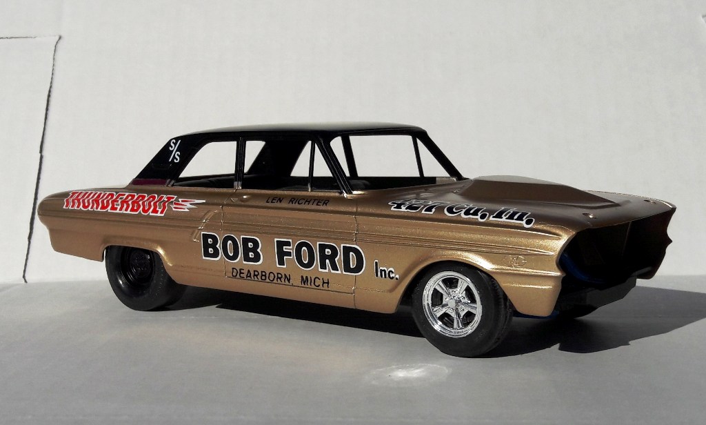

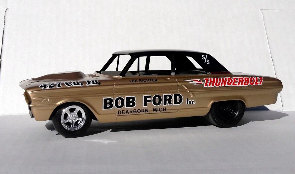

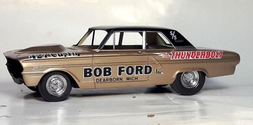

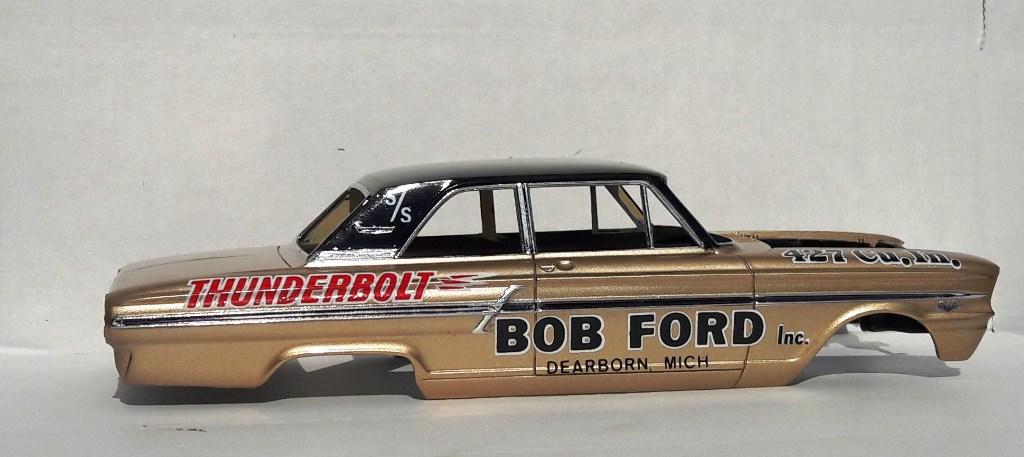

gtx6970 Posted February 26, 2017 Author Posted February 26, 2017 (edited) While browsing my local auto parts store, I stumbled on some Duplicolor gold that I think passes pretty close for the color " I think " the Bob Ford car was. And per the can its a Ford color. So I grabbed another body and hood out of the stash and quickly got to work. Sanded all the mold lines off and washed it down. Primer on Friday morning, sanded it down with 600 , then taped off the roof and painted the gold yesterday morning, taped it back up and then the black this morning. Dug out my Cady decal sheet this afternoon. And I have to say Ive never in my life had so much trouble getting decals on a model car. Seems like every one I pulled out of the water it came off the sheet in pieces. Or once it hit the body it absolutely didn't want to move no matter how wet I had the area. I was so frustrated I nearly stuffed it back in a box for some other day. But with some serious effort on my part after nearly 3 hours of work . I managed to get everything on and lined up as best I could . I'll get the chassis - power train assembled this evening then carry one with my 1st ever dual build. For now its just a dry fit to the Tasca Ford cars chassis/interior to see how it looks. This build will get the steel wheels only I'll try to the chrome pen thing on them and see how well they work . Otherwise I'll let it dry overnight then clear it tomorrow morning. Edited December 9, 2017 by gtx6970
dungeonracer Posted February 26, 2017 Posted February 26, 2017 I like what you're doing here!As to your earlier question about black steel wheels or ones that match the front, I vote for the steel wheels. Just feel it looks more period correct (could be wrong though)

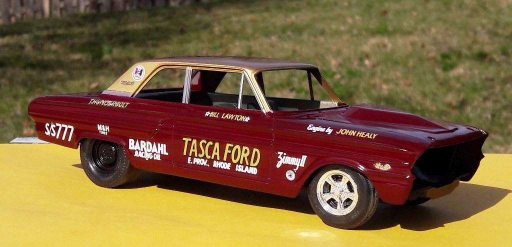

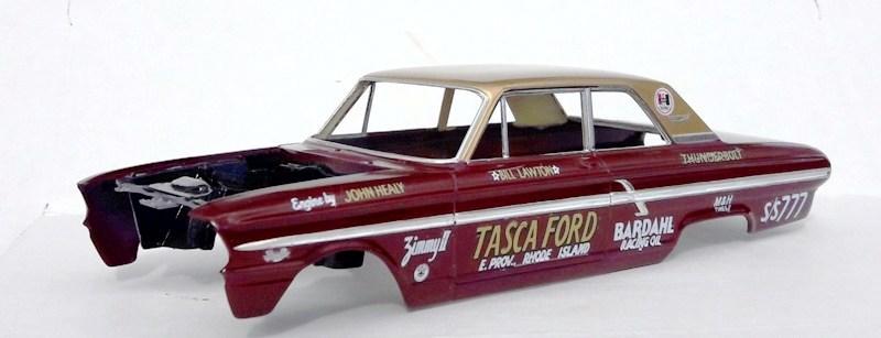

gtx6970 Posted February 28, 2017 Author Posted February 28, 2017 (edited) Final wheel choice has been decided on the Tasca car. ( my wife made the final decision. As I just couldn't decided one wheel over the other) Steel wheels on the Bob Ford car are the chrome pens , same goes the chrome around the door frames . I'll stick with BMF for the FT/RR window trim and side moldings on both cars. Decals on the Bob Ford car have fought me tooth and nail from the word go. Ive got decals to do 5 more cars. The Conner Ford car, Al Means / Phil Bonner car, 2 versions of a Butch Leal car, and the Reynolds Ford car. Problem is I'm not sure Ive got enough kits on hand to do all 5 Edited December 9, 2017 by gtx6970

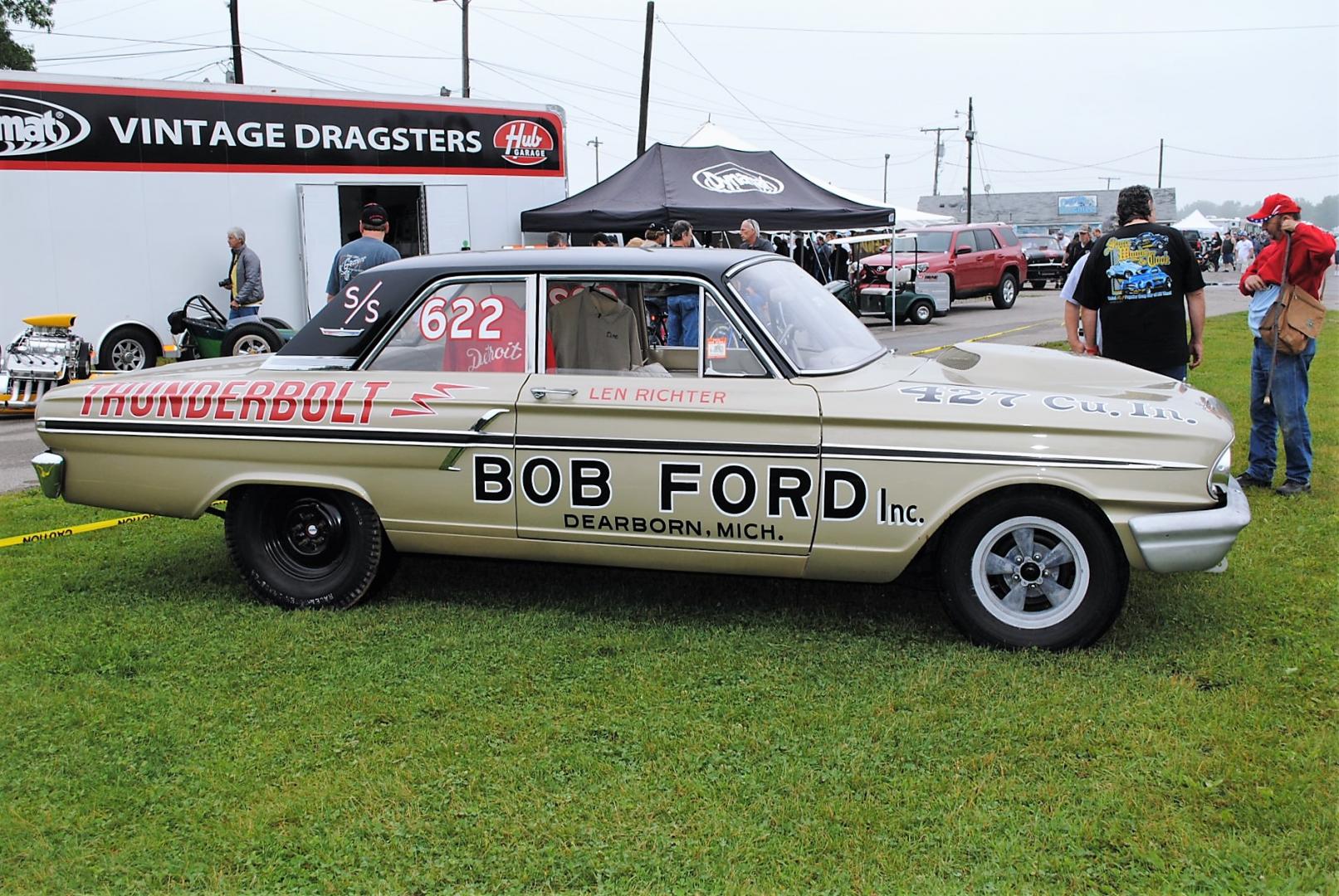

afxmustang Posted March 2, 2017 Posted March 2, 2017 Here is a photo of the actual Bob Ford car. I believe the correct color is Champaine Gold.

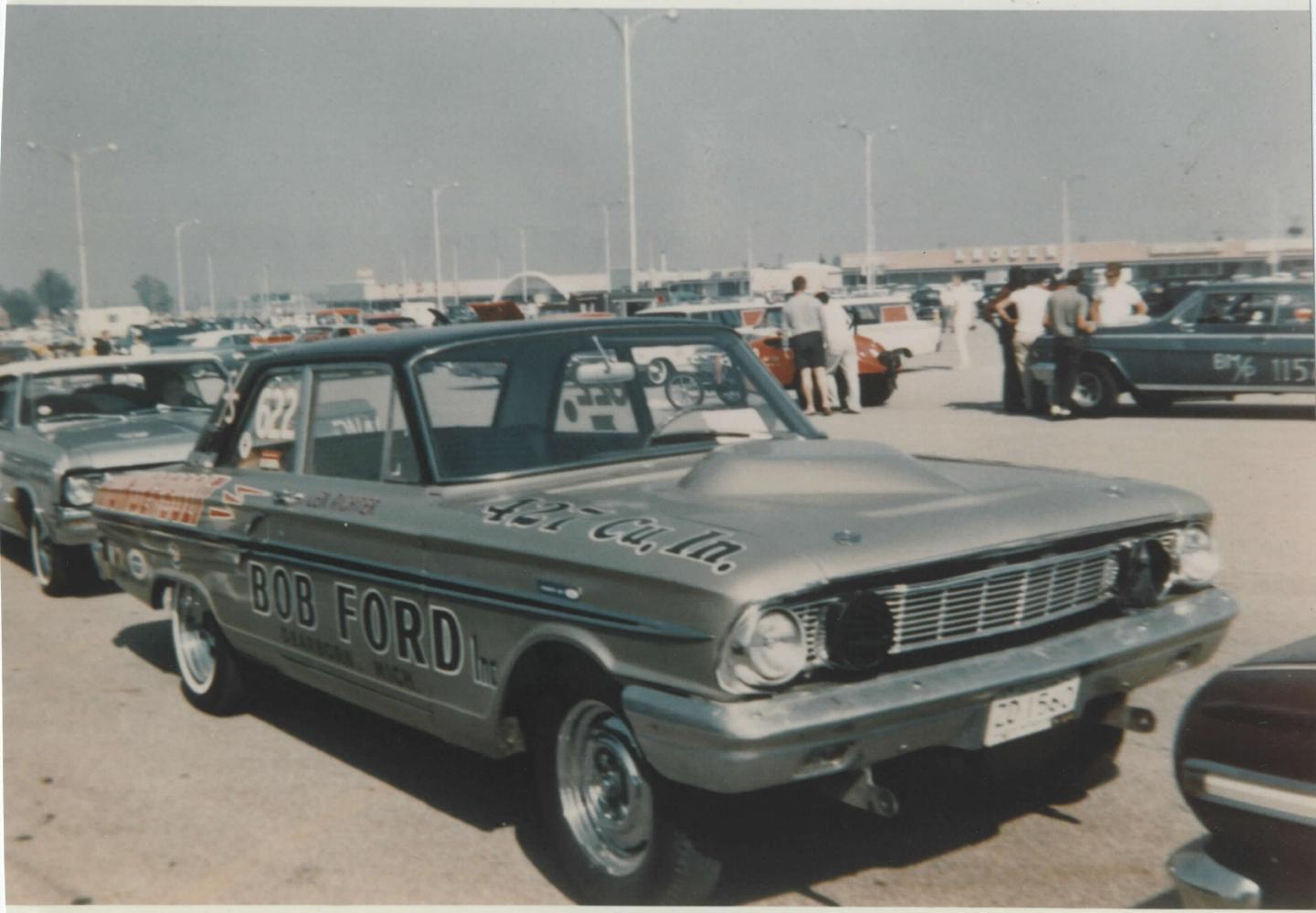

gtx6970 Posted March 2, 2017 Author Posted March 2, 2017 (edited) Here is a photo of the actual Bob Ford car. I believe the correct color is Champaine Gold. Thats the restored car ( notice the color of the name on the door ? ) I try to use period photos for references as much as I can , as an example in all the pictures I have of this car none show it with the 5 spoke wheels on the front like the restored car does . And In person the model isn't as gold as it appears ( at least not on my monitor ) Edited March 2, 2017 by gtx6970
62rebel Posted March 2, 2017 Posted March 2, 2017 I notice the restored car is missing the upper windshield corner trim piece, at least on the passenger side... picture also shows the bit of forward quarter panel cut away to clear the slicks; something Revell missed when mastering the body. Still, it's one of their best kits and I won't speak ill of it.

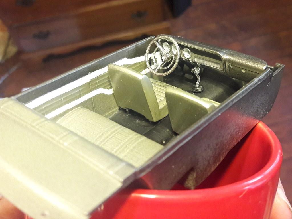

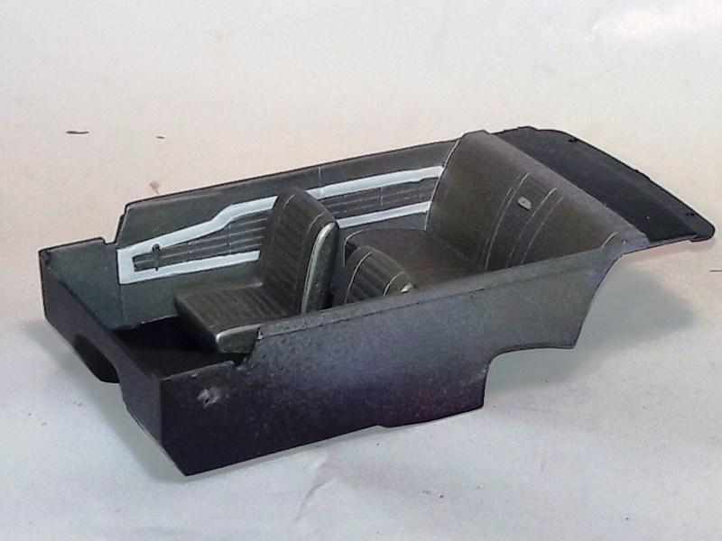

gtx6970 Posted March 5, 2017 Author Posted March 5, 2017 Thanks all. Got the bodies done with all the chrome work / Bare Metal Foil work on both cars . Working on the interiors now,, getting colors ( at least in my eye ) right . Found a duplicolor paint called Arizona Beige that looks pretty close to the painted upper portion of the doors(pics tomorrow maybe )

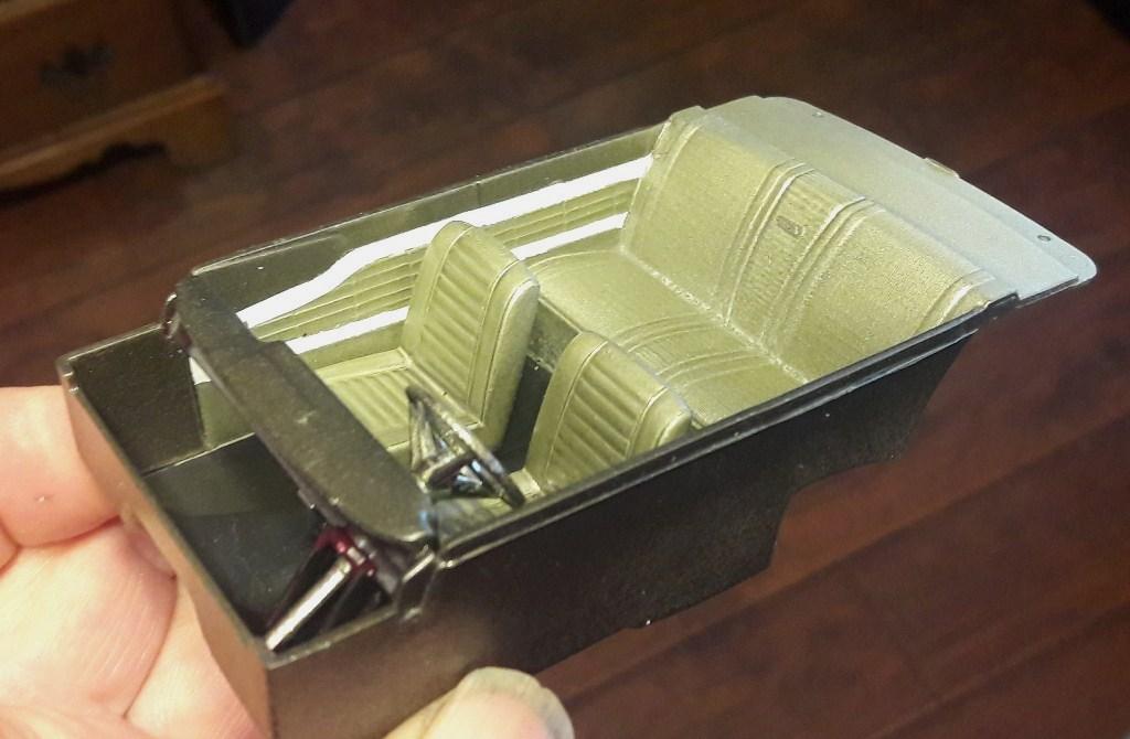

gtx6970 Posted March 6, 2017 Author Posted March 6, 2017 (edited) 2 interiors are now done (due to all the similarities I now have 4 different Thunderbolts in process) . Tub and Seats are Tamiya Champagne Gold, with testors flat clear over the lower doors and back seat of the tub and satin clear on the seats themselves. Tops of the doors and dash frame are sprayed with duplicolor Arizona beige to get me close to the 2 tone door frame I was after. Its not dead on,,,but close enough for me . It definitely has a little bit more of a gold tint to it in person than my camera/monitor depicts here . I picked out some trim on the dash and the horn ring on the steering wheel with a 1mm chrome pen. Body is essentially done on the Tasca Ford car. Front and rear window trim , as well as the body side moldings are BMF. But the door + 1/4 window frames are done with a 1mm chrome pen Edited March 6, 2017 by gtx6970
gtx6970 Posted March 6, 2017 Author Posted March 6, 2017 (edited) Only the body side moldings are done with BMF on the Bob Ford car. All the window trim ( front, rear and side ) is done with a chrome pen Edited December 9, 2017 by gtx6970
gtx6970 Posted March 7, 2017 Author Posted March 7, 2017 Well, finished the Tasca Ford car last night after dinner. headed to under glass and in my case to join the others
