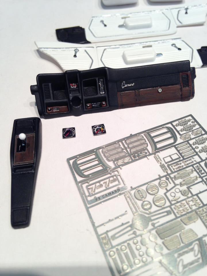

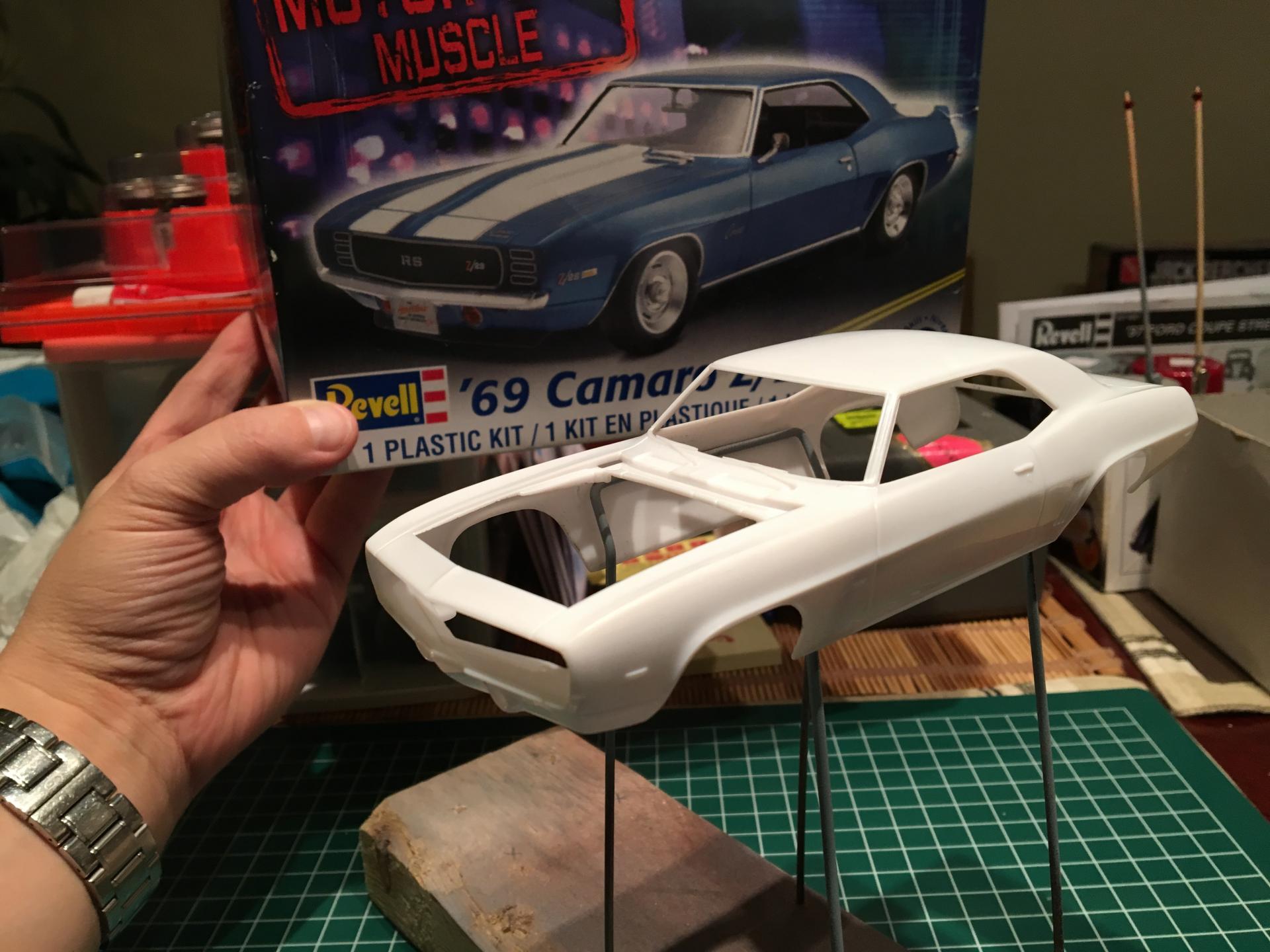

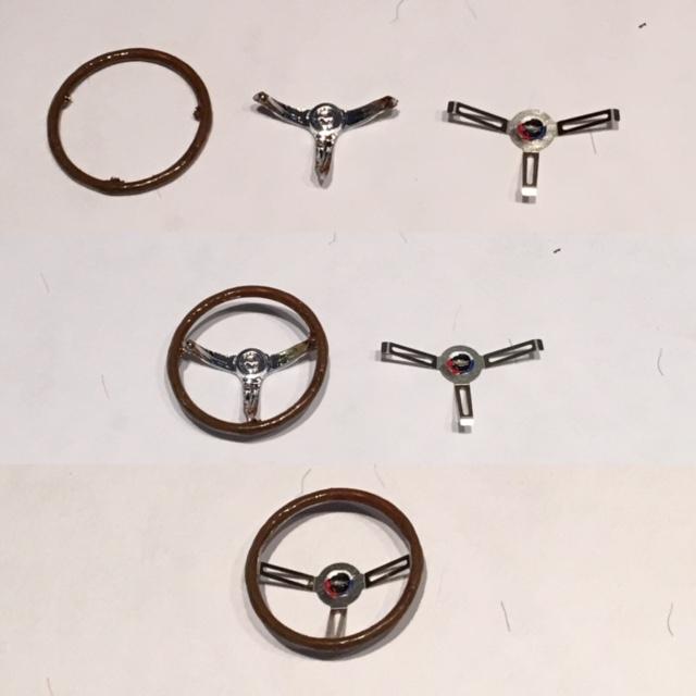

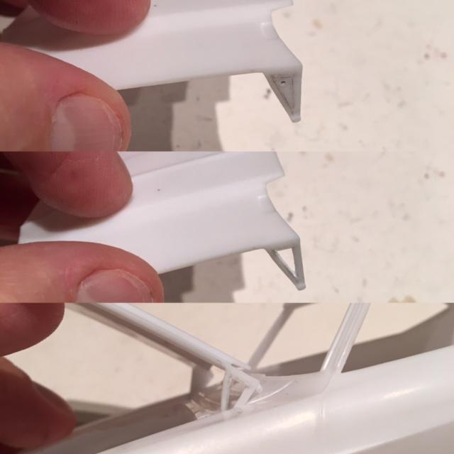

adamelvis Posted March 16, 2017 Share Posted March 16, 2017 (edited) Hello Fellow Modelers ! Boy oh Boy! I'm so excited to be back into my beloved hobby !!, it has been 18 years since I have built a model. Last year, a good friend of mine found an old "Fall Guy Truck" from MPC that he had 30+ years ago as a kid. He asked me if I could build it for him .... and that was all it took !! (I'll post pics on this kit later). Now, I have a wife and two young wonderful kids, so what better way to get on her good side, so she doesn't frown too much on the future neglect and my modeling priorities (lol) ? Start by building your wife her favorite car !! A Blue '69 Camaro RS Z/28. I will share my tips to help others and also learn from all of you, so please comment. TCB, Adam This big triangular chunk of plastic hardly looks like a realistic hood hinge. I cut the middle out and it looks much better now. MCG makes a good PE set for this model, so I got it and will use most of all the parts. (I have a question later about installing the Camaro script and Z/28 emblems on the body exterior ). Here I used the steering wheel arms and center cap. The stock one is very chunky and has not much detail. It was cut out and replaced with the PE part. Much better, however, I didn't realize that I had a decal for the center cap and I ended up doing my best red, white & blue paint job I could. I used flat black for the interior, as I did not have semi-glass black at the time. With all the man handling of these parts, the oils from your hands rub off on the parts anyhow, which ends up giving you a subtle semi-gloss look in the end. I dry brushed two shades of brown over the center console panel and dashboard. PE gages, Camaro script and glove box lock was used. QUESTION: 1.) How do I glue on the "Rally Sport" , "Camaro" and "Z-28" script to the side of my car body? do I use super glue?, regular model glue? clear window glue? or a coat of clear underneath? 2.) Do I clear coat over these parts once attached to the body? or do I add them on at the very end of completion, once the final car polish has been completed? 3.) Do most people clear coat over the BMF window trim and door handles? or is this again one of those very last things to add to your model, once the final polish has been done? Thanks ! Here is a good close up of the dual carb, 302? (can someone confirm this, as I have to know which PE engine size number to put on the hood cowl. lol). It has been plumbed and I have even made the oil dipstick by stripping of the end of a wire, bending it into a fish hook, then dipping it into yellow paint. This is such a quick & easy thing to do for additional engine detail. More pics later .... TCB, Adam Edited April 2, 2017 by adamelvis added tags Quote Link to comment Share on other sites More sharing options...

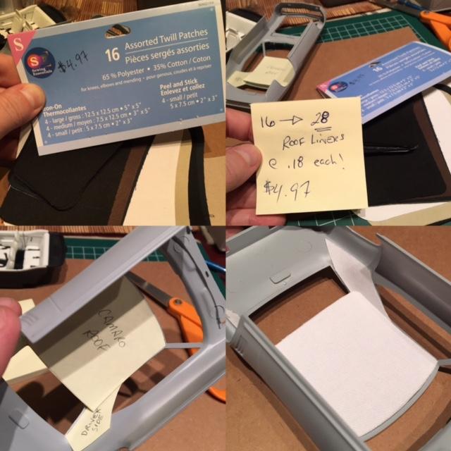

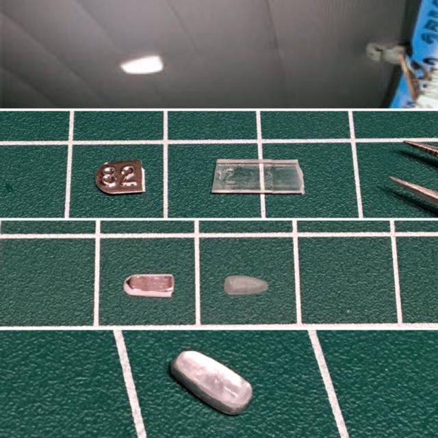

adamelvis Posted March 20, 2017 Author Share Posted March 20, 2017 (edited) Went to the local Walmart and picked up this pkg of twill patches for $5. Cut out a roof liner from a template I made from Post-It notes. You can make about 28 roof liners for less than .20 cents each !!. With an option for four different colors also (black brown, tan & white). This was my attempt to make a interior dome light for the 69 Camaro, using some scrap from the parts tree. The light cover should be white plastic, however, I used clear. I might paint over it later. TCB, Adam Here is the final result. Both the cloth roof liner and dome light worked out great ! Edited April 2, 2017 by adamelvis Quote Link to comment Share on other sites More sharing options...

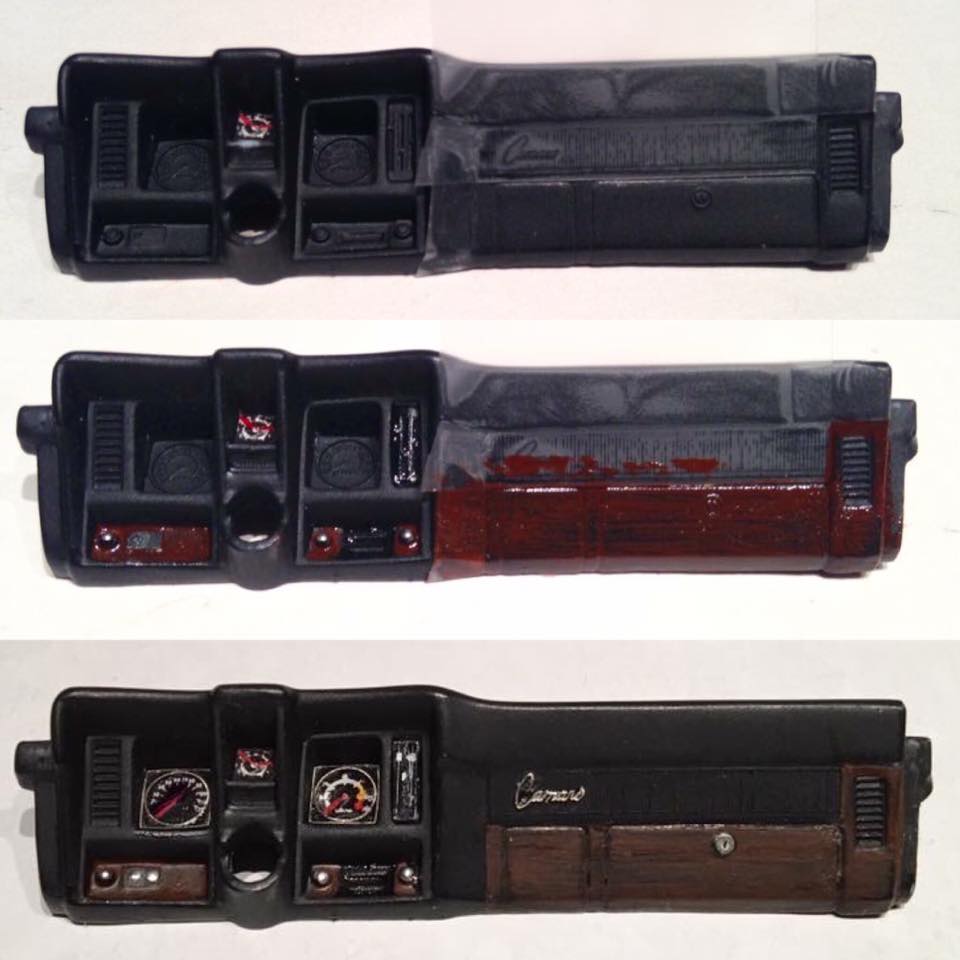

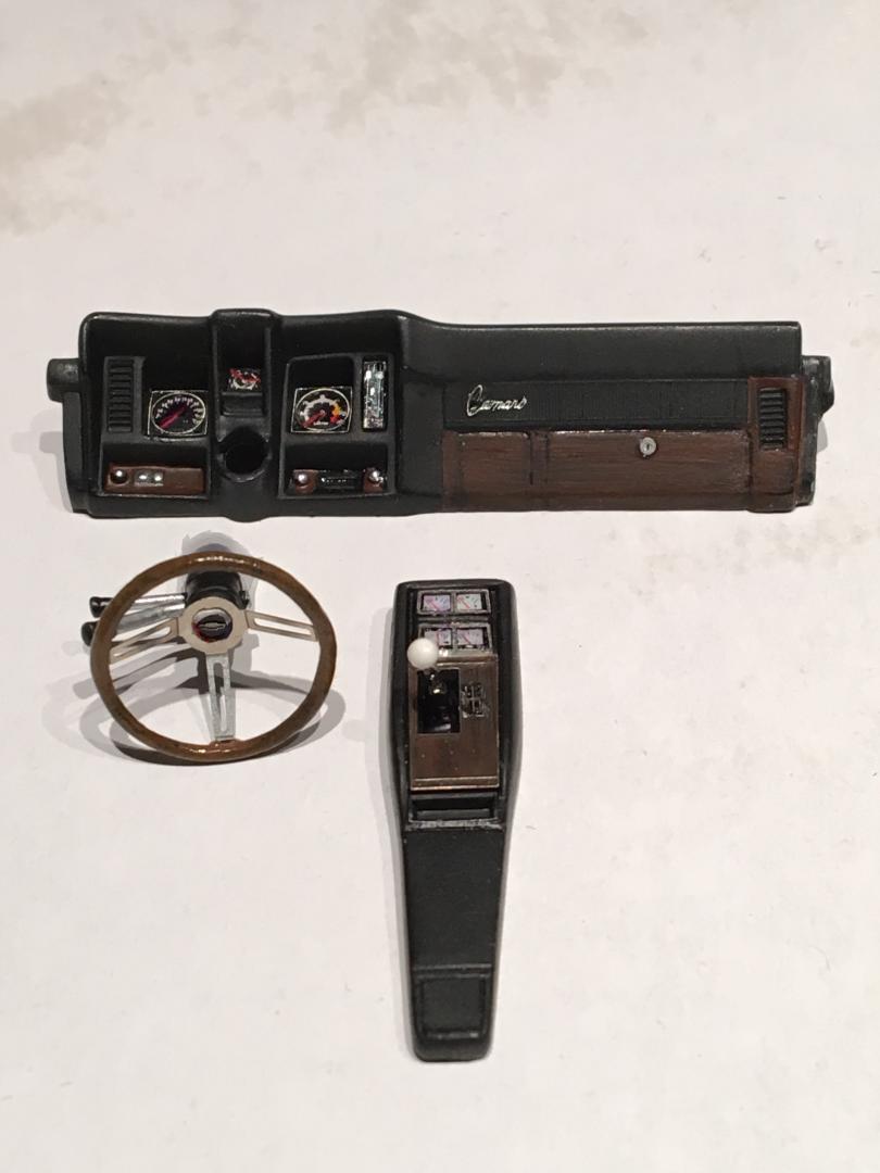

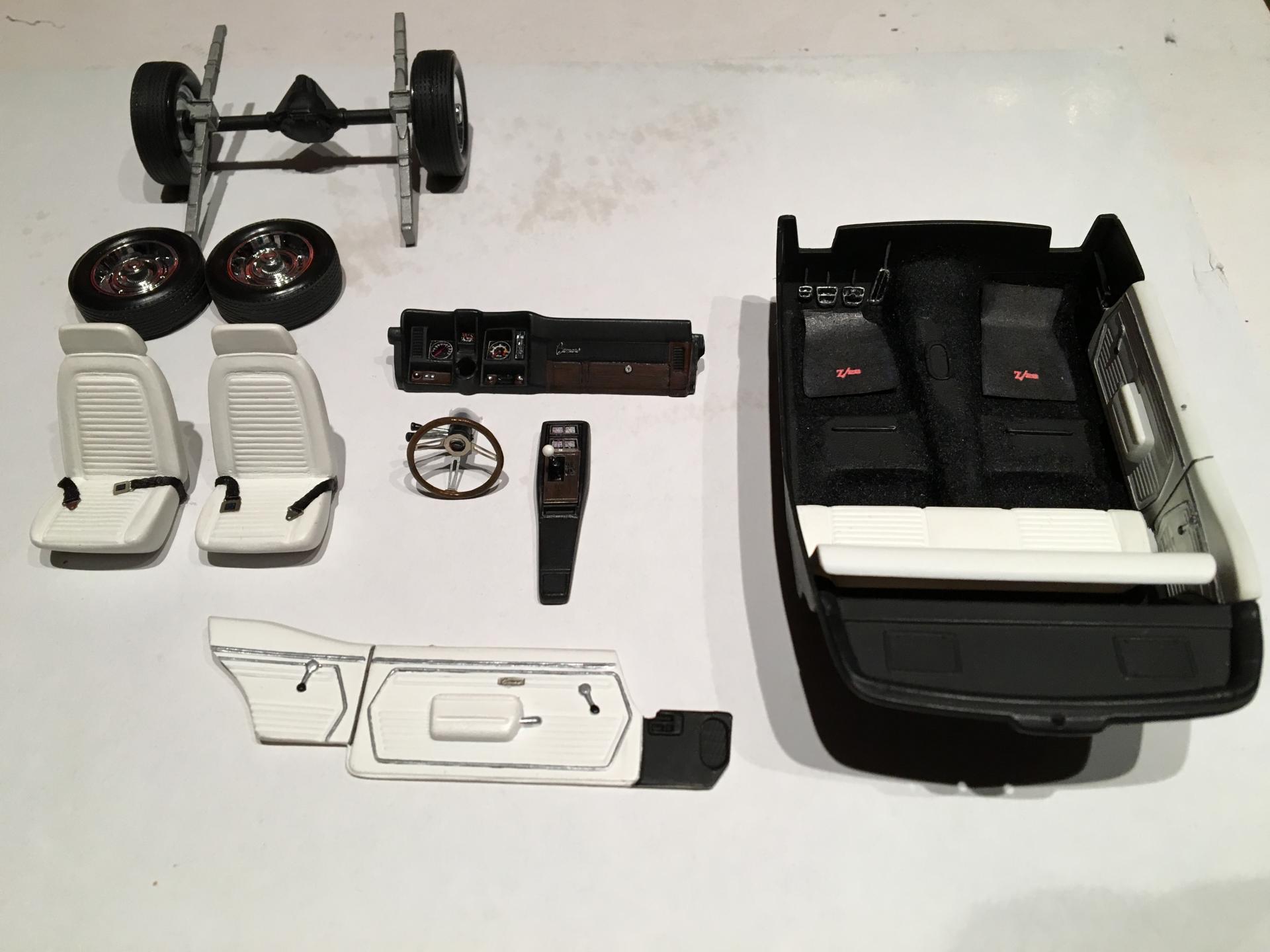

adamelvis Posted April 2, 2017 Author Share Posted April 2, 2017 (edited) Dashboard with photo etched parts from MCG. Interior is done and ready for final installation. TCB, Adam Edited April 2, 2017 by adamelvis added pics Quote Link to comment Share on other sites More sharing options...

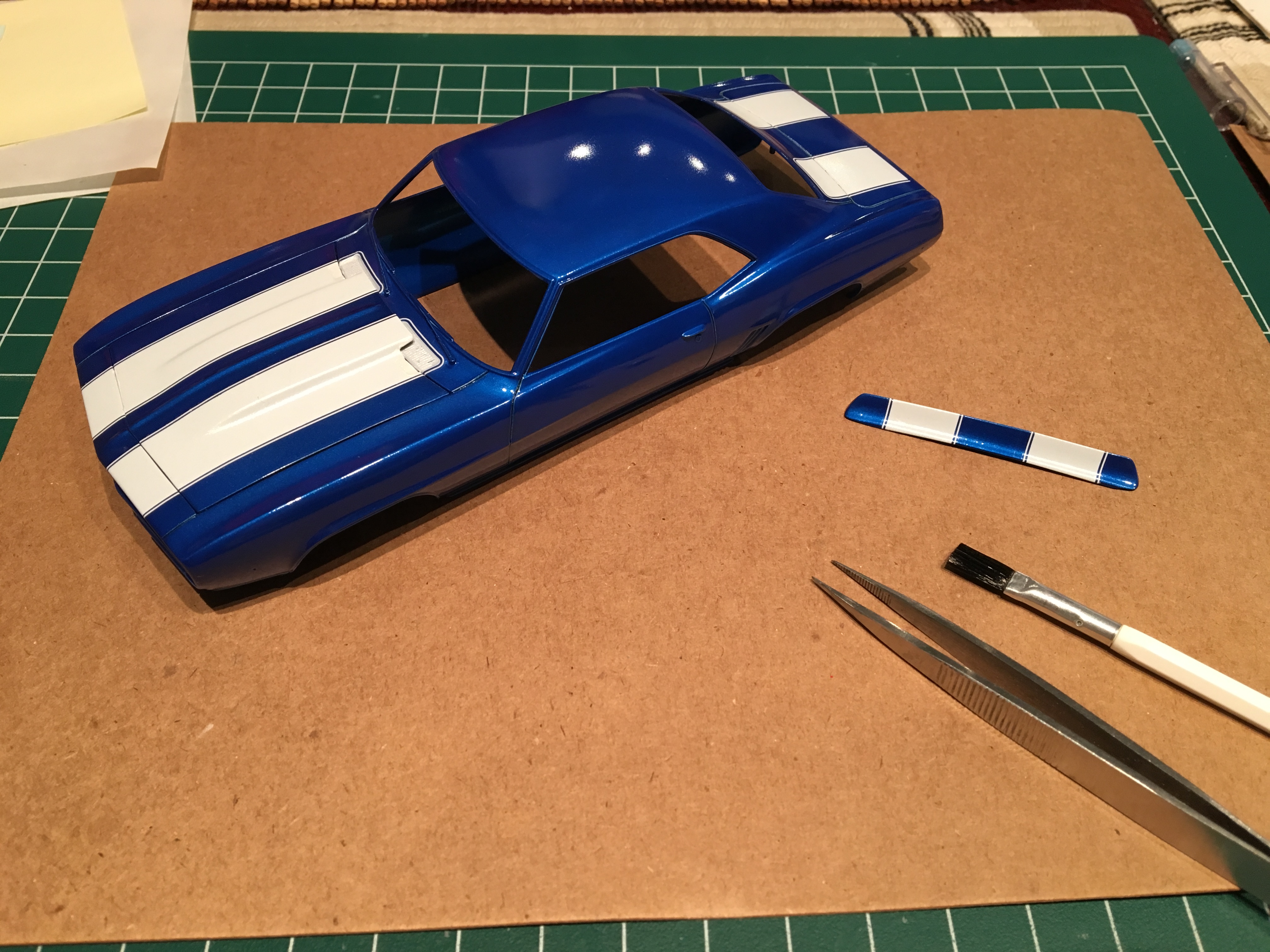

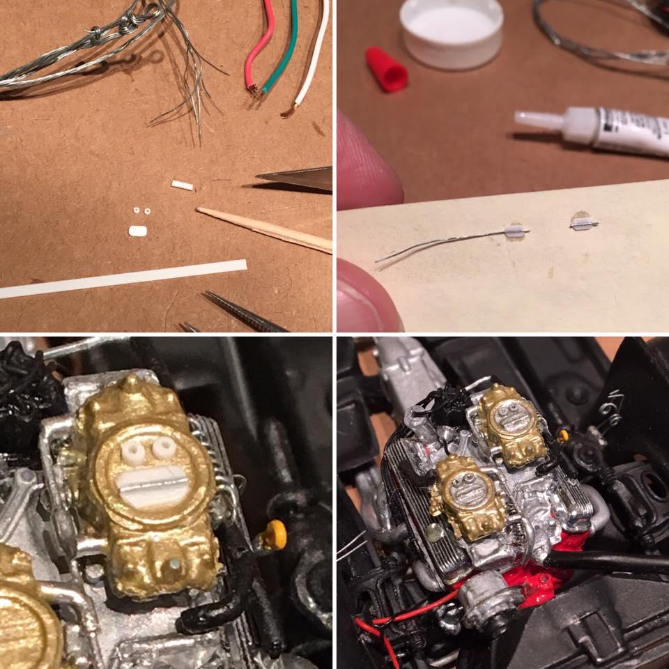

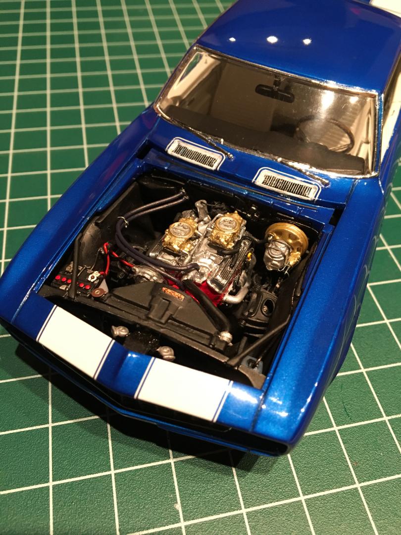

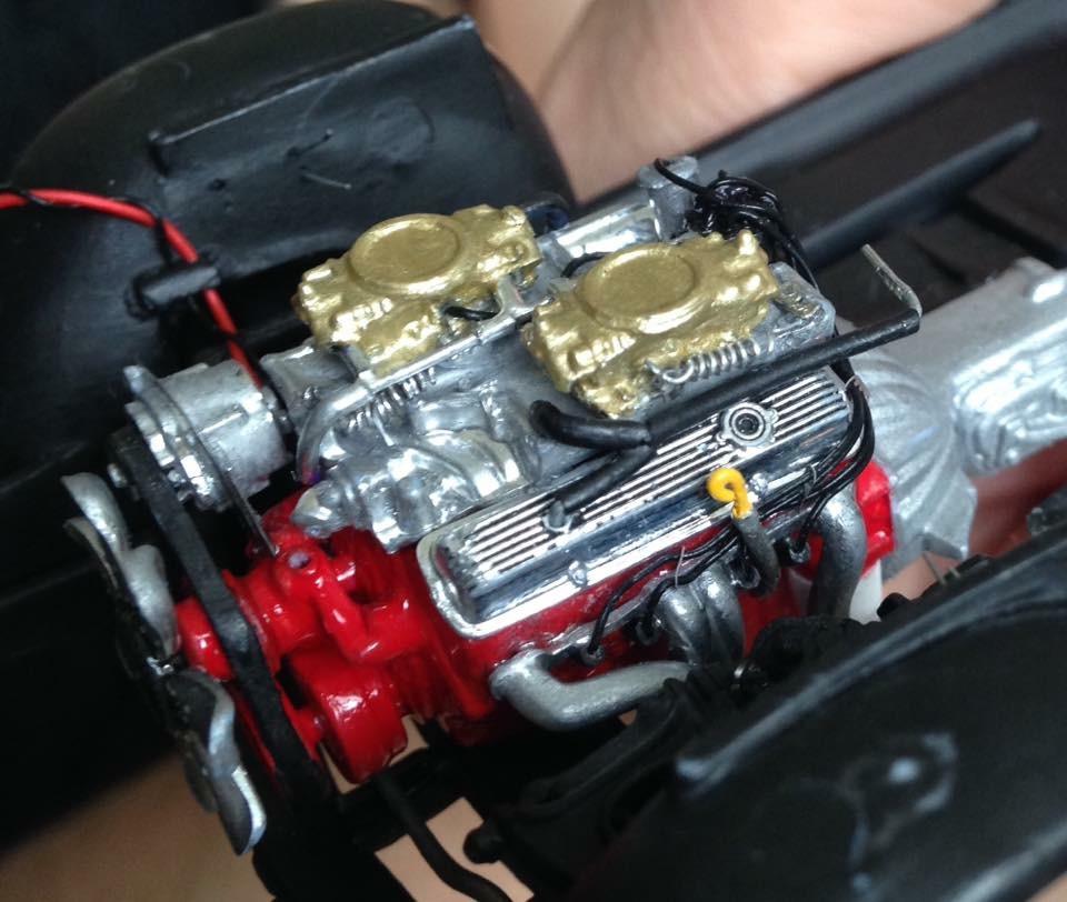

adamelvis Posted April 2, 2017 Author Share Posted April 2, 2017 (edited) My wife choose Tamiya's Mica Blue (TS-50) for the colour and then a couple coats of Tamiya Clear (TS-13) over top the decals. Wanted to give some more details to the stock kit carburators. I used the piping from scrap wire, strip styrene and wire. You can used the sticky side of a Post-It note to tack down your small parts for gluing. Here is my completed engine bay with spark plug wires, heater hoses & clamps, battery cables, brake lines, vaccum hoses, fuel lines and the windshield washer hose ! All that is left to do is add the final photo etched Camaro emblems to the body exterior and finish up with one final polish before it is entered into the Auto Modelrama Contest. TCB, Adam Edited April 2, 2017 by adamelvis Quote Link to comment Share on other sites More sharing options...

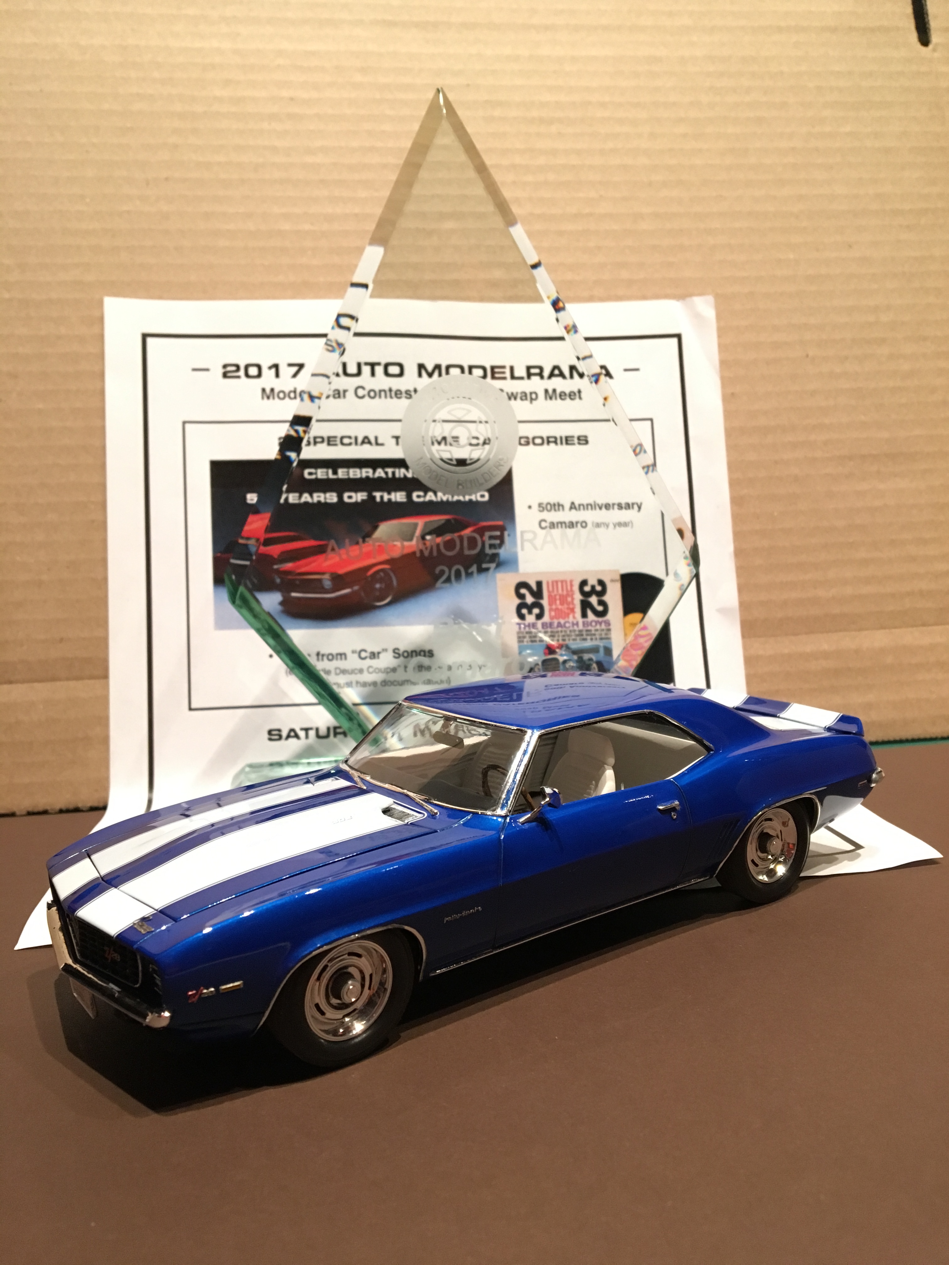

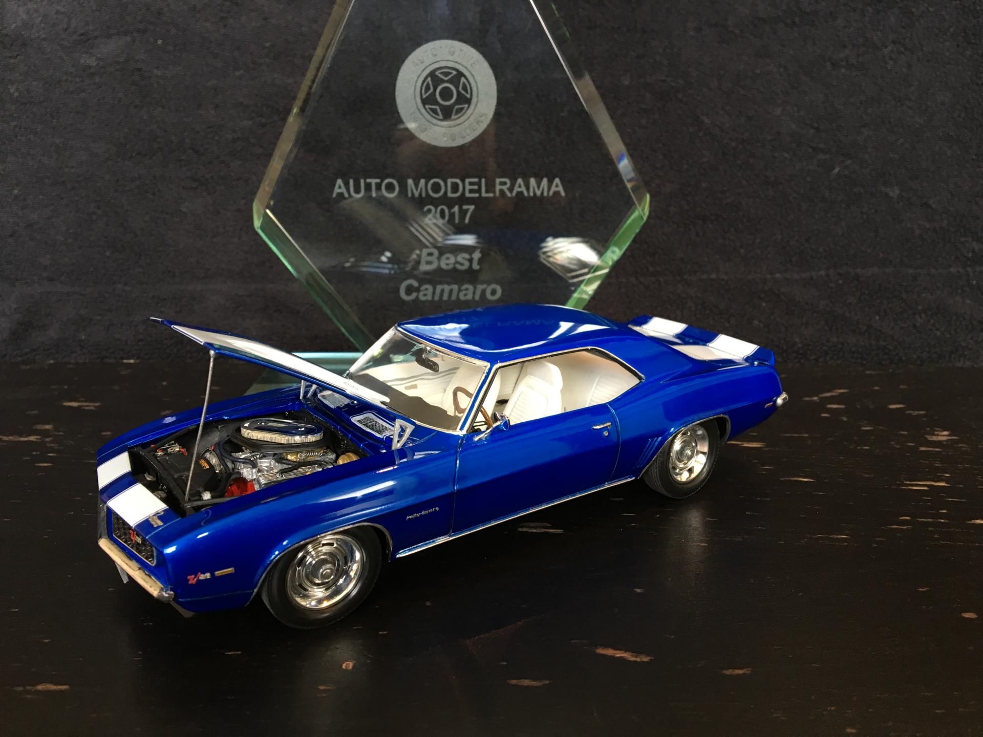

adamelvis Posted April 2, 2017 Author Share Posted April 2, 2017 GREAT NEWS !! I WON !! WOW! After a 18 year hiatus..... my first car built won for Best Camaro !! I will post all the finished photos in UNDER GLASS. TCB, Adam Elvis Quote Link to comment Share on other sites More sharing options...
espo Posted April 3, 2017 Share Posted April 3, 2017 A well deserved award. Beautiful build. Outstanding engine compartment. Quote Link to comment Share on other sites More sharing options...
