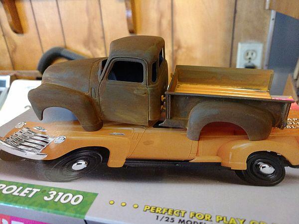

KWT Posted July 3, 2017 Posted July 3, 2017 Make your model windows dirty, grimey, barn findy?.... and make your tires appear flat?Making a rusted relic'd truck, so clean windows and good tires are not really desirable.
