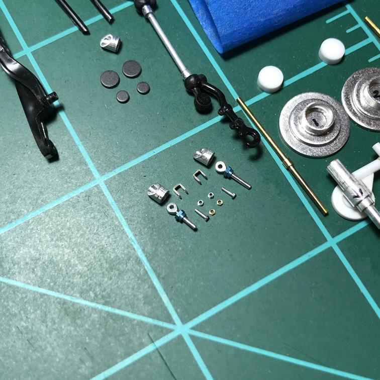

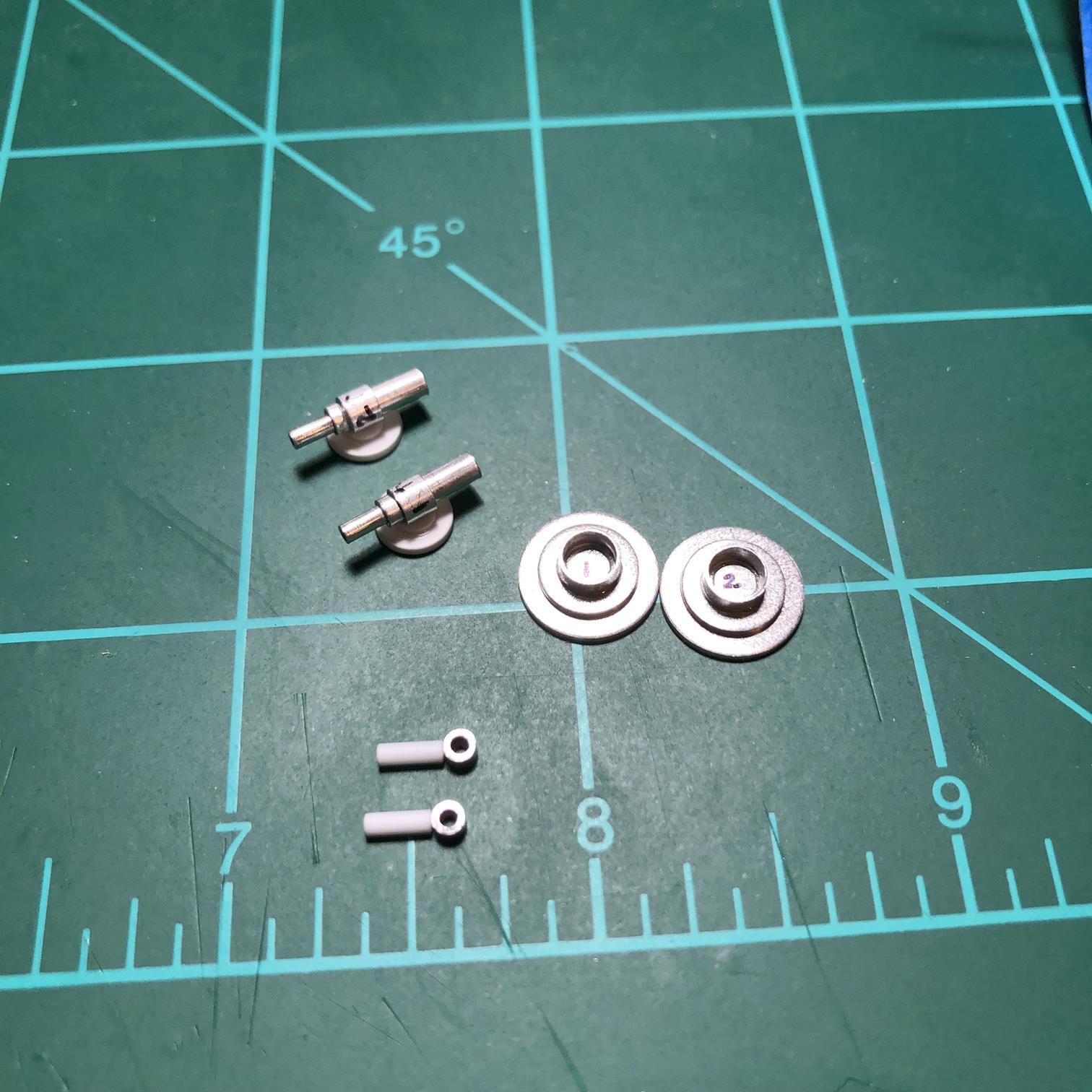

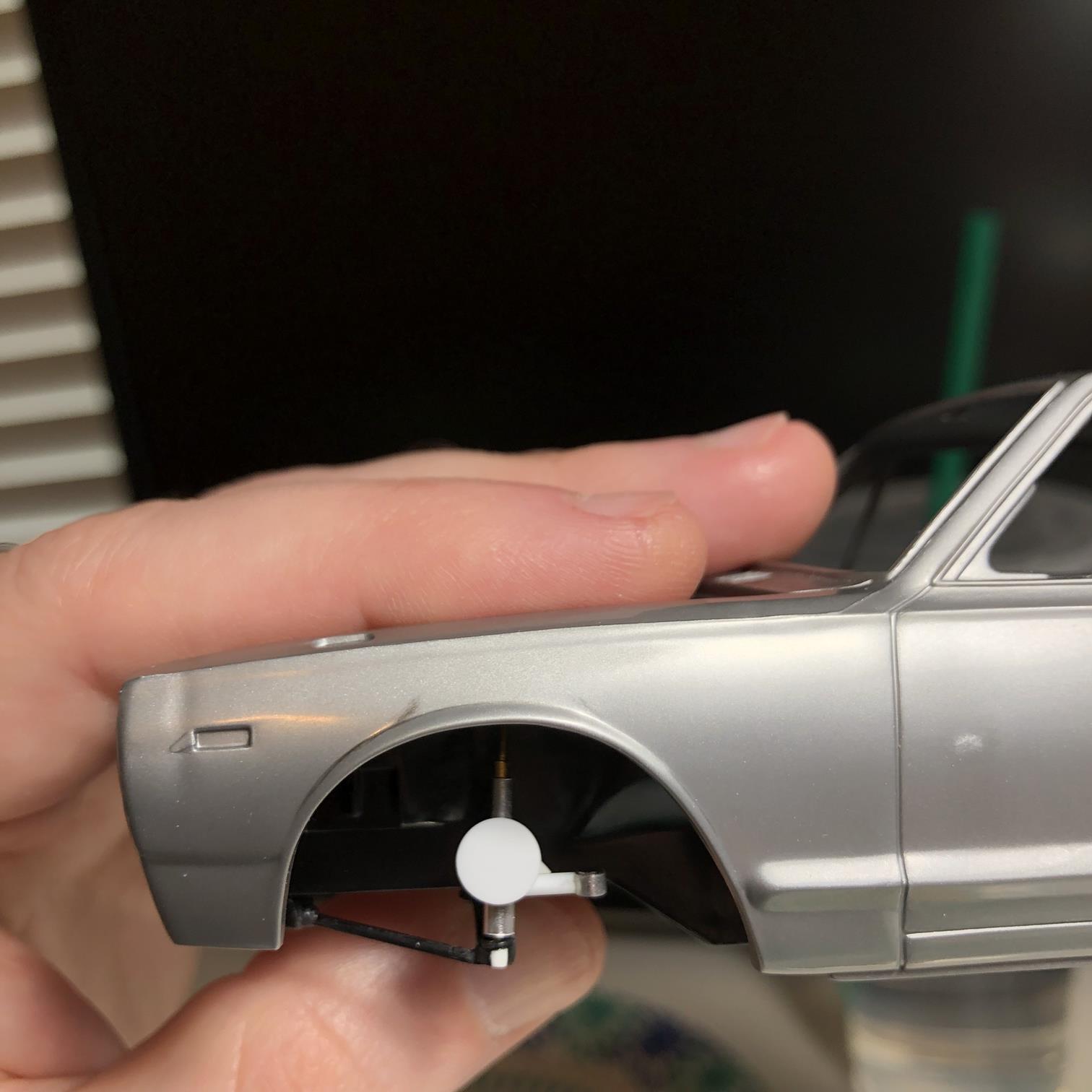

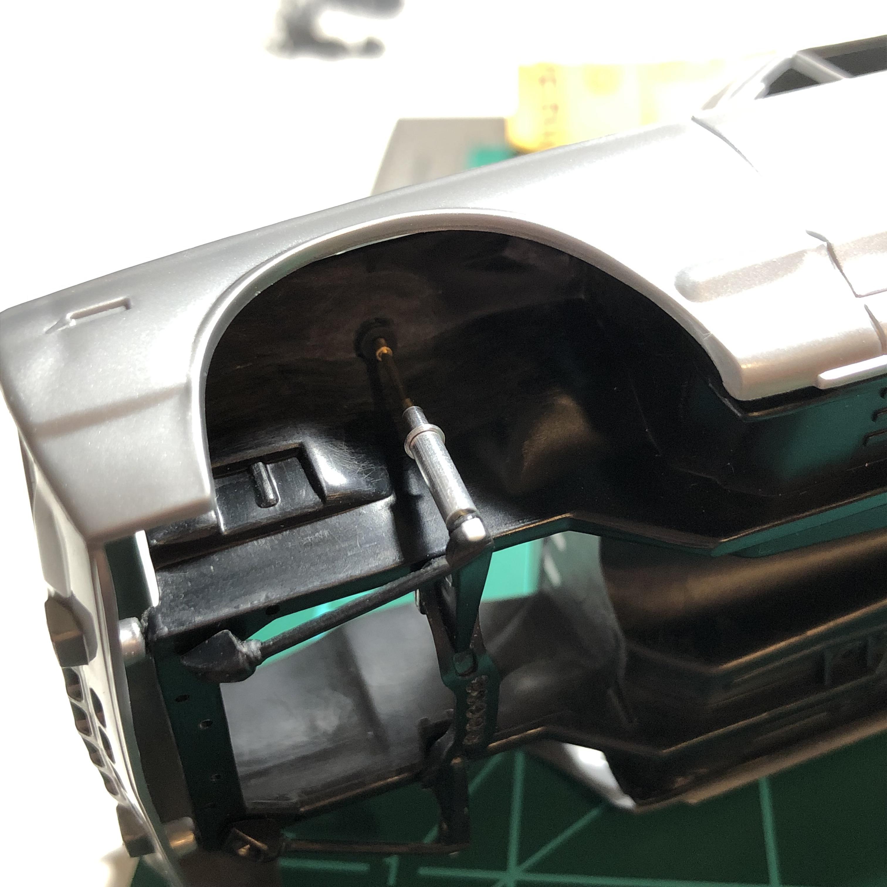

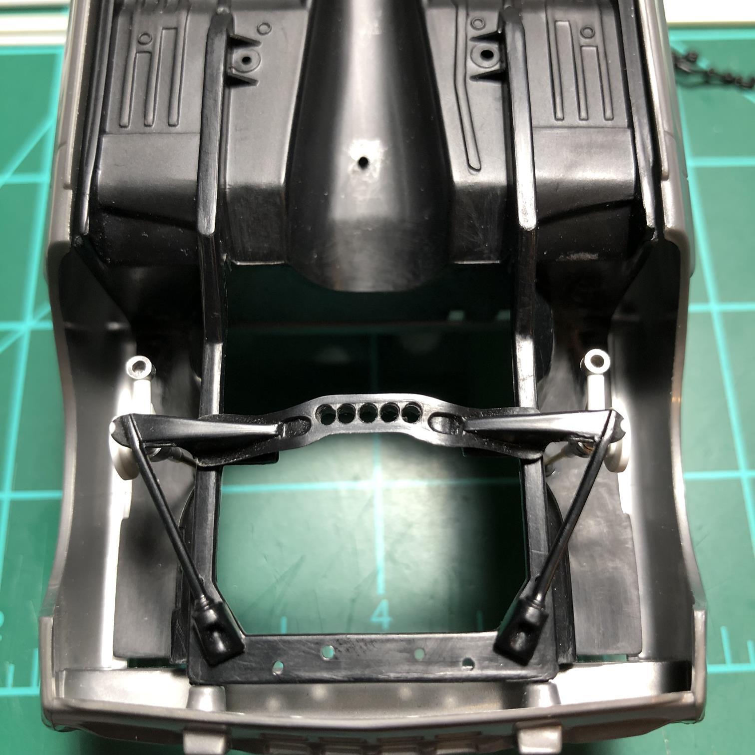

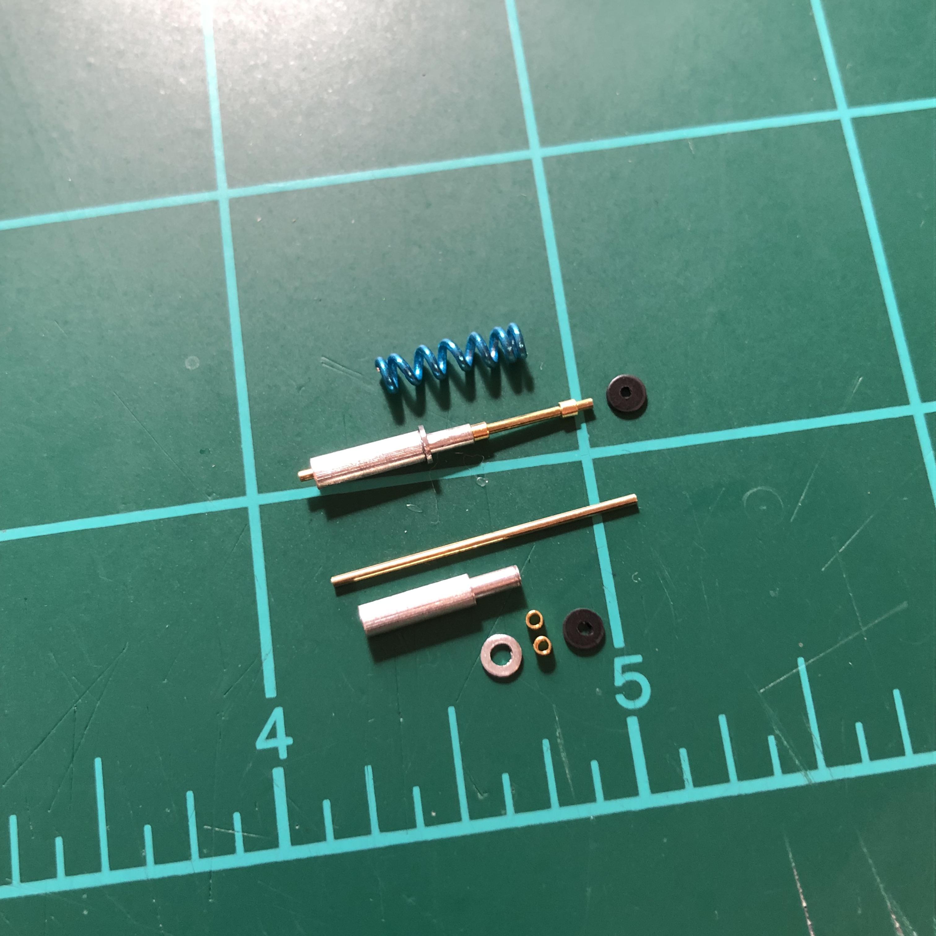

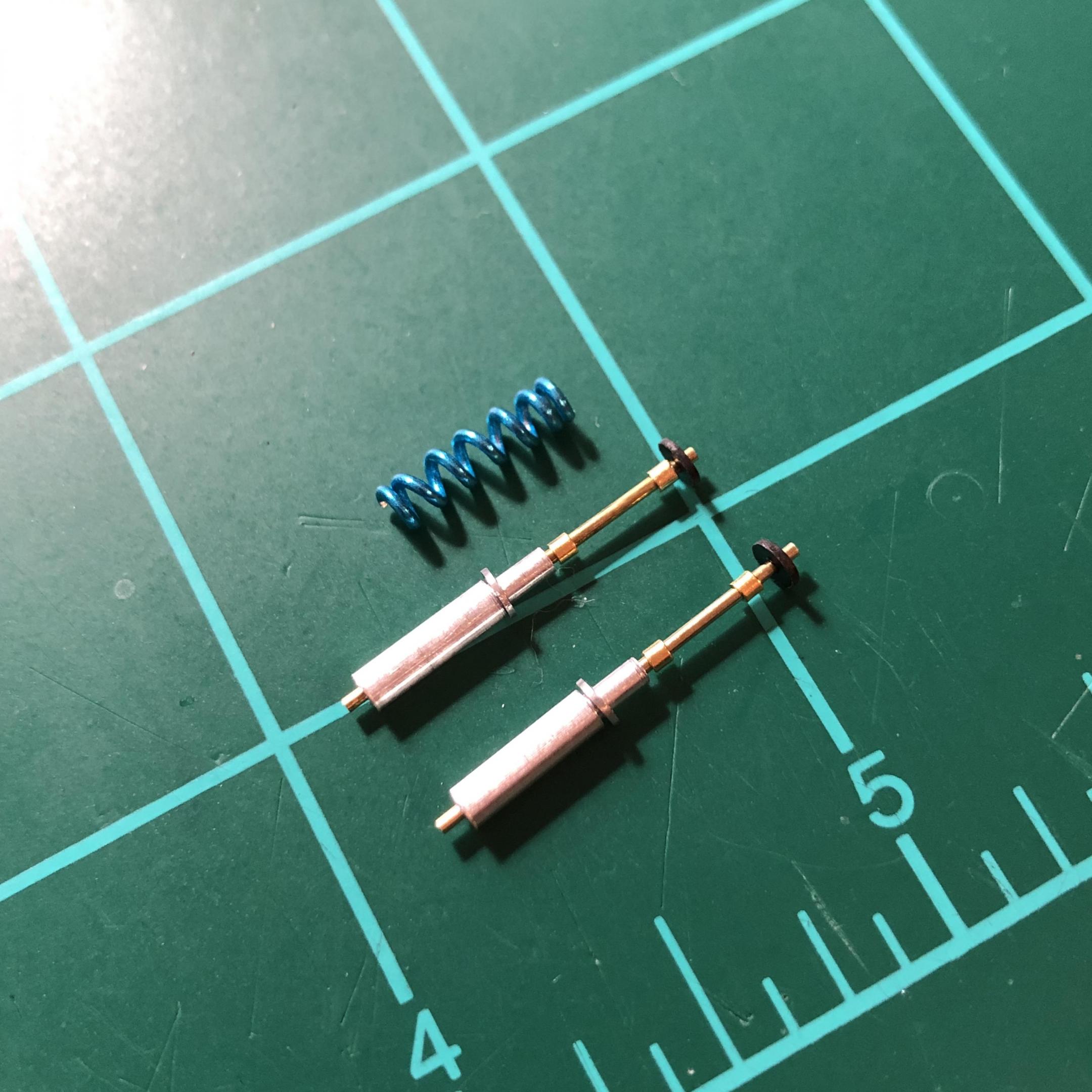

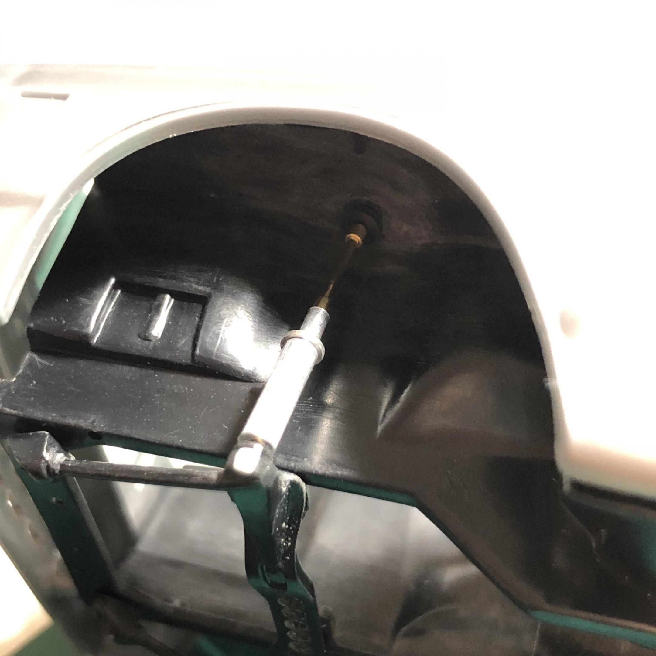

shucky Posted May 13, 2020 Author Posted May 13, 2020 Hello everyone! It is hard to believe that I haven't updated this post in 2 years! As I have many projects going on at the same time, I alternate any time I get burned out from one to another. Anyways, much work has been put in to the Skyline so I thought I should keep this thread alive and update it. While I played around with wheel choices for a very long time (still do), it delayed moving forward with the front suspension until I narrowed down my choices. Basically, I had to move the front shocks inward about 4-5mm on the top and about 2-3mm on the lower in order for me to get the look I wanted. Typically those that lower this kit considerably have massive camber issues because they do not alter the shock mounting points and suspension geometry. I wanted a low down look with mild camber while keeping it realistic. I also still wanted to keep the ability to turn the wheels left or right. So lots of scratch building was in store ... These are the final version of the shocks and springs with mounting points moved inwards ...

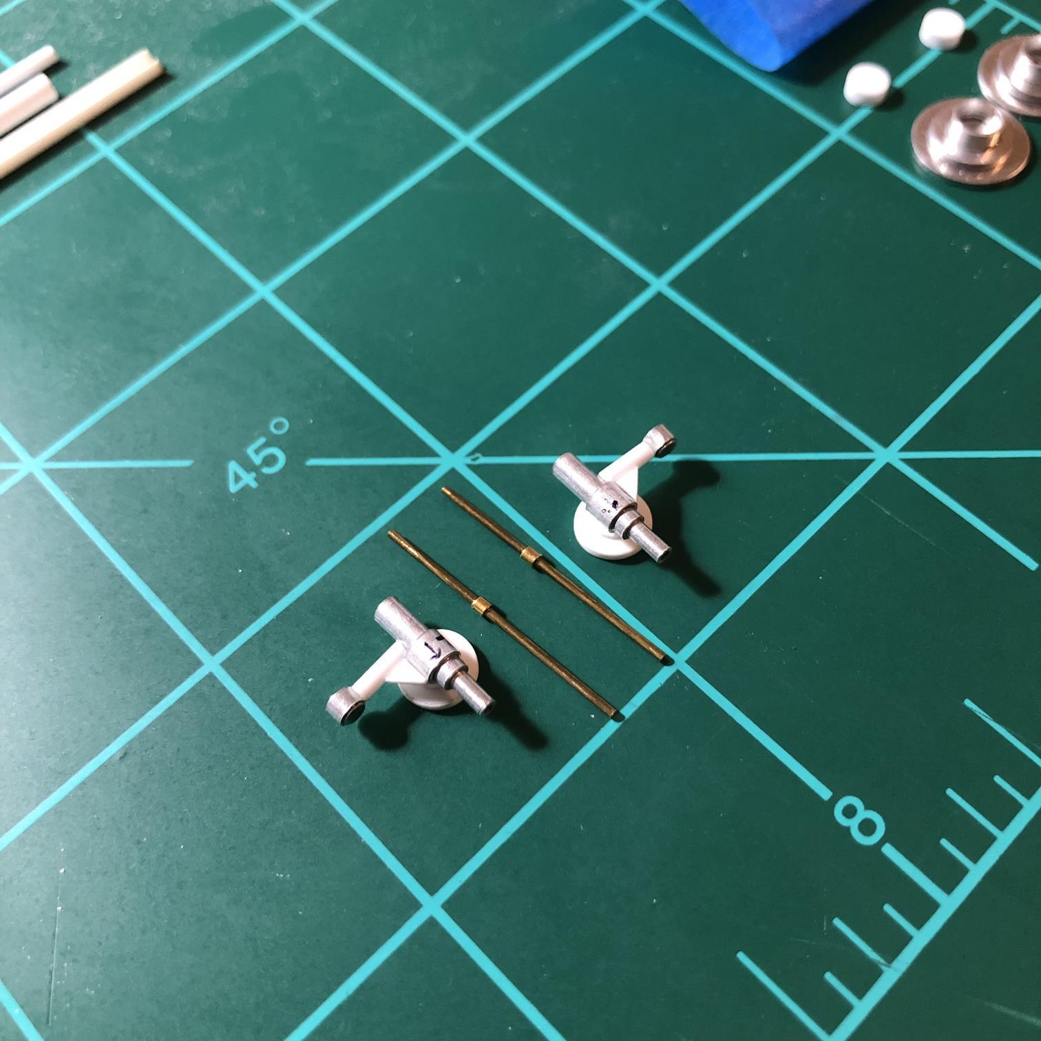

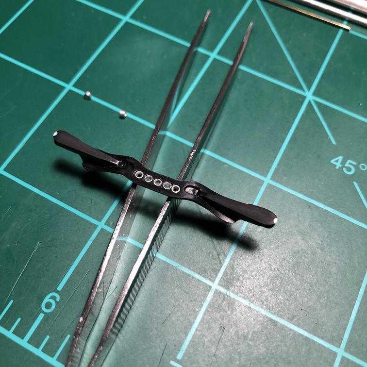

shucky Posted May 13, 2020 Author Posted May 13, 2020 Since I did this with the suspension, I had to make the spindles and brakes also. Had to narrow the steering arm as well.

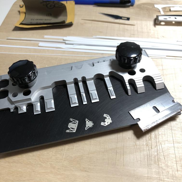

shucky Posted May 13, 2020 Author Posted May 13, 2020 Next up where the kit torsion bars that had to be removed and remade. All of this is ready for primer, assembly, etc but on hold until i get the chassis in primer and paint.

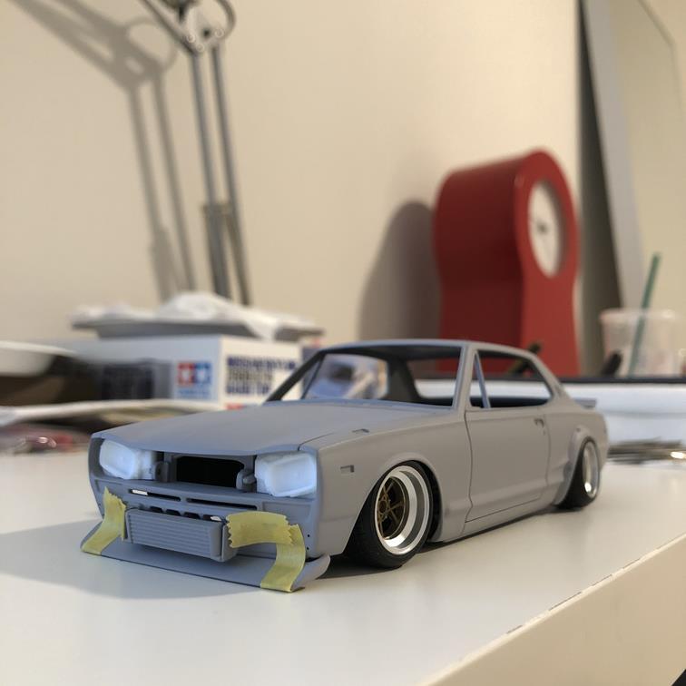

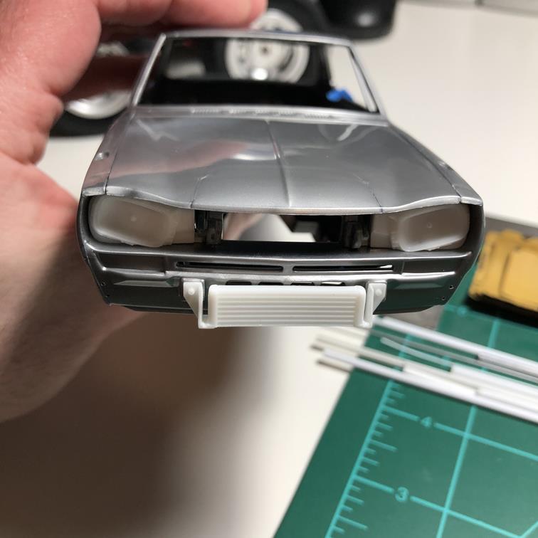

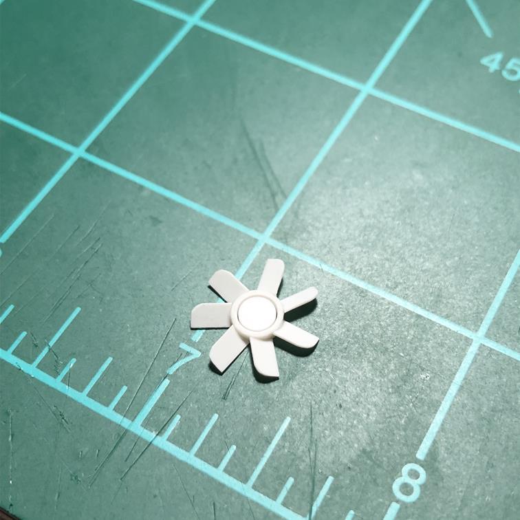

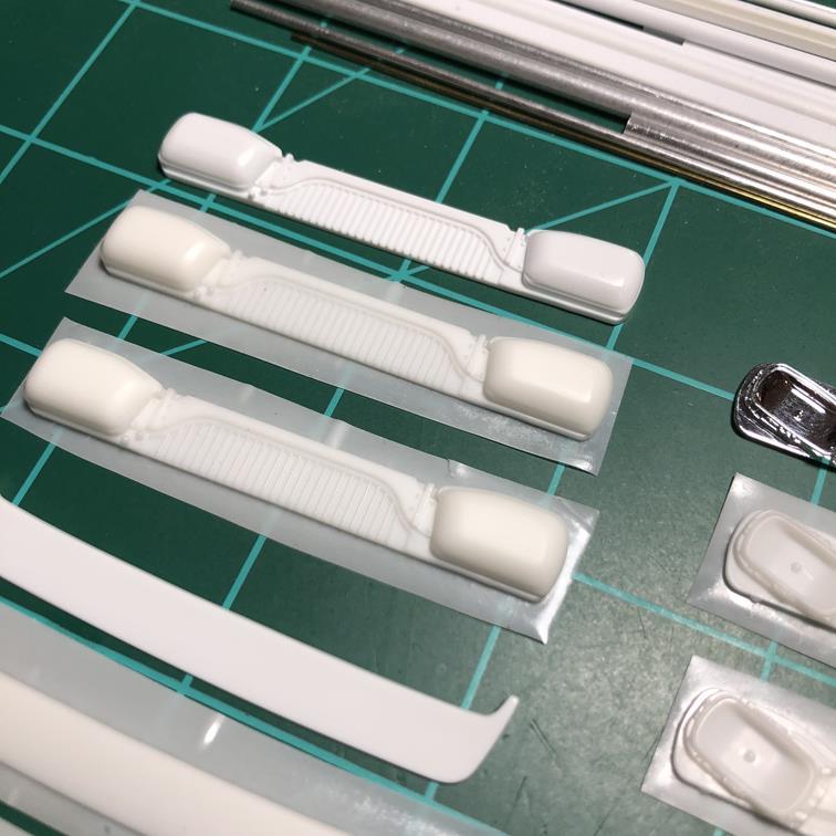

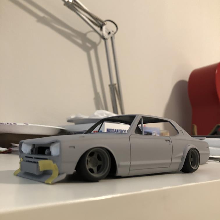

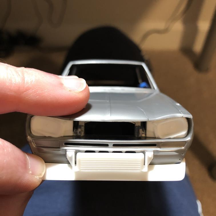

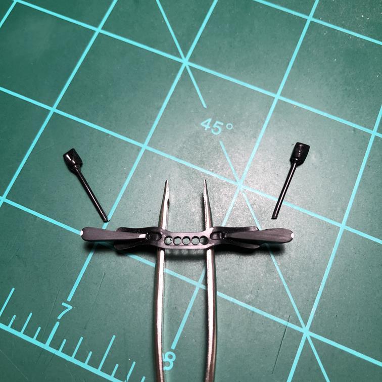

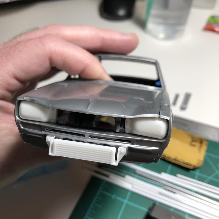

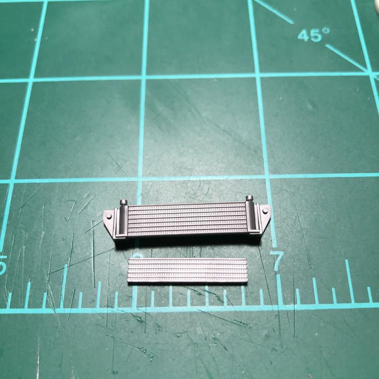

shucky Posted May 13, 2020 Author Posted May 13, 2020 I also wanted to customize the Skyline a bit, and seeing as how I just picked up the Aoshima "Charasuka Works" kit, I thought I'd make some resin copies of the slanted single headlights, headlight covers, and front lip and then fit them to the Tamiya kit. I also really liked the oil cooler from the Tamiya kit and wanted to make copies of that too. Lastly, I made a new fan for the S20 since I do agree the kit piece is too chunky!
shucky Posted May 13, 2020 Author Posted May 13, 2020 Some test fitting after reshapping the resin pieces.

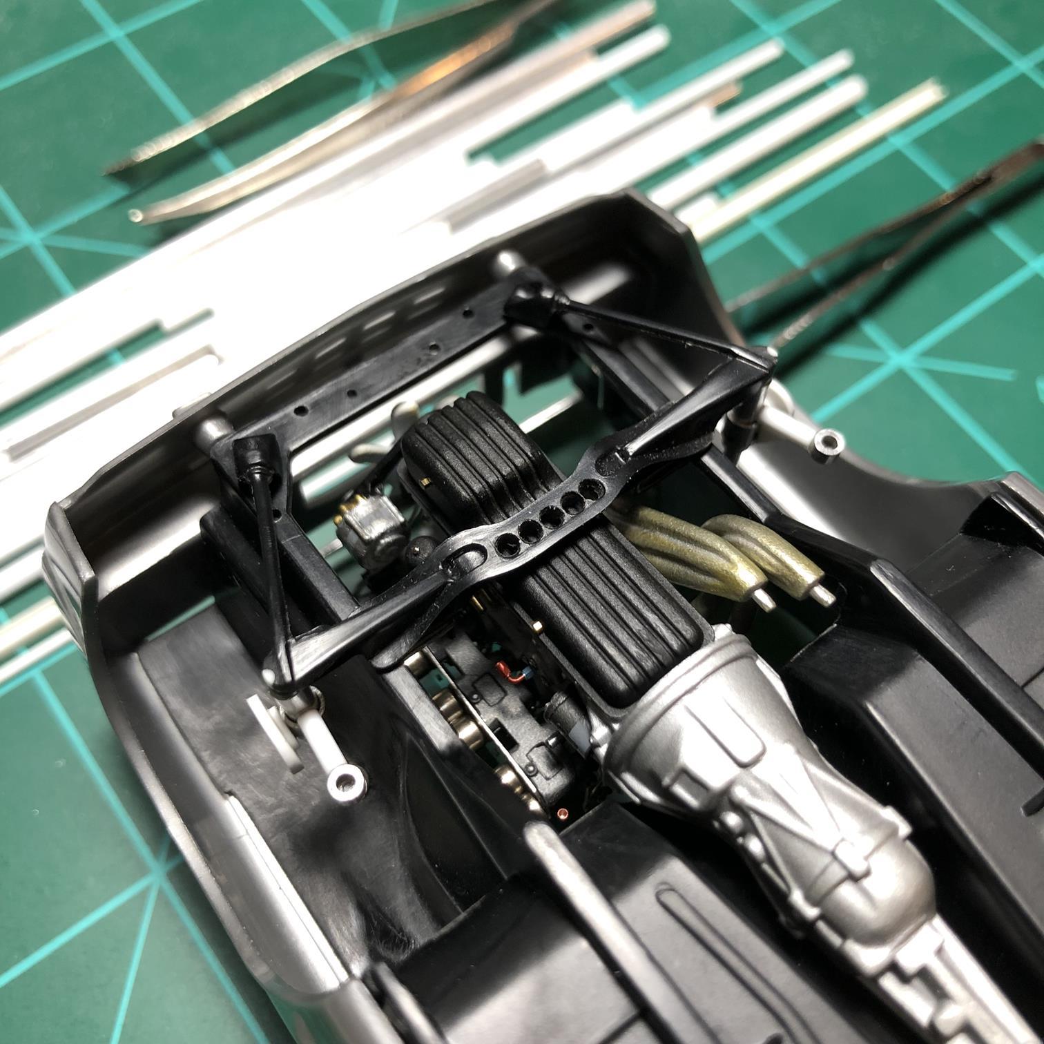

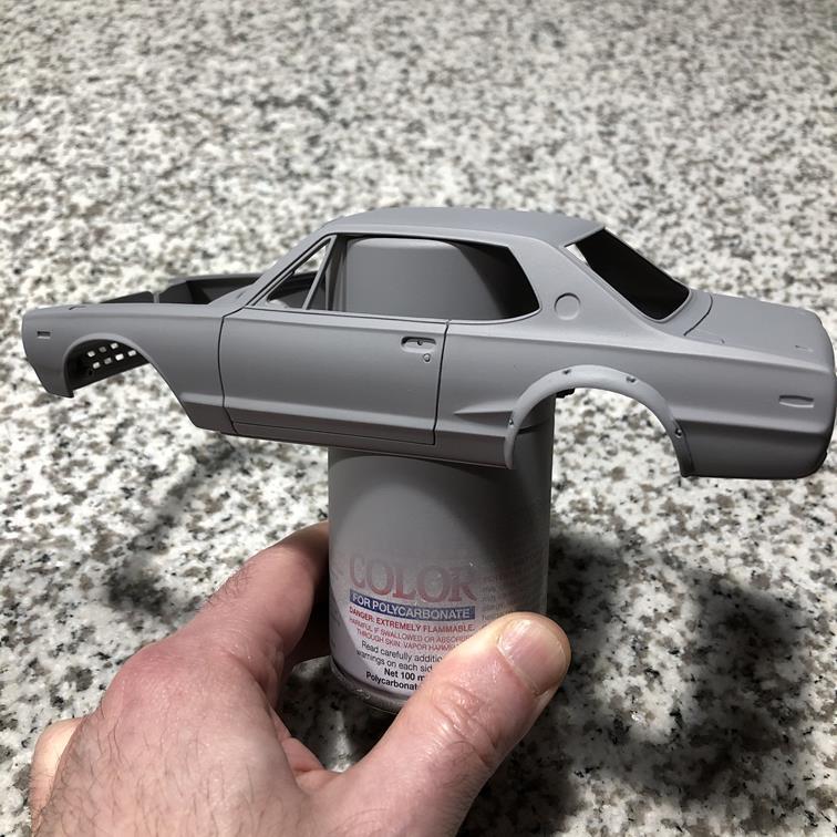

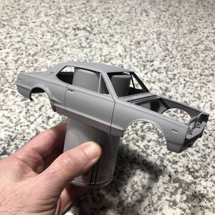

shucky Posted May 13, 2020 Author Posted May 13, 2020 Never thought I'd be this excited for primer! Its been a long time coming! lol
Italianhorses Posted May 13, 2020 Posted May 13, 2020 Very nice detail work on the engine. I know you can't really see it, but I would drill inside the velocity stacks. Following this for sure!
Erik Smith Posted May 14, 2020 Posted May 14, 2020 I’m glad to see this one is still alive! The new fan is awesome. Well, it all is.

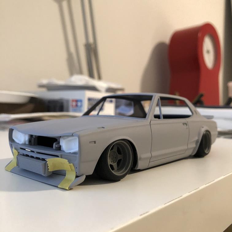

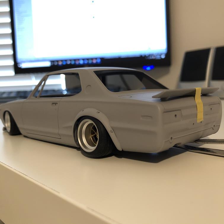

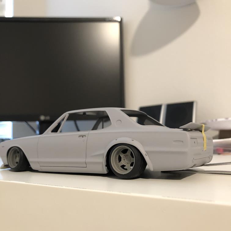

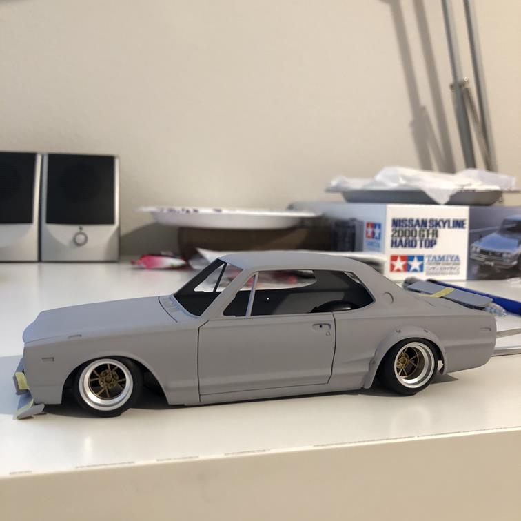

shucky Posted May 14, 2020 Author Posted May 14, 2020 (edited) Hello again, here are some mock up's with my favorite wheels choices (still subject to change - lol). The "Bilbo's" are resin cast in color and the Work Meister CR01 are from DiOlex Production. Edited May 14, 2020 by shucky

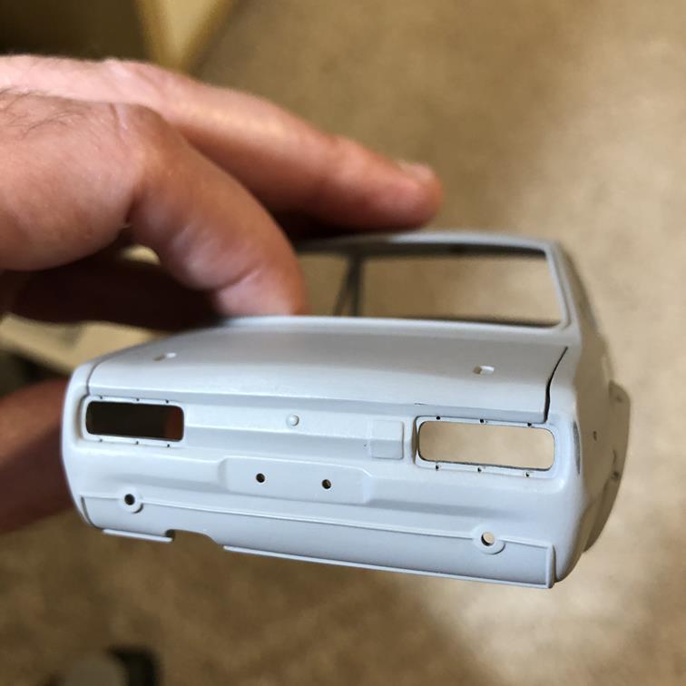

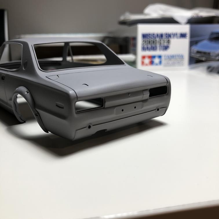

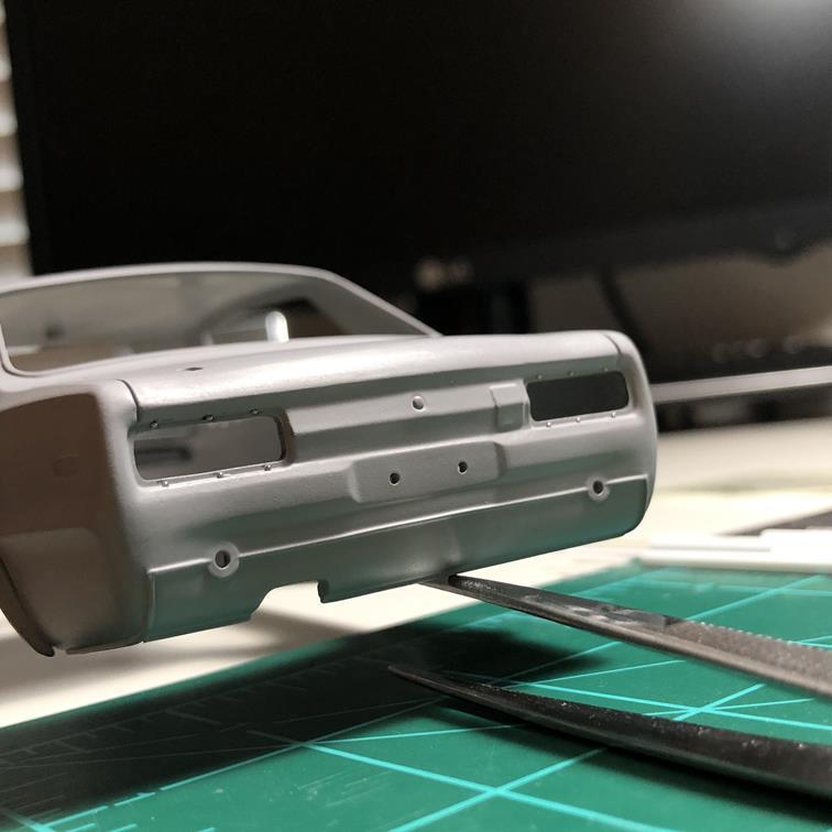

shucky Posted May 14, 2020 Author Posted May 14, 2020 I also really like the look of the large single tail lights on more modified Hako's ... so out came the files again ... Also test fit the rivets
shucky Posted May 14, 2020 Author Posted May 14, 2020 Also, after shaping the Charasuka Works lights and covers to fit the Tamiya kit, I re-cast them in Smooth On Onyx black resin to avoid painting.
fumi Posted May 15, 2020 Posted May 15, 2020 19 hours ago, shucky said: I also really like the look of the large single tail lights on more modified Hako's ... so out came the files again ... One popular mod was to use the one piece 1968-69 tail lights in place of the dual tail lights of the post 1970 Skyline. http://showa.blog.shinobi.jp/車両メンテナンス 大将商会/ハコスカ 前期45テールに変更!

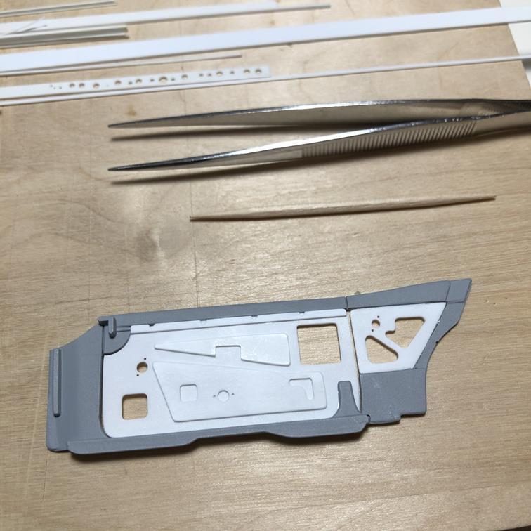

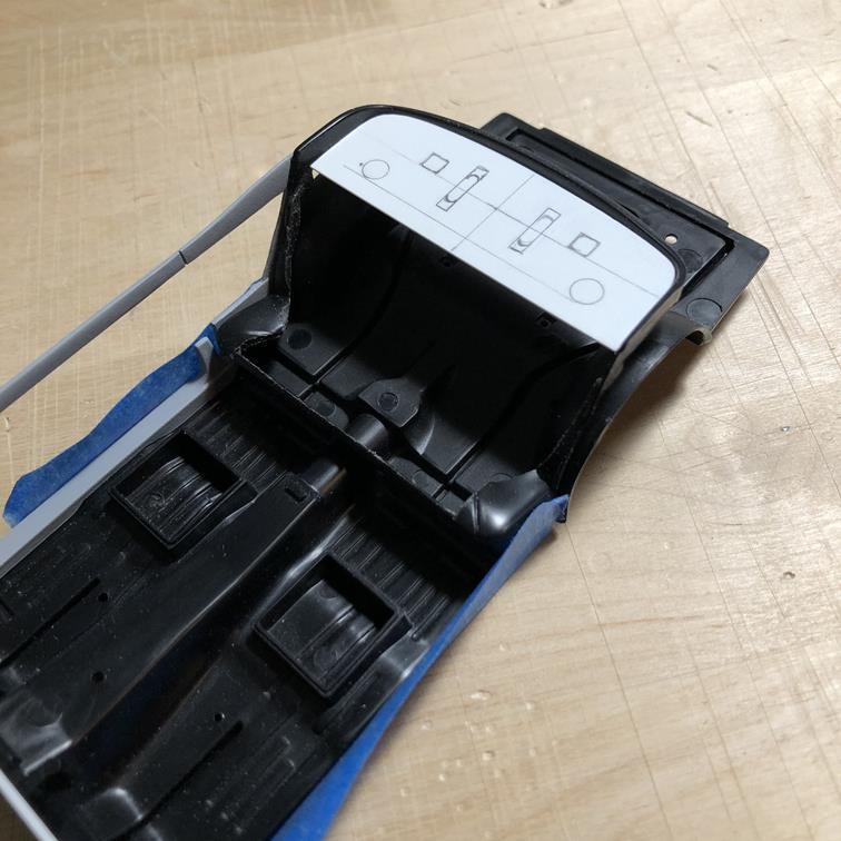

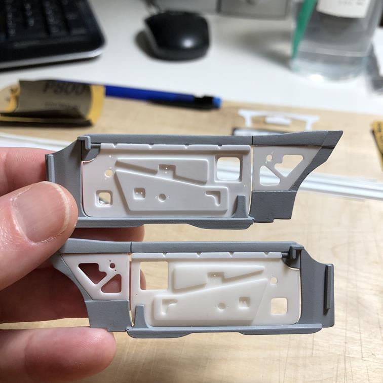

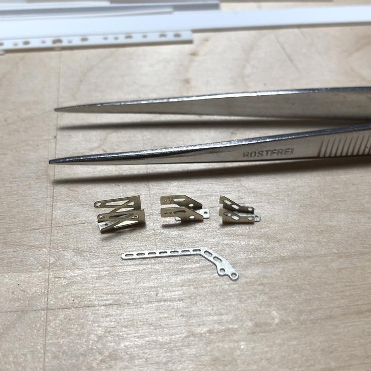

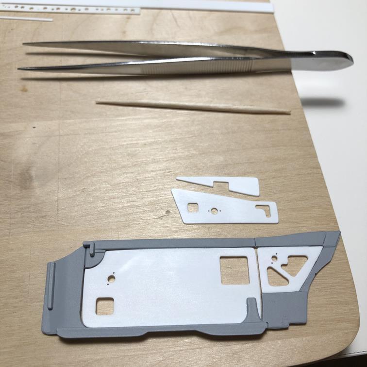

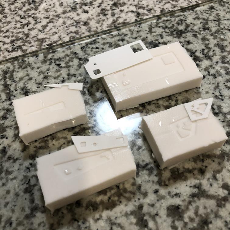

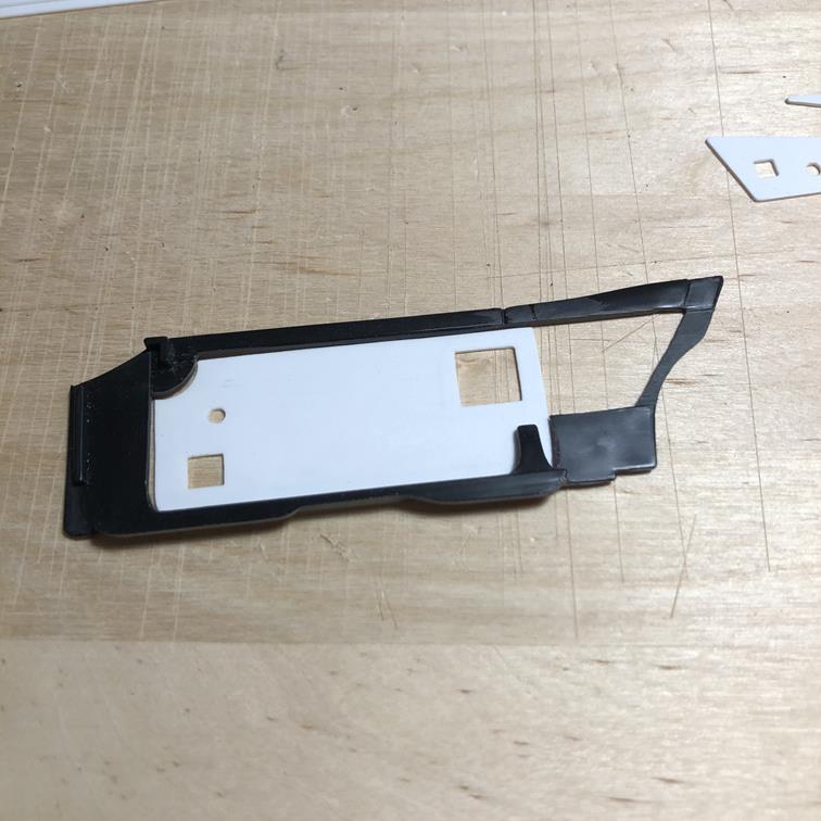

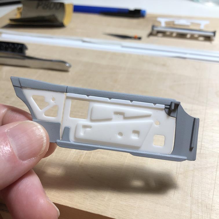

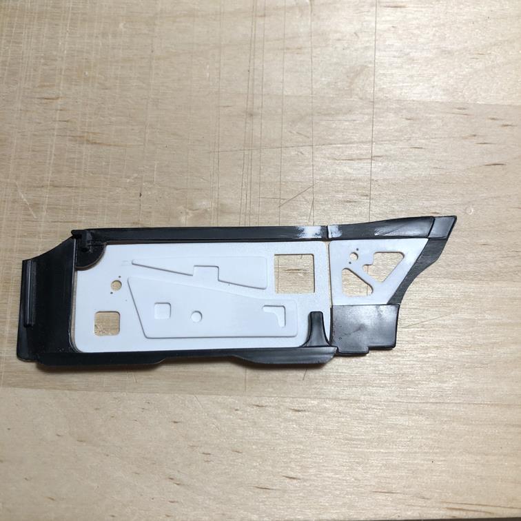

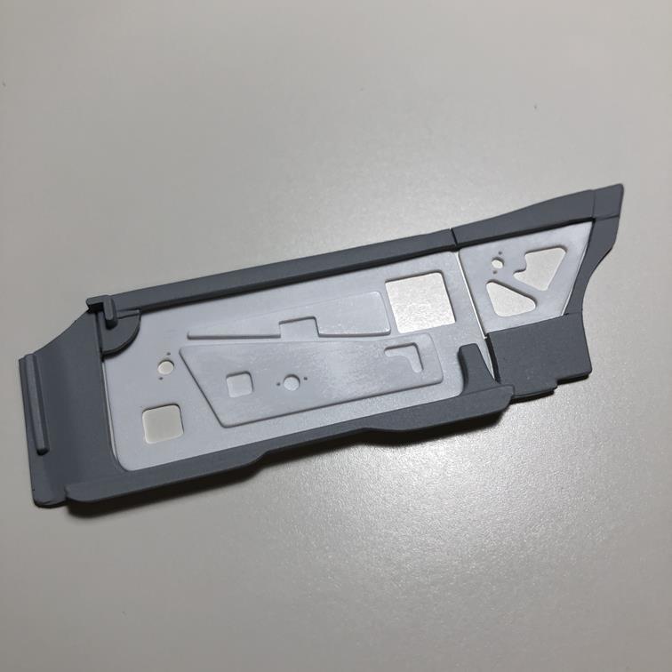

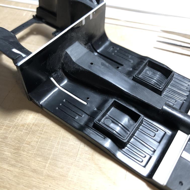

shucky Posted May 15, 2020 Author Posted May 15, 2020 So, while I decide on a color for this build, I shift the focus to the interior. I wanted something more purpose built with some look of a stripped out interior. Since I have a spare Tamiya kit in case I dont like the result, I decided to tackle making it appear as if the interior panels have been removed. First step was removing the kit door panel and trim piece details. I made a template on styrene of the basic shapes I wanted based on some photos I found online. After carefully fitting, I test fit into the body and realized the door panel seem does not align with the door opening on the body. Its about 3-4mm off. This is an older Tamiya kit so I give them a pass on this one lol. I had to rescribe the panel line on the interior side to align with that of the body. Got the door frame in primer and test fit again.

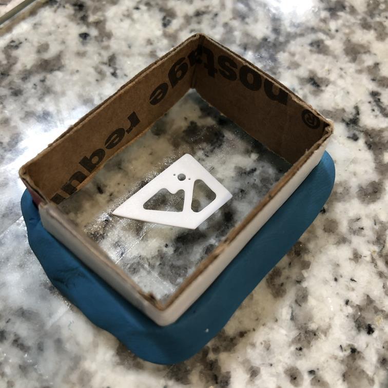

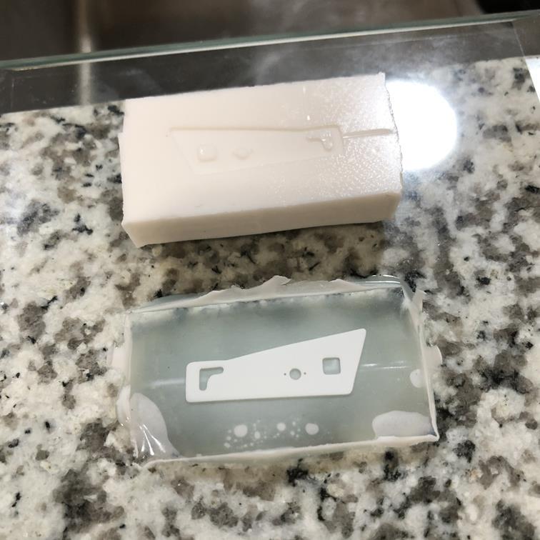

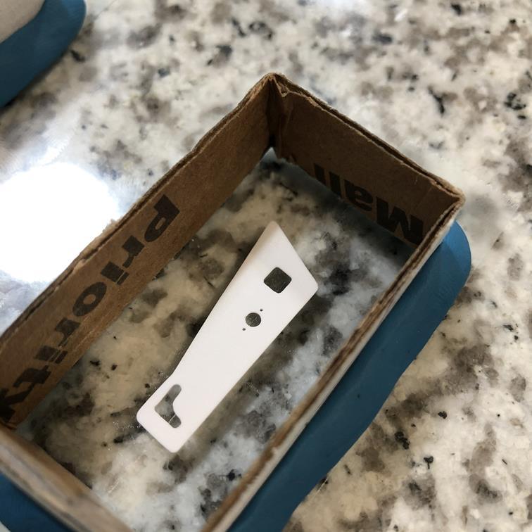

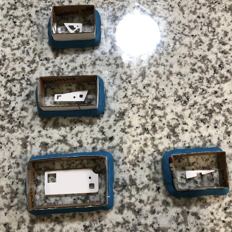

shucky Posted May 15, 2020 Author Posted May 15, 2020 So far I like the result. I do not want to make all the same pieces for the left side by hand, so I cleaned up all of the styrene pieces and put them in rubber for resin casting. These will likely be the thinnest and most delicate resin pieces I've made so far. Should be able to pour resin this evening or tomorrow morning. Should the resin be a success, I can then proceed to trim the other side door panel to fit the pieces and begin working on removing the rear seat cushions.
Italianhorses Posted May 15, 2020 Posted May 15, 2020 Looks good. What do you use to make the molds? What brand resin?
shucky Posted July 13, 2020 Author Posted July 13, 2020 Hello Alex, the rubber is Smooth On Mold Max 14NV and I use Alumilite White resin.
shucky Posted July 13, 2020 Author Posted July 13, 2020 Resin copies were a success. Time to assemble.

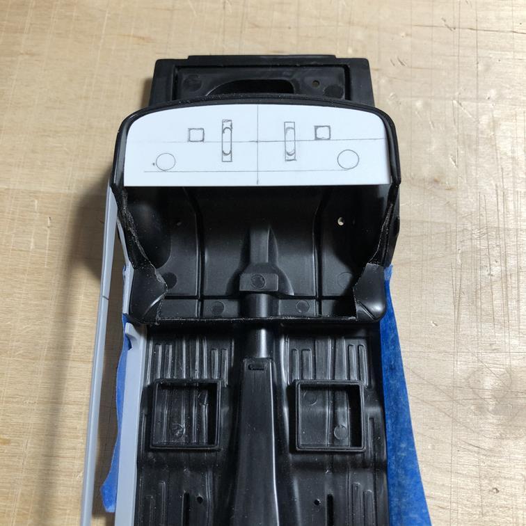

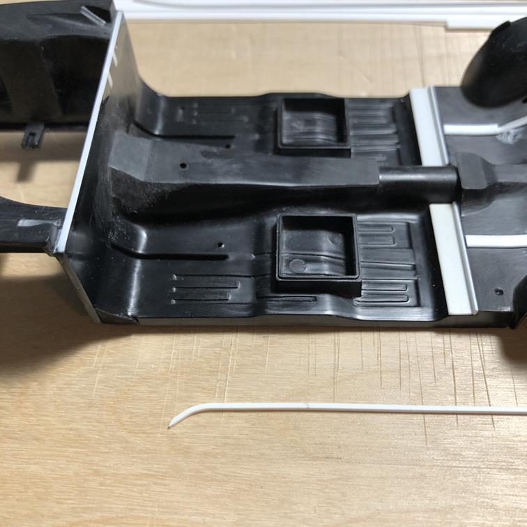

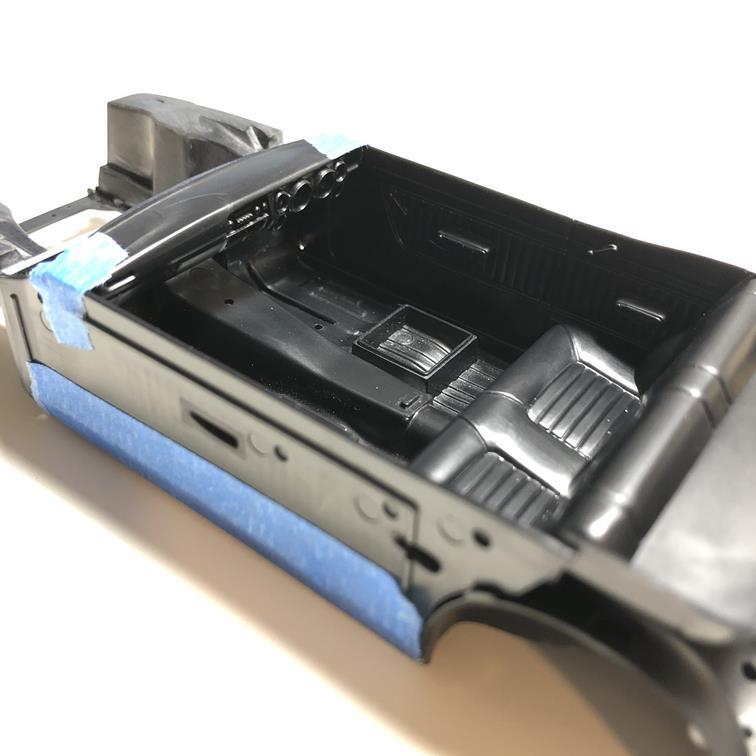

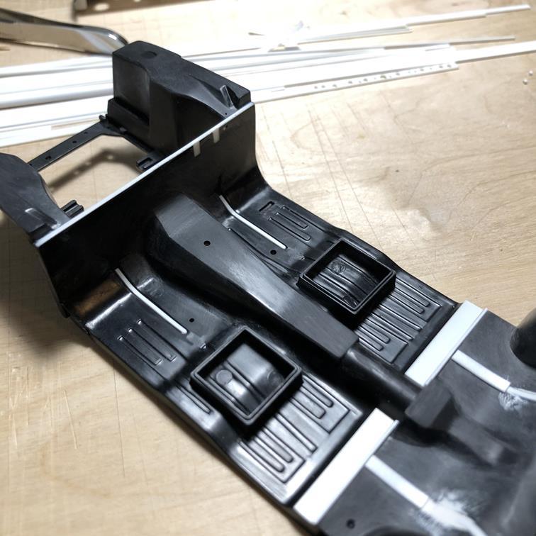

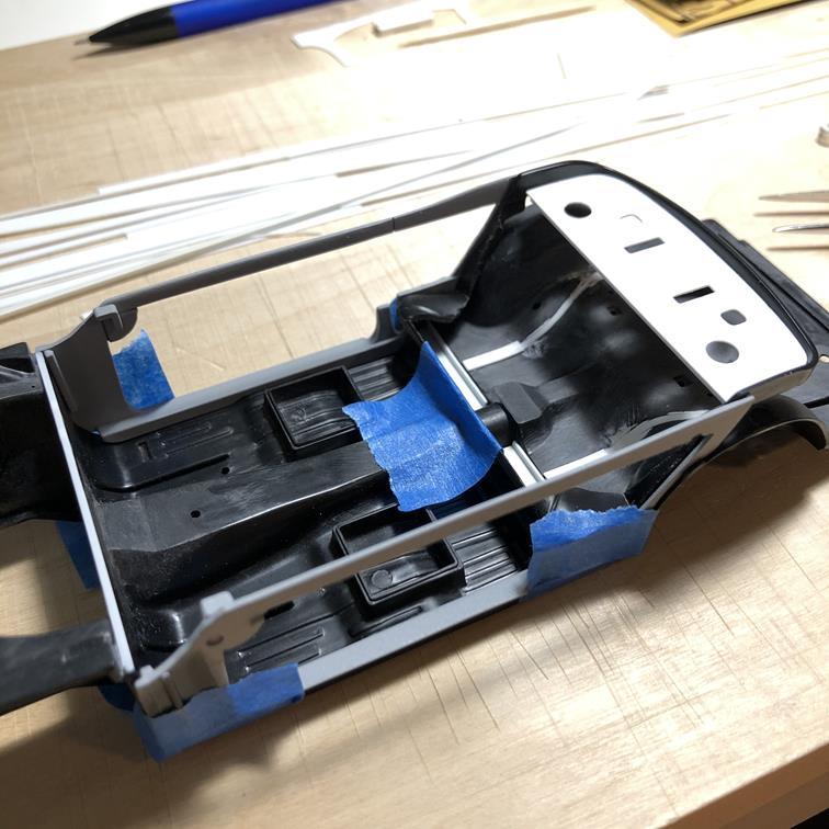

shucky Posted July 13, 2020 Author Posted July 13, 2020 So I moved on to the rear deck. Using some reference photos, I created a new styrene piece for the rear deck. Also, since the back seat will be removed I need to create the framing and structural pieces found from reference photos. The gas tank will be visible through this area as well, so lots of work to do. To ensure the rear deck stays in exactly the same position as intended I left it attached to the rear seat structure until I made mounting tabs for it. The rear seat will entirely be removed at the last moment after ensuring the deck is properly aligned.
shucky Posted July 13, 2020 Author Posted July 13, 2020 These areas were too deep so I filled with styrene shaped to fit.

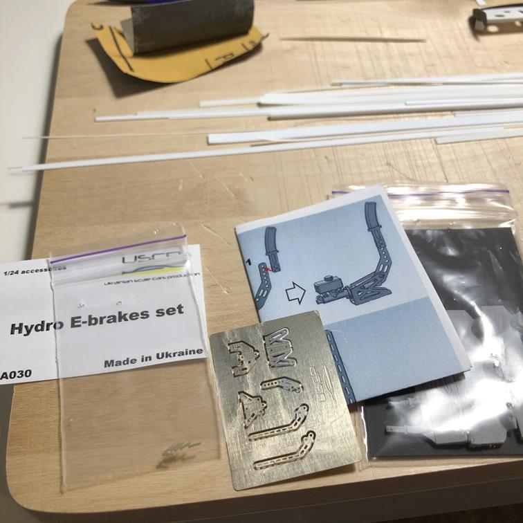

shucky Posted July 13, 2020 Author Posted July 13, 2020 Mock up of USCP "hydro brake" to be installed later
shucky Posted July 13, 2020 Author Posted July 13, 2020 Starting to assemble the inner door panels/structure. Almost ready for more primer and lots more details to add.
shucky Posted July 13, 2020 Author Posted July 13, 2020 Both sides of door structures coming together. One styrene, the other is resin copies.
