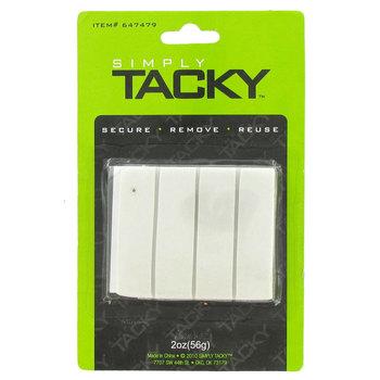

Here's one way I avoid that (sometimes):  get some "Simply Tacky" or "Blu-Tack" adhesive putty, sold at Hobby Lobby, Michaels, etc.  (Pic below.) I put a dab of that stuff on a toothpick or an old Micro-Brush with the tip stripped off, and use that to pick up the photo-etch and position it on the model.
To keep the photo-etch piece from flying when I cut it off the sprue, sometimes I stick it to a piece of double-sided tape. That has another benefit, it leaves a little adhesive from the tape on the back of the photo-etched part.  I used that method on one of my worst photo-etch challenges: the 1/35 scale Hobby Boss EBR-10 French armored car.  That thing had 44 tiny photo-etched rivets, 22 each for the front and rear hulls.
