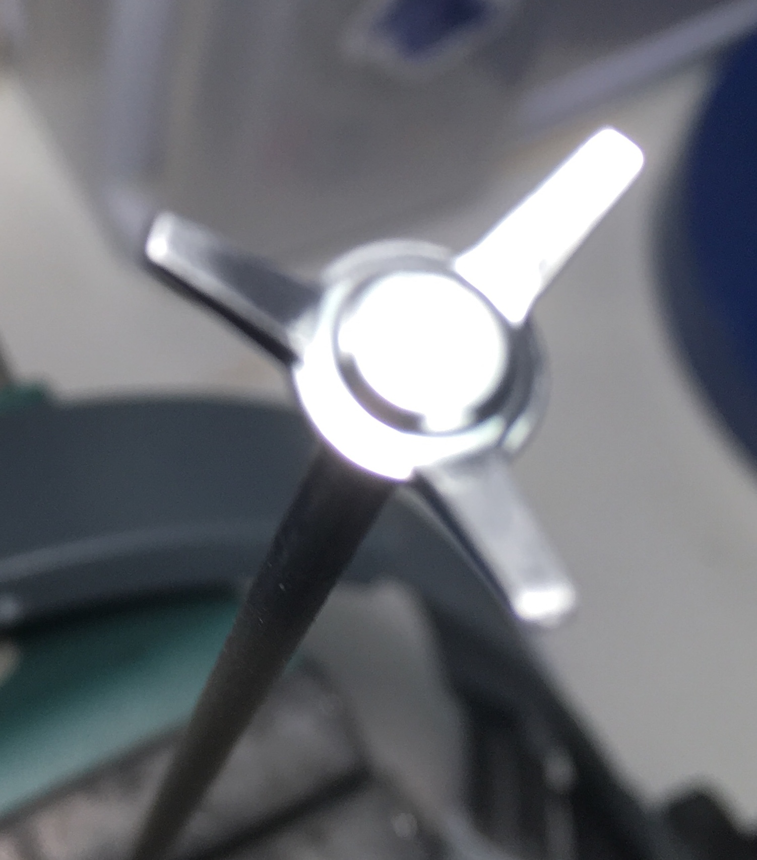

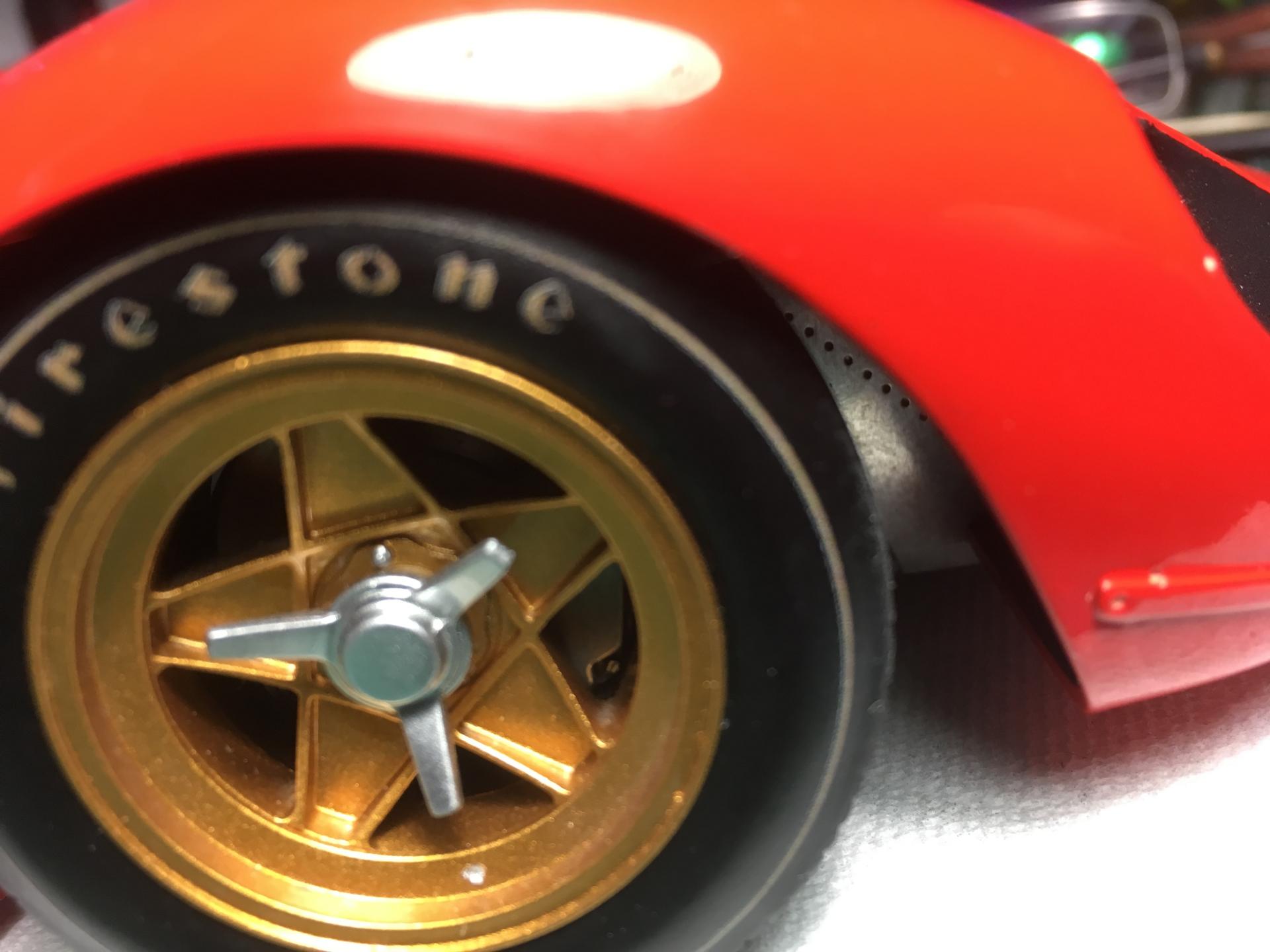

Brudda Posted April 24, 2018 Author Posted April 24, 2018 Molotow liquid chrome. This stuff is great. The best chrome paint ever. Just used a few drops for my spinners and this is the result. Hope you like
Brudda Posted April 26, 2018 Author Posted April 26, 2018 It’s real easy to spray. Just put a few drops in your airbrush, and spray. You do not need gloss black or any gloss for that matter. This was sprayed over primer. Let it dry (a day in this case) then I dipped the spinner into future. Now I can take the spinner off and not hurt the chrome.
Chris Smith Posted April 26, 2018 Posted April 26, 2018 On 4/26/2018 at 4:57 AM, Brudda said: It’s real easy to spray. Just put a few drops in your airbrush, and spray. You do not need gloss black or any gloss for that matter. This was sprayed over primer. Let it dry (a day in this case) then I dipped the spinner into future. Now I can take the spinner off and not hurt the chrome. Expand Nice. I may have to give it a try on my next project

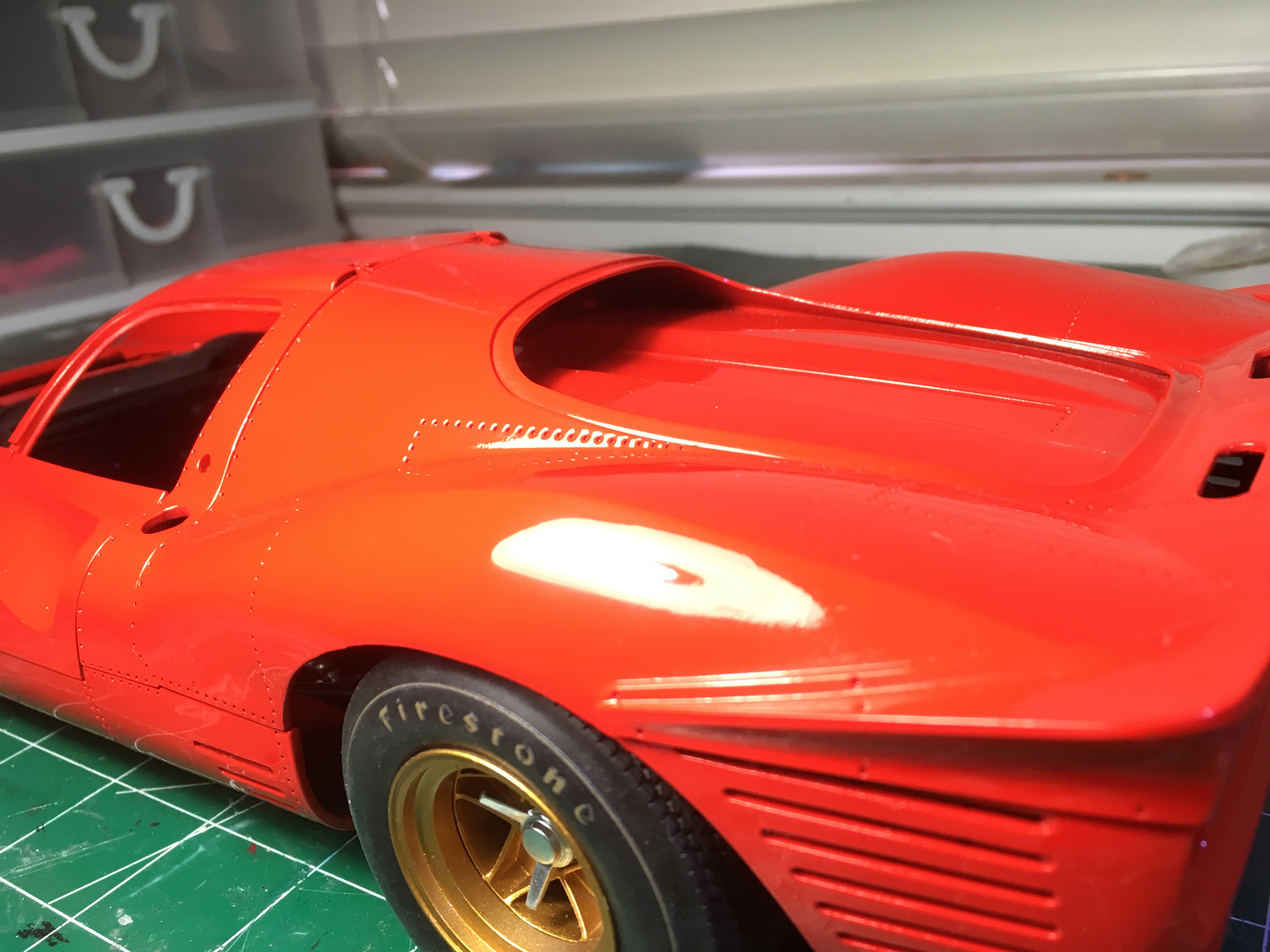

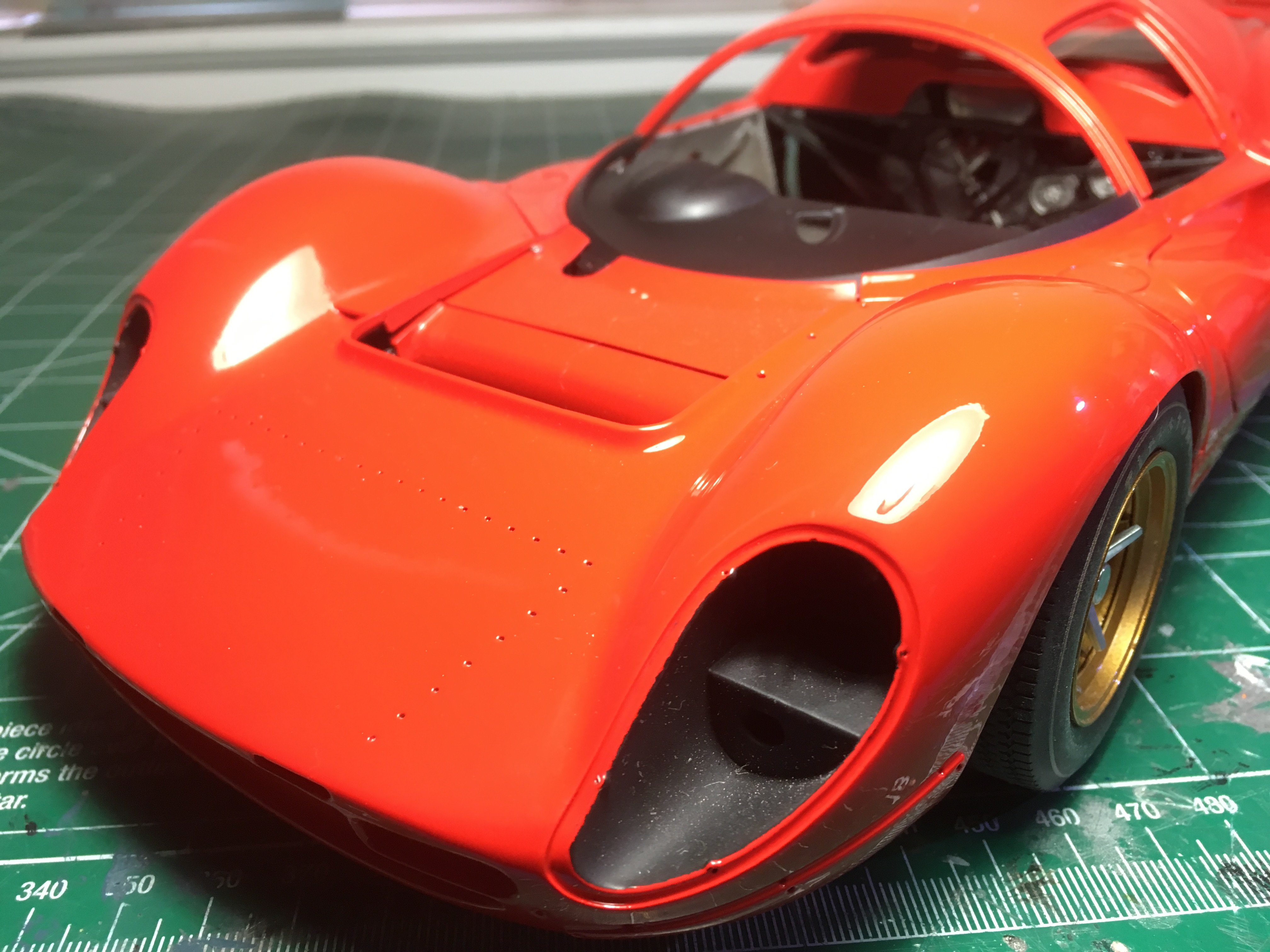

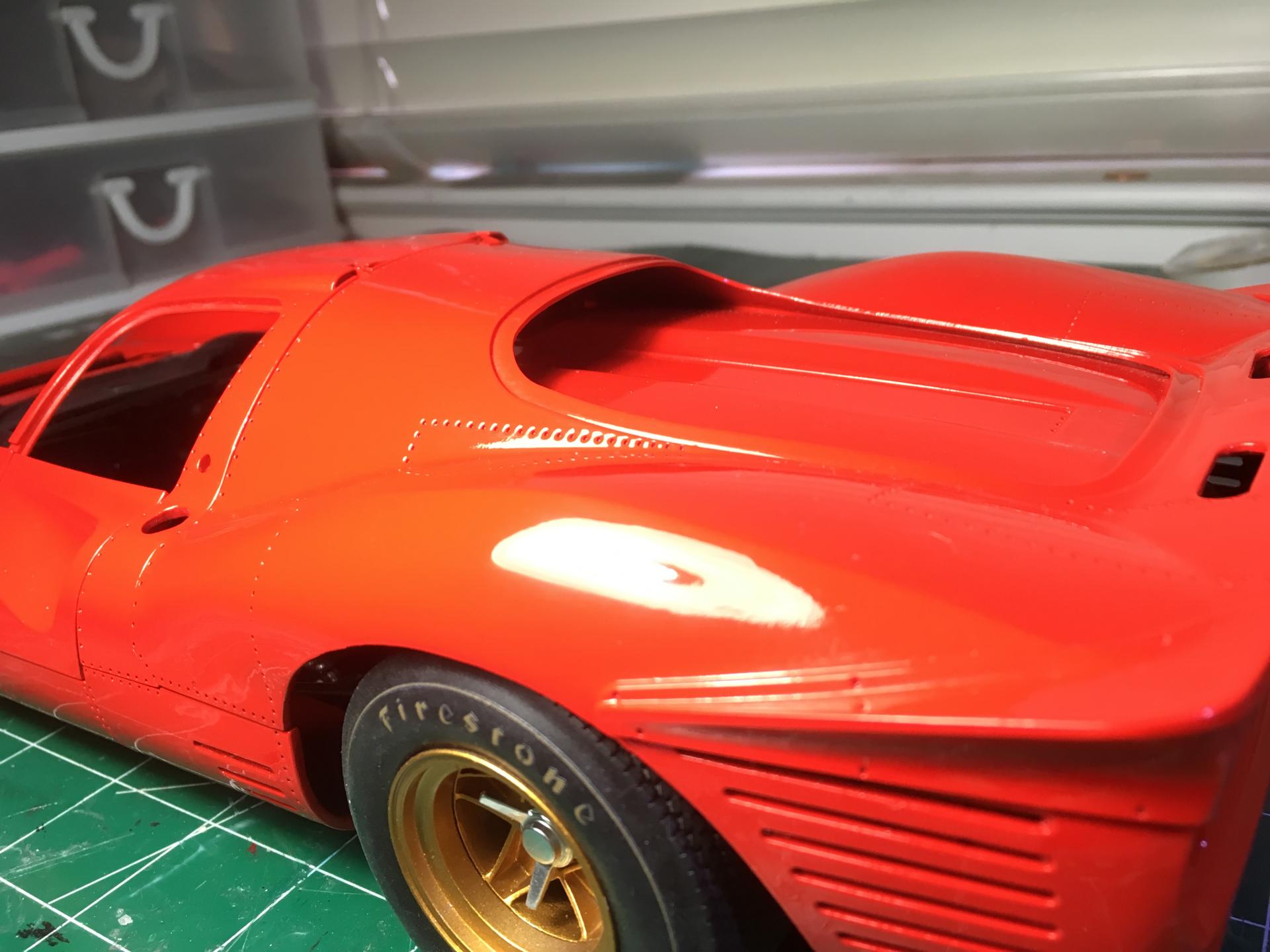

Brudda Posted May 6, 2018 Author Posted May 6, 2018 Rubbed out the paint, nice and shiny. This is a automotive water based paint, then cleared with a automotive urethane clear. The primer is ppg one choice. Hope you like.

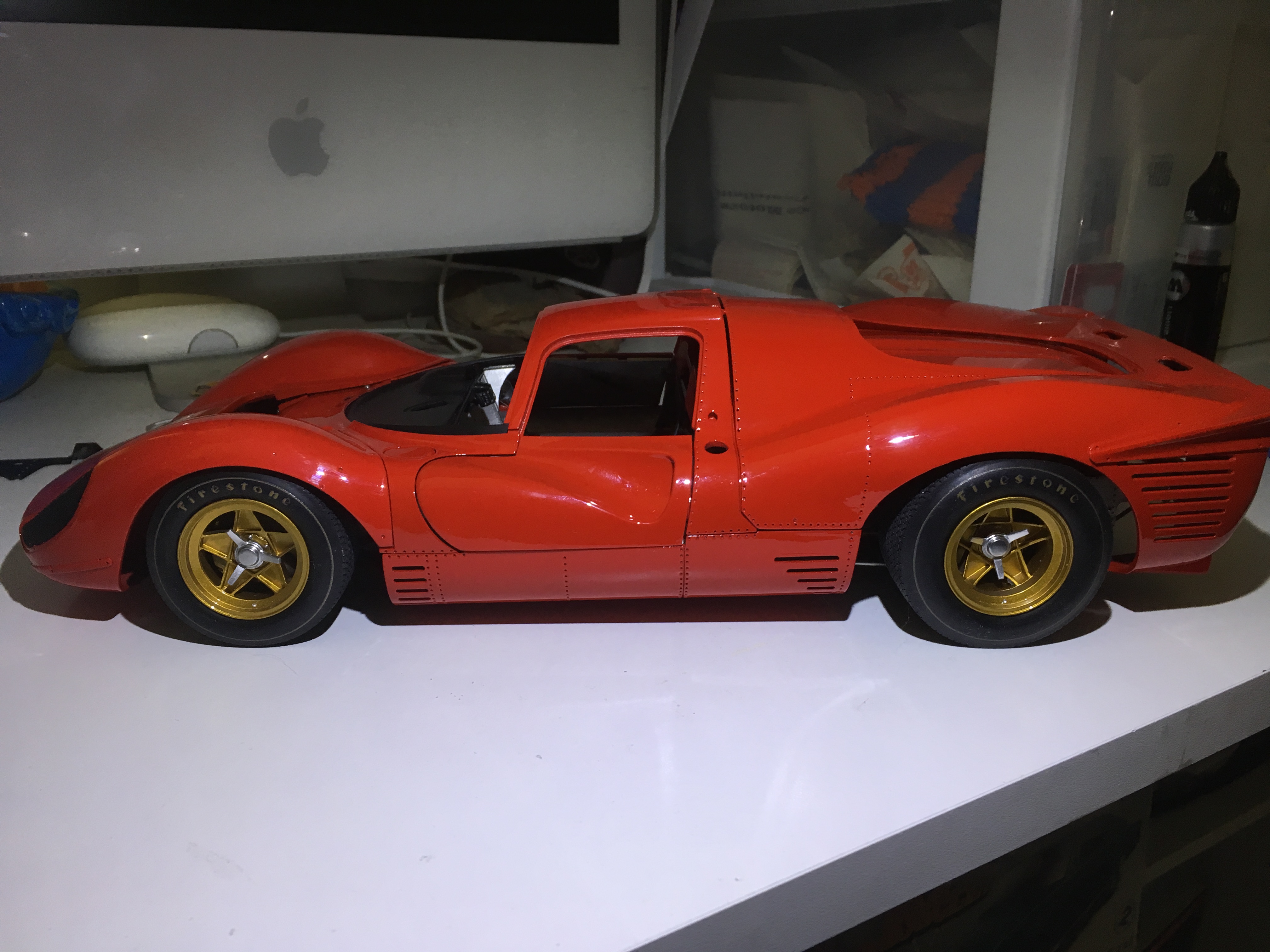

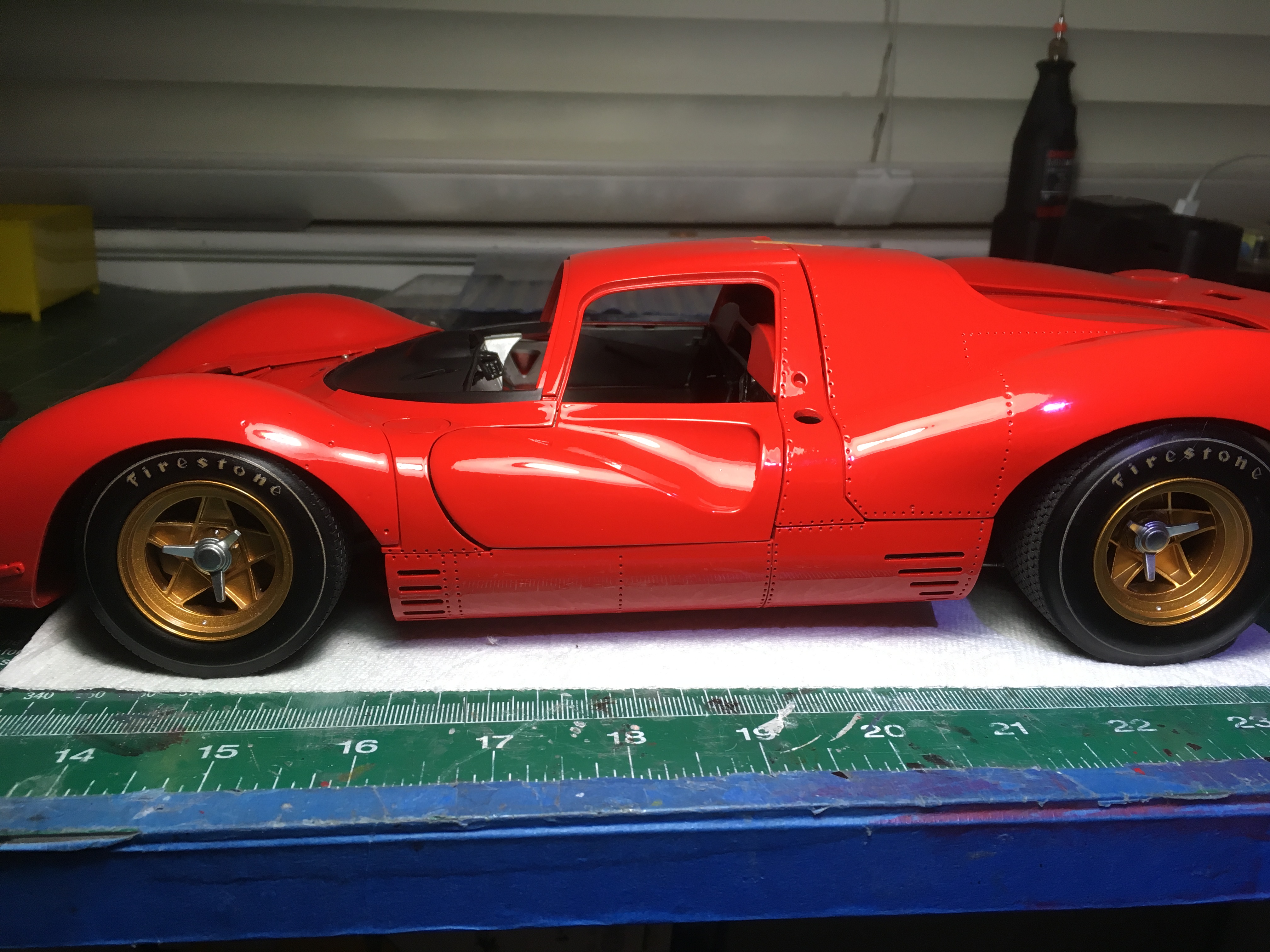

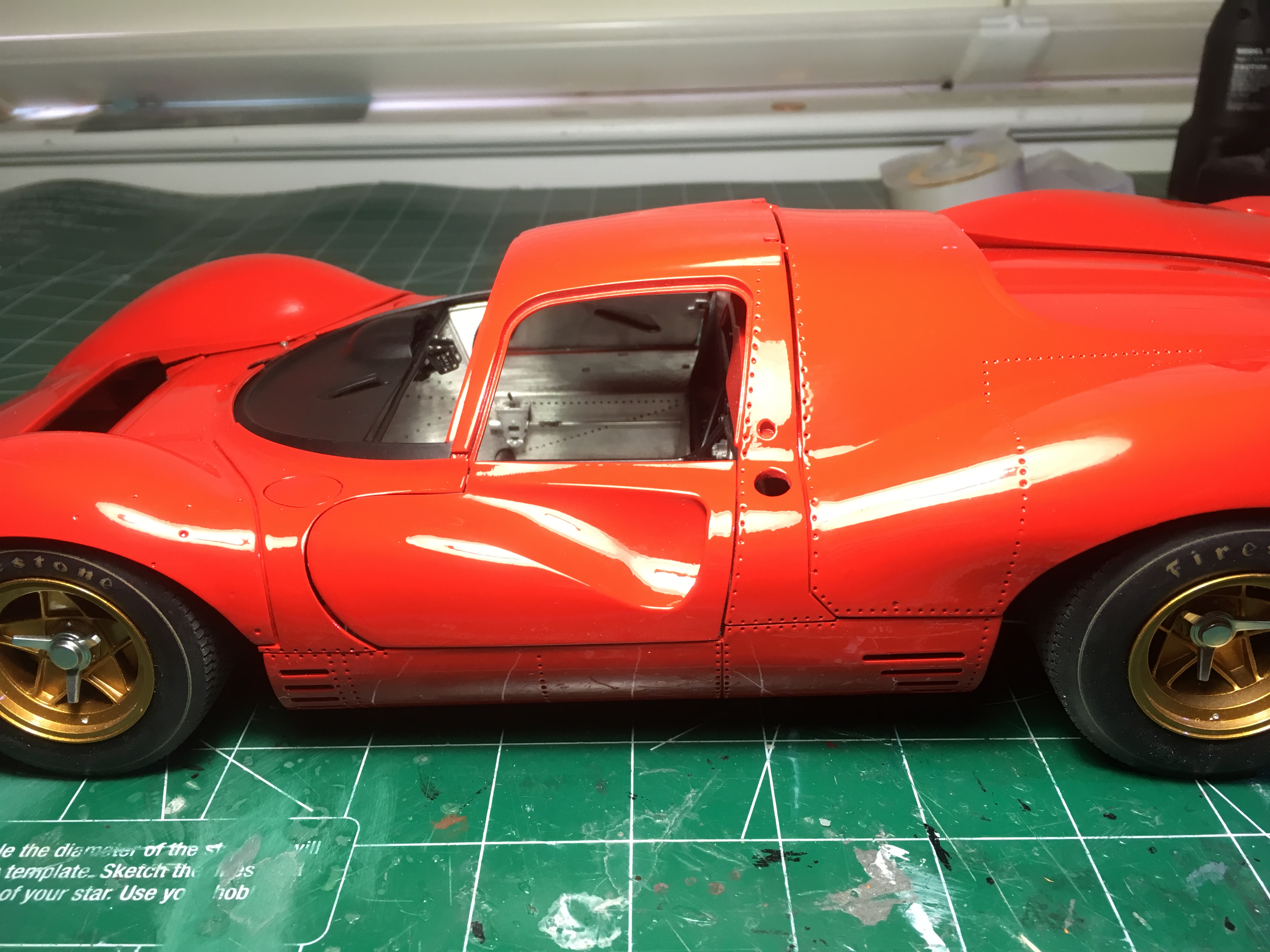

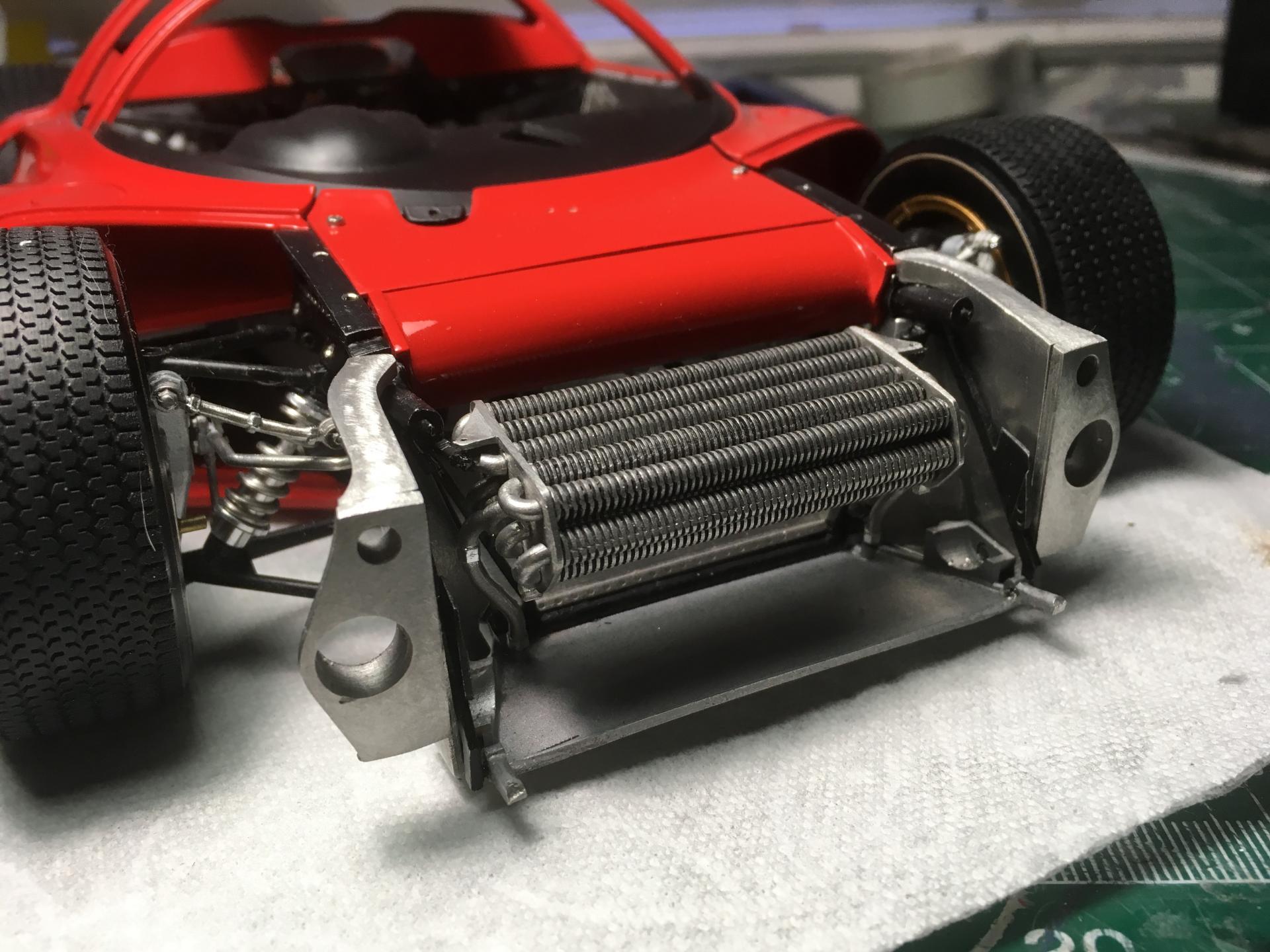

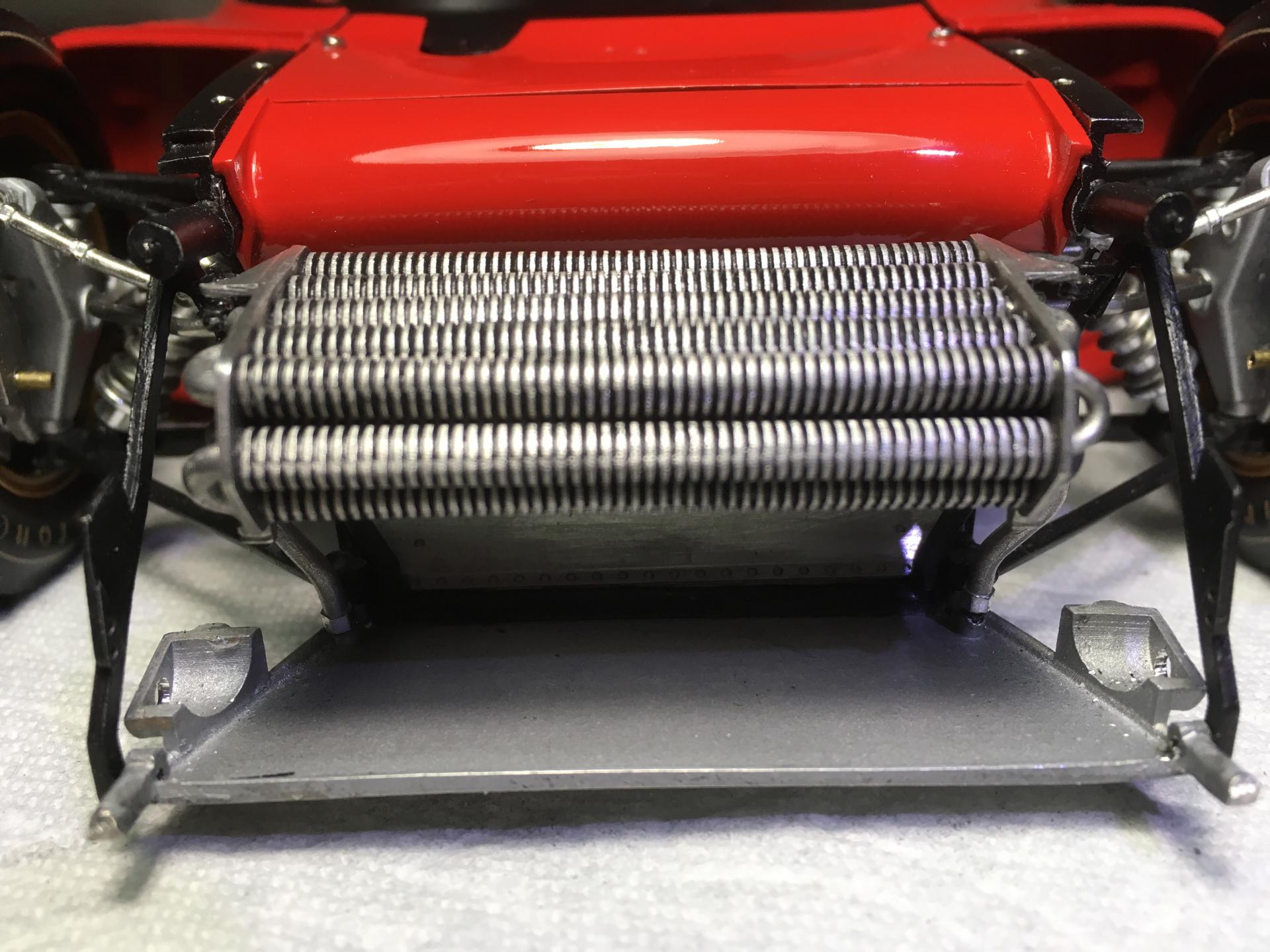

Brudda Posted May 10, 2018 Author Posted May 10, 2018 Thank you for the enlightening comments. Here is the oil cooler. It was 30 parts. Took most of the week. And another side view of the car. Rubbed it out again. Not going to press my luck. I have to learn to leave things alone. From here on I have to be very careful, as the build can go sideways. For some reason it will not let me load the oil cooler pics. Sorry

Chris Smith Posted May 11, 2018 Posted May 11, 2018 The oil cooler looks sick? I can see why it took you a few days to assemble. Keep it coming love this car your building

Brudda Posted May 15, 2018 Author Posted May 15, 2018 Put the duct mounts on the front end. Of course had to modify. This kit is a great kit as long as you model it. Meaning modify, change, cut , add material etc. The model is not a regular kit. As soon as my buddy ,Mark explained to me about mfh kits, it was better. I thought since I spent so much for this kit it was supposed to fall together. NOT SO! You have to work every part. I do not want to put any one off these kits but they are a lot of work. But the results are quite amazing. Next is the cooling ducts for the brakes and interior. Hope you like and thank you for the comments. I’m learning , boy am I learning.
