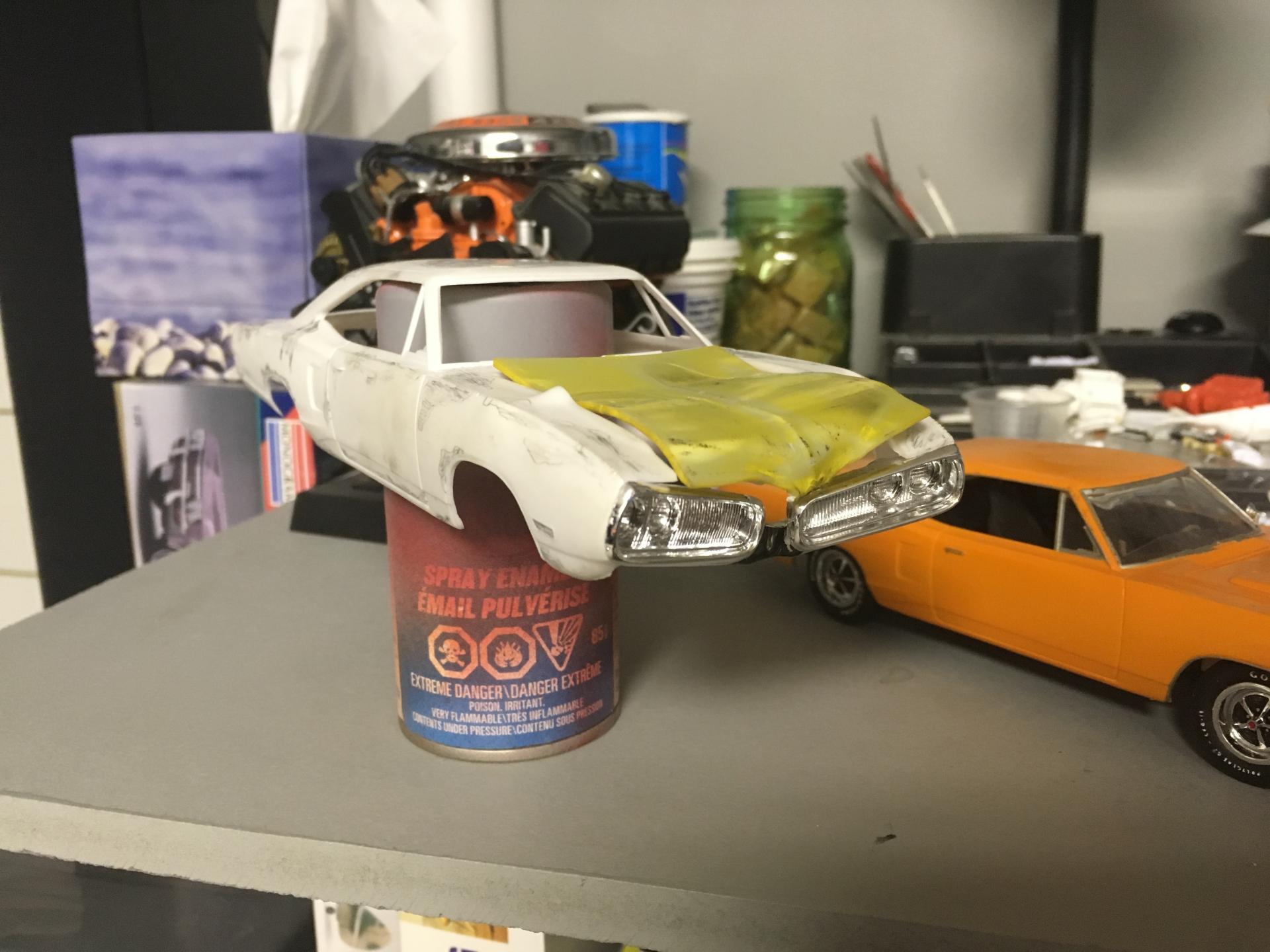

Furiousgeorge Posted October 29, 2017 Posted October 29, 2017 Started this one last night. I’ve rusted a kit before, but wrecking one is completely new territory for me! Should be fun! I tried hot water, but couldn’t get much from that method, so I’m using one of my wife tea candles and needle nose pliers.

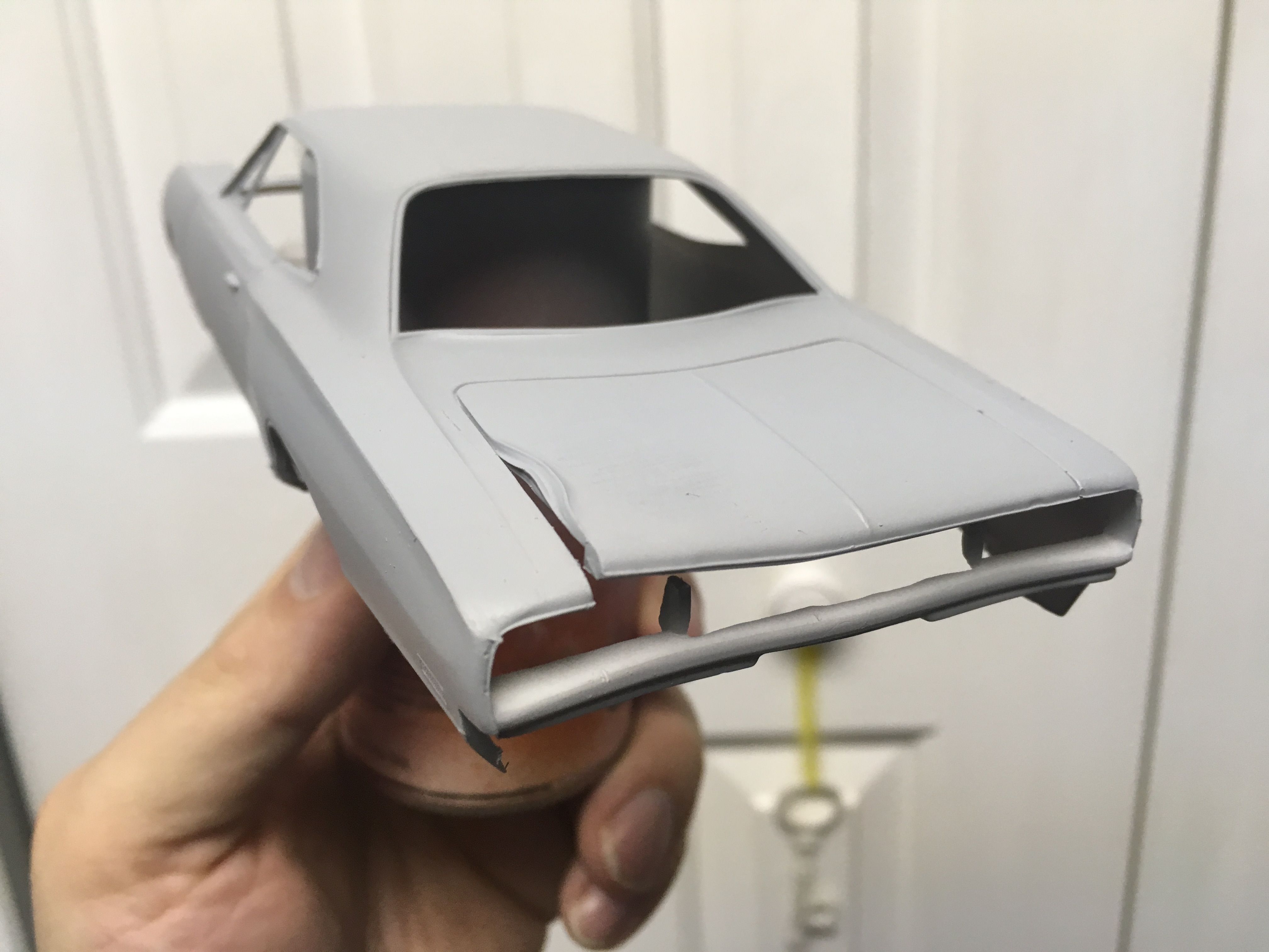

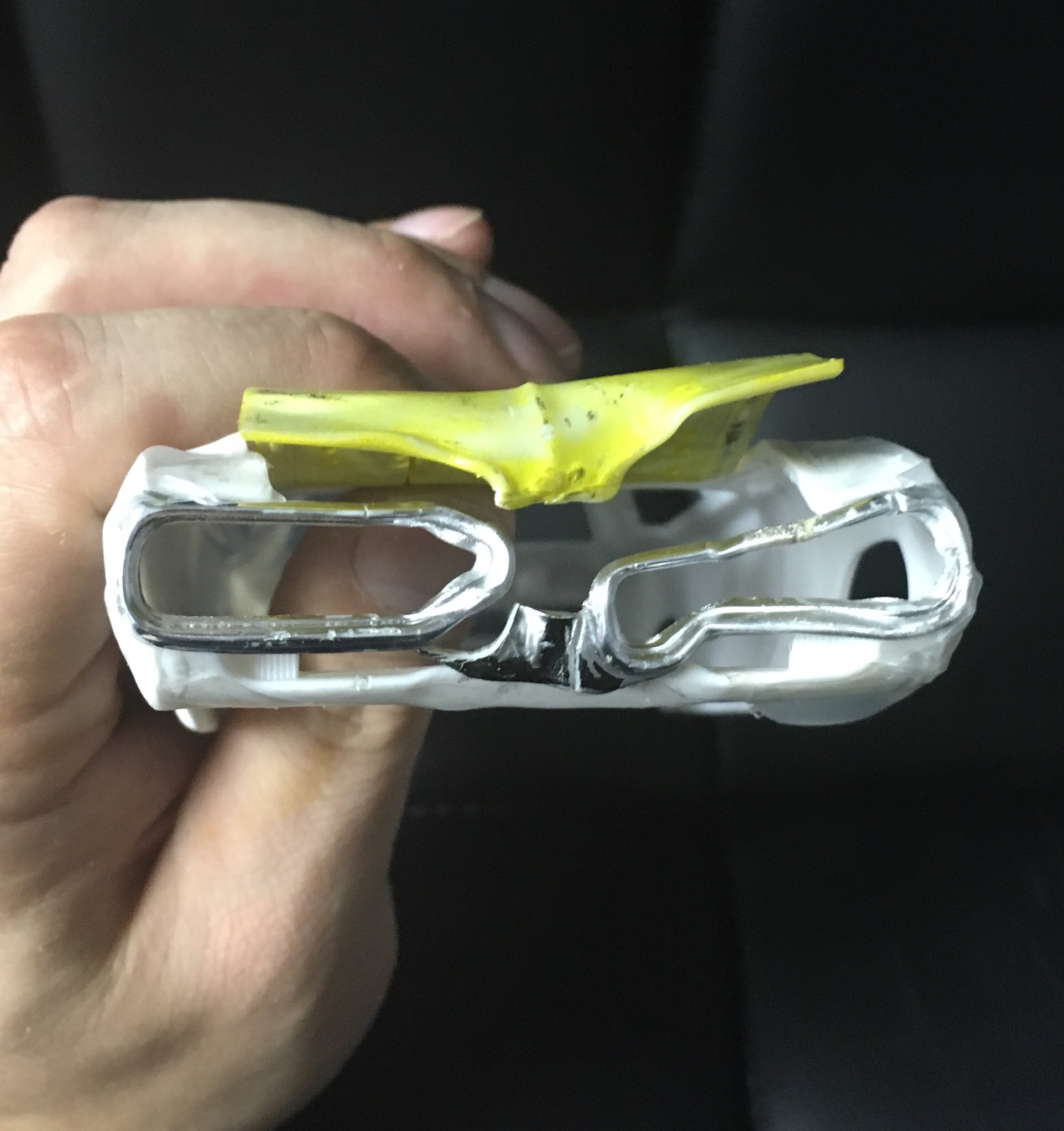

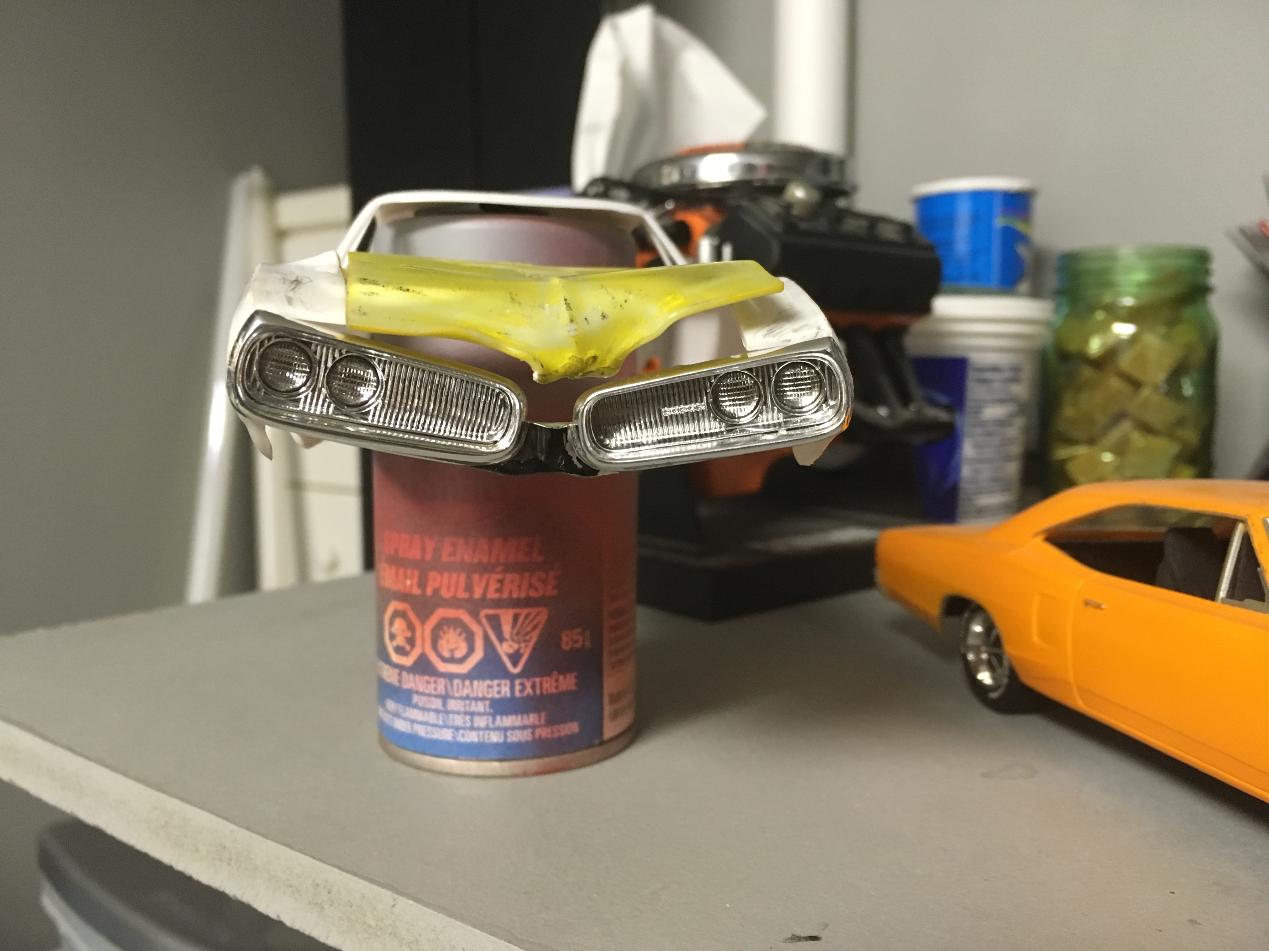

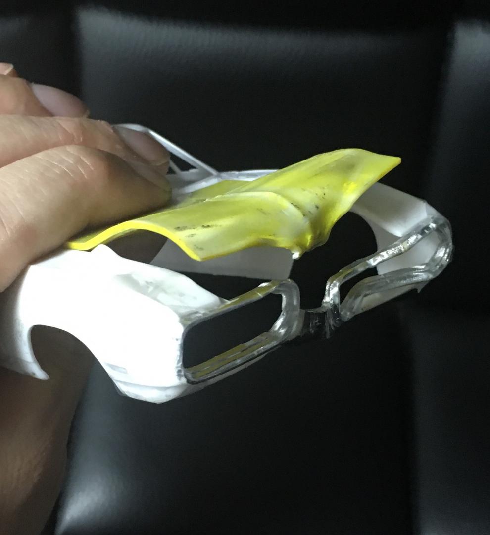

Furiousgeorge Posted October 30, 2017 Author Posted October 30, 2017 Got some work done on the grille, tedious business, but I like how it’s turning out.
Evil Appetite Posted November 3, 2017 Posted November 3, 2017 My uncle had one. He wrecked it. Wrapped it around a telephone pole 7 months after he bought it. When I see that I imagine the front end concave with the engine pushed right up onto the front seat
Furiousgeorge Posted November 7, 2017 Author Posted November 7, 2017 I think that would be beyond my skill level! It’s hard enough getting the rad support and inner fenders to match the little bend that is there!

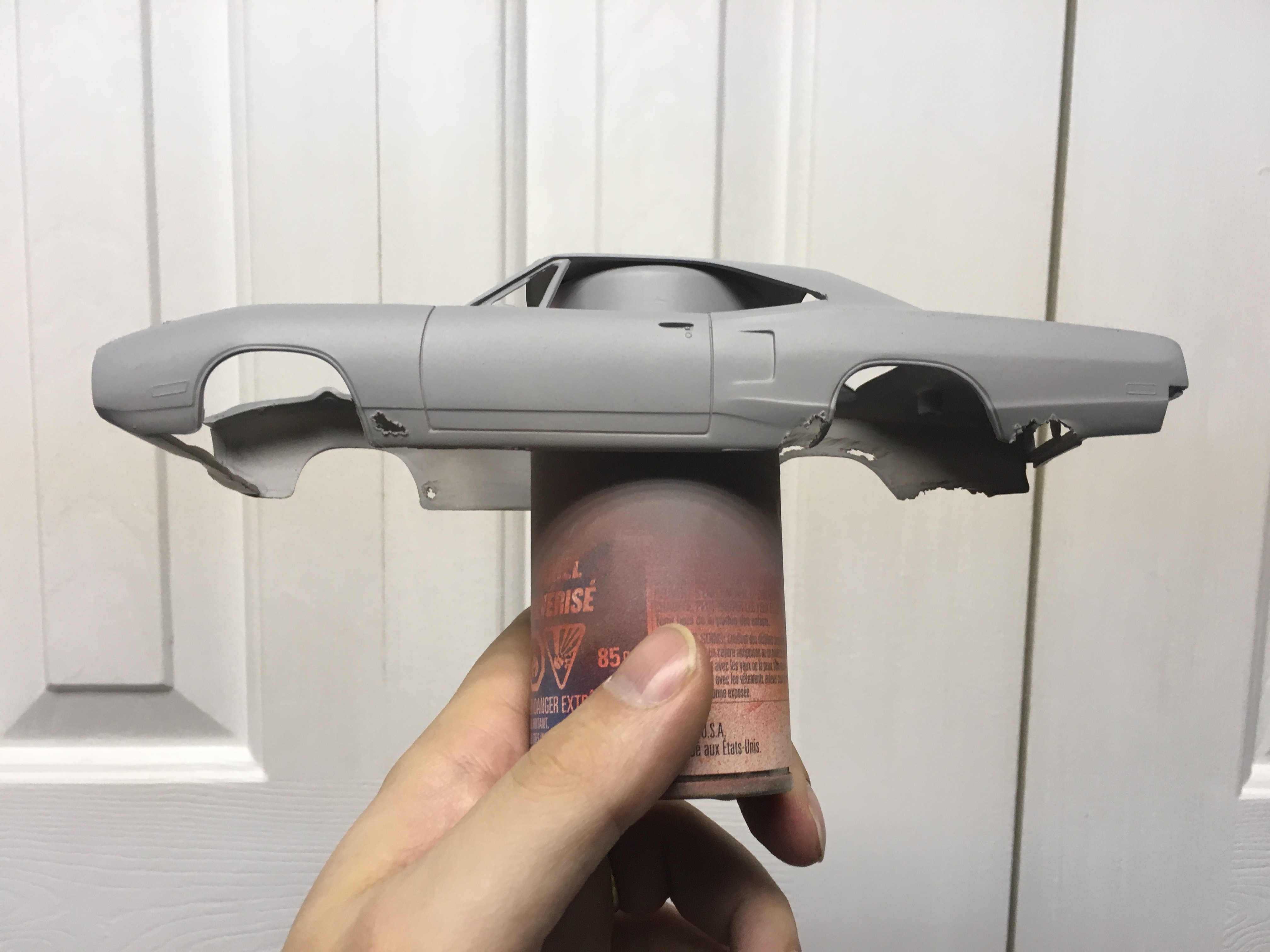

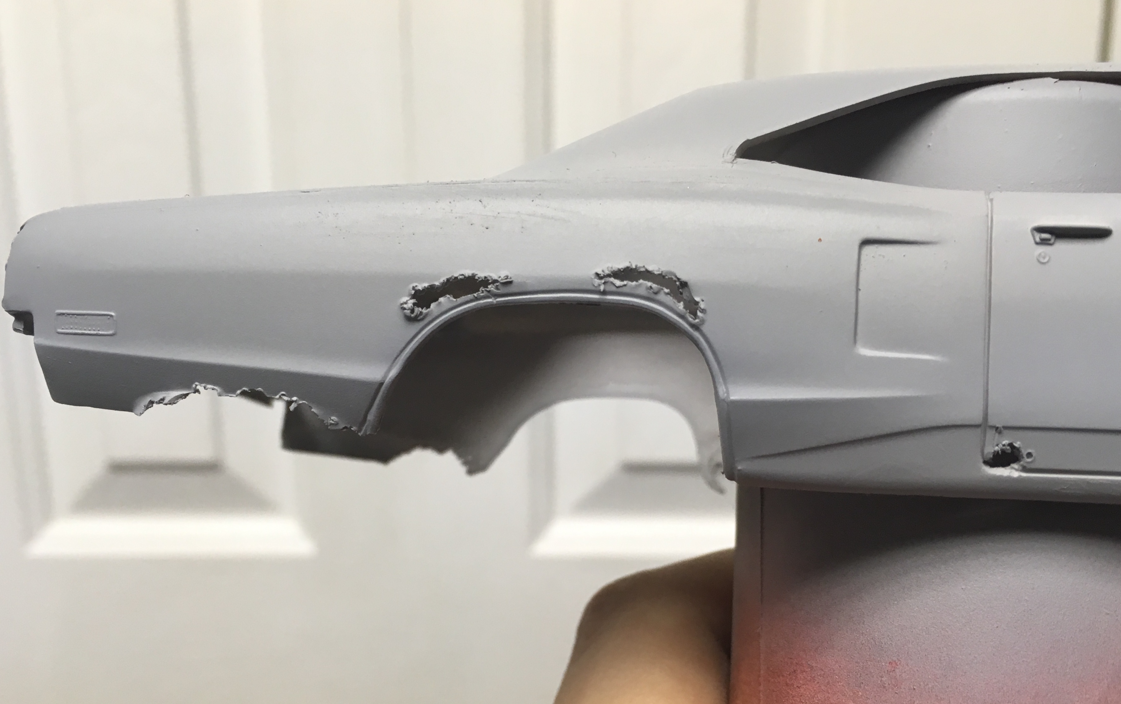

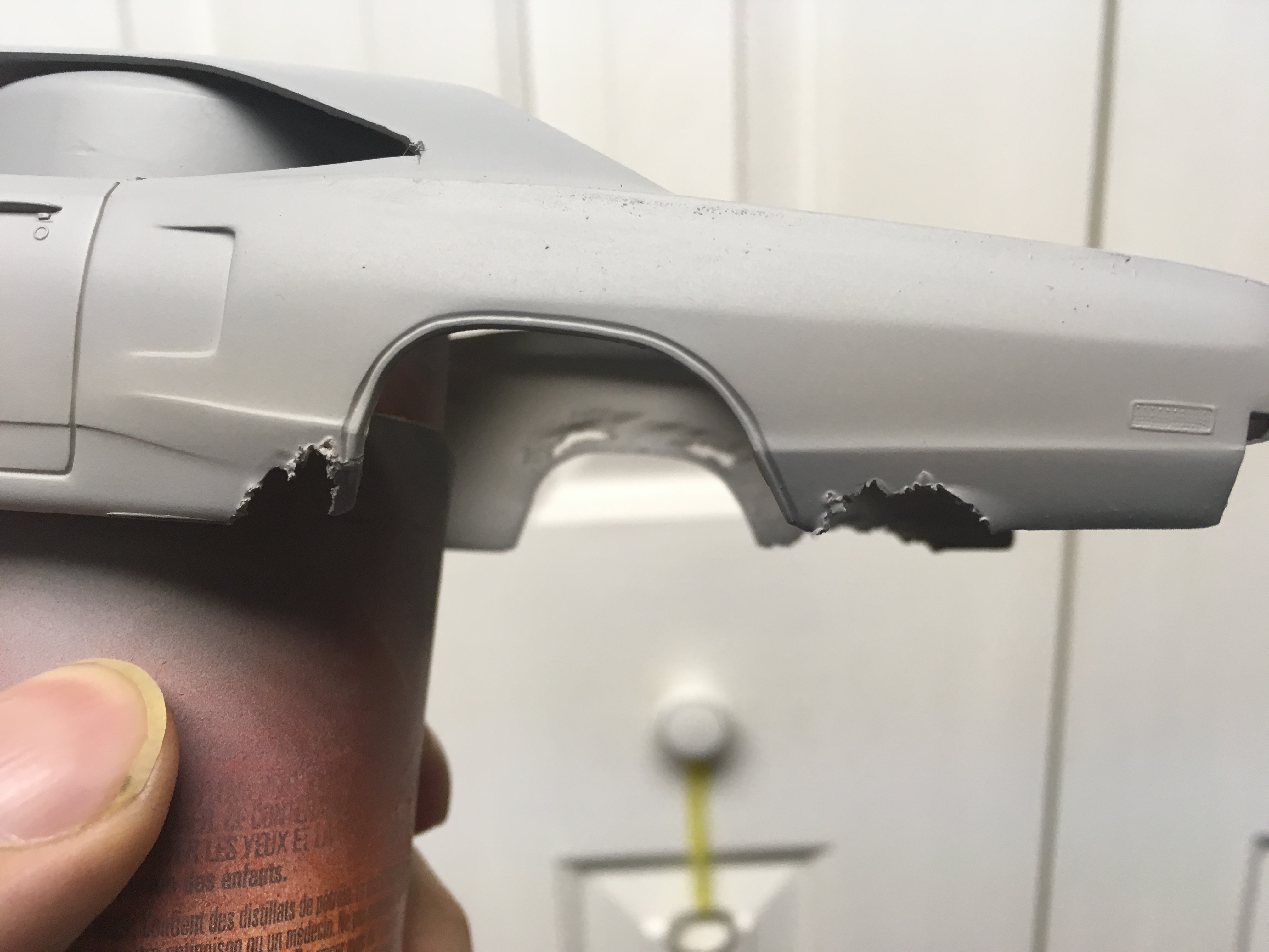

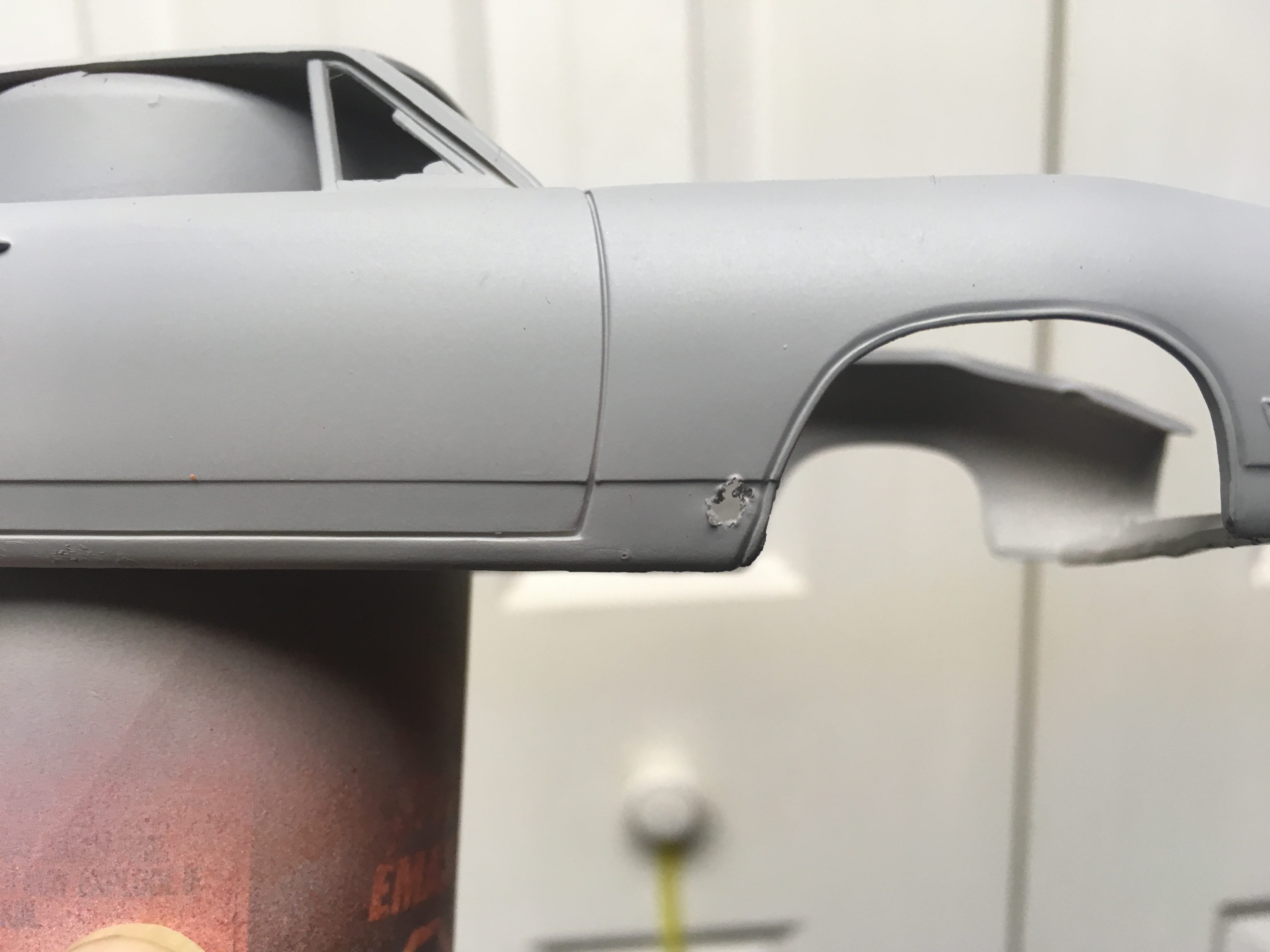

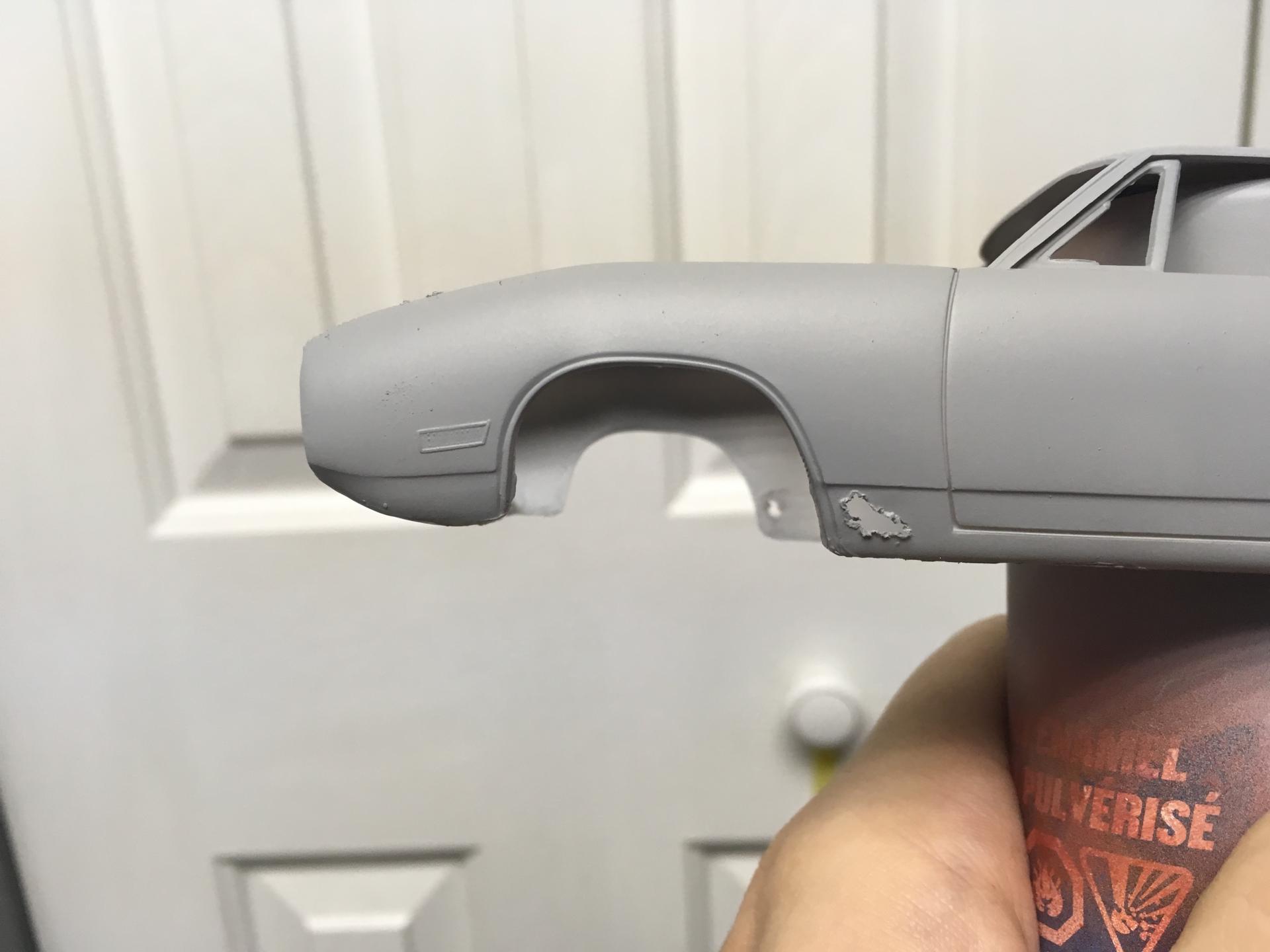

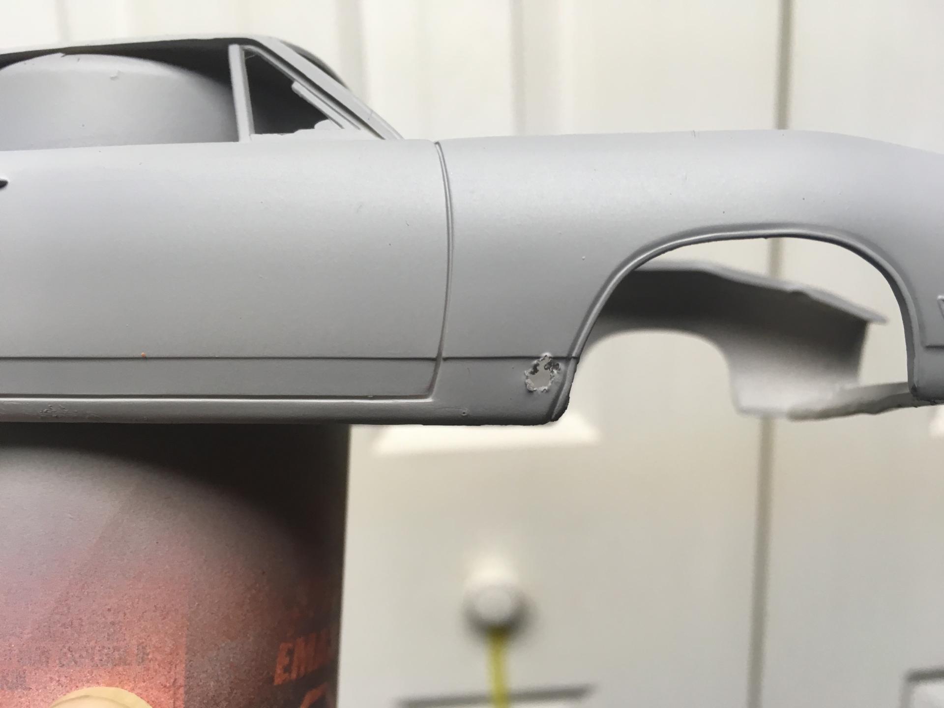

Furiousgeorge Posted November 16, 2017 Author Posted November 16, 2017 Got a bit done on this, some rust holes and primer.

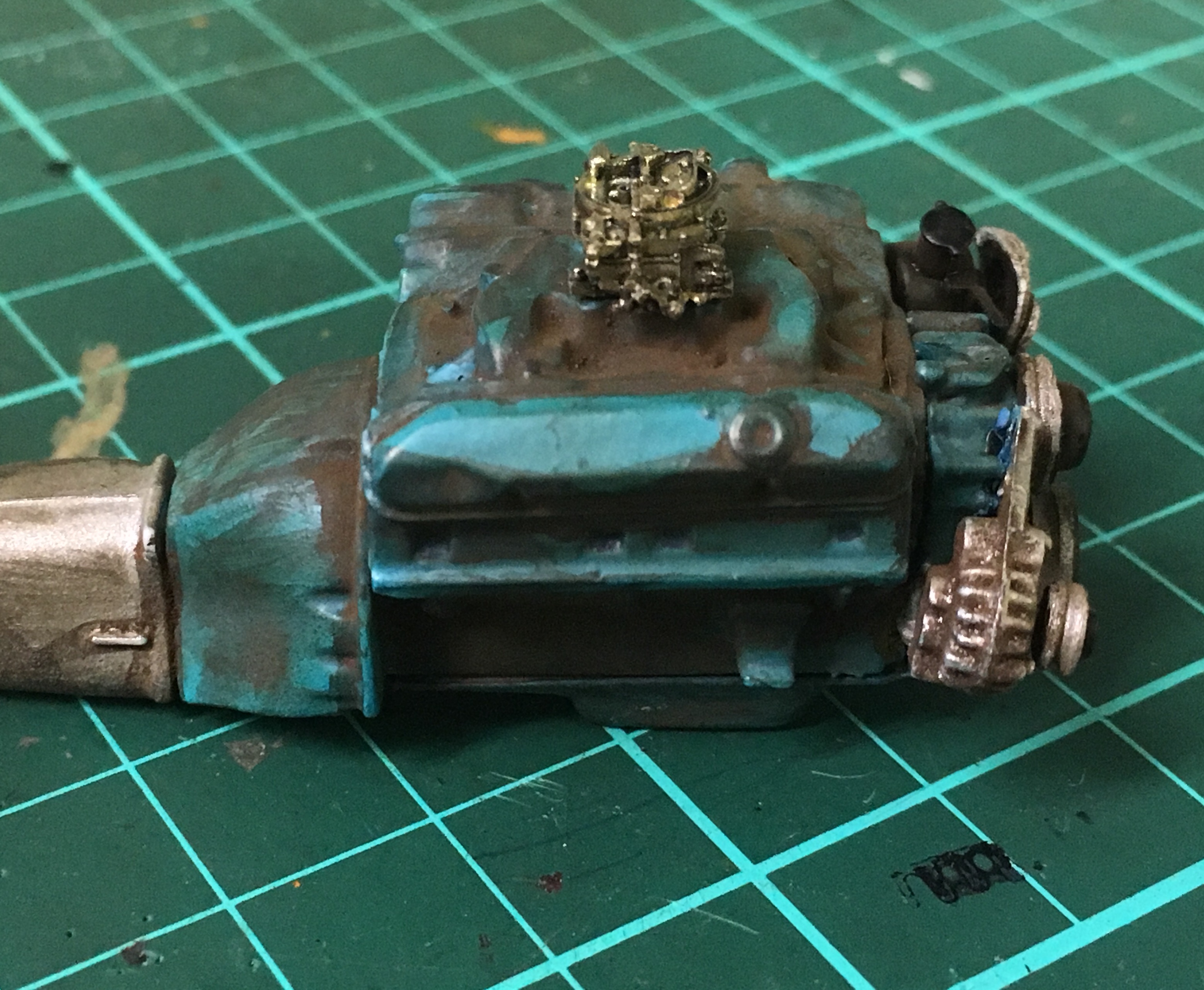

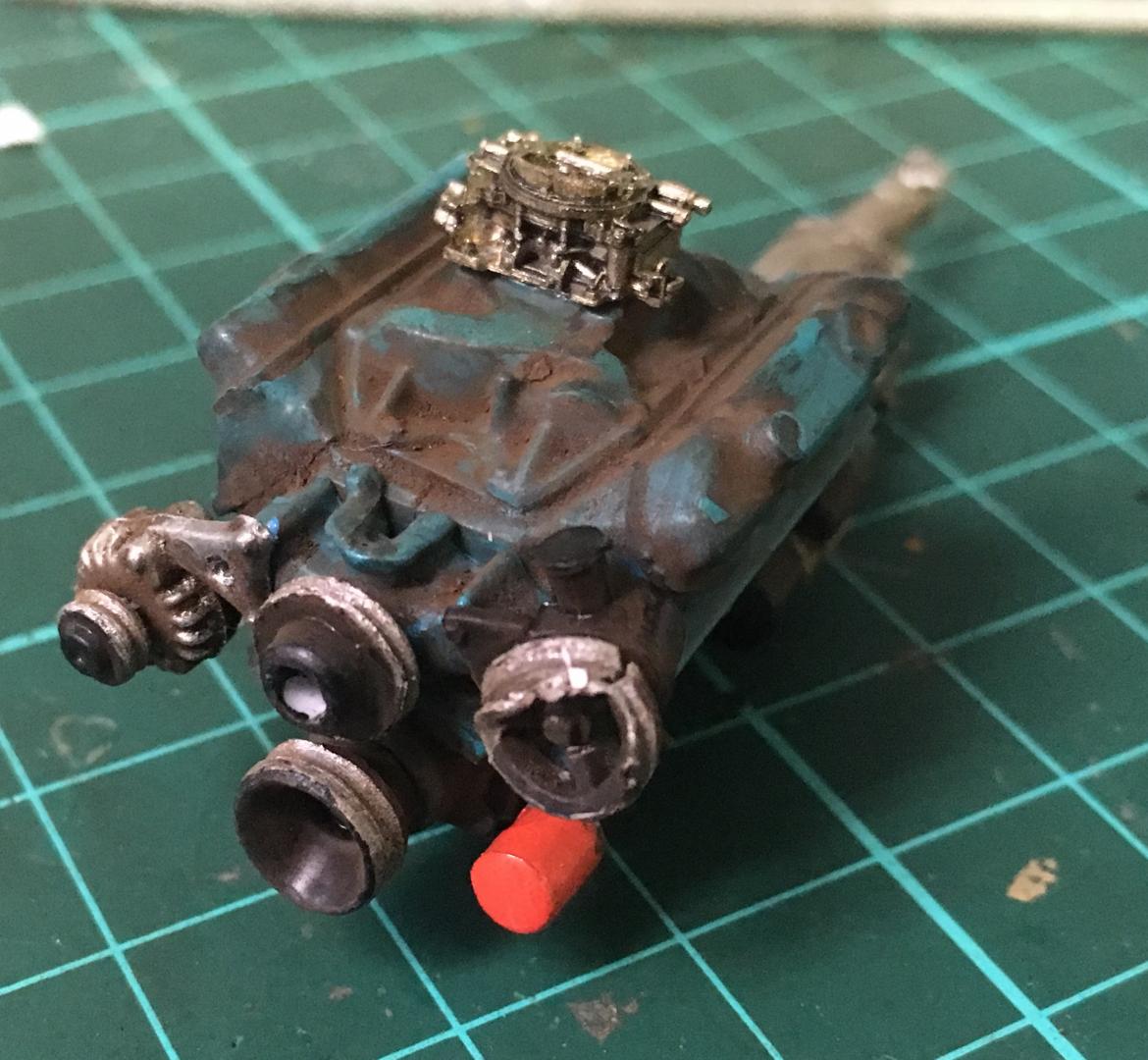

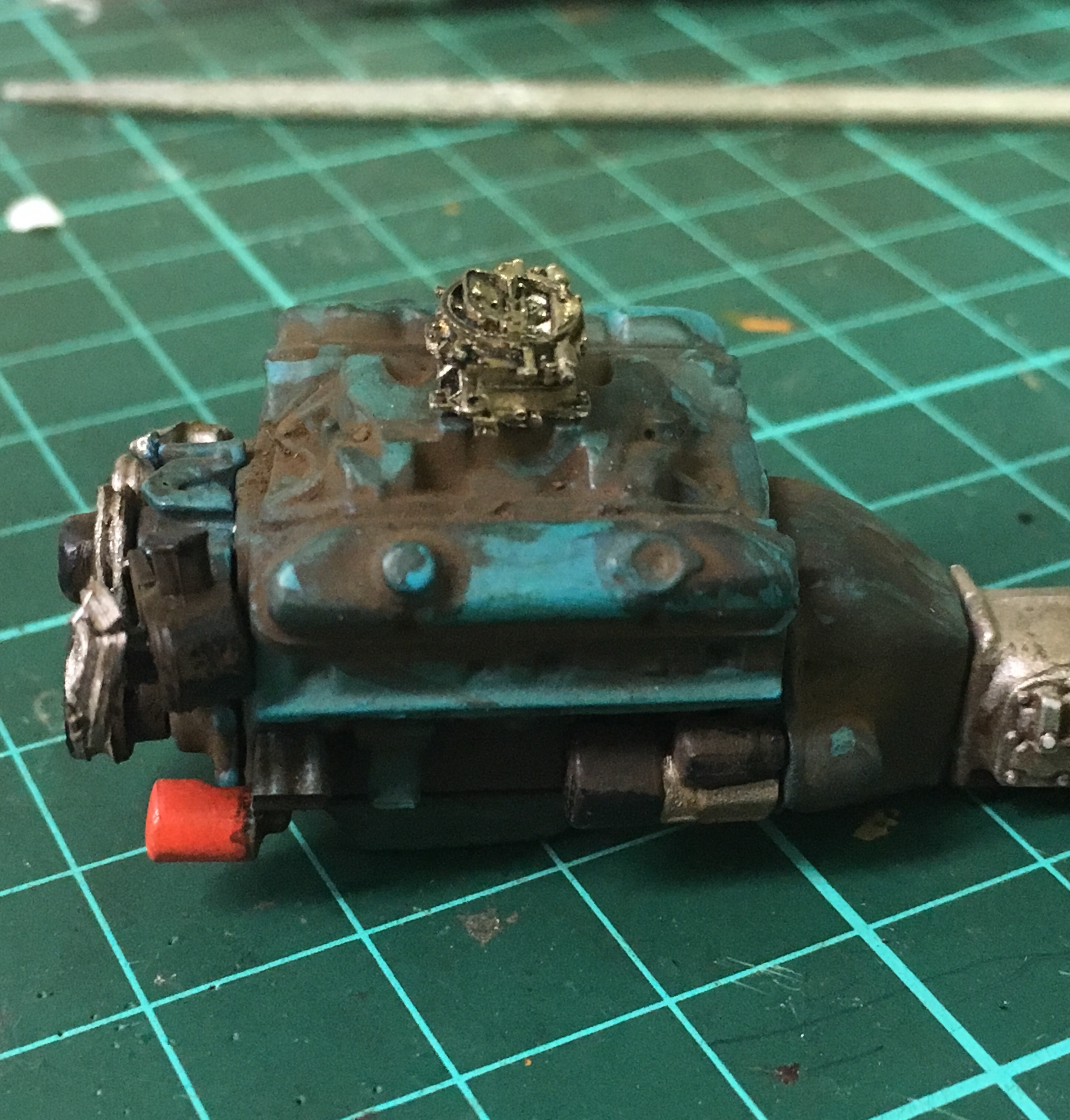

Furiousgeorge Posted December 23, 2017 Author Posted December 23, 2017 Ingot a bit of a break, and got some engine work done. I know it should be orange, but I wanted to try out a new brand of paint. Still have to make an open distributor, broken fan belt, and exhaust, but it’s coming along nicely. Moving slowly, but still going. I did finish a ‘74 GTX that I’ve had going for years. Good to get that one off the bench!
Furiousgeorge Posted December 23, 2017 Author Posted December 23, 2017 I mixed up a grime wash, then just as it was nearly dry, coated it in real powdered rust.

DrKerry Posted December 24, 2017 Posted December 24, 2017 4 hours ago, Furiousgeorge said: I mixed up a grime wash, then just as it was nearly dry, coated it in real powdered rust. Nice, thanks for the info!!!!

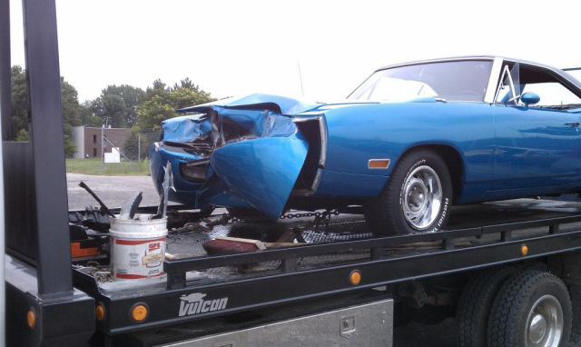

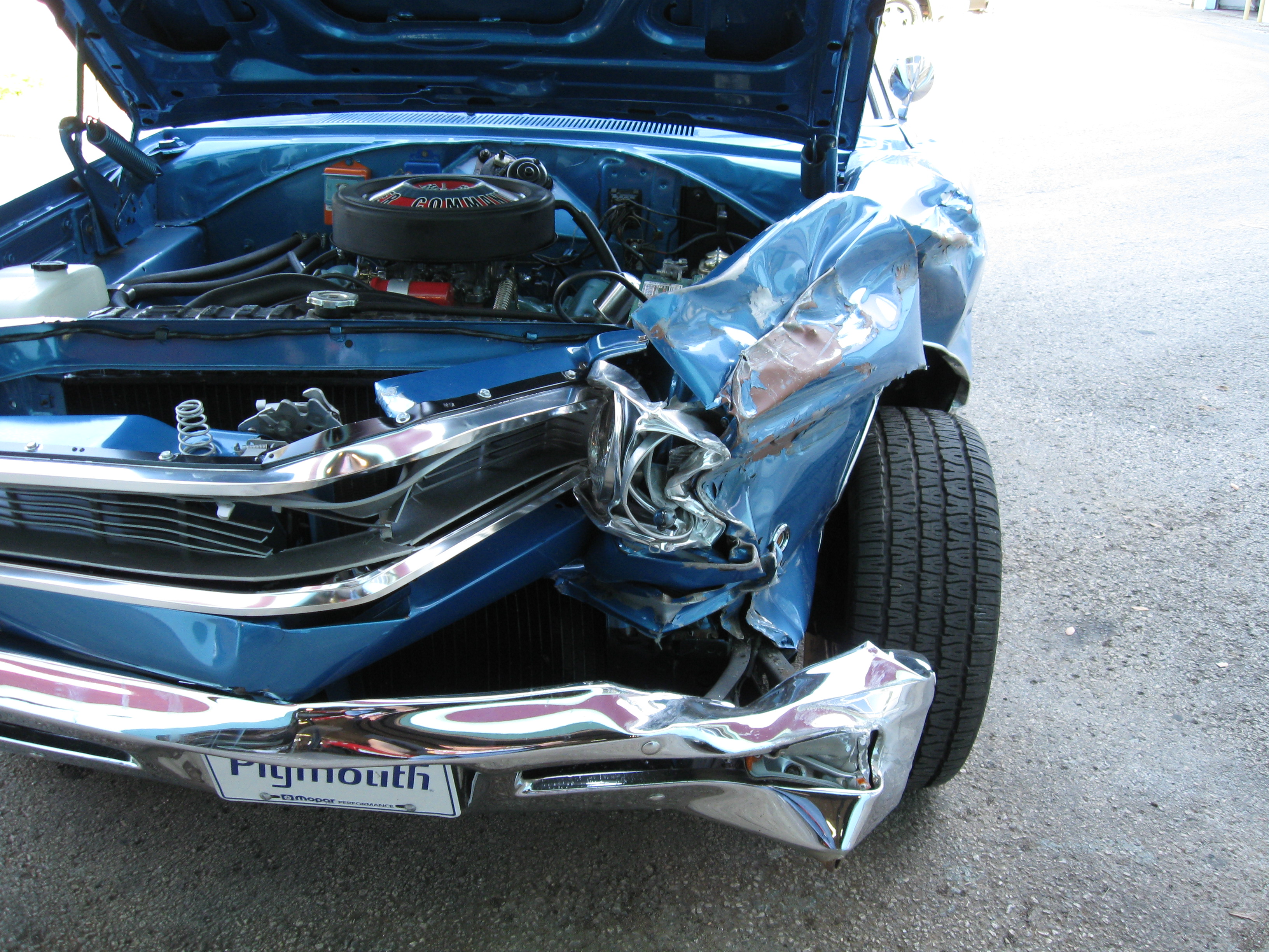

Swifster Posted December 24, 2017 Posted December 24, 2017 (edited) Forgive me, but I work in a body shop and I used to work as an independent appraiser looking at vintage cars. This '68 GTX hit a guard rail on the freeway during a rain storm in 2008. To damage the engine, the radiator support (and radiator) will have to come in contact with the engine. Usually the movement will stop at the fan and fan clutch. With most of your damage being in the center, the fenders will be pulled in, pulling the gaps between the fenders and the doors. I'm not being critical of your efforts, just showing what the real thing looks like. I've kicked around doing a body shop diorama. I'm trying to find a small shop with enough interest to have more than a couple cars in it. The real challenge in doing cars like this is internal structure like radiator supports, front wheelhouses and if you're bold enough inner door and quarter panel structure.. Edited December 24, 2017 by Swifster

Furiousgeorge Posted December 24, 2017 Author Posted December 24, 2017 8 minutes ago, Swifster said: Forgive me, but I work in a body shop and I used to work as an independent appraiser looking at vintage cars. This '68 GTX hit a guard rail on the freeway during a rain storm in 2008. To damage the engine, the radiator support (and radiator will have to come in contact with the engine. Usually the movement will stop at the fan and fan clutch. With most of your damage being in the center, the fenders will be pulled in pull the gaps between the fenders and the doors. I'm not being critical of your efforts, just showing what the real thing looks like. I've kicked around doing a body shop diorama. I'm trying to find a small shop with enough interest to have more than a couple cars in it. The real challenge in doing cars like this is internal structure like radiator supports, front wheelhouses and if you're bold enough inner door and quarter panel structure.. Oh man! I’d cry myself to death if that would have been me! Great inspirational pics though! I think on the next one I’d remove fenders and mess with buckeled doors and whatnot, but this one is more of a “let’s see if I can do it” build. I’m pushing myself quite a bit with this one, learning and figuring out all kinds of stuff on the fly. I hear you on doing the inner engine bay structure! Gives me headaches trying to figure out “if the fenders bent this way, what would the inner fender do?”
Swifster Posted December 24, 2017 Posted December 24, 2017 I'm certainly not suggestion you are doing anything wrong. Just showing the real thing. You can see a small tear in the radiator support, the radiator is bent, the fan shroud is bent and the radiator hose is about 6"'s from where it should be. Again, just things to maybe try in the future. I love old Mopars and just about cried myself when I saw it.
Furiousgeorge Posted December 24, 2017 Author Posted December 24, 2017 Any suggestions are welcome! I’m not so far along that I can’t add/change things. The pictures willl help greatly, and I’ve added them to my pile. The rad and fan are next, being copper they all seem to tend to just bend with the rad support, and get chewed up a bit by the fan hub more then the fan, as you’d mentioned. It’ll be a tight squeeze with this car, with all the bending and twisting, there isn’t much room in there anymore!
gtx6970 Posted December 24, 2017 Posted December 24, 2017 12 hours ago, Swifster said: Forgive me, but I work in a body shop and I used to work as an independent appraiser looking at vintage cars. This '68 GTX hit a guard rail on the freeway during a rain storm in 2008. To damage the engine, the radiator support (and radiator) will have to come in contact with the engine. Usually the movement will stop at the fan and fan clutch. With most of your damage being in the center, the fenders will be pulled in, pulling the gaps between the fenders and the doors. I'm not being critical of your efforts, just showing what the real thing looks like. I've kicked around doing a body shop diorama. I'm trying to find a small shop with enough interest to have more than a couple cars in it. The real challenge in doing cars like this is internal structure like radiator supports, front wheelhouses and if you're bold enough inner door and quarter panel structure.. Oh man that sucks. You hap[pen to know if the car was repaired or wrote off as a total loss ? I saw a picture just a couple years ago. Where a Superbird was involved in a front end collision. It hurt the nose cone pretty bad ( never did hear what happened to it afterwards if it got repaired or not )
Swifster Posted December 25, 2017 Posted December 25, 2017 The GTX was written off as a total loss. But I believe the owner retained the salvage with the intent to repair it. The only issue with that car was lack of power steering and power brakes.
Rotorbolt73 Posted December 25, 2017 Posted December 25, 2017 21 hours ago, Furiousgeorge said: That is the most detailed Carter AFB Carbuerator I have seen in this scale. What kit is it from?
