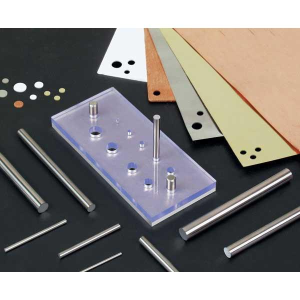

astroracer Posted November 7, 2017 Posted November 7, 2017 Make them. The 1/25th scale diameter of the rivet head will be 0.01 ( a #87 drill) OR .25mm's. Stack a couple of pieces of clear plastic (1/8th inch or so thick) and use the drill to drill a hole through both pieces. Lay some aluminum foil in between and punch out a circle with the back side of the drill. This will get you as many rivets as you will ever use in a couple of minutes...Mark

astroracer Posted November 7, 2017 Posted November 7, 2017 Thanks Bill, but not really. I use one of these a lot in the shop making one-off gaskets and templates for 1 to 1 cars I am building. My punch is much bigger, but the principal is the same. https://www.micromark.com/Micro-Punch-Set
