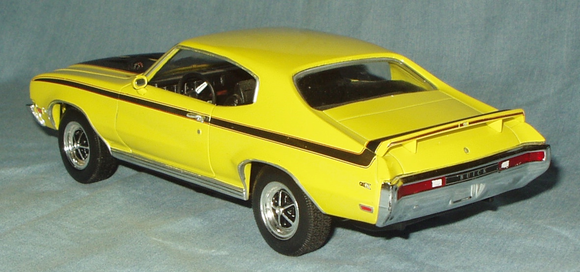

Snake45 Posted February 11, 2018 Posted February 11, 2018 18 hours ago, Casey said: Unfortunately this is the most glaring weak spot on this kit, and even worse, there's no easy fix. As I said, the area gave me no trouble at all. What's giving me fits--and has kept me from finishing the model for over 20 years--is figuring out how to do the yellow on the hood right. There's a thin stripe of yellow down the center, and the hood scoops are surrounded with yellow, which most modelers seen to just ignore and paint black. I THINK I've figured out how to mask the scoops but the thin stripe is still something I don't want to deal with, yet. In the meantime, this cheap, slightly undersized (I think about 1/26.5) Welly diecast with added Snake-fu is holding down the GSX slot on my shelf This was one of the first diecasts I Snake-fu'ed about four years ago, and I can see from the pictures that it could probably use another helping, using some of my newer tricks. Maybe soon!
