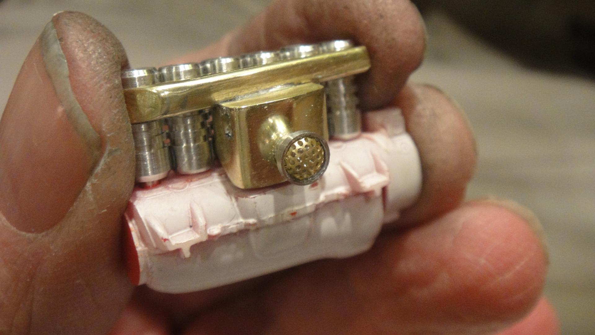

Don't want to step on your thread but this is how I did the air intake on a Red Baron I did some time ago.  Thought it might provide some inspiration.  Never finished it, but I may need to get back at it one of these days.
As to the decompression lever, I have no experience with the physical force to operate it, but considering the fact that this is scaled down to about half size, I don't think anyone could argue with a cable control.  You could leave it alone and just say it takes two people to start the engine.  On the real deal aircraft it takes at least two people to start it.
