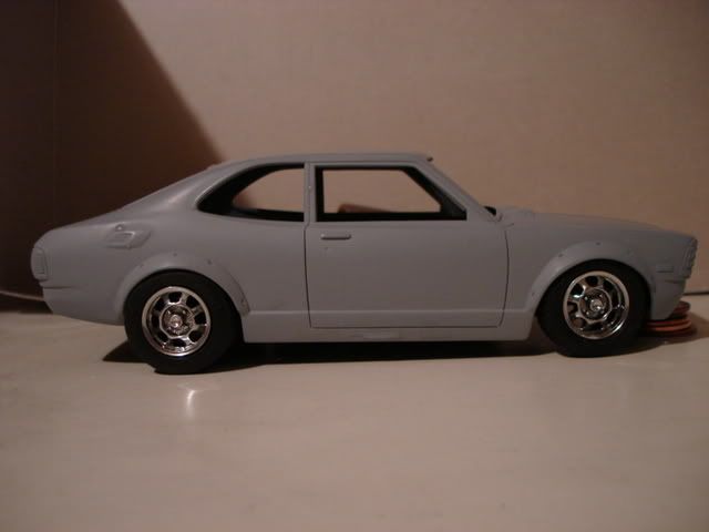

jbwelda Posted September 28, 2007 Author Posted September 28, 2007 marcos im not sure i understand your technique there, maybe im missing something? so you scribe the lines very deep and then sharpie them from the back so the black shows through. then you flow metalizer (you didnt specify a color but when i think metalizer i think silvery color) into your panel lines. then you primer and paint, and sometimes add more metalizer between coats. so...im unsure what youre left with then. the metalizer somehow doesnt get covered by primer and paint? if its covered by the metalizer, what use was the sharpie on the inside of the scribed lines? how does silvery metalizer end up looking dark like a panel line? i see your photo there so its obvious your technique works but im kind of puzzled how it works.
cruz Posted September 28, 2007 Posted September 28, 2007 If you look at the metalizers, they have various shades, I usually go with the darkest but it really does not matter, at the end of your painting session they will look dark, not silvery. I use the sharpie on the white plastic and this gives me an idea how the panel lines will look at the end, that's just me being picky After I prime the car I will flow more metalizer paint into the lines, sand my primer and fix any imperfections and prime again. I stop flowing paint into the lines on my last primer coat, there will be enough paint in the lines for a good finishing effect. Hope this helps..............
jbwelda Posted September 28, 2007 Author Posted September 28, 2007 thanks for clarifying that marcos, i may try this technique one day...your lines do look very nice in the photos you posted. so the lines stay dark somehow even after the color has been sprayed on? i take it you use an airbrush and can control the amount of paint you squirt. unfortunately im using cans, tamiya mostly these days...wonder how those lines stand up to that?
cruz Posted September 29, 2007 Posted September 29, 2007 Hey my friend, both cars were painted with cans, it does not matter, the primered Corolla you see in the first picture was done with an airbrush because I use the Floquil brand of primer so it has to be airbrushed but the color and clearcoats were done with cans. Here is a picture of my Impala, also done with cans and you can clearly see that the car is silver but yet the panel lines are dark even after using the metalizer paints........
